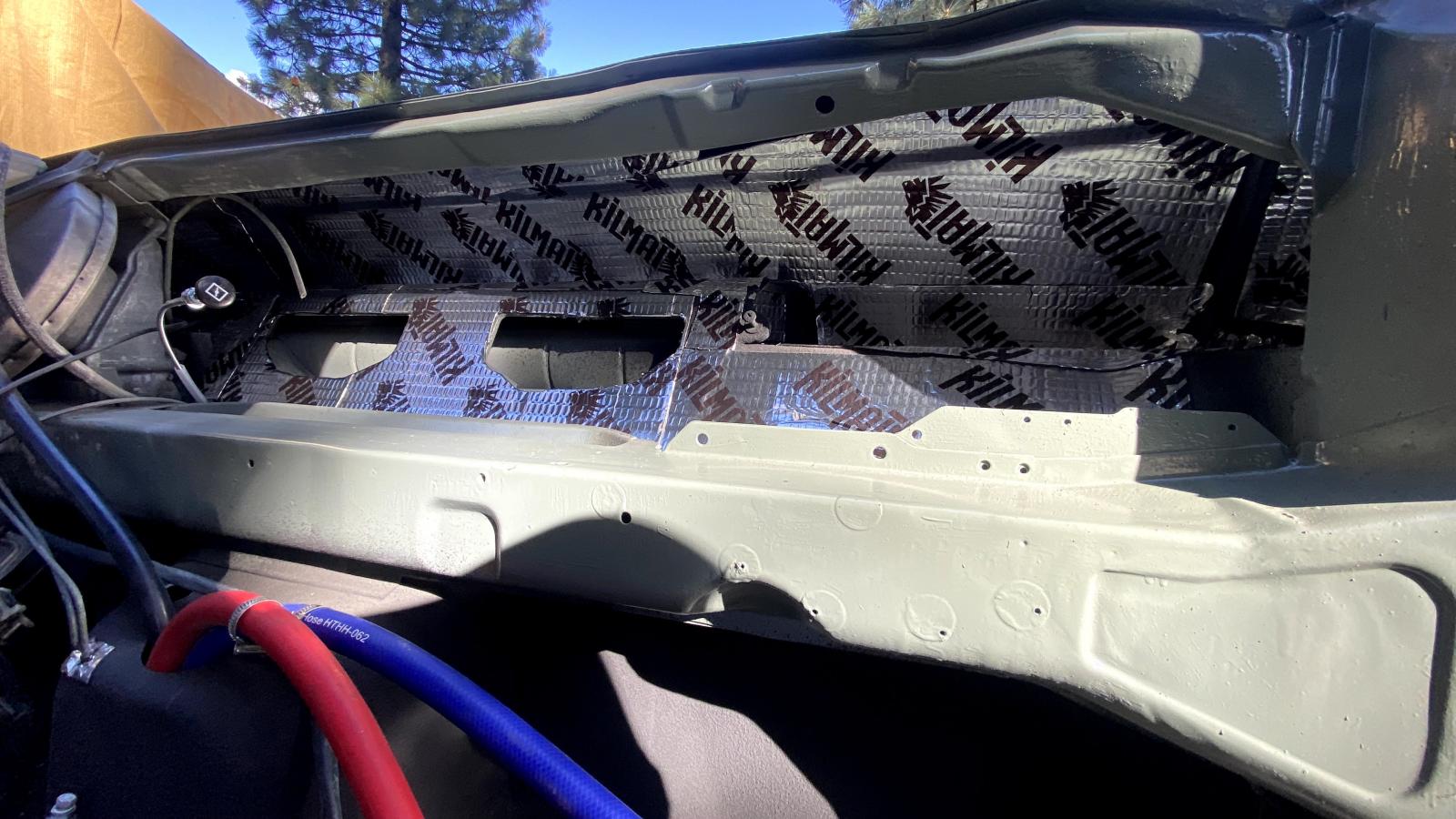

PostPosted: Thu May 06, 2021 5:21 pm    Post subject: Re: 1981 (@wileythewesty) TDI conversion, from ground up Reply with quote
I finally installed the lever for the vanistan fresh air vent. Looking good. Ill end up clipping the lever part on a U bolt somewhere on the dash when i get there.
next i did some of this fake soundproofing up front so i could feel better about my life
Lastly, since the weather is FINALLY warm, I did a bunch of prep work and cleaning on the battery box area. Plan here is to put some fiberglass down, and then drill out drainage holes. There was some rot that I cut out (small bits) and didnt want to weld a whole new pan in, since the metal was good most places. Someone stop me if im insane for adding fiberglass- dunno, seems like a good idea.
Ill probably finish it off with either 3m rubberized undercoat that ive got leftover from the underside or some fake soundproofing stuff.

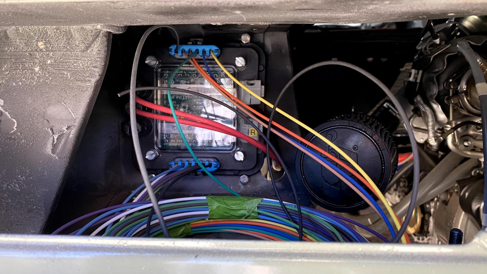

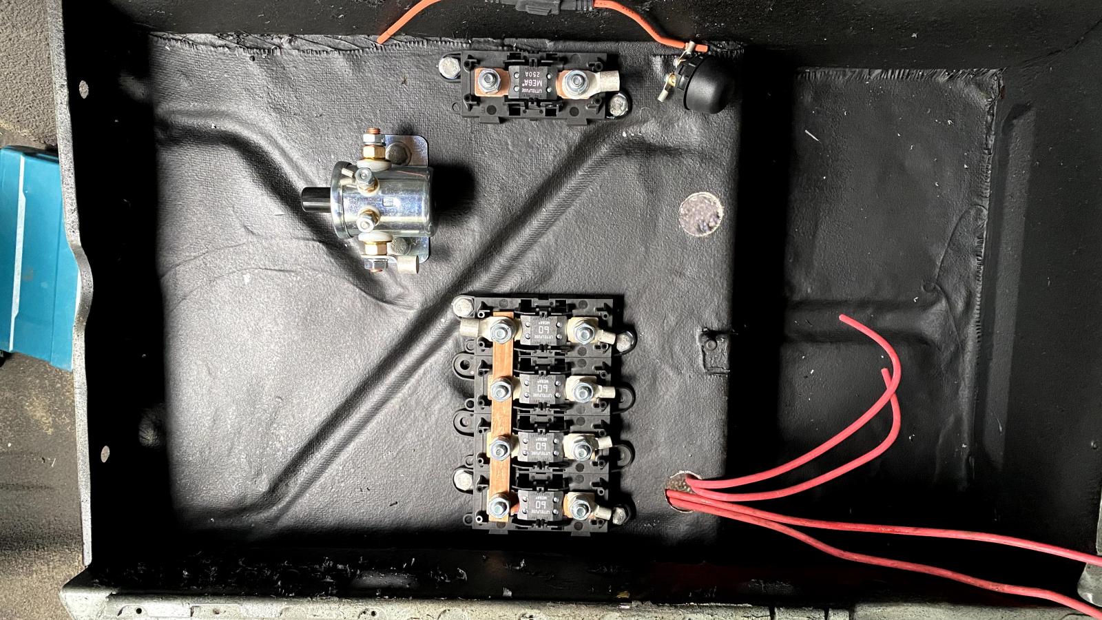

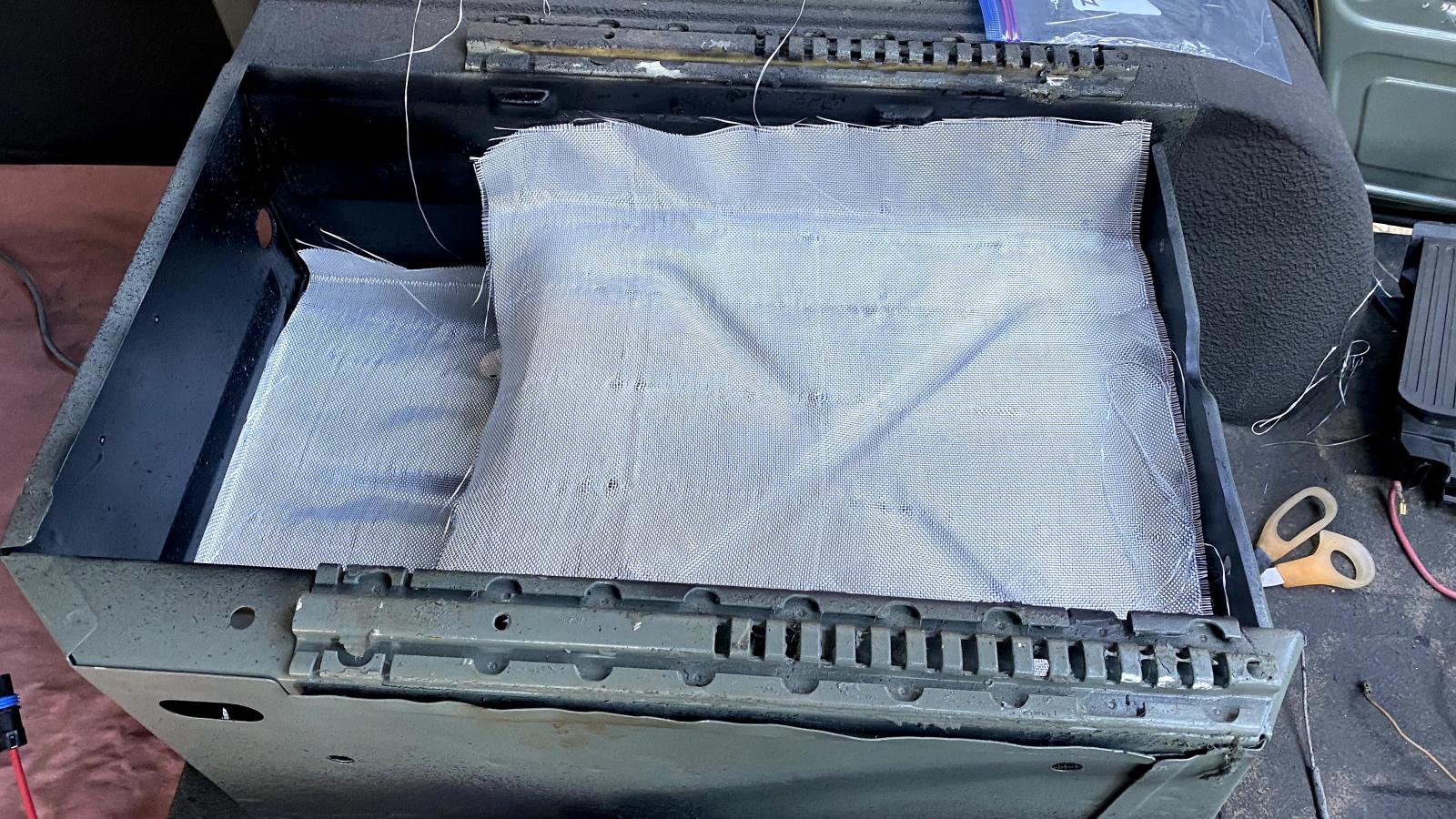

PostPosted: Tue May 11, 2021 11:29 am    Post subject: Re: 1981 (@wileythewesty) TDI conversion, from ground up Reply with quote
Started laying down the initial wiring for the battery box and the infinity box stuff.
rear drivers side behind the brake light:
passenger seat box (all fiberglassed and nice:
passenger dash above glovebox:

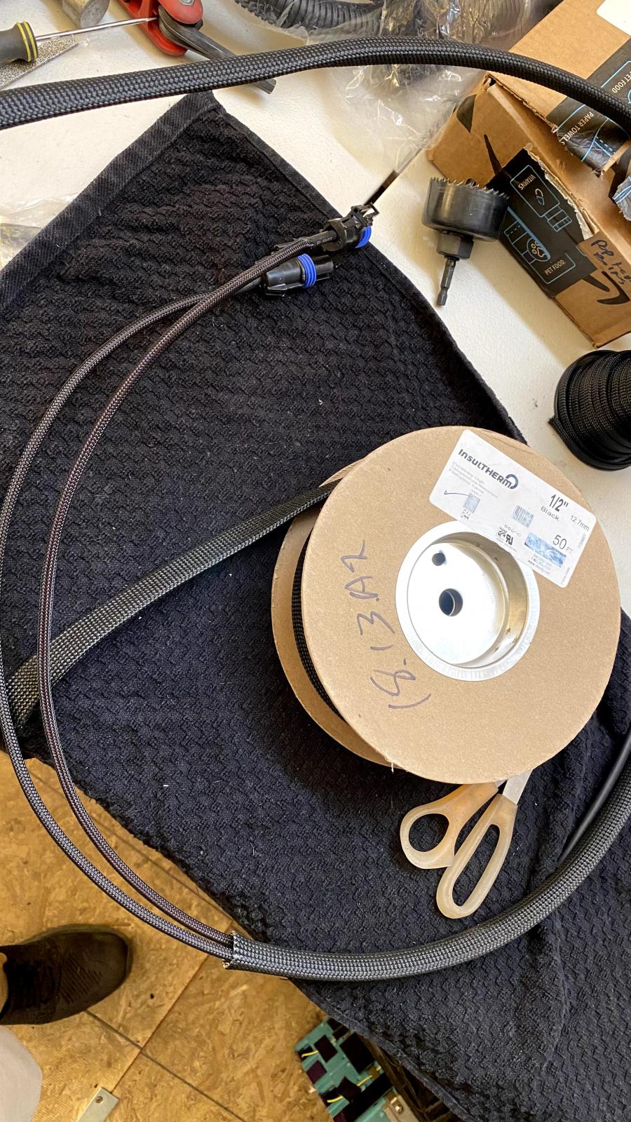

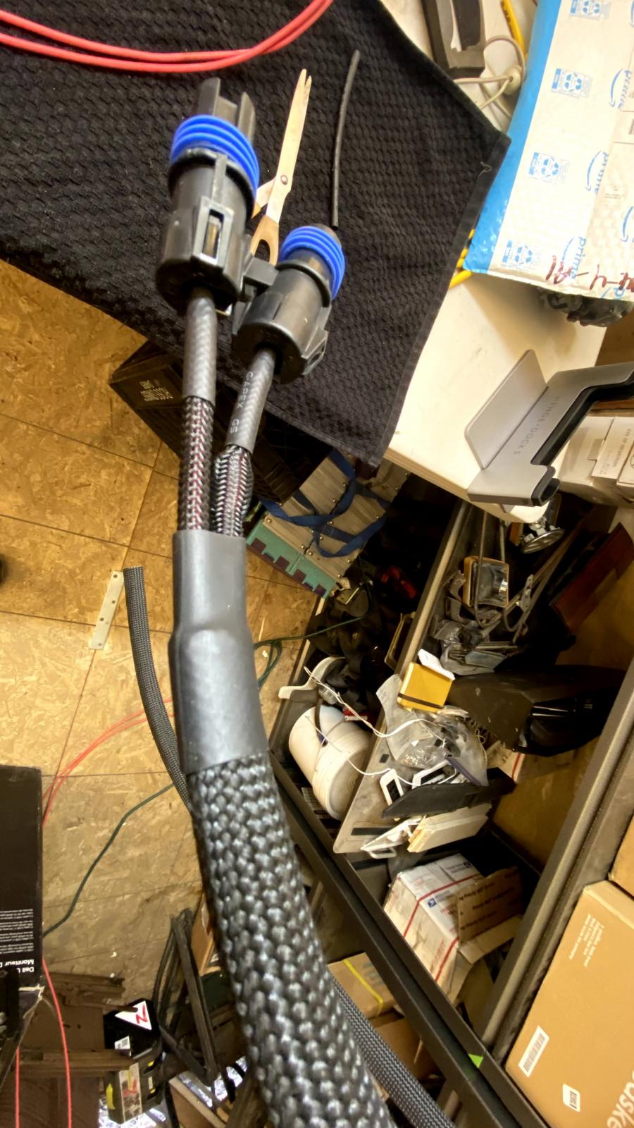

PostPosted: Wed May 19, 2021 8:12 am    Post subject: Re: 1981 (@wileythewesty) TDI conversion, from ground up Reply with quote
Took the single wiring run that goes front to back and did some prepping on it.
wrapped the 8ga infinibox power feed wires in a protective loom, and then wrapped that into a fiberglass high temp loom from del city electrical.
Making good progress here on the details of the electrical.
some pics:

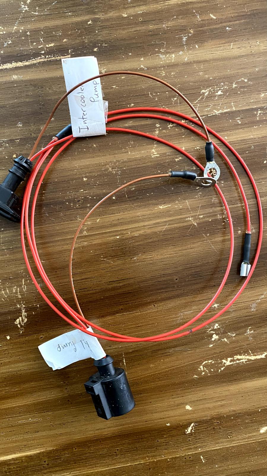

PostPosted: Sun May 23, 2021 4:10 pm    Post subject: Re: 1981 (@wileythewesty) TDI conversion, from ground up Reply with quote
Due to the different position of the Aircooled from the WBX trans, I had to cut my firewall and relocate the N75 sensor down on a different location on the firewall. I bought new silicone 8mm hoses to accommodate this:
Secondly, I was a little concerned with the ~18-22awg wires that came with the boxeer kit for the fuel pump and water pump,
Since I already rewiring everything, I decided to rebuild the connectors with 14awg. Greg assured me that max draw was around ~4amps. This 14awg gives me the headroom that I need.
