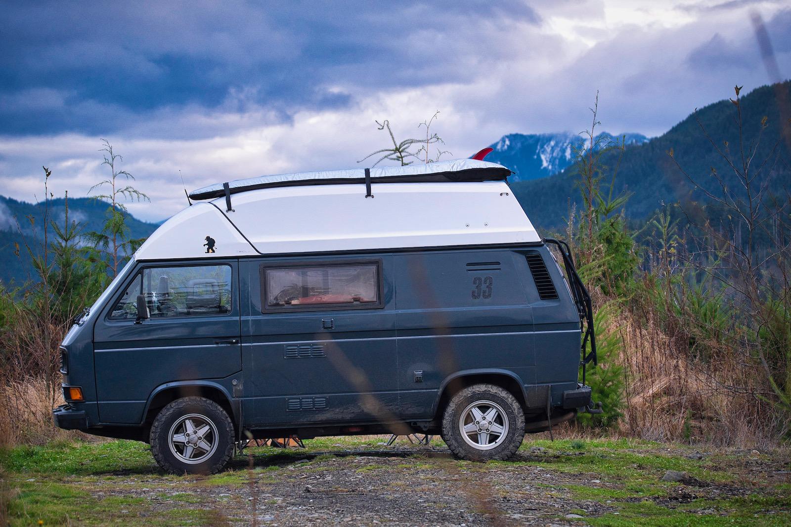

danbar wrote:
I have zero regrets about searching the world high and low to find a proper Zwitter roof (high top/pop top). It's great to be able to stand up in the van with the roof down, or to stealth camp, or stay warmer in the winter. Summer time is top up, windows open and tons of space inside. It's really perfect. Bonus, I can still fit through a 9' garage door with plenty of room to spare.
[/img]
I love this van. Cool

PostPosted: Thu Jan 07, 2021 9:36 am    Post subject: Re: Hightop poptop/ Westy top lift kit? Reply with quote
Sweet looking. Have any interior pictures you'd car to share? Curious.

PostPosted: Thu Jan 07, 2021 10:16 am    Post subject: Re: Hightop poptop/ Westy top lift kit? Reply with quote
For those who are curious, here’s the thread I made for my van when I bought it. So as to not derail this thread any further 😁
https://www.thesamba.com/vw/forum/viewtopic.php?t=618304&highlight=sca
