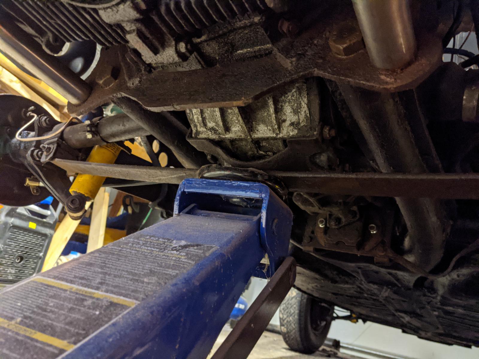

I recently picked up a dune buggy, not my first. I have never seen this on anything else. The ownership says 71, but it's a swing axle with a king pin front end. There is a single leaf spring that runs across the transmission and attaches to swing axles out near the brakes. Does anyone know what this is for?

camber compensator

This is an early dealer add-on. It was $35 in the early 60s. It helps you a little and the dealer more. Still nice to have.

As other have said its a "camber compensator"... If you want better driving performance replace it with anti-sway bar....

Camber compensator keeps your rear wheels from tucking in during cornering. Frequently added for "high" speed cornering.

They were a popular add-on for other swing axle autos... Corvairs and Triumph Spitfires come to mind....often sold under the brand of Camber Compensator.

I've been running one for many years...it definitely helps with axle lift and wheel tuck in hard corners.
I added some longer studs in the case this past summer when I had my transmission diff replaced. It makes it easier to install the piece that mounts to the trans case.

Never say never without proof... our dealership sold and installed them back in the day.
And they did offer some aid in preventing rear axle tuck. Lots of accurate detail available from knowledgeable people.

They were sold in the US for many years under the EMPI brand name.

Porsche installed a camber compensator on the 356 Super 90. I believe it was optional on non super 90 cars.
