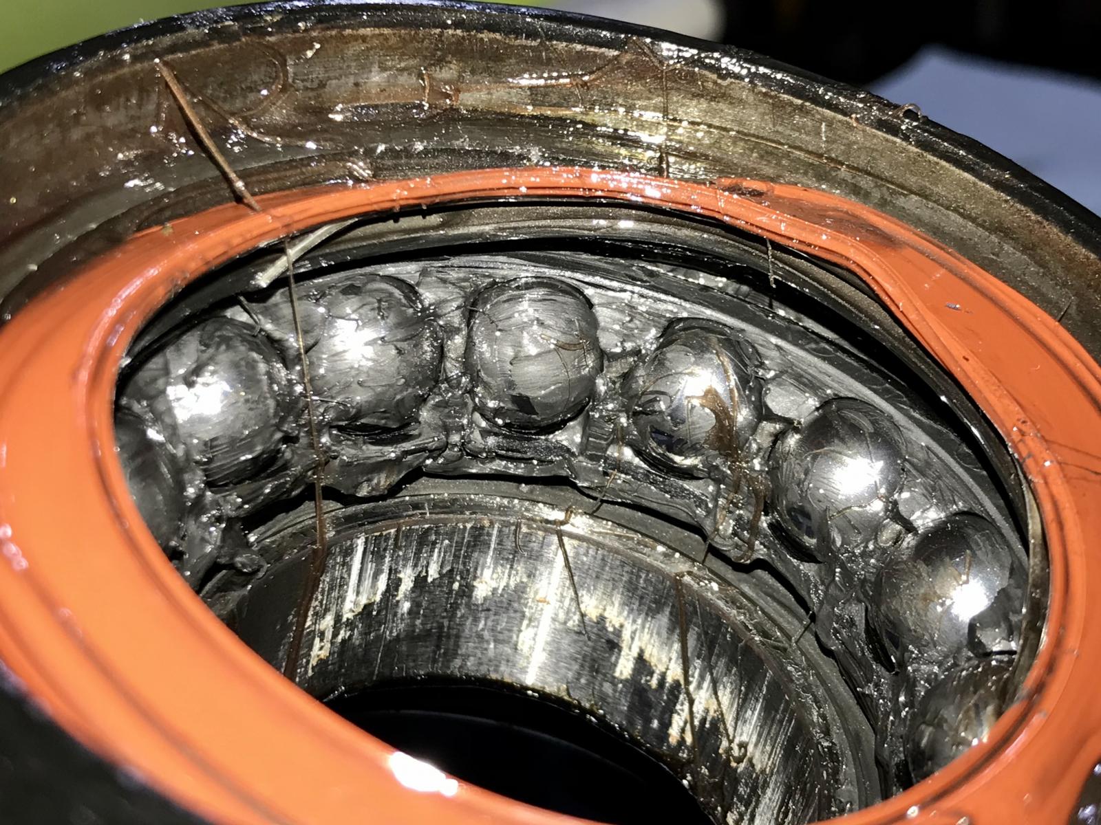

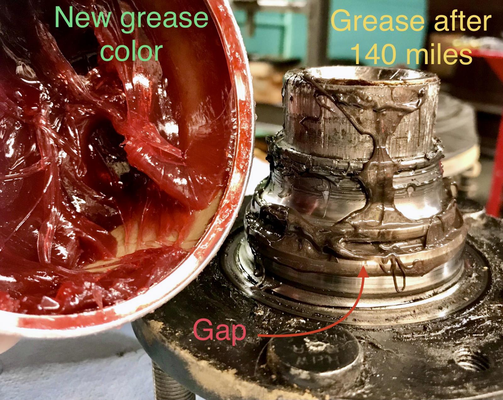

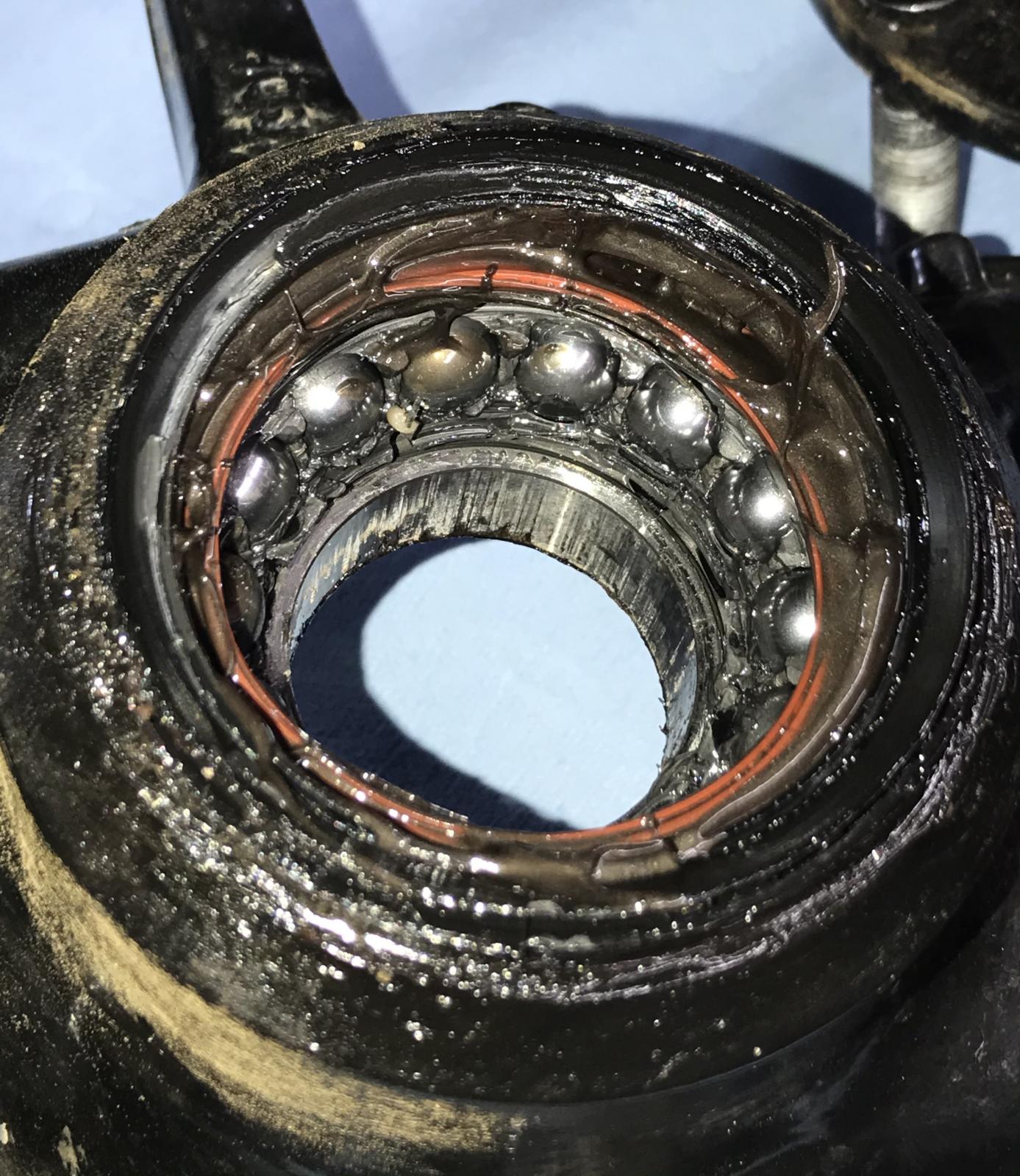

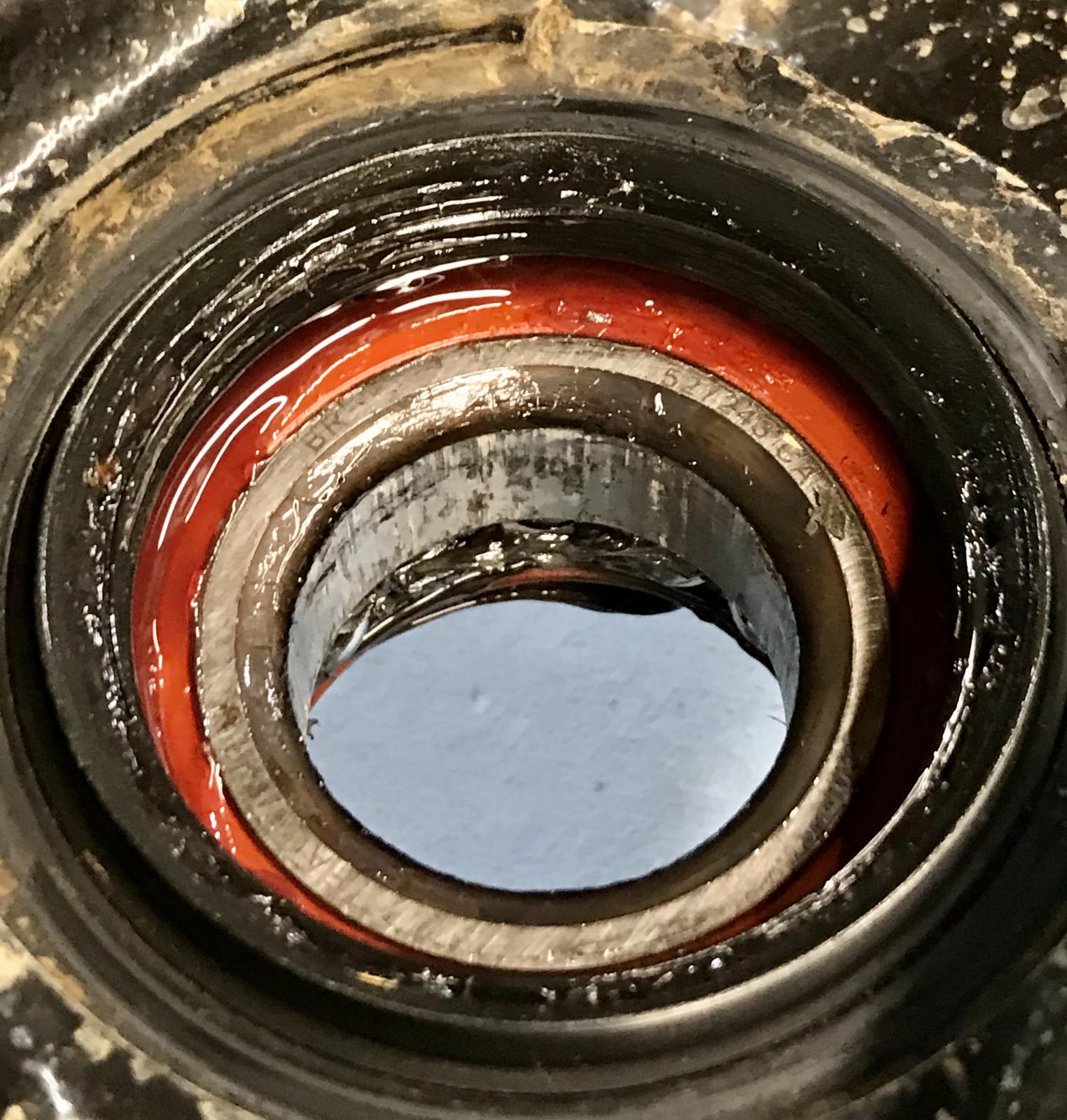

Alright, I just got back home and went ahead and removed the hub. Sodo, I considered trying to get some grease out by warming the hub and even trying to create a gap and using compressed air but it’s just too tight in there.
Anyhow, hub is off. It actually came off surprisingly easily with the press, which I’m not sure is a good thing or not. I can’t remember how hard the hubs and bearings were the first time around. The bearing is destroyed of course when removed.
I unnecessarily packed the outer sides of the bearings with STP hi-temp premium NLGI Grade 2 grease that has a dropping point in excess of 500°F. I really don’t know what all of that means but there it is. I was surprised to see that the grease on the outer side of the bearing had completely changed color from bright red to dark golden gray-ish. No idea if it’s from contamination or that the color changed because of temperature. There is about 140 miles on these bearings and just a handful of splashes in muddy puddles, nothing like a water crossing or sitting in water. The inner side of the bearing has grease that is still red.
I’m not entirely sure what to make of all this but here are photos.
Grease color differences (disregard the “gap” note, it’s actually the groove for the plastic bearing cage).
Grease color on inner side of bearing (still red)
Other bearing photos
I also just noticed that the inner race of this bearing is quite different than the one I removed a few weeks ago (image on left is a little stretched):

Sodo
Joined: July 06, 2007
Posts: 10597
Location: Western WA
Sodo is offline
PostPosted: Wed Jan 20, 2021 10:00 pm    Post subject: Re: Hot lug nuts and hub after Syncro front end rebuild Reply with quote
Are both bearings same width?
Kinda looks like bearing #2 ball tracks could be wider.
I’m not too sure exactly what you’re talking about. Bearing #1 were the ones I removed with the initial front end rebuild but those have long been in the trash.

the picture of the bearing balls under the orange seal is not good. abnormal amout of gray, which is metal. you've made the right call to take this back apart. just a guess but either the wrong bearing dimension was used or there was installation damage.
-dan

I’m surprised to see that much scoring on the ID of the one inner race. Next assembly freeze the hub before pressing. The scoring appears to be from assembly and disassembly, not from seizing.
Also, the side by side is interesting. You are making a sandwich when you assemble these. The tolerance is machined in and all parts must be the correct dimensions.

Did the bearings come pre-greased?
I ask, because judging by the pictures, there's way too much grease on those bearings.
Also, the grease you added may not be compatible with the the grease that bearings come with.
