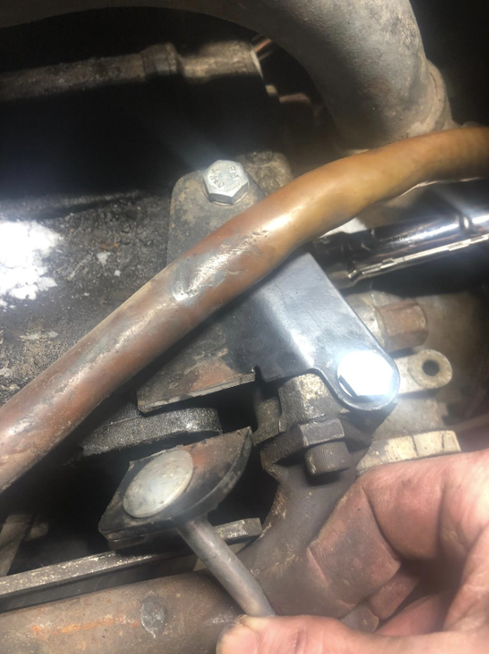

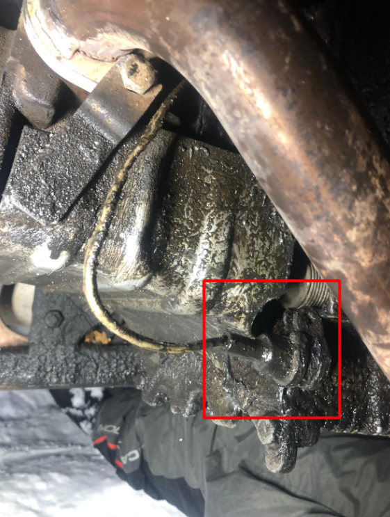

Update:
After retesting my spark, I didn't have one today. I replaced the coil ignition, replaced/cleaned ground from under coil ignition to left engine bolt and changed back to my previous middle distribution plug.
After crawling under the van to look over the fuel lines for kinks or broken wires, I discovered this mess:
Then after checking the right side fuel line that was under the alternator. I discovered that the bracket I bought last summer from a known company had broke, probably why my belt became loose, but I also never drilled out and fix the knobs that are supposed help support the alternator bracket: See below. The fuel line could have been kinked by the weight of the alternator on it.
Also any advice on a clean easy way to fix those support knobs or a replacement bracket. I don't have a welder with me.
Also within the messed below, I'm guessing this isn't supposed to be here?

djkeev
Joined: September 30, 2007
Posts: 32983
djkeev is offline
PostPosted: Thu Feb 04, 2021 5:52 am    Post subject: Re: Starting Issue: Running out of fuel aftermath 83.5 Vanagon 1.9L Reply with quote
Cheap & easy, never hurts ..... get new spark plugs and try it.
Sitting may have allowed some fuel to evaporate off your plugs so it fired.
Overall we are rather confused.
I have spark
I don't have spark
I have fuel
But the injectors in your video aren't spraying, do you have fuel?
I think the only thing we KNOW you have is possibly compression.
Yes, you've got a few questionable wiring issues that need sorting out also.
Time to focus.... fuel? Positively Yes or No?
Injectors spray? Positively Yes or No?
Spark at the plugs? Positively Yes or No?
Plugs are good and not flooded? Yes or No?
Engine diagnosis 101 type stuff.
All of that dodgy wiring isn't helping things either. It is to warm and Sunny today, clean that up and verify good connections.
Dave
Ghia
Vanagon
Beetle
djkeev
Posts: 32983
djkeev is offline
PostPosted: Thu Feb 04, 2021 6:06 am    Post subject: Re: Starting Issue: Running out of fuel aftermath 83.5 Vanagon 1.9L Reply with quote
Those broken Alternator Studs are going to require some finesse to get out and a bit of skill so you don't ruin your engine case.
Don't go blaming GoWesty for a crappy bracket. Without the other supporting fasteners in place you put that under a stress it was not designed to endure.
That O2 wire is a shielded wire, that requires some extra steps to operate properly.
Overall you need a warm spot and a couple of days to go through the maintenance deferred items and set this engine right.

That engine bay needs a cleaning before it can get worked on. Put a large drop cloth down. Get a catch can. Get a box of 12 bottles of brake kleen. Get disposable brass brushes. The issue with that level of dirtiness is that it can hide a lot of issues.
It looks like your starter has the starter relay mod. So that's a plus.
Are your cv joints cracked? The starter looks like it's covered in grease. Or did you replace them recently? And it looks like you have a major oil leak. Once it's clean you can find out where.
The white wire hanging down is, I think, a diagnostic port of some sort that isn't used. I think it's supposed to be bolted to the block behind the alternator. I'm sure Dan or Mark or any of the Daves will correct me if I'm wrong on that.

Yuch,
Someone added a relay for a starter problem. Likely a no crank hot problem. Here is what I notice. There is a smaller dangling wire red with a black tracer. I'm pretty sure it is supposed to be on the starter solenoid. It has something to do with providing power to the ECU? during cranking. I'd have to get my manual out and trace.
The wires on the hall distributor look terrible. Also, have you followed the brown wire in that harness? It needs to be grounded for everything to work. Good luck dealing with those alternator bolts. I watched a good video on you tube the other day on how to remove broken bolts.
Overall, I'm surprised you have gotten as far as you have. VW, did their home work. From what I've seen, I'd be afraid to run it around the block on a test drive.

MarkWard wrote:
Yuch,
+1 on that wire. It's supposed to go on a cluster of male spades on the starter solenoid, my van definitely won't start if it's disconnected. I don't think it matters which spade.
