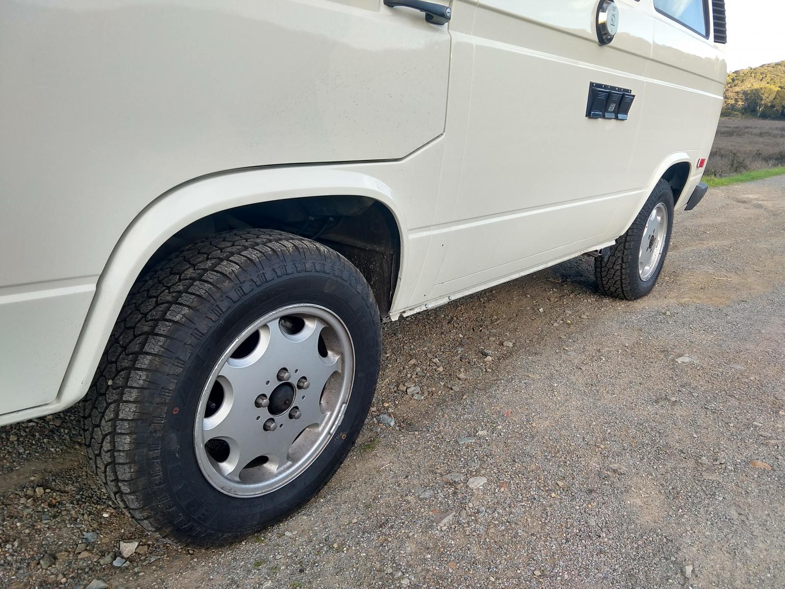

I just wanted to follow up:
I asked about tires a while back, and ended up with these Radar Renegade A/T 5 205/70R15XL 100H purchased via Simple Tire. They're pretty reasonably priced.
I've only driven a few hundred miles on them, but, for my 1.9, I can't believe the difference in performance and handling over the old BFG 215/75's that the PO had installed. Much better pickup, better handling in wind, less downshifting, and MUCH quieter than the old set. Best thing I've done for my van since buying it...
Other than fixing the frayed ignition wire that was arcing to the fuel pressure regulator, the fuel leak, the vacuum lines, the alternator, the coolant pipes...sigh. Smile
Hope that this helps someone from going down the same 15" tire rabbit hole that I did.

Regarding: BFGOODRICH® ALL-TERRAIN T/A® KO2 215/75R15
dobryan wrote:
I have them on my '87 Westy. Love them.
But I can get rubbing from the front right if turning and compressing the suspension like going onto a steep driveway ramp. But this only happens rarely and overall I am very happy.
I get a seldom "zzzzziiiiipppp" on the Tintop on driveway ramps but never on the Westy. Confused Confused
Californio wrote:
They get noisy after 15K miles or so. Best when fresh.
That's been my experience too.
But I also had cupping, for some reason (alignment?) and perhaps that's the noise of cupping.
Other than that I like the ride.
FROM BFG WEBSITE: BFGOODRICH® ALL-TERRAIN T/A® KO2 215/75R15 100S RBL
Mileage Warranty 50,000
Rim Width 8.5" on 6.0"
Overall Diameter 27.7(in)
Max Load, Single (lbs@psi) 1765lbs @ 50psi ----> (5500 lbs/4= 1,375 lbs)
Revs/MI 751
Tire Weight 34.3 lbs
Rim Width Range 5.5-7.0
Tread Depth 15/32
Specifications 3PMSF M+S
215/75R15 KO2s are LOAD RANGE C
Does anyone know of a 215/75R15 that has heavier sidewalls?
......for a guy who drives fast on rocky roads?
And how much rougher does heavier sidewalls "ride" on the highway?
I confess I like the ride of the "Load range C".
