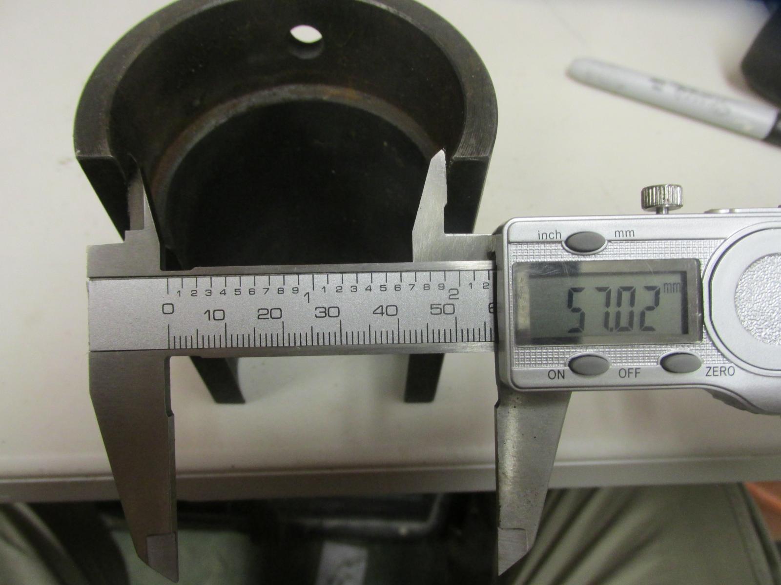

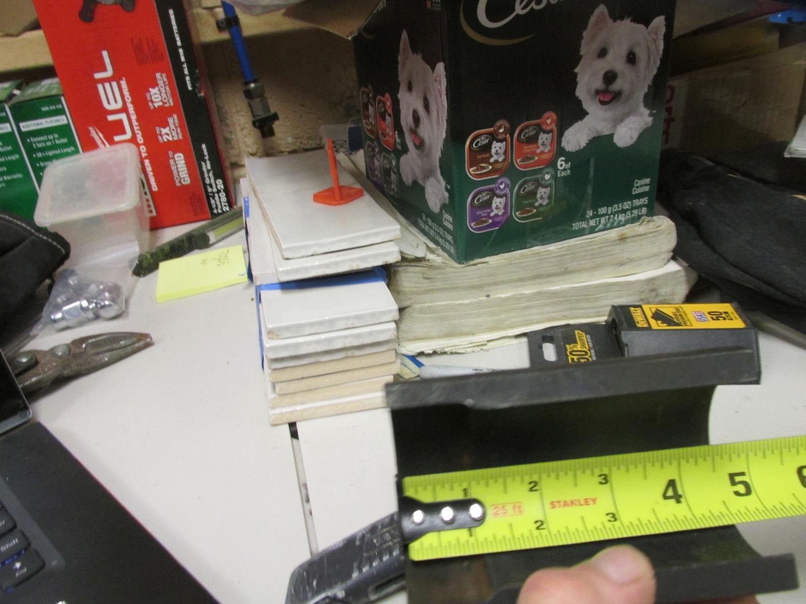

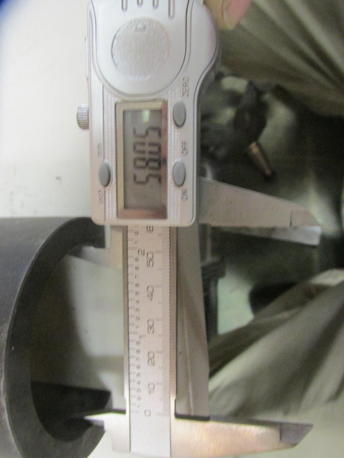

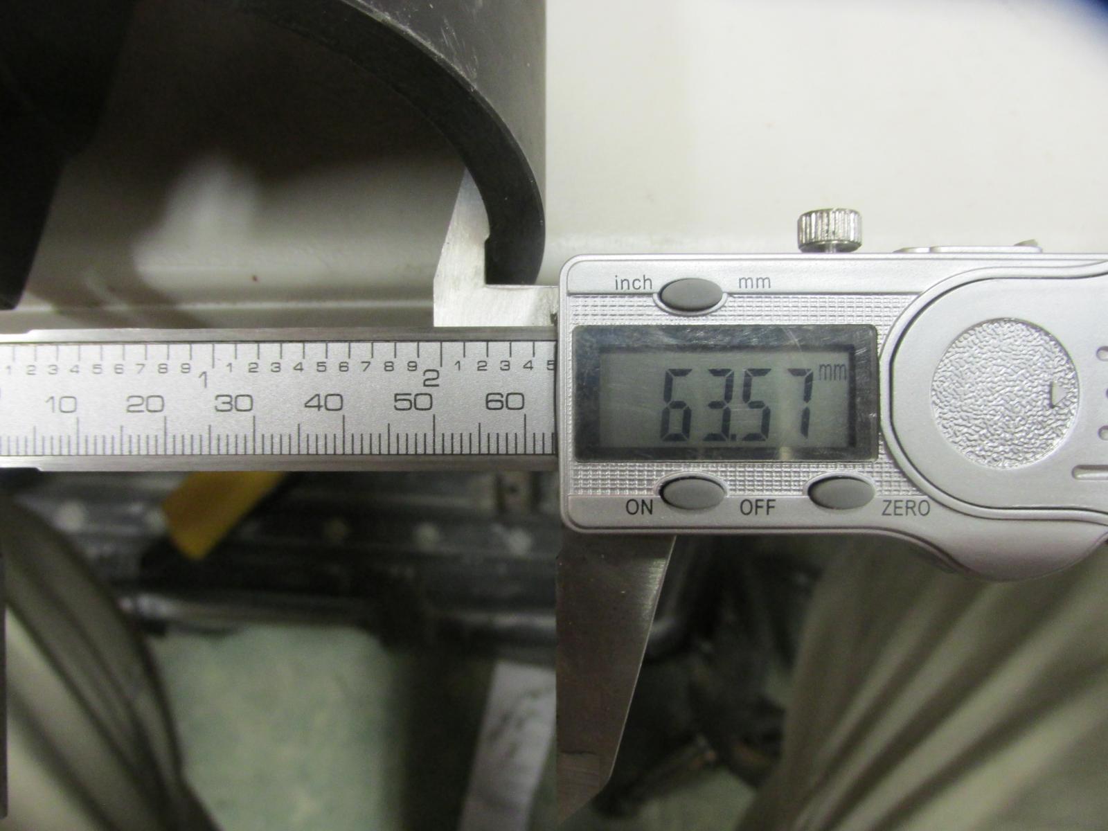

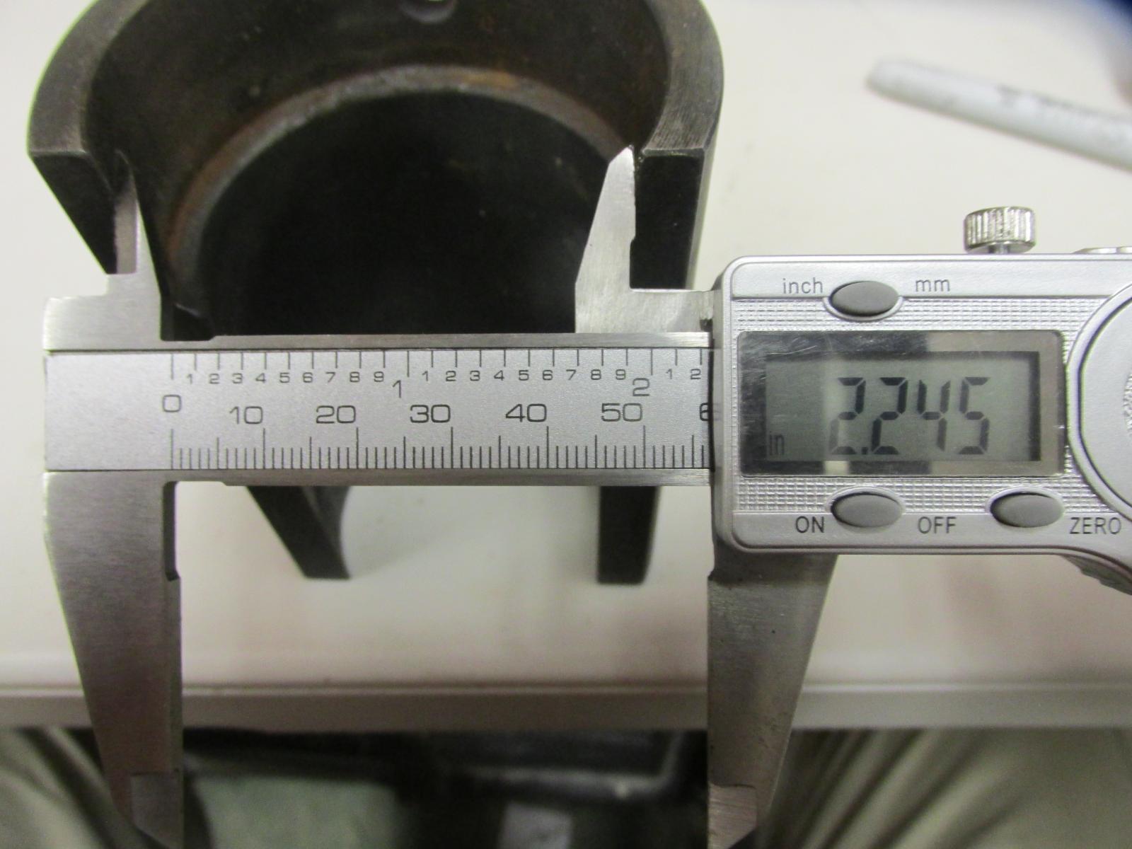

Here is my attempt at taking some pictures with splits on almost every finger tip. Not as easy as I thought it would be.
Overall length.
Outer.
Thicker inner.
Thinner inner.
This one might help too.
Do notice I held a few of those measurements at an inch. Hope it helps.
Dabaron, I have the tool and press and I'm not far. Feel free to get in touch when its time. I also posted some pictures on this thread, end of page one. https://www.thesamba.com/vw/forum/viewtopic.php?t=...mp;start=0

PostPosted: Sat Feb 20, 2021 7:33 pm    Post subject: Re: VW 3051 ball joint tool dimensions Reply with quote
this is really helpful, Gregg. thanks! i was thinking 2" black pipe was the same but this is way larger.

PostPosted: Sun Feb 21, 2021 8:51 am    Post subject: Re: VW 3051 ball joint tool dimensions Reply with quote
Here are the dimensions using a caliper. I did my best to get it centered.
Here are the thin side.
And I think Skills is correct that the cut out is important too.
Here is the cut out.
I'll double check that I got the pictures under the correct locations.

PostPosted: Sun Feb 21, 2021 8:52 am    Post subject: Re: VW 3051 ball joint tool dimensions Reply with quote
The first two pictures are the thick side.
