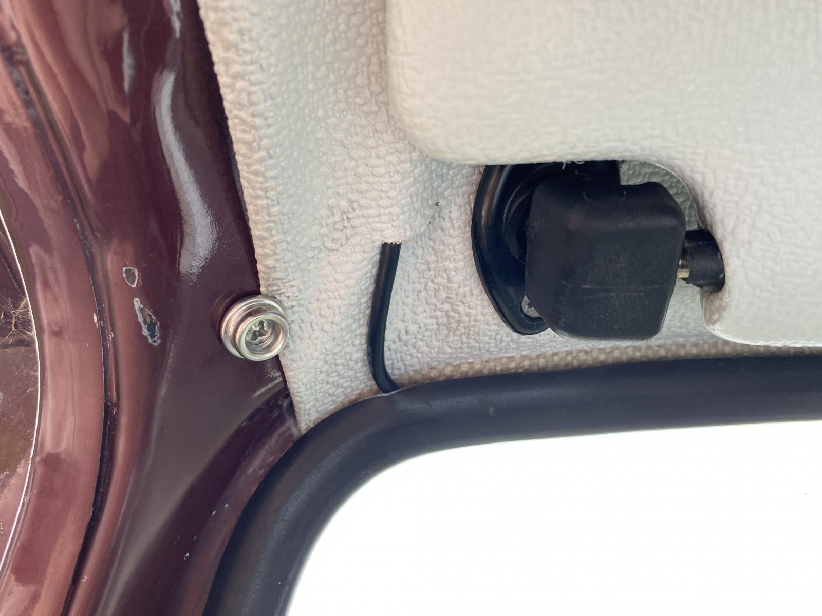

PostPosted: Mon Apr 19, 2021 6:23 am    Post subject: Re: Building a bus for travel in Europe "euroBus" Reply with quote
I added a rear/front camera system. (Thanks to Tom Hutch for the recommendation.)
https://smile.amazon.com/gp/product/B07XZ1D226/ref=ppx_yo_dt_b_search_asin_title?ie=UTF8&psc=1
This allows a virtual rear view mirror to be added to the standard rear view mirror. It is especially needed since I have blocked a good portion of the limited rear view with the cook box and will also have bicycles later too.
Here is the camera placement. It is off center but the image it gathers is fine.
The unit strapped to the rear view mirror. I ran the camera and power wires up under the windshield gasket so they are not visible. Notice how little view there is out the back window, and no bikes yet...
Power wires coming out the bottom corner.
Camera wires going into the headliner. It took me about an hour to fish these to the back. Next time I'll do this when I have the bus apart...
And driving image.
The other great thing is that this unit captures a 5 minute loop of front and rear video. If I am ever involved in an accident maybe I can use it to prove my innocence if necessary. This could be especially important in Europe where language could be an issue. (I hope never to find out.)

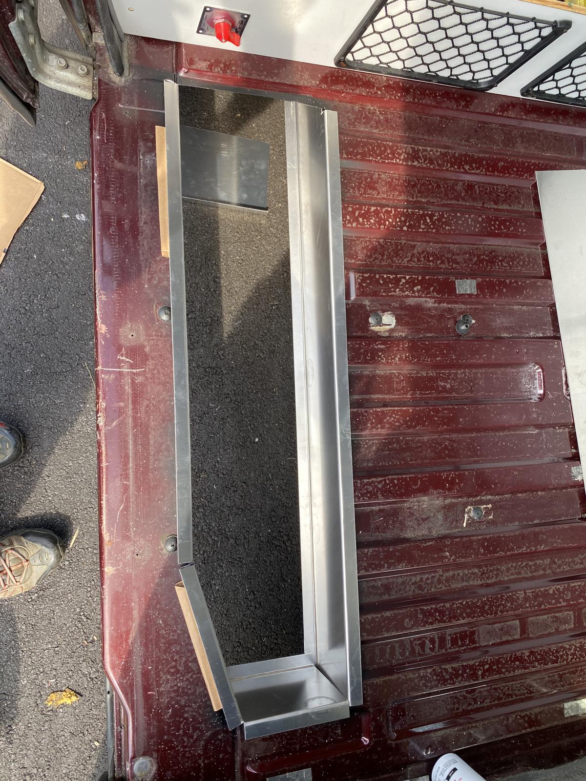

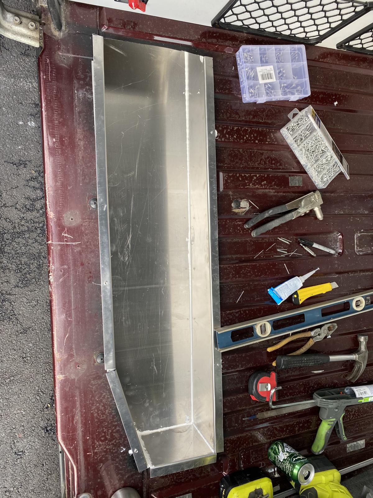

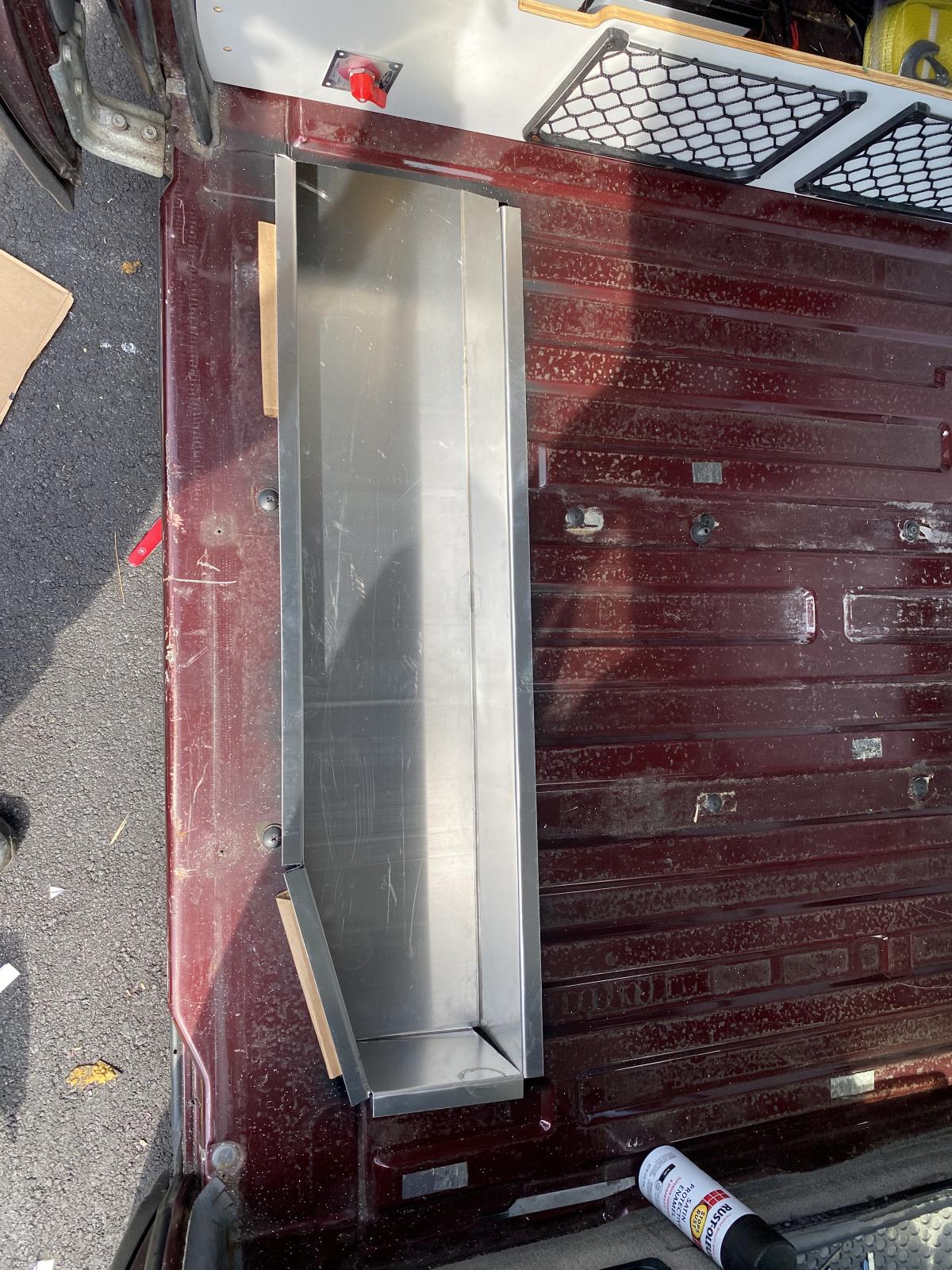

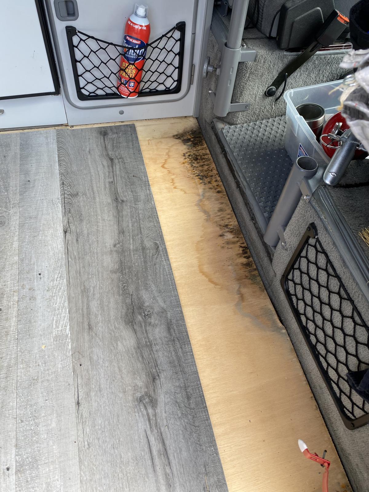

PostPosted: Mon Apr 19, 2021 12:46 pm    Post subject: Re: Building a bus for travel in Europe "euroBus" Reply with quote
And I finally started on the under floor storage bin. (I intend this for tools and parts that I hope to rarely have to access. This way I can save the under seat storage for camping and living gear. The other spare parts area will be the bin under the drivers seat.)
When I removed the vinyl plank flooring I discovered that untreated plywood was a bad choice as an underlayment. I will get 1/2" pressure treated plywood to replace this. (Obviously some water had been spilled in the bus and got the plywood wet...)
Nice clean floor ready for surgery.
Opening up.
Treating the open wound edges with rustoleum.
Test fit of the first 1/16" thick aluminum side piece.
Three sides sitting in place. (The rear piece will be placed on after the bin is created as it does not overlap the opening. The bin goes about 4 inches under the floor.)
And the bottom laid in place. The bin now needs to be riveted and 3M 5200 used to hold it together and weatherproof it.
The inside dimension is about 9.5 " wide and 6.5" deep. It hangs no lower than the gas tank or transmission so it should be fine. Basically the same as a propane tank.

Ambitious cutting! But great utilization of otherwise wasted space. How are you going to access it? 2 small hatches? 1 large hatch?
dobryan
Joined: March 24, 2006
Posts: 17122
Location: Brookeville, MD
dobryan is offline
PostPosted: Mon Apr 19, 2021 3:47 pm    Post subject: Re: Building a bus for travel in Europe "euroBus" Reply with quote
One large flush floor hatch. Lift off, no hinge.
Not sure what 'handles' I am going to put on it. I'd like to find something that can fit flush to the floor and then somehow pop up to grab.

very nice and an easy DIY method for those who can't weld
there are all sorts of options in the 'recessed latch' world.
some can even be used with a length of wire to a slide pin as a remote operation.
https://www.google.com/search?q=recessed+latch

PostPosted: Sat Apr 24, 2021 7:28 am    Post subject: Re: Building a bus for travel in Europe "euroBus" Reply with quote
And I assembled the storage box.
I will need some spacers for the side closer to the slider since that part does not have the ridges that are in the center portion. Fortunately some leftover jalousie window pieces that are cut off when I do a conversion were just the right thickness.
I pop riveted and 3m5200'd it together.
Now I'll start working on the floor and hatch.
