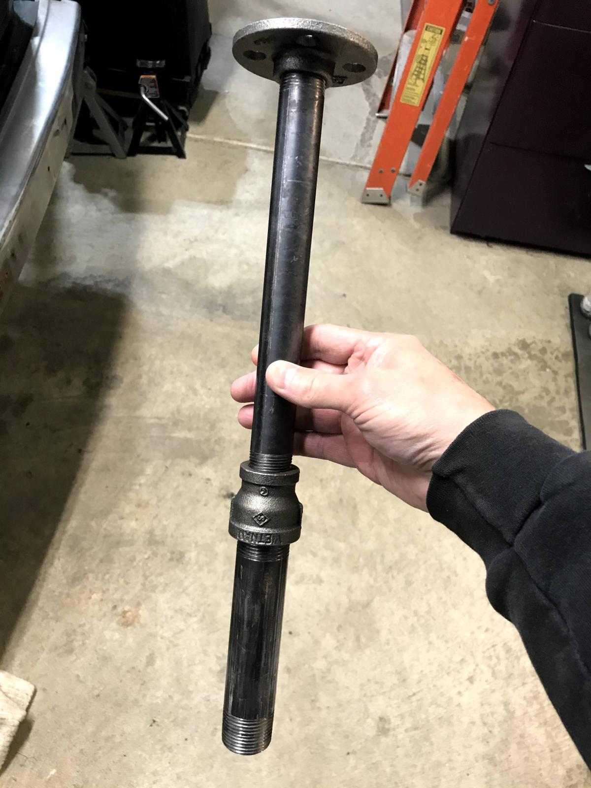

first of all, thanks to all the contributors. super helpful in keeping my vanagon running.
$13 of black iron pipe from local hardware store:
3/4" flange
3/4" x 10" nipple
3/4" to 1" coupling
1" x 6" nipple
cleaned protective coating using soap and water. may paint.
clears the cabinet and allows full recline and rotation of the seat.

Slick!

Now that's clever!

i would hit it with a bunch of clear coats, that looks fantastic!

Steam Punk look.

Self defense tool too!

Good idea but the site safety officer in me would maybe add some grip tape to the top to prevent a damp shoe or foot from slipping off during upper bunk mounting/dismounting acrobatics.

I like it. Just got back from a couple days camping and would like to find a good option such as this to facilitate the somewhat laborious task of climbing up and down, especially for my shorter companions. This gives me some great ideas.

if you slip on that at night and catch your shin on it, it's going to really hurt.

To appease safety officers, one could very easily screw in a small wooden plank to that top flange for a broader place to step on and not slip off. It could even easily be made removable when not in use.

Is there a good hardware store spray paint available that is a close match to the factory grey?

And easy way to bring a color sample into a store is to remove the van's door slider cover. It's only 2 screws.

Brilliant! Thank you. I have some extra black pipe laying around. Cleaning it up and painting is definitely going to be needed.

I use this as a close match to the interior gray paint.
Rustoleum Satin Granite
https://www.amazon.com/Rust-Oleum-249078-Painters-Purpose-12-Ounce/dp/B002BWORWM
And if you want to cover something dark like that pedestal I recommend a coat or two of white primer first.

very cool and am curious, why not just a 1" piece of pipe with a 1" flange rather than the coupling/reducer?
