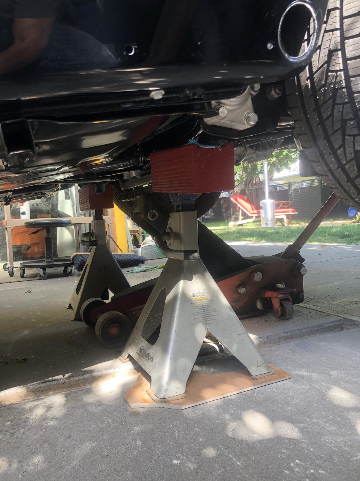

Just to give an idea what it takes to jack this car up (or down)...
First, pray the welds hold and side-jack to get a couple 2x4s under.
Align (three or four times) the special bracket and pump the teeny-tiny-est strokes ever.
Use some broken tiles as shims, and align a few times as these come home.
Nice fit up front here, eh?
Notice required block of wood - otherwise the apron becomes the jack point.

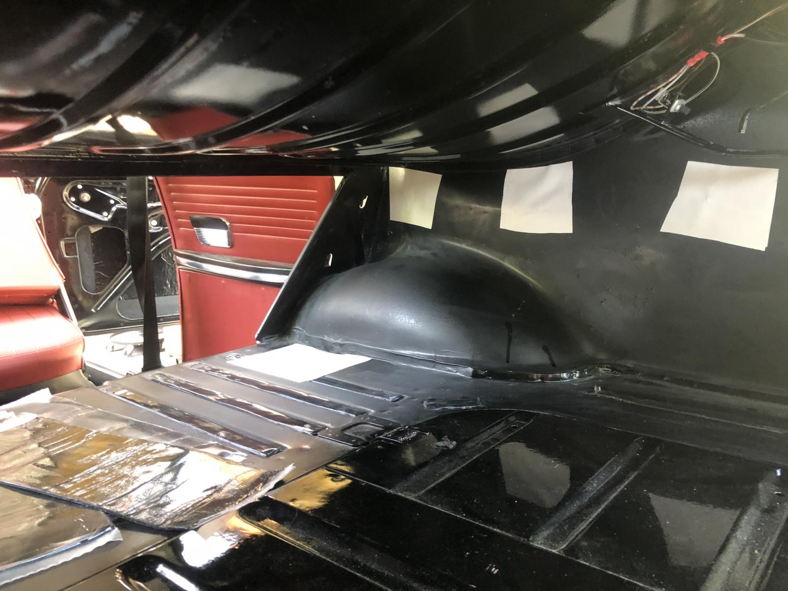

Another long day out there yesterday..

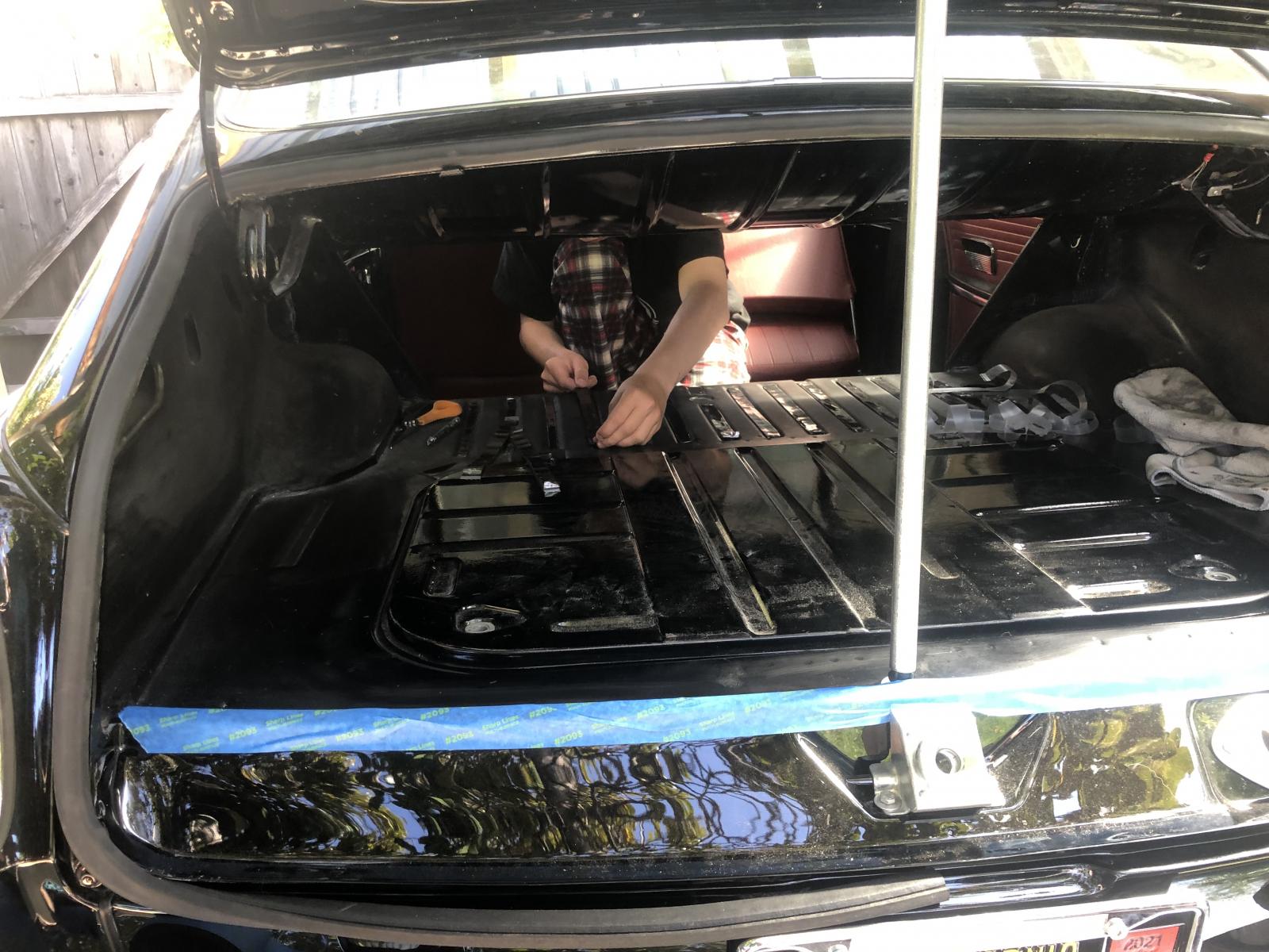

Started in early on trying to get the rear trunk area ready to show.
Can't believe how many different kinds of insulation i have around here these days..
In front is what they sell at TMI, behind that is traditional thin carpet pad and next to that is RetroMat.
All of this stuff has the advantage of being light weight.
Then there's two different kinds of this; Mass Loaded Vinyl (MLV).
Both the heavy/sticky squares here and also a big sheet of stiffer stuff.
Both of these are Heavy, adhesive backed, and black in color.
This stuff better help, because i really don't like just adding weight to the car like that.
Have just a square of similar crap stuck to the inside of the doors,
but here I'm a goanna line the whole 'powertrain compartment' with this heavy, gooey expensive stuff.
Sure as hell hope it helps.. Costs -and- weighs a ton. Evil or Very Mad
Little brother helped me for a couple of hours trimming and gluing down scrap pieces of vinyl.
He also helped cut insulation and sandblasted and whatnot.
Warms my heart, because he's not really a car guy like his brother, just wants to be helpful.
Heart of Gold, this kid..
The factory glued these squares over the bolt holes, so i did the same.
Not really sure why.. Confused
See also hours of lying on my back in there with a rag soaked in wax/grease remover.
Years of sanding and buffing grit were everywhere up under there.
Big brother (sorta) helped trim the TMI thick foil stuff.
Had one piece left big enough to do the rear deck.
Because the engine hatch sits up 'proud' of the rest of the deck,
This thick stuff evened the whole rear area out.
He wasn't much help really.
Whined a lot until i gave up let him go and play video games all day (again).. Rolling Eyes

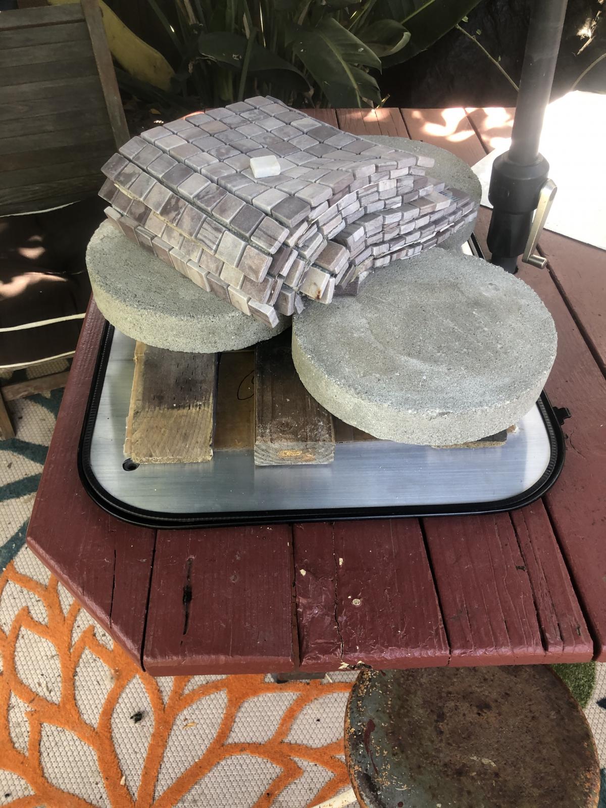

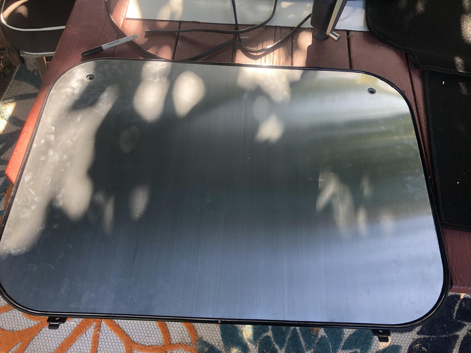

Ian the polisher finished a piece of sheet aluminum for me.
It woulda cost hundreds to have it shined to a mirror finish,
But this brushed, even scuff works well for a hunnert and a half or so.
Brightens things up..
Found a piece of c-channel seal used to trim the sunroof on a 944.
It meant i had to (carefully) take the perimeter of the aluminum piece down 1/8" or so for it to fit,
but it will finish off the underside of the hatch nicely methinks.
Unlike that heavy stainless piece tried before,
this one will get panel-bonded into place, so no fasteners will show.

Then, he dug in to scuffing with Scotch-brite, then wiping down with wax/grease remover, then some carb cleaner on a clean rag..
Strips of the gooey MLV where cut 1/2" wide and laid into the bottom of grooves,
Then more strips .800" wide went in over the top of those.
That fills all of the stamped grooves so anything going over them later lays flat.
Since this stuff is gooey and would follow the ribs, those ribs would show through the carpet.
So these little strips fill in the low areas.
Peeve of mine when you see the embossed ribs thru the carpet..

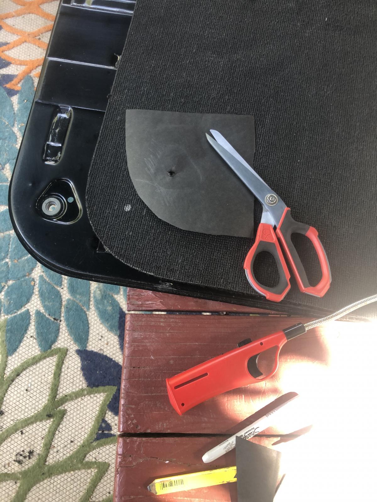

I spent the whole last day and a half on making this TMI rear trunk carpet "kit" work and fit.
Especially those rear wheel 'hump' covers - those were just pieces of carpet.
Not sure what you were supposed to do with them, Rolling Eyes
But i made several pie cuts to try and get them to sorta lie in place.
Hopefully those wrinkles from sitting folded in a box for years will settle out.
Think maybe lie it all on the sidewalk in the sun for a couple of days? Think
On the back deck..
Strips of MLV,
Whole squares of MLV,
Thick TMI foil carpet pad stuff,
Carpet
PITA working way up in there, and not really the best carpet job ever, but what's done is done.
What's done is done... Cool

Big assembly push continued over the last couple of days..
Taking a rubbing to make a template to trim hatch carpet.
Panel-bonding my decklid liner into place.
Using a steam iron to get wrinkles out of carpet.

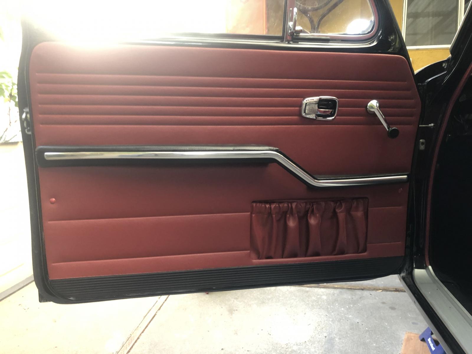

Started in on assembling doors.
Got one done.
Getting down to the wire,
Only a couple more weeks to go! Anxious

I sure hope Trevor is on to something here..
This prop rod deal just sucks and blows! Evil or Very Mad

Those red buttons look spot on, on your door panels.

VWporscheGT3 wrote:
Clatter wrote:
Max Welton wrote:
Wow. I also had this problem!
Max
Embarassed Embarassed Embarassed sorry I got home and forgot... I wrote it on my hand this time and I'll post up
Ok here they are
You're showing the correct way, right?
Max
Damn Straight! Cool
Goes good with my dash pad and sunroof crank stuff.. Wink

Max Welton wrote:
VWporscheGT3 wrote:
Clatter wrote:
Max
Ok here they are
Max
The man's a genius.
Far smarter than myself... Embarassed
Should have consulted scripture...
Can't WAIT to just open a decklid like normal again!
Much thanks to Trevor for catching this one.

Max Welton wrote:
VWporscheGT3 wrote:
Clatter wrote:
Max
Ok here they are
Max
Yes sir. I had installed it the same way clatter did before and I had the same issue you guys had.. after seeing some unmolested rust bucket pictures I found I had them backwards. This way the trunk lid actually stays up and works flawlessly.

PostPosted: Thu May 13, 2021 7:22 am    Post subject: Re: Black Fastback Build Thread Reply with quote
WHooHooo!! VICTORY!!
Can't tell you how NOT stoked i was to struggle with that prop rod for the rest of my life with this car..
Something else that comes after doing things multiple times..
See the tool they use here in the Bible?
Just when i was all about to make one,
It came to me!
A tire iron for a motorcycle works just the same.
The little hook on the end is perfect. Cool
