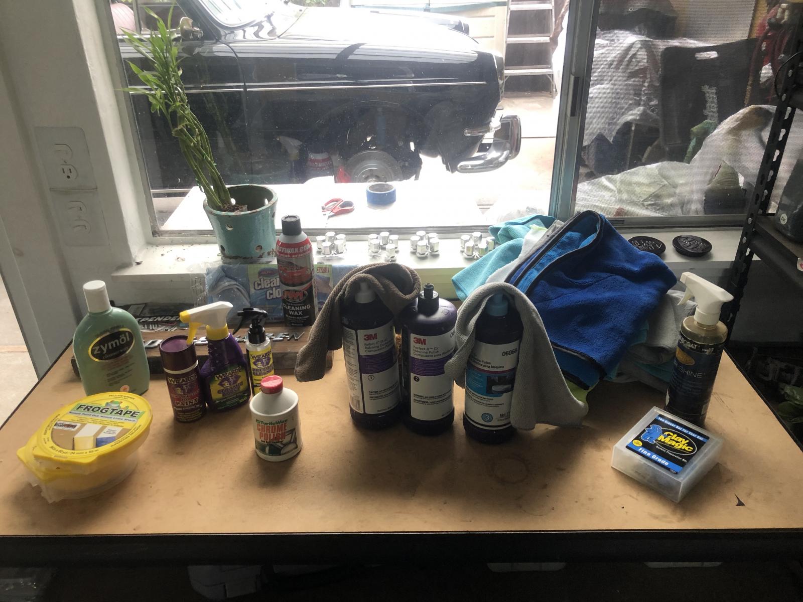

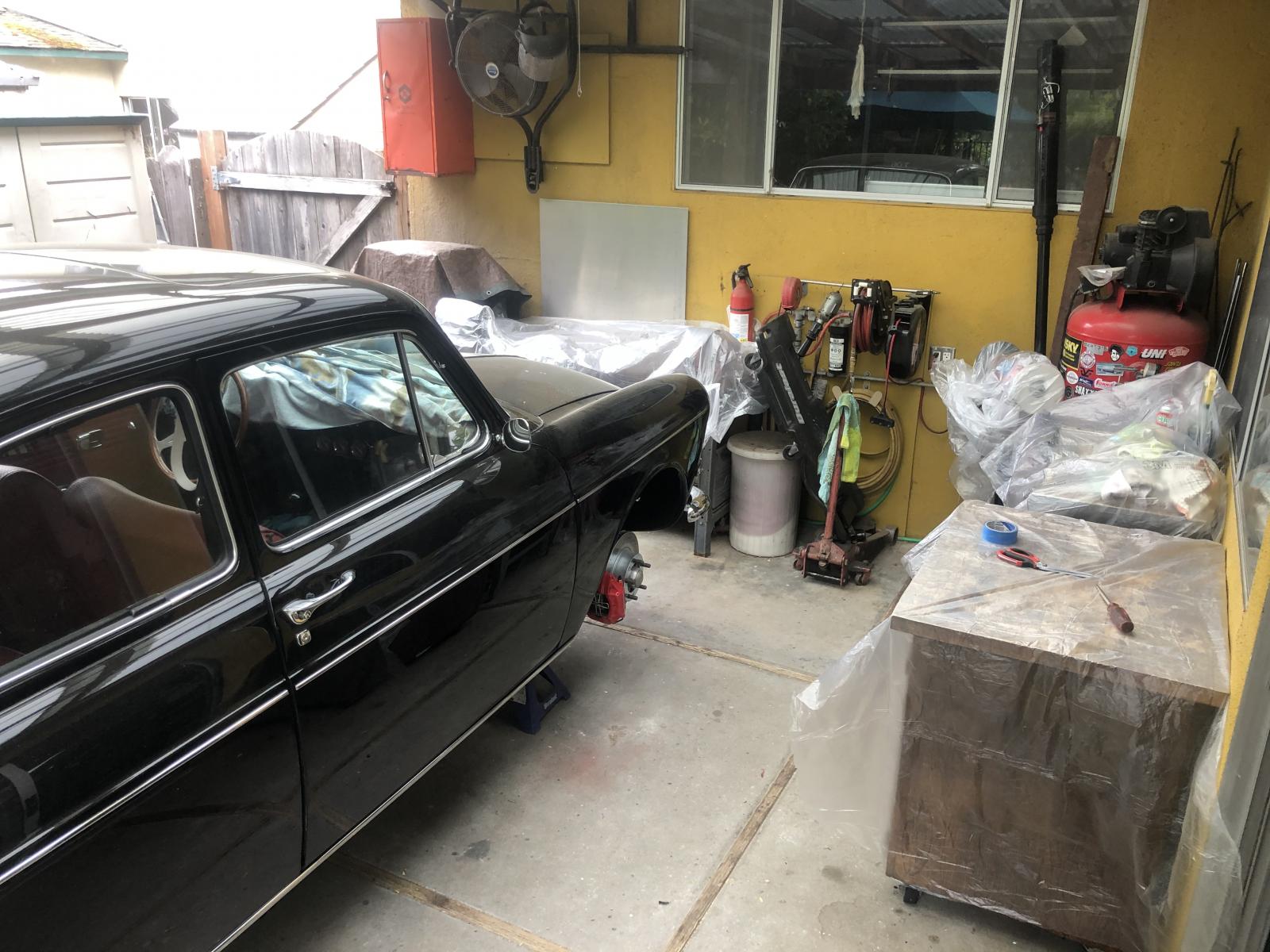

Day before yesterday Wences said he could come by for one last time.
Spent the morning getting things ready.
He said he wanted to pressure wash before the final buff,
So i got things put away and covered up.

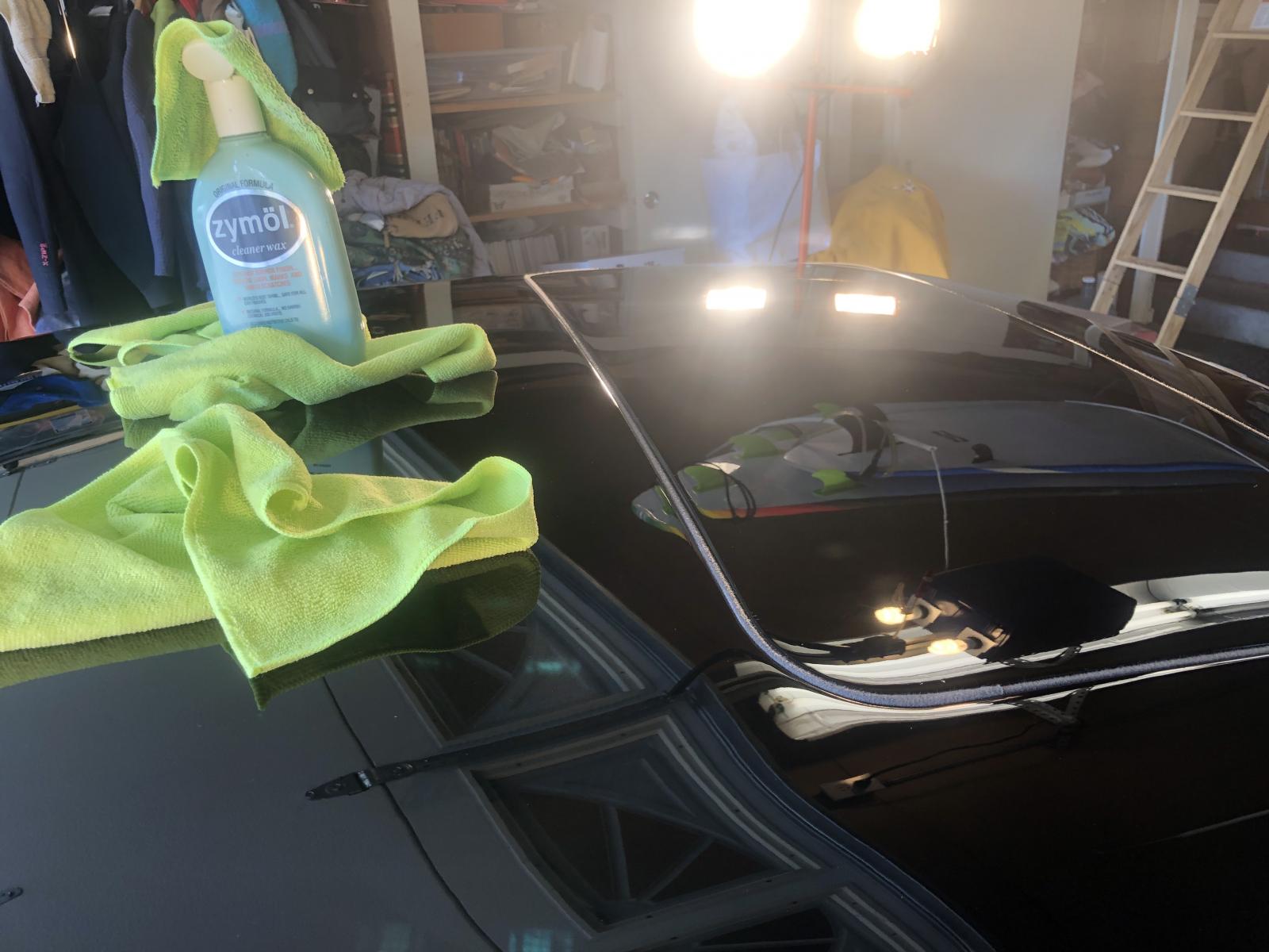

Also got out all the wax and buff stuff.
He used the three 3M compounds and the Zymol and that's it.
He considered that ceramic stuff a fail, as well as this black wax i got too.
We tried all of these other products and more, but the Zymol wins hands down.

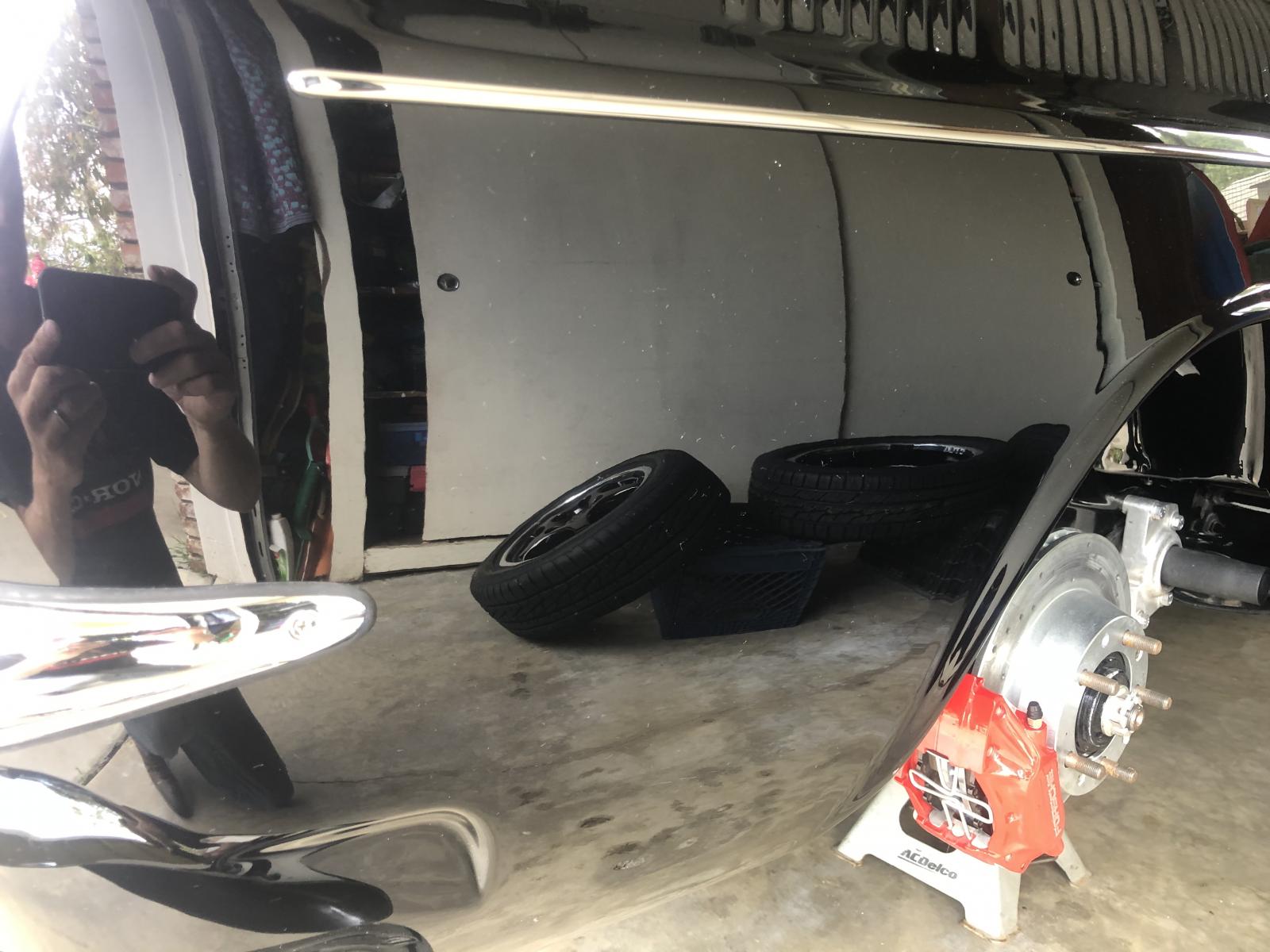

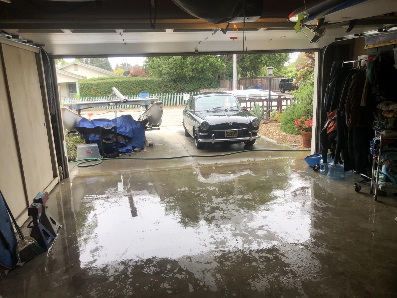

Turns out he wanted the car on the wheels out in the grass for pressure wash,
So we stabbed the wheels on with a couple old lugs.
Mailman hasn't brought my stock long tie rod yet, so it all went back together temporary-like just to move.

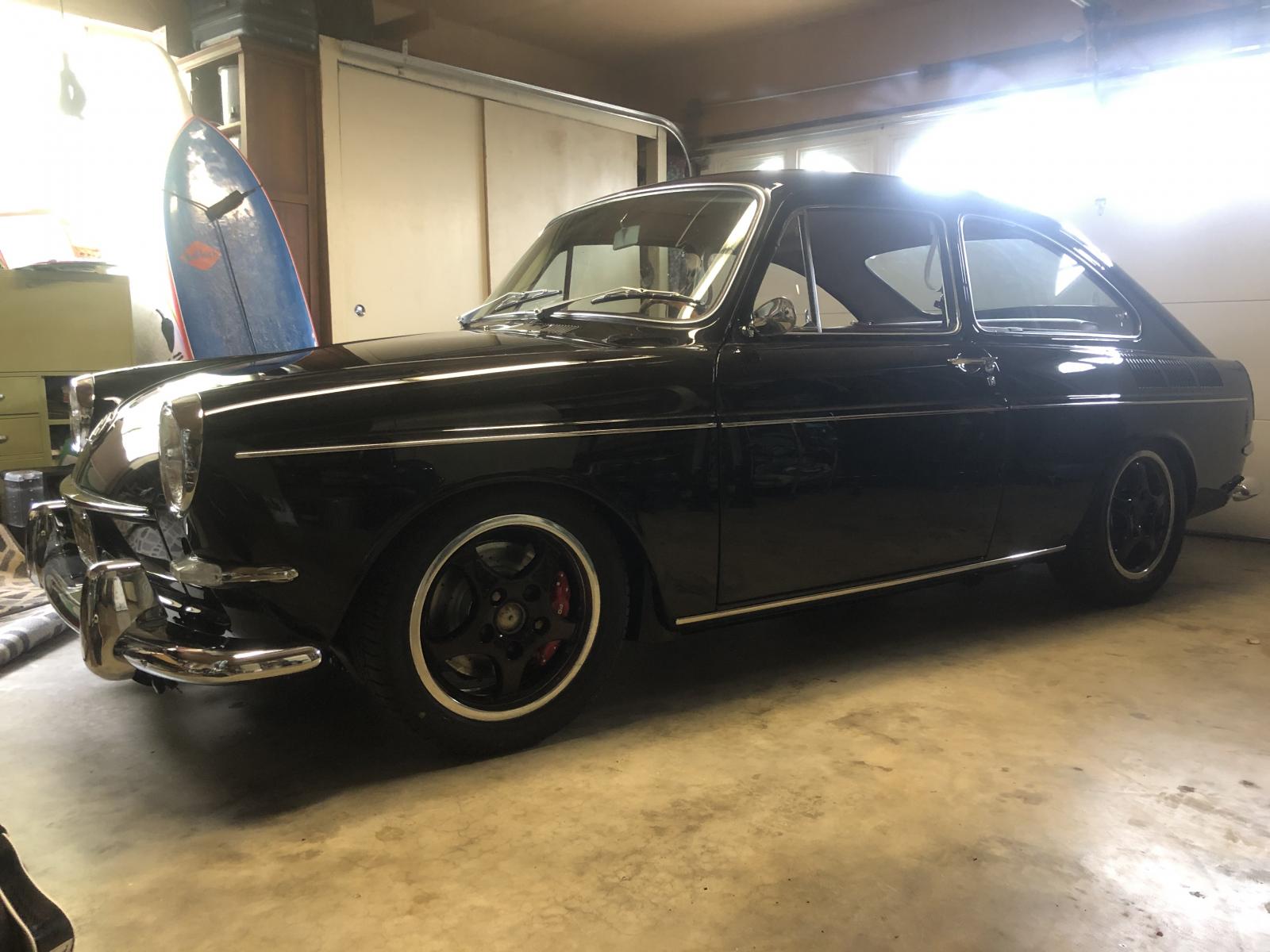

Was pretty cool to see it 100% together with it's first wash on. Cool
Took a bunch of pics but we'll spare y'all.

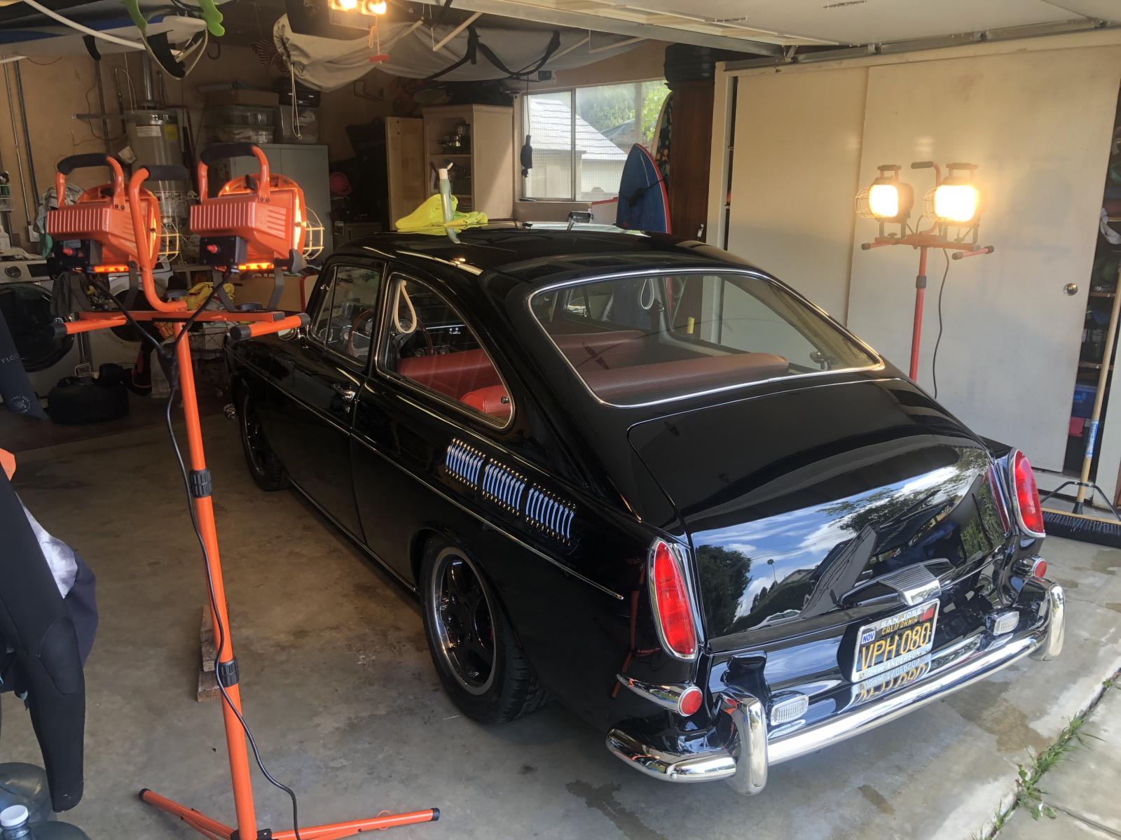

By the end of the day i had gotten the two other cars out of the garage and this thing in.
Hard when pulling it around to not go take it for a rip,
but with only two lugs each wheel and a tie rod smacking a fuel fitting that might have ended poorly. Rolling Eyes
Now the job is to give it a hand wash to remove all of the buffing compound,
And then a hand wax with Zymol.
Then comes the llooonng task of detailing the wax and compound out of all cracks/crevices..
Then back up on stands, wheels off, in the garage for doing all that same detail work underneath..

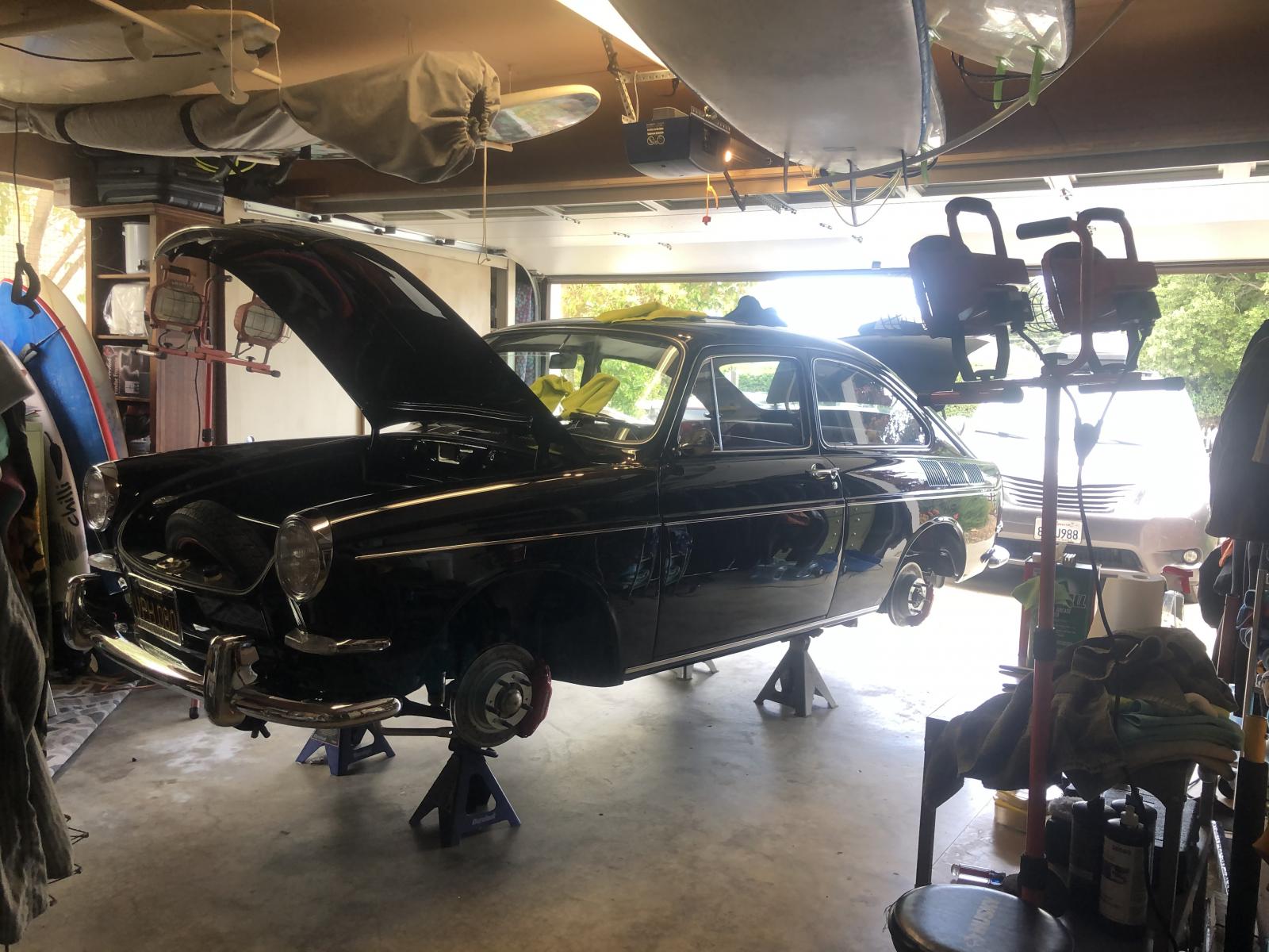

Washed the car outside in the driveway,
Then drove it in for drying.
Waxed the roof and sunroof while it was still low and on the ground.
Got it up on the stands and wheels off
Man! It’s SO nice working on a flat level pad! Shocked
Smooth and easy.. Jacks and creeper just roll along..!
Trick i learned from my Dad.
This stuff used to be called Wesley’s Bleche-White.
“Gets the whites white and the blacks black”
Made even these new tires look way better.
See the brown stuff being washed away here..
Got things dried off (water spots are the enemy at this stage)
Started in polishing top surfaces,
And chasing any white buffing or polish grit from crevices.
Stuff really pops when it’s polished.. Cool
Quite a good time at this point.
Just a few more details,
And hours of wiping..

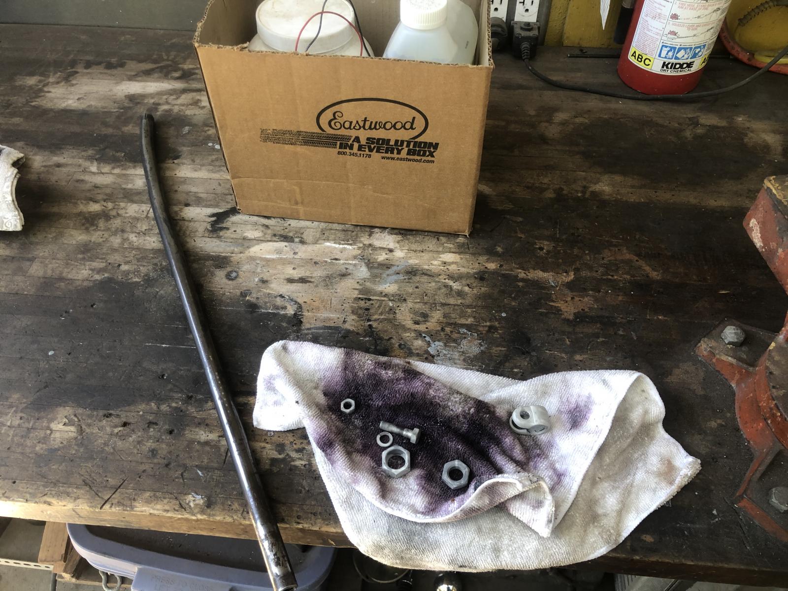

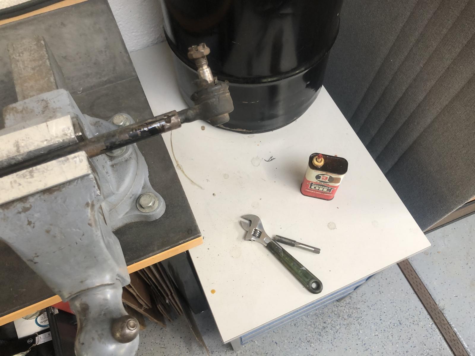

Got a stock tie rod from Joel cleaned up.
Scraped off the undercoating, couple rounds of paint stripper.
Got it up under the car for marking a couple of slight bends to clear my fuel fittings, and also shortening,
Brake/spindle combo needs shortened tie rods..
That means tapping deeper and moving the divot and slit as well.
Wire wheeled/blasted/plated fasteners.
Front hub caps looked like shit after welding and the zinc coating had failed.
Got 'em pulled off, gas bath, blasted for tooth, and some JB Weld.
After a night's drying, they'll get sanded and go with the tie rod to Brooke for black powder coat.
Wanted these powder because paint will just chip off again installing them..
Caught Ian the Polisher and his newest helper on-site, and managed to get the wheels touched up.
Couple rounds of tire mounting plus the dreaded water spots(!) Shocked
And professional help was needed, saving me hours of struggle trying to get rims back to pretty again.
