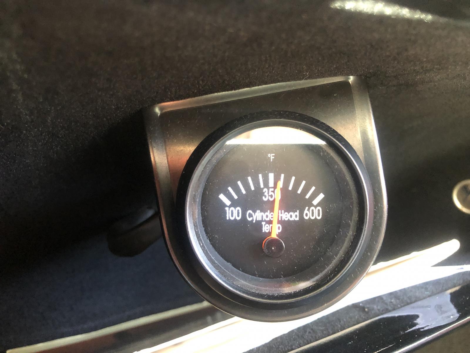

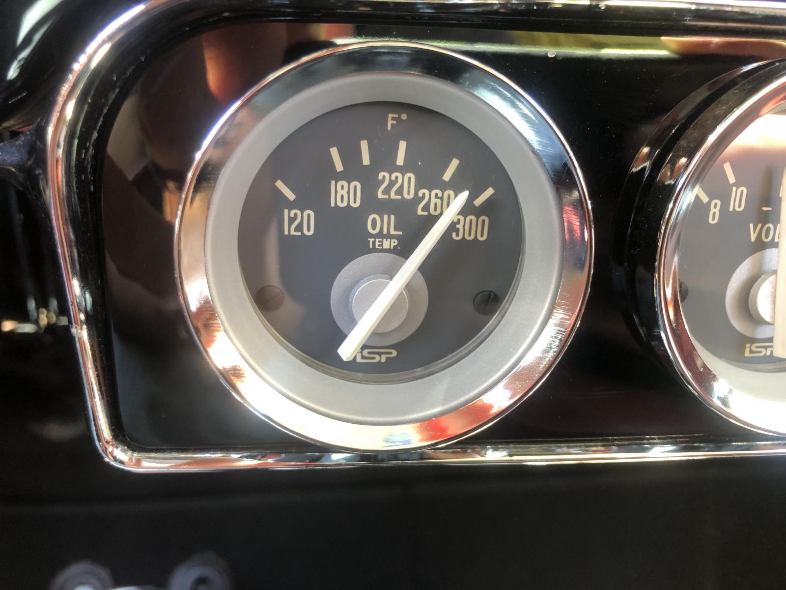

Temps started climbing pretty quick once out and moving.
By the time we got back home - Holy Sheep Shit! Shocked
CHT wasn't showing anything out of line.. Confused

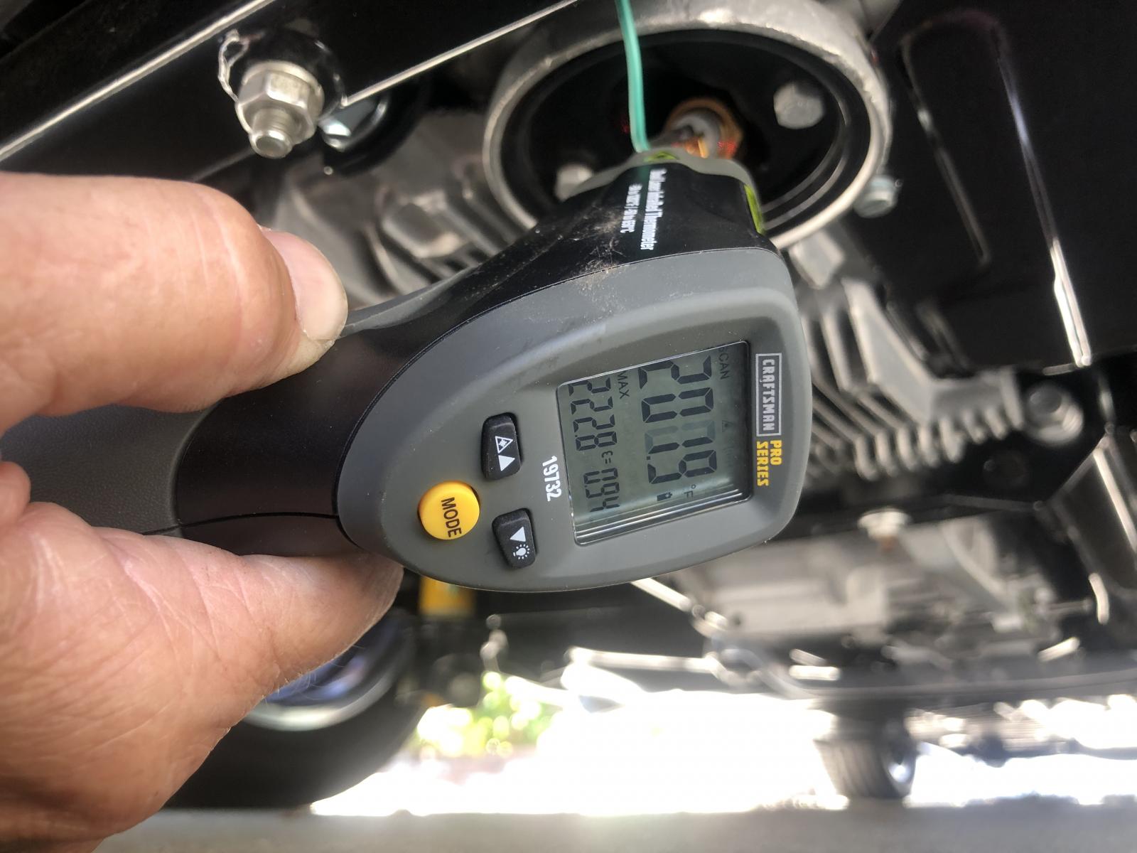

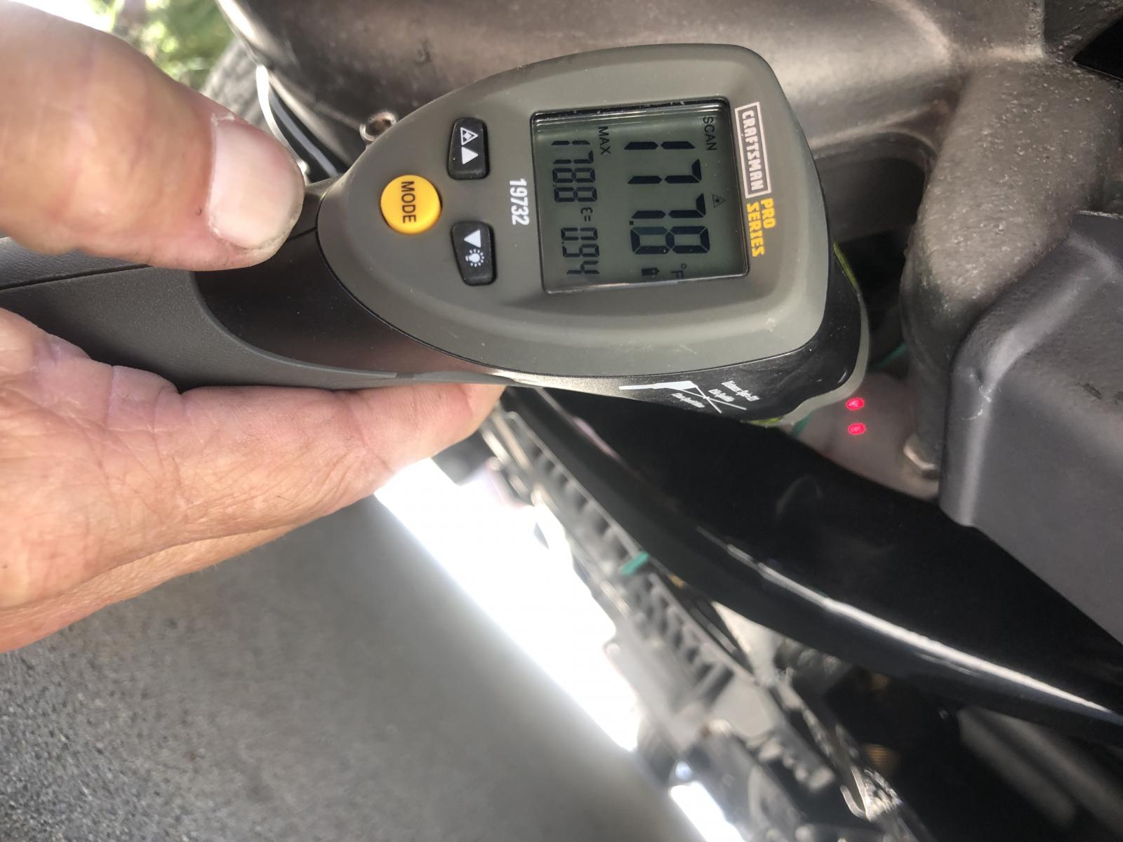

Then it occurred to me that i got one of those IR temp guns.
Top of case:
Taco plate at sender:
Dipstick block-off plate:
Opening the oil cap gave a small wisp of smoke,
Like other cars i had before,
But not since using Brad Penn..
Plus, the dipstick was too hot to touch.
So definitely too hot, but not crazy hot like the gauge says.

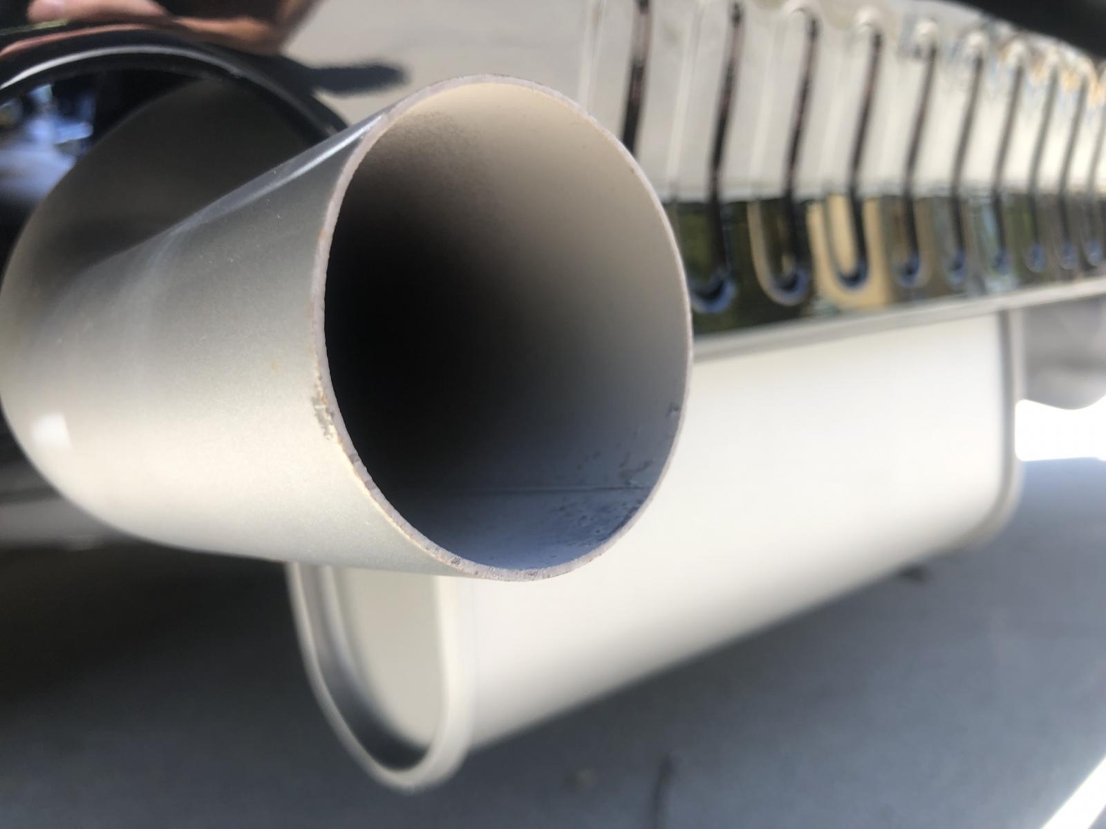

Check out how white it is inside the tailpipe.
Still race gas, so this means something(!)

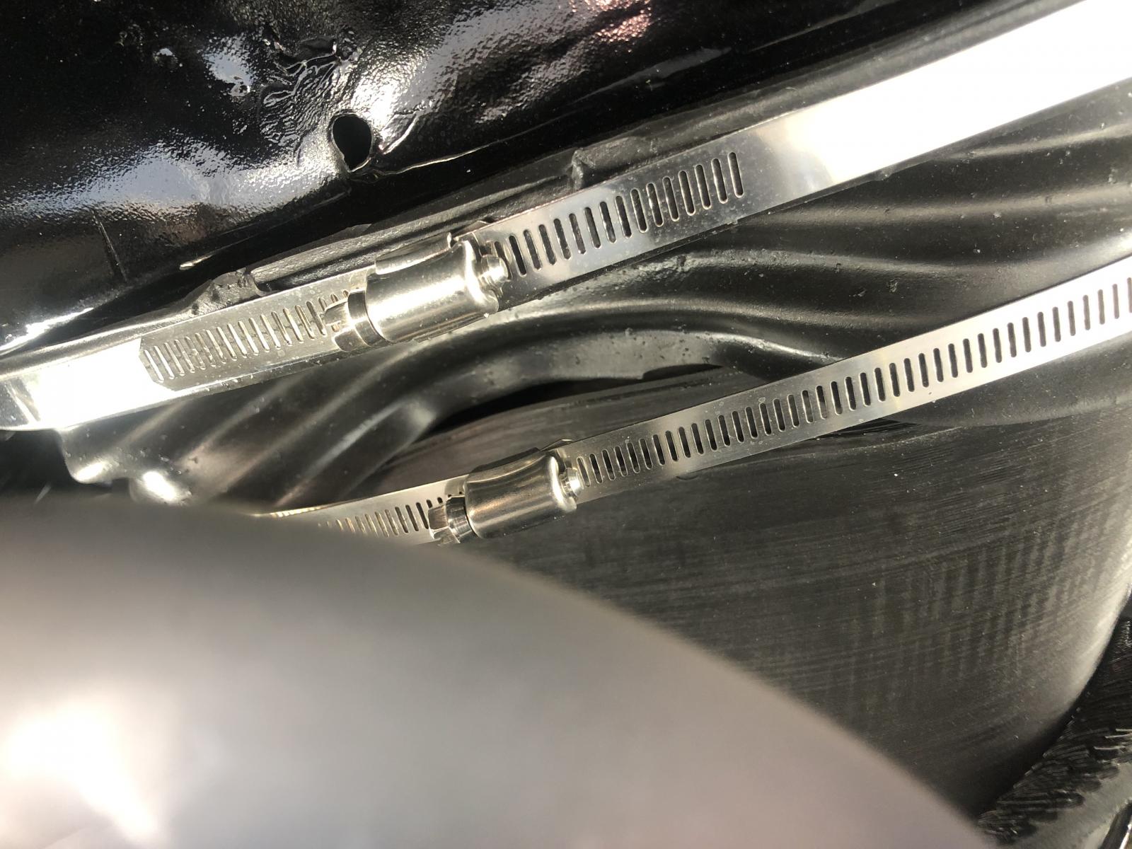

Also found the cooling boot popped off the bottom of the adaptor:

TBPH, I'm kinda suspicious of the gauge.
Oil that hot woulda shown lower pressure.
Plus, it didn't clatter or sound funny..
Wonder if i got a mismatched sender.? Think

I run a VDO cockpit oil temp in mine and it is roughly 10 degrees off, i use a similar sender. i verified that with a mechanical temp gauge, LONG LONG thermometer, and a laser temp gun. all of which were reading 190 and the gauge was reading 180 right after a prolonged 75mph highway run. at 80-85 the oil stays almost rock solid at 200... and with this little engine i dont like turning those rpms for long and makes me wish i had your awesome transmission of doom!
At 45-50 mine gets a little hotter than that..! Razz

I was just thinking, For the excessive oil temps, could one of you oil relief valves not be working right? Stuck in place or too heavy/light of a spring not letting oil to the cooler? Could the oil cooler be plugged?

if a oil valve is stuck or the cooler clogged the temp would be even higher.

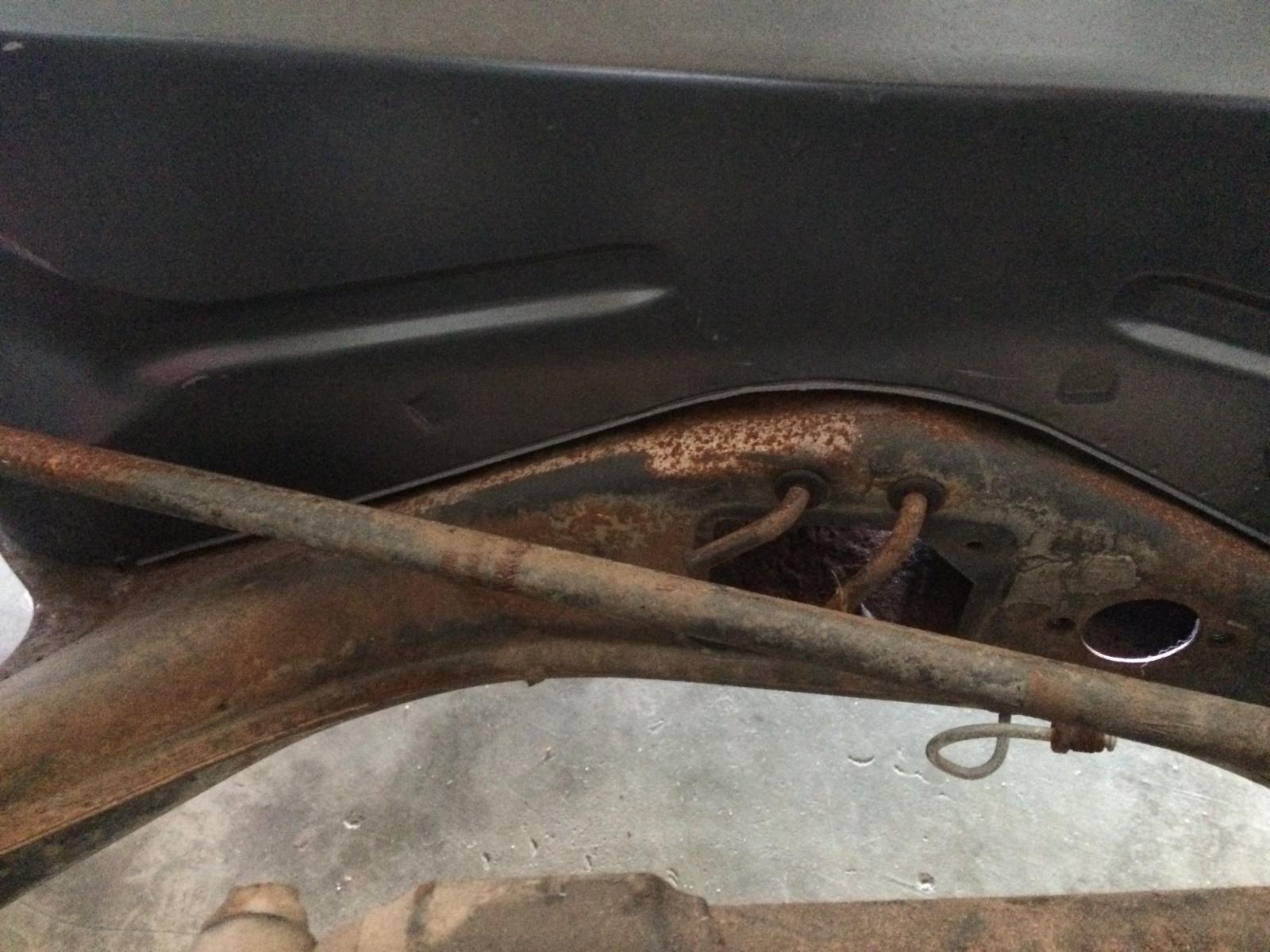

The whole front end will be coming apart to properly address the tie-rod-hitting-fuel-fitting issue.
What I'll be doing is shortening the drag link on the steering box, and the tie rod arms to match.
This will move the tie rod 'forward' away from the fuel fittings.
Here's hoping it won't mess geometry up.
Only plan on removing about 1/4"..

Maybe a silly idea, and I'm well aware of how shit that works in your head doesn't always work in reality, but...
If all you need is 1/4", why not slightly change the position of the tank rather than cutting up and re welding steering linkage? Can you space the tank up enough in front to clear? In the rear? All around?

The lines come out of the pan in the center of the frame-head above the rectangular access hatch.
Same location as factory on the FI cars; two fittings - supply and return.
They're attached to the pan, in the factory spot,
It's just that the fittings i'm using don't make the turn super-tight like the factory fuel lines did..
(And the tie rods I'm using are Lanner's bigger diameter 'super duty' version).
Here's the factory lines; they make a really tight turn as they leave the tunnel.
There's full-on threaded 90 AN fittings there now.
They don't turn as tight, and hit the tie rods (Barely)
If Russel can weld drop spindles and sectioned trailing arms that support the weight of the car,
I can weld some steering arms to withstand the rigors of steering..
I'm really not coming up with any other way to do this right.
A banjo doesn't give me more room on the AN male fittings welded to the tunnel.
The stock tie-rod i have in there with a slight bend in it works, but doesn't inspire confidence.
Plus, it won't give fine adjustment; it's 'one thread' of adjustment at a time.
Wences suggested hammering the Lanner tie rod flat for a section there.
That would give it a 'half thread' of adjustment at a time,
but I'm not sure it would give enough room.
If i shorten the steering arms and drag link a bit, it will be a sort of 'quick steer' kit, and will definitely give me the room i need.
Hopefully it won't mess up the geometry, or hit something else.
And I'll have to pay close attention to steering stop adjustment,
But I'm already doing plenty of that with these huge tires.. Wink

VW used to make special front beam rubbers of different thicknesses for tweaking caster. Maybe you could somehow move the entire front beam slightly forward using that methodology, then perhaps shim your coupler on one side if necessary.
Or just cut and weld shit up and if you boink something so that it doesn't work I have parts! Very Happy

I know there are a couple of different drag links, I wonder if one is shorter than another.

Can you add a bend (or a fancy miter cut and weld back together) to the long tie rod near the outer side? I mean, I know you can, but would it help?

Why not go to an aftermarket smaller diameter tie-rod? What material is your tie rod now? Solid, or tubing with the bungs welded at the ends for the threads?
On one of my Bajas, I have 3/4" solid tubing that's drilled and tapped for Heim joints, and the other car uses 1" tubing that has the bungs welded on the end.
We run stock tie-rods in the Class 11 cars, and we sink a stock sway bar down the middle for strength, if it will survive an off-road race, it will surely survive a street car.

PostPosted: Sun Jun 27, 2021 10:43 pm    Post subject: Re: Black Fastback Build Thread Reply with quote
Clatter wrote:
I had the same temp issues with the T4.
Oil and head temp in uncomfortable holy crap area.
I installed a Deral super duper mega chill 60000 btu cooler and oil came down a lot but I still was not comfortable.
After much sleeplessness and talking to the universe I took the sleds off and everything changed.
The next day I drove mid day 98 degrees to the DKP cruise and the oil never reached 220 and heads ran 350 (dakota digital, sender under #3 plug) at 65/70. Stoichiometry at 13.3. I believe the Notch air intake is in a negative pressure area at speed, the Fasty may be also. Temps are acceptable so I am good now.
Amazing power, now I just need to get the steering to feel much less vague.
914 guys drop to 4th if necessary to keep load off. That tip does look hot.
Good luck.
