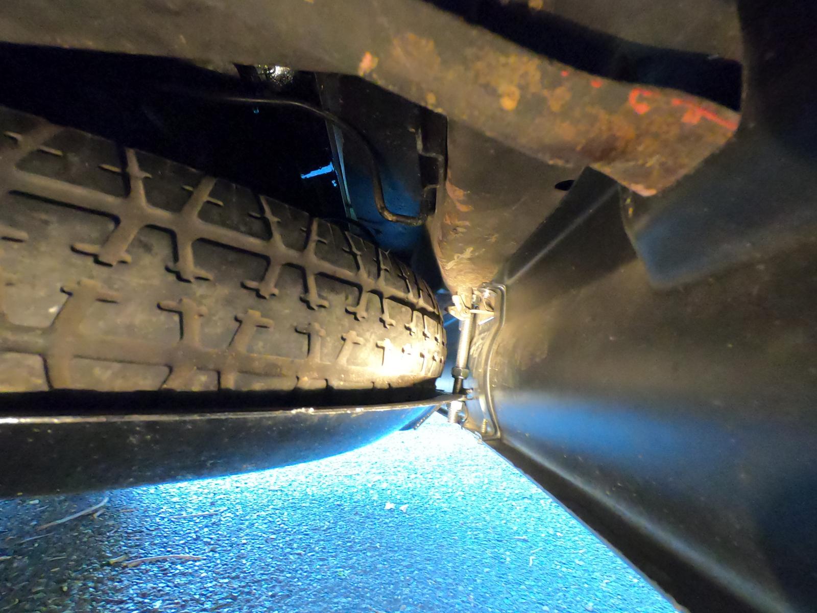

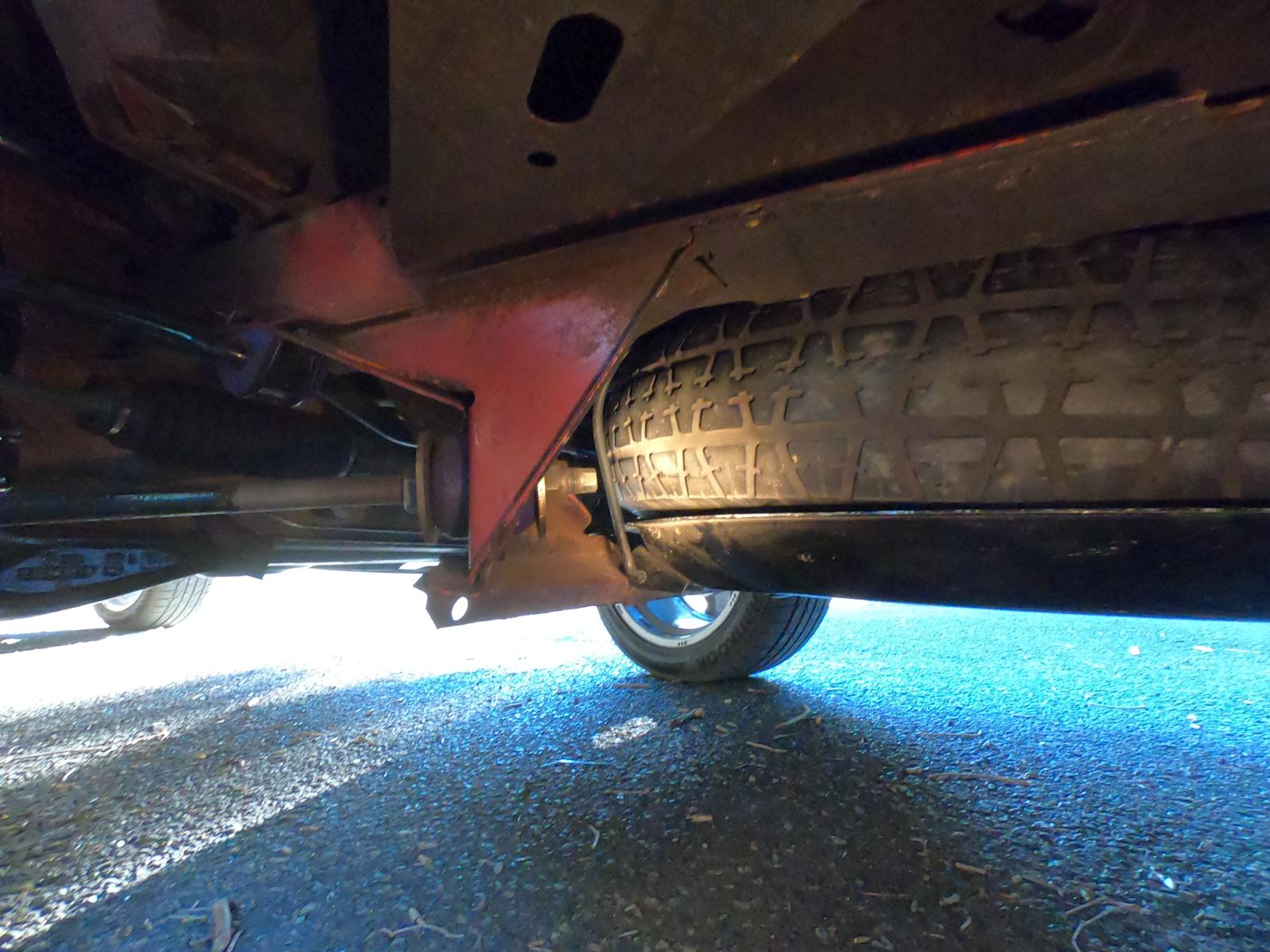

This is my spare tire solution. Mercedes fifty/fifty tire on 18 inch aluminum rim. Rolling diameter is slightly smaller so it only will work on the front. So if I blow a rear it gets a front and the front gets the spare. Kind of a pain but my lug nuts work and it fits in the clamshell, sort of. TIre and wheel $50.00, Hardware $15.00, Total $65.00, RT $27612.67

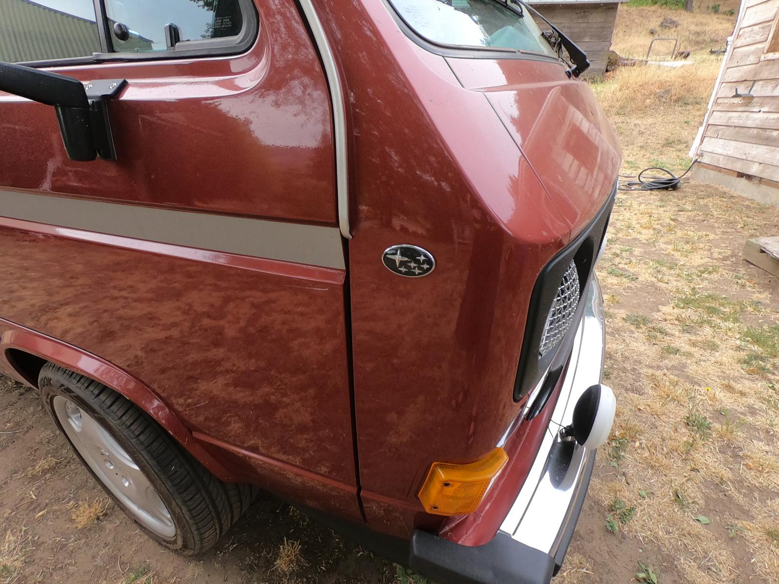

I changed up my emblems. Also found a passenger side NOS tail light still in it's original VW- Audi box, still looking for one for the driver side. It's hard to see but it's brighter looking and no cracks. Emblems $45.00, tail light $50.00, Total $95.00, RT $27707.67

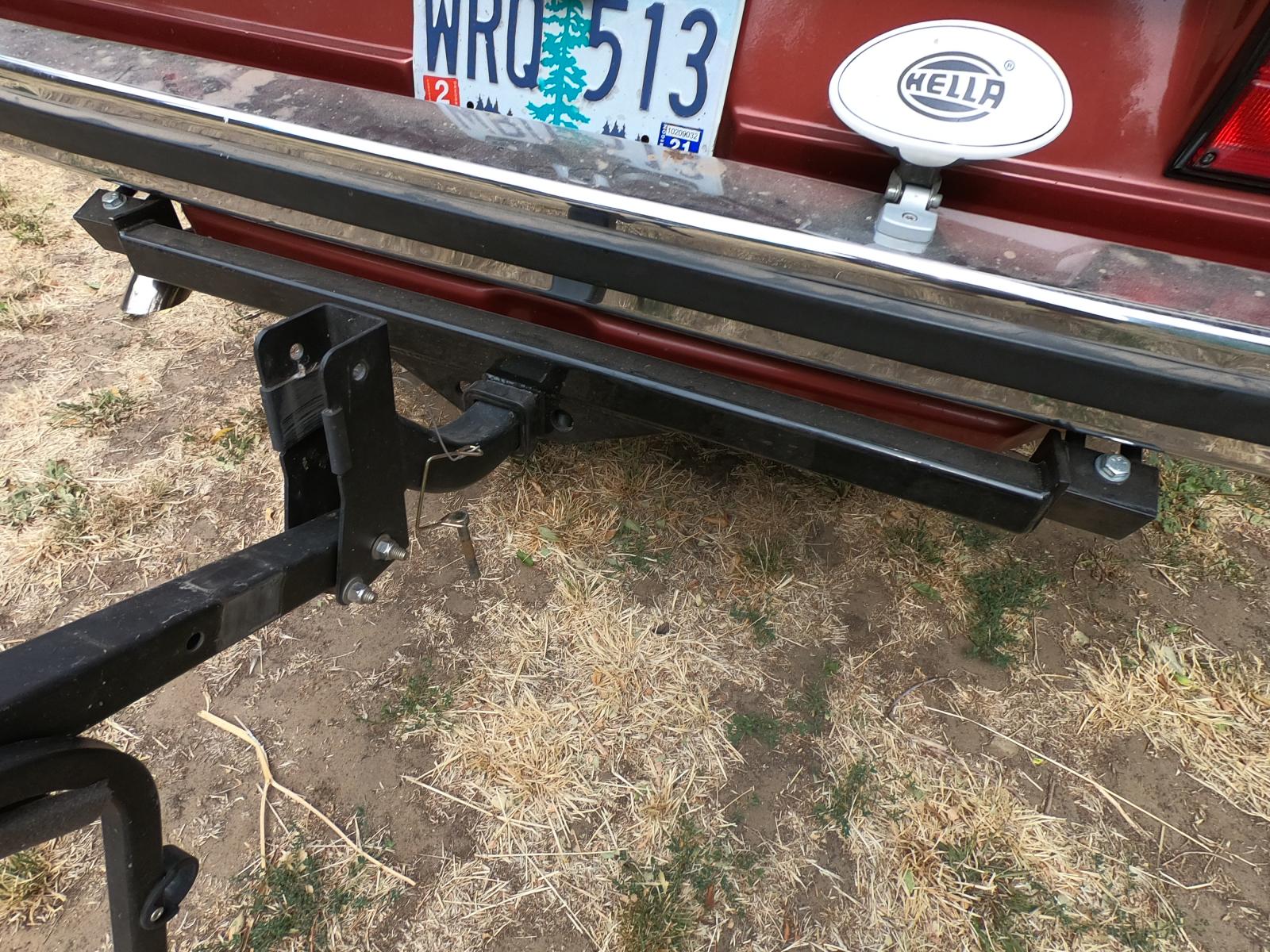

Picked up a like new GW receiver hitch, bolted up super solid. I like the versatility of the receiver, ball hitch, bike rack, hitch tray, whatever. GW hitch $125.00, RT $27832.67

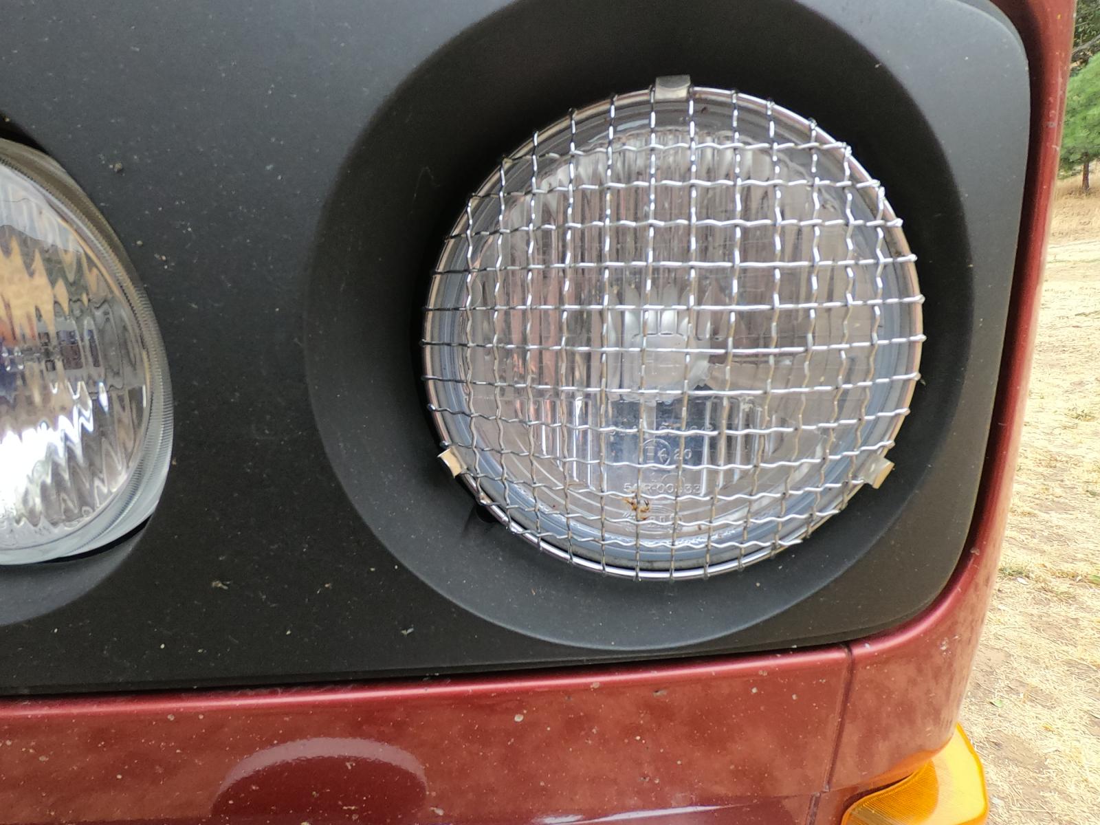

A few things I forgot to list. Mesh light guard $25.00

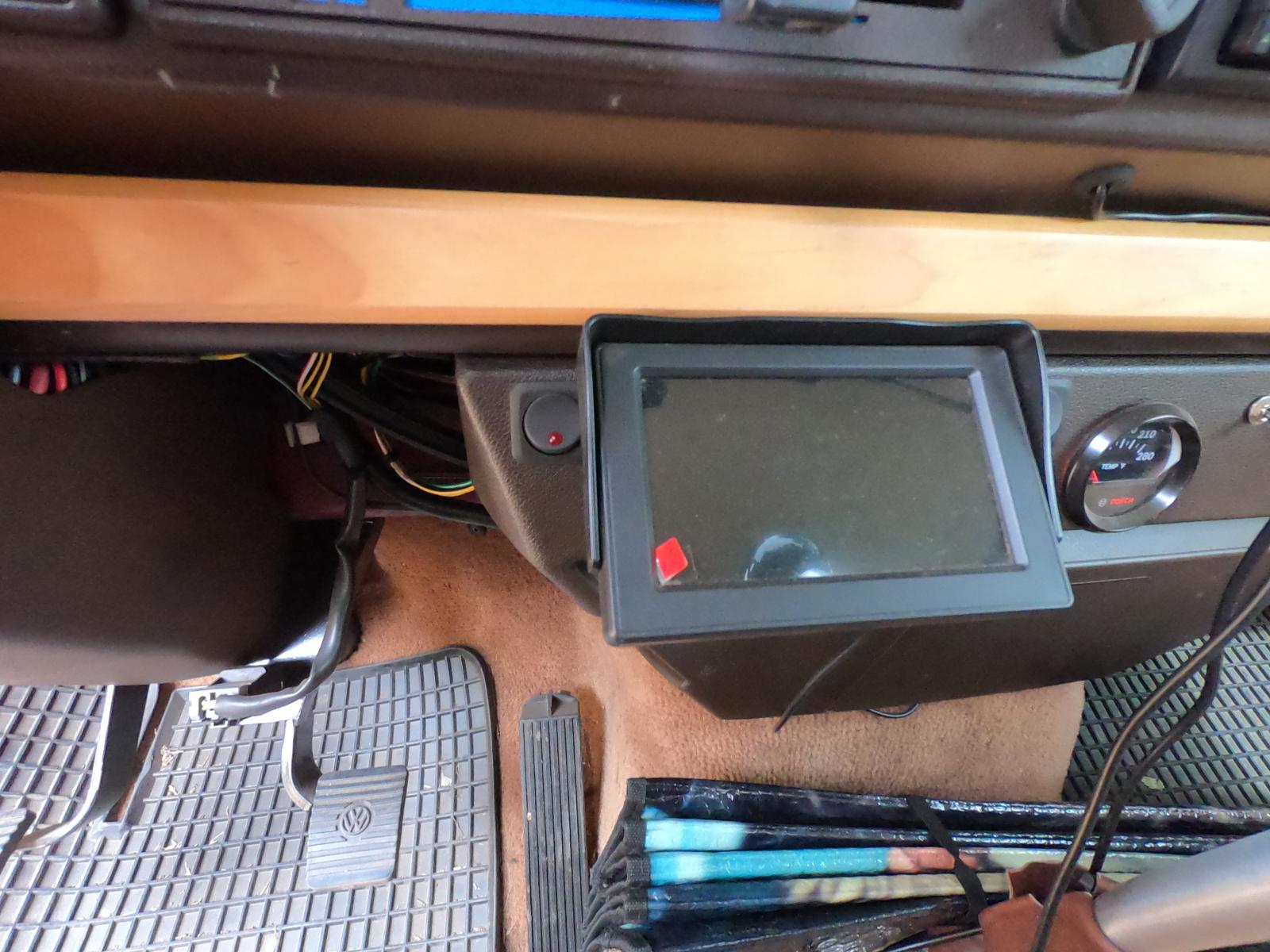

Back up camera $45.00

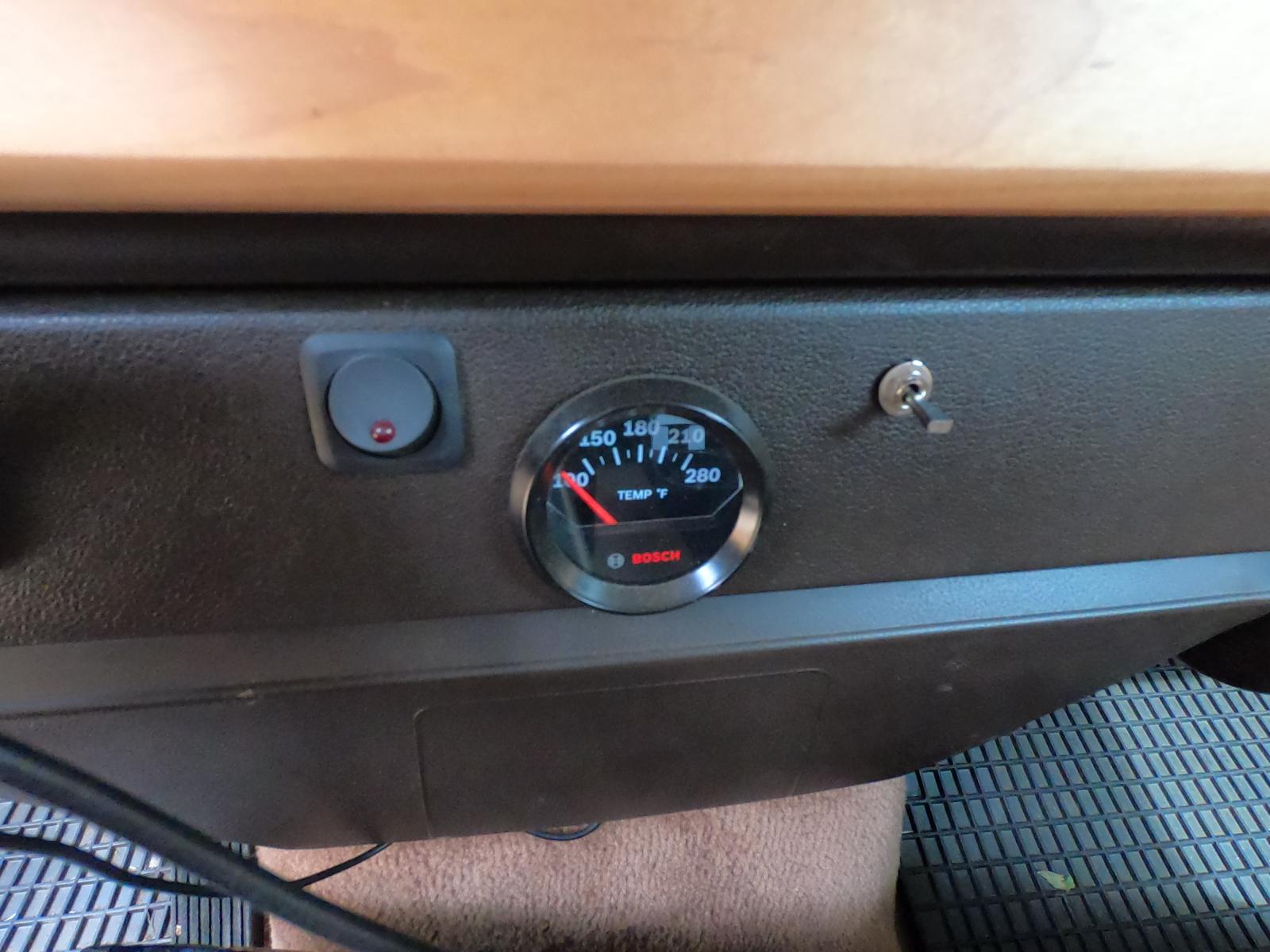

Water temp gage for on board water tank $42.00

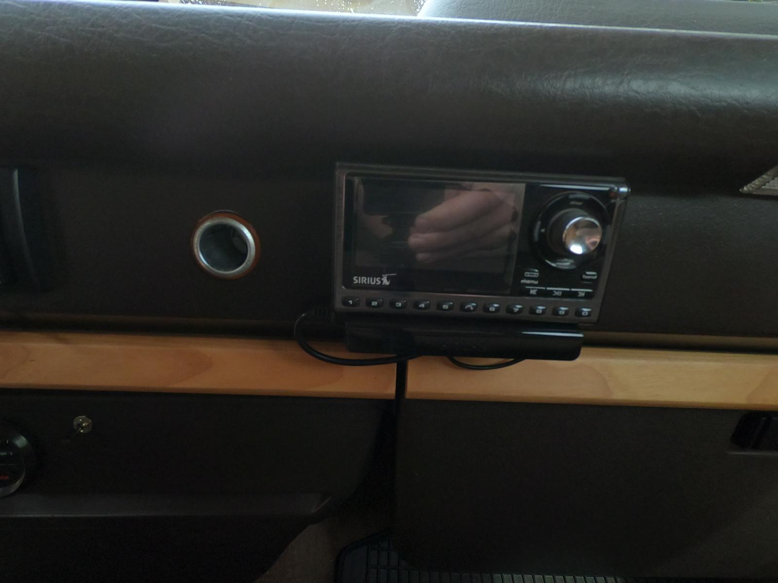

Satellite radio, priceless. Car installation kit $65.00

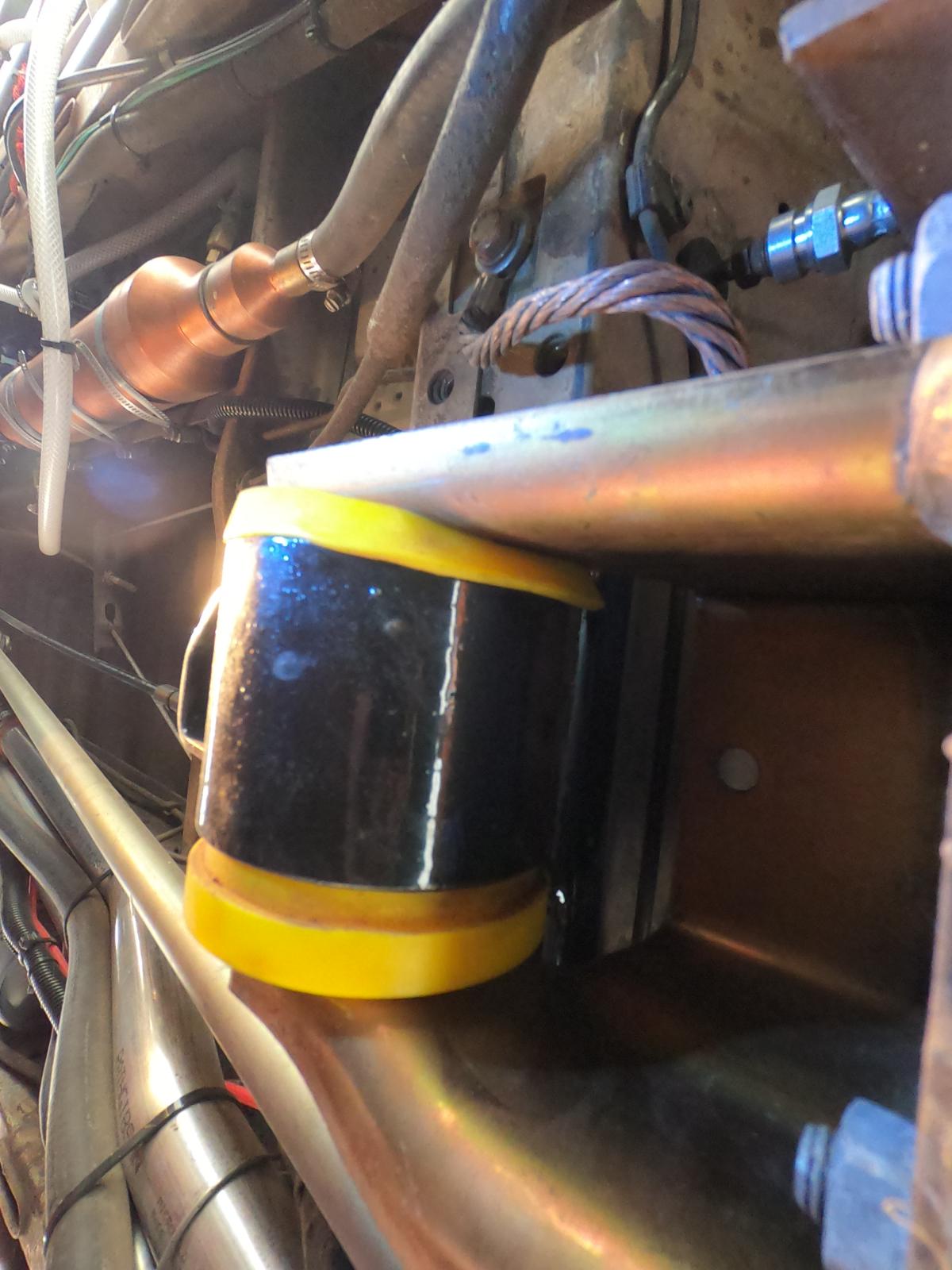

Well it's time for an update and a question. Vino was in storage for the winter and I have not been out in her much yet this year. She's running great but I was crawling around underneath checking for any lose fasteners and I found this.
Manuel trans, Porsche 930 axels and CVJs.
1500 miles on Power flex trans bushing. Looks like an obvious alignment issue. With the van on th ground I tried moving the axels in and out, passenger side had maybe one eighth of movement, driver side had none. I loosened the slotted adjustment on my SC engine mount and shifted the engine a solid quarter inch to the passenger side. Now I have about one sixteenth of movement on the passenger side and maybe a hair of movement on the driver side.Front mount is better but still off buy one eighth. Last chance is to loosen my mustache bar bolts to get a hair of adjustment there beyond that I'm kind of stumped. Mount has cut the lip of the bushing almost through. Any suggestions?
