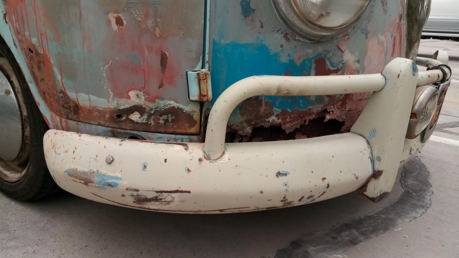

Frame rust was pretty bad. I'm sure there is worse out there, but like I said, I could feel the bus flexing. The roof raingutter line was nice and straight though, probably held together by the HWE rack. 80's era repairs were some nice steel pipe and diamond plate welded into the crossmember. And typically the rust holes were filled with foam.

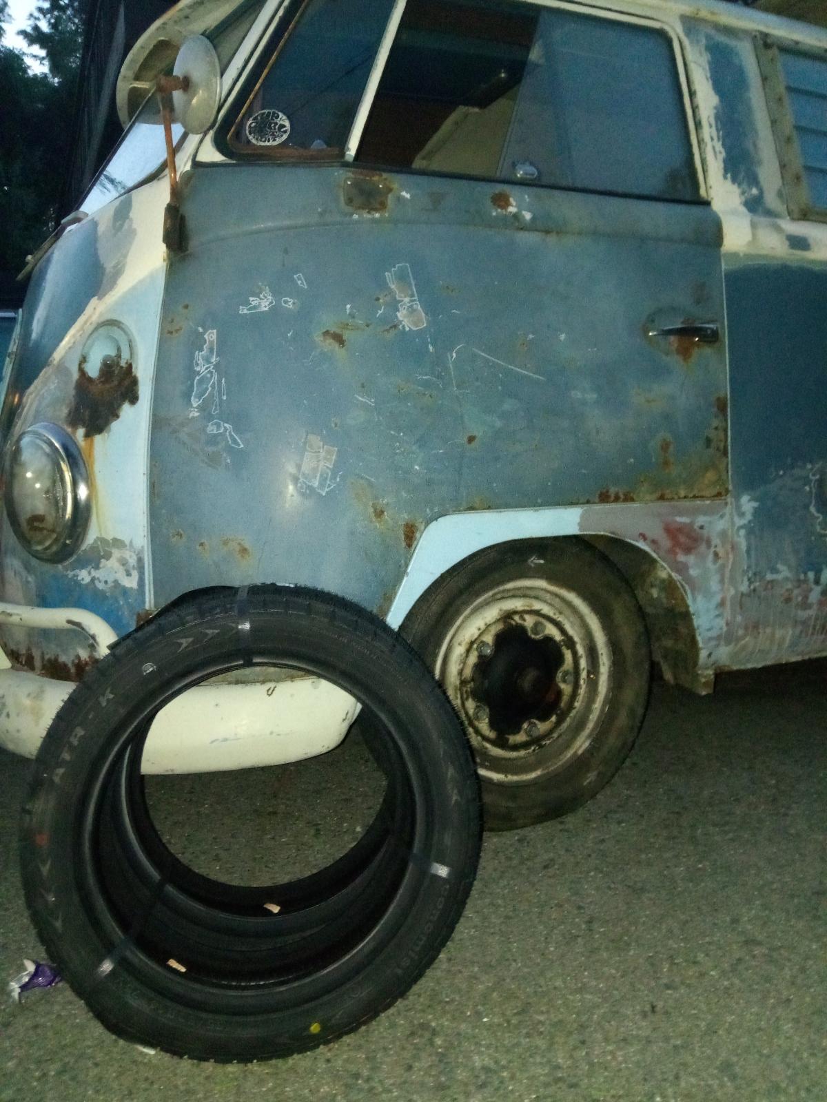

Right on mr. white. I like a rough, fabricated-on, look. I may go dove blue touch ups eventually, but I'm going to do the metalwork first and then decide. Probably just clearcoat or OG.

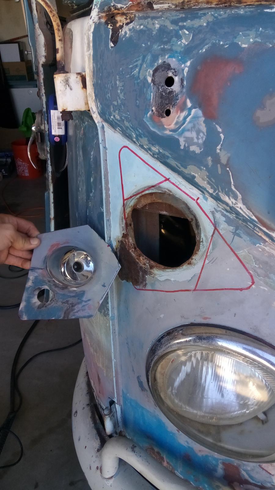

Since I'm doing metalwork, it's a good time to change back to bullets from fried eggs and little tail lights from the canned hams. Somebody at one point got their hands on a donor 67 and "upgraded" it.

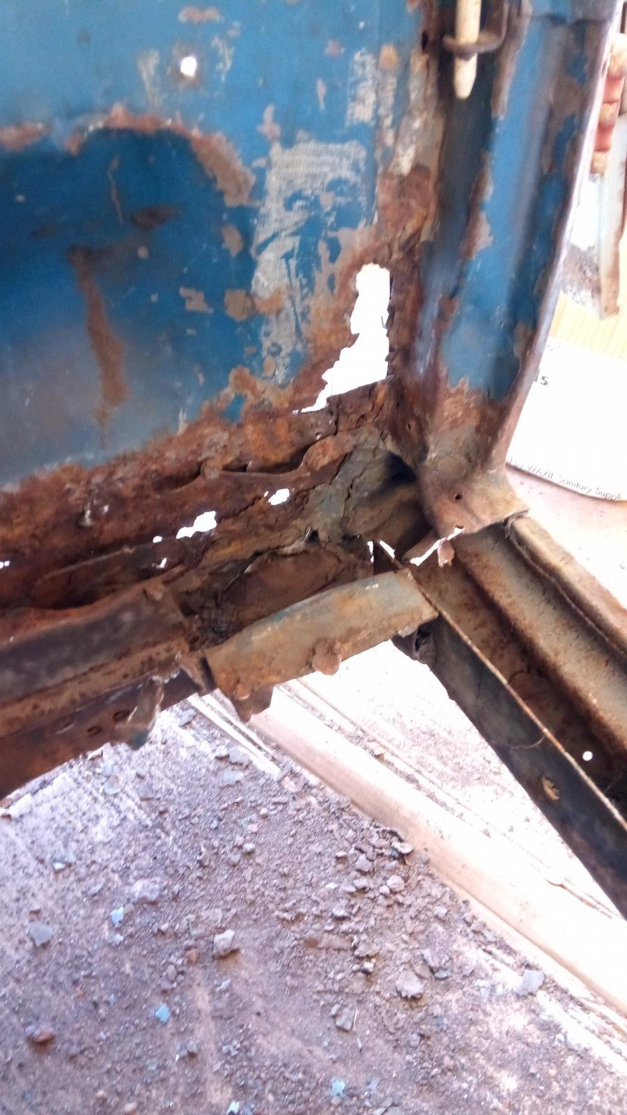

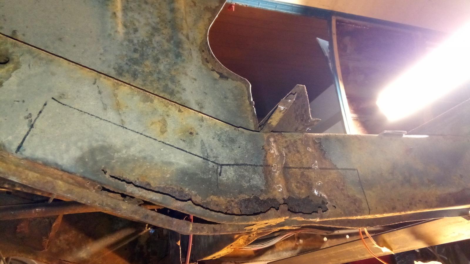

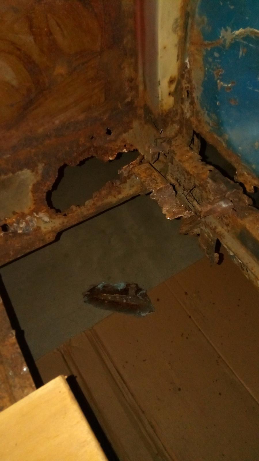

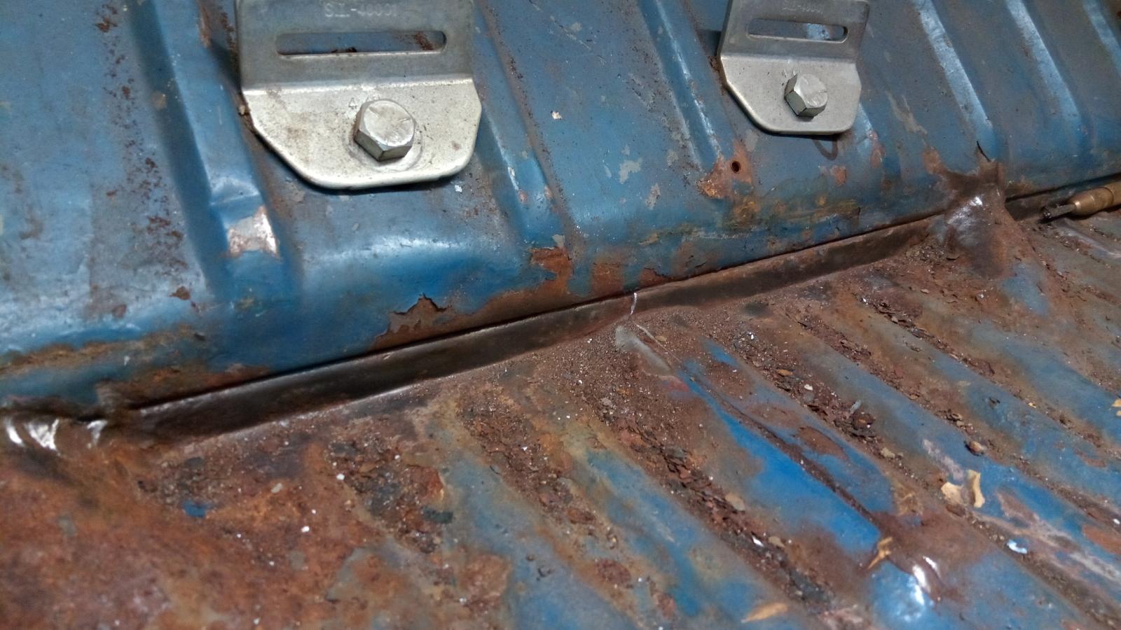

More B pillar crusty-ness, pre demolition.

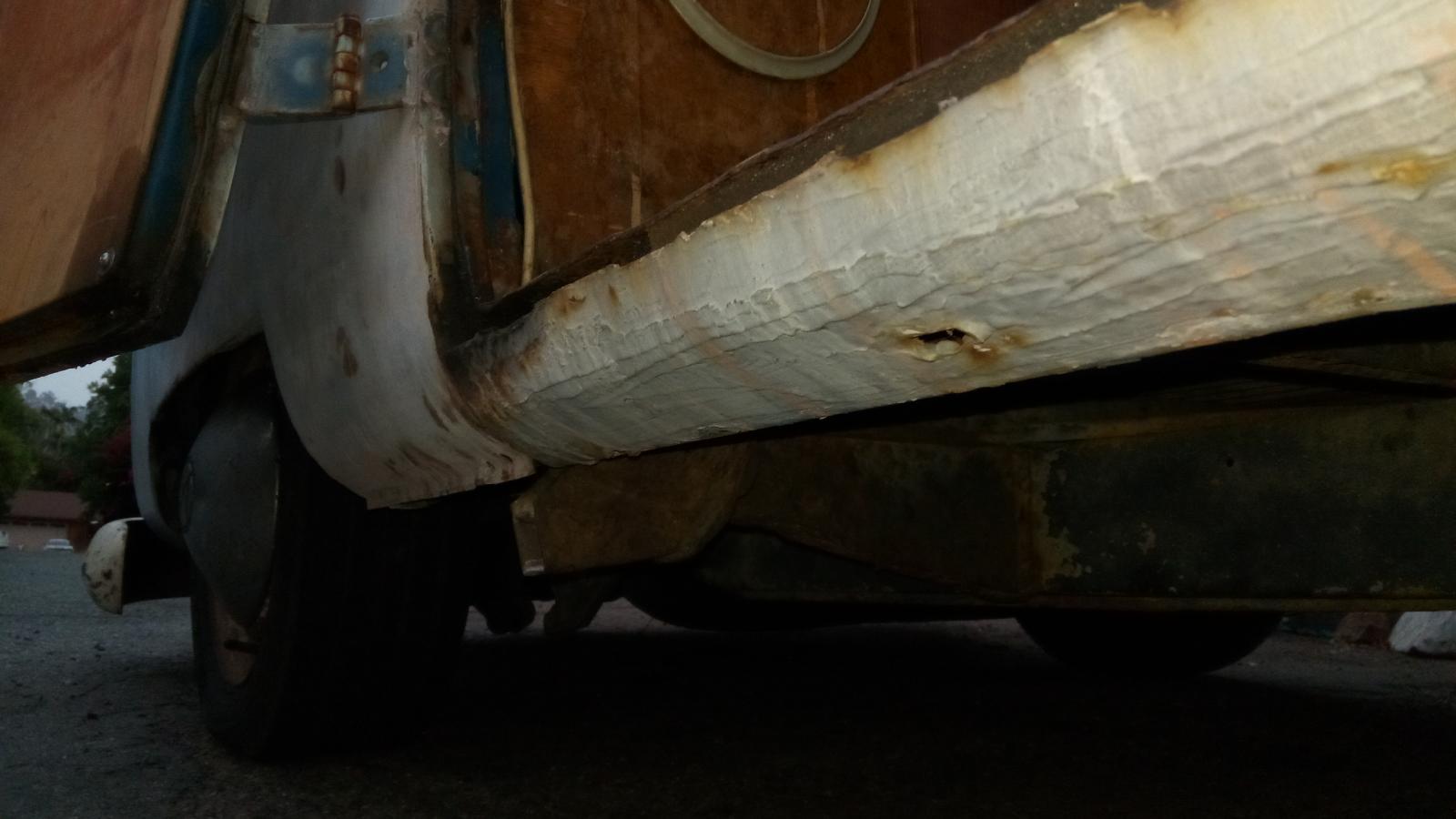

C-pillar crust and previous cargo rocker repairs:

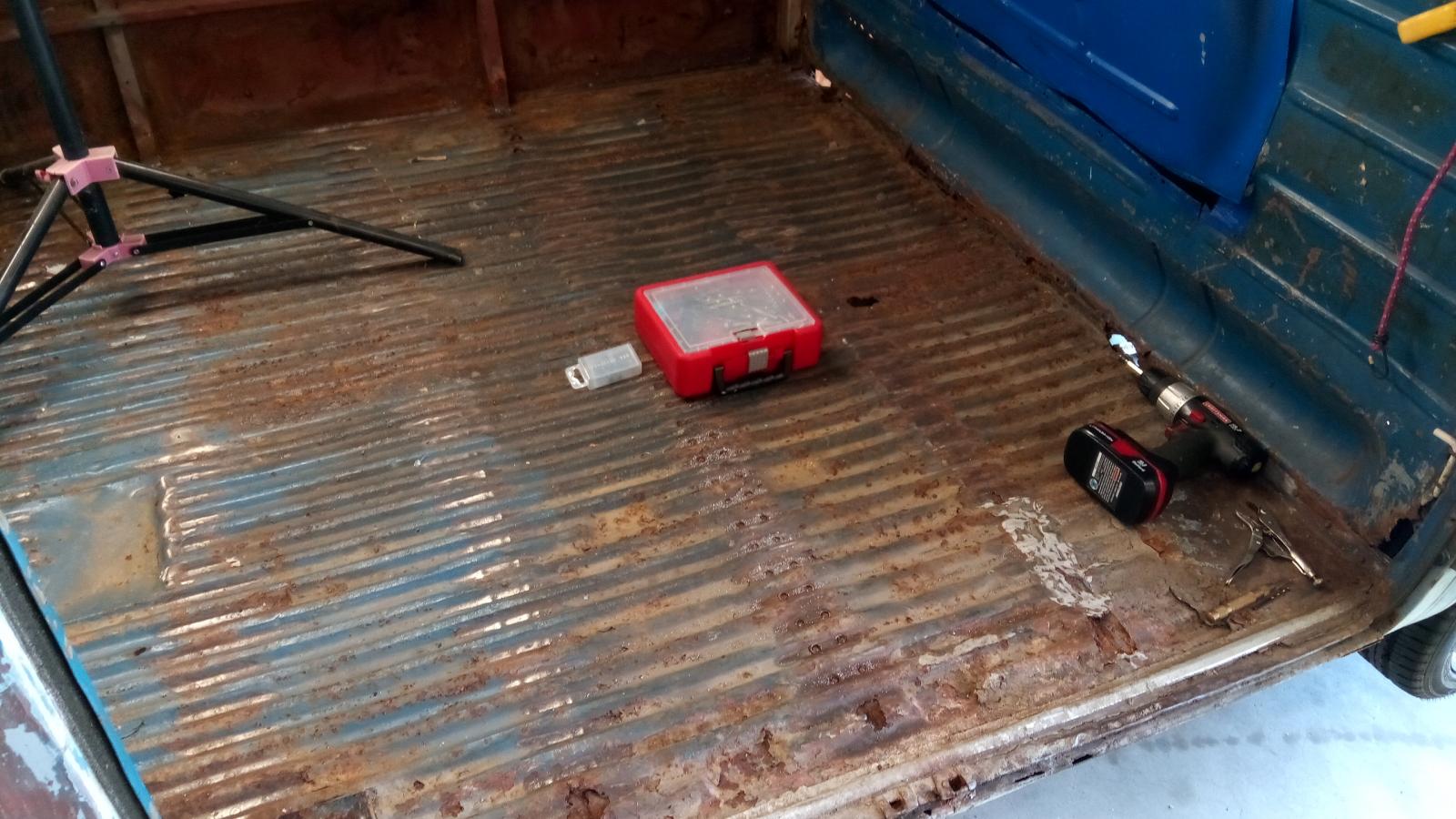

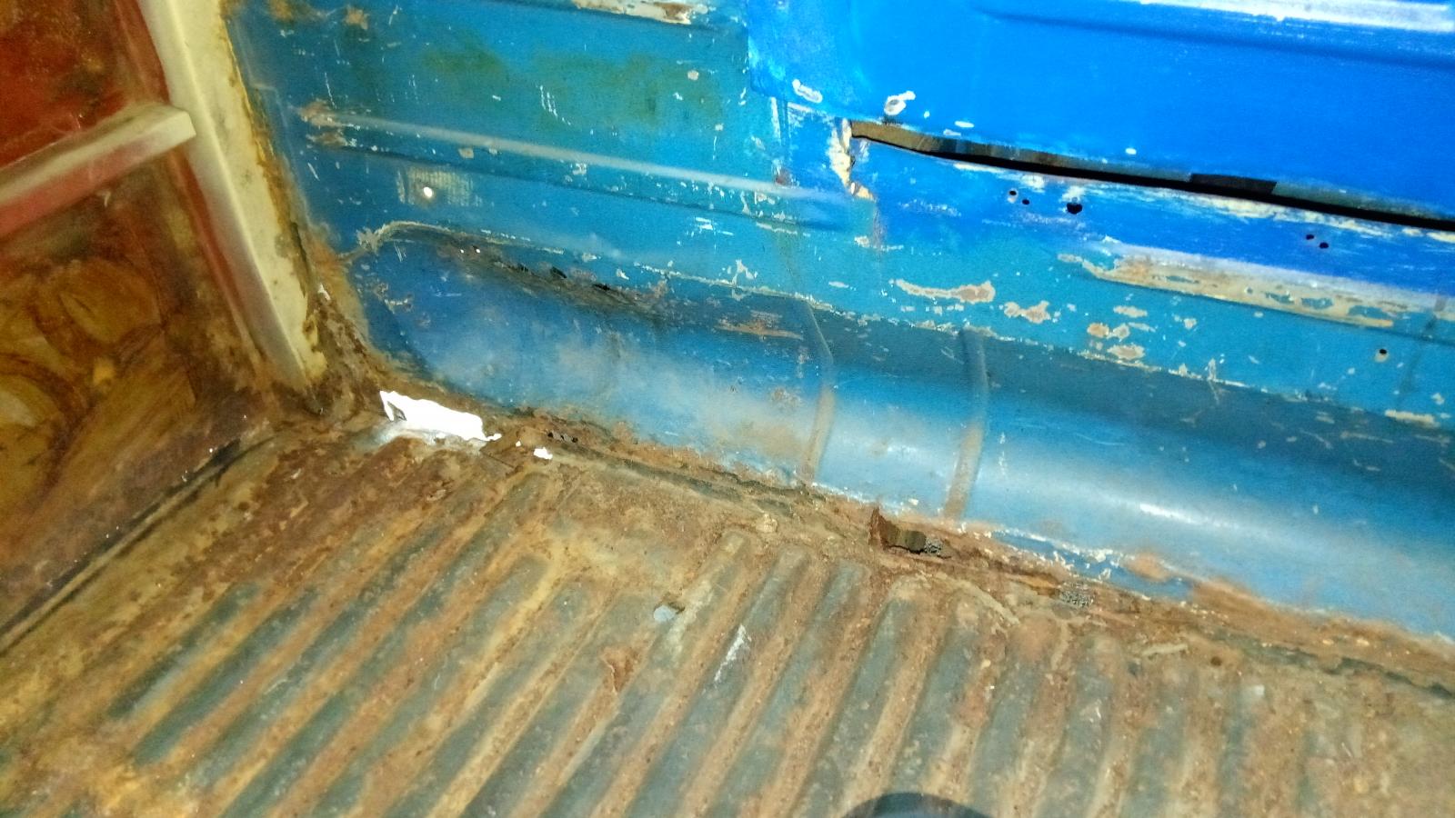

Front floor and valence crust. Patches are surfboard fiberglass:
The 14" lo pros that started this mess:
Pulling hippy foam out of all the nooks and crannys:

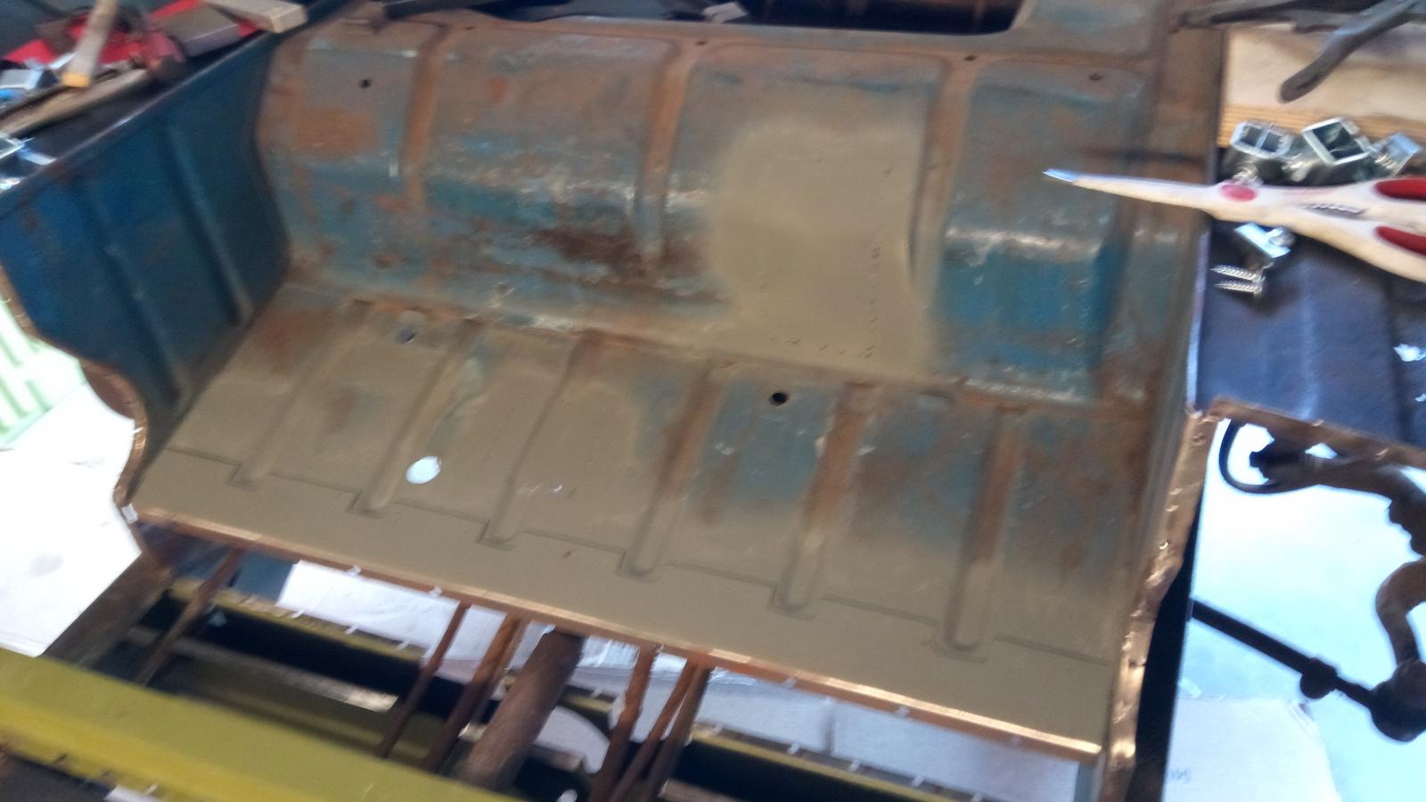

Wire wheel grinding to expose the spot welds. Cleaned up the edges and crossmember locations:

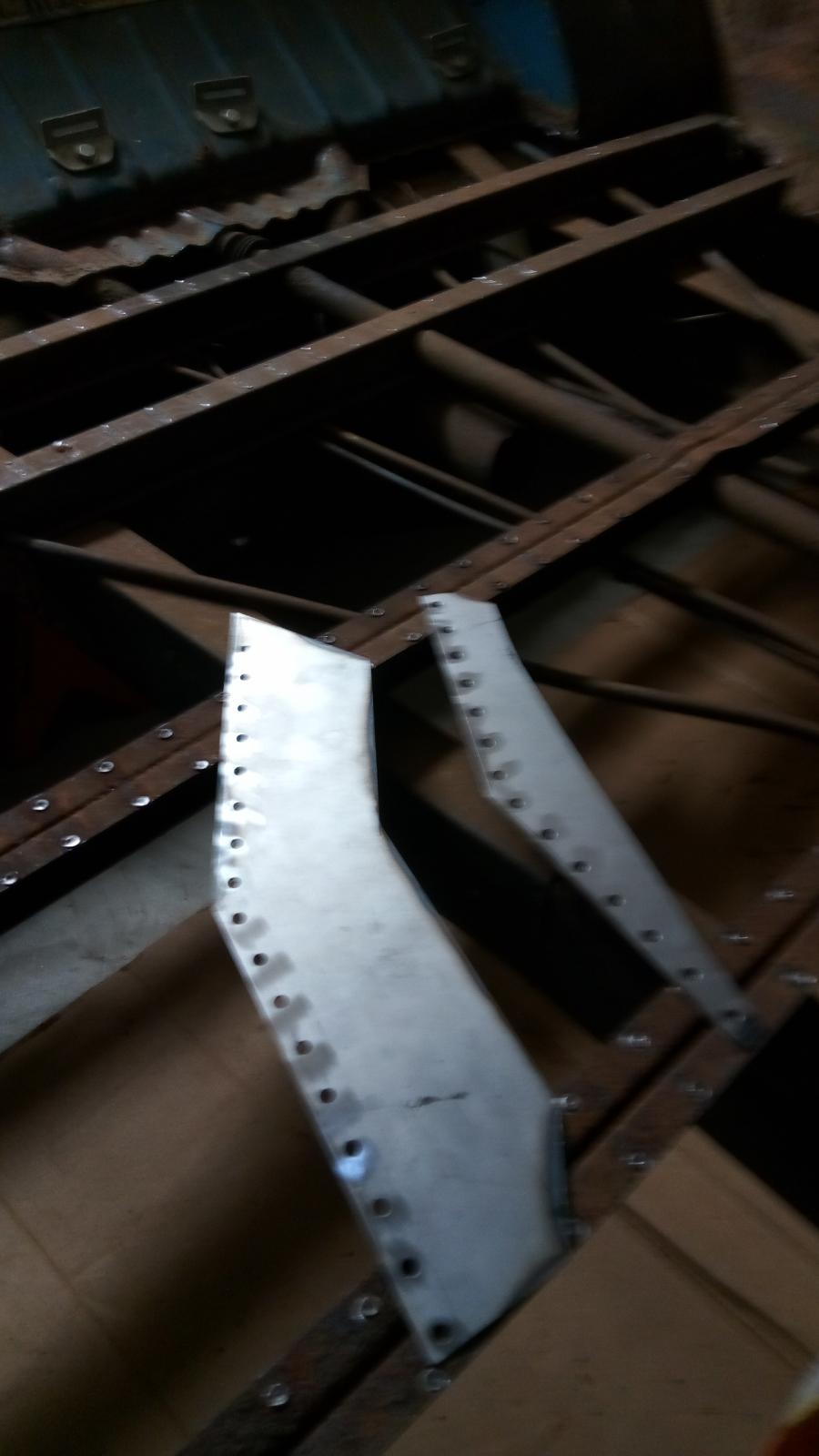

Making the frame profile templates for the patch panels.

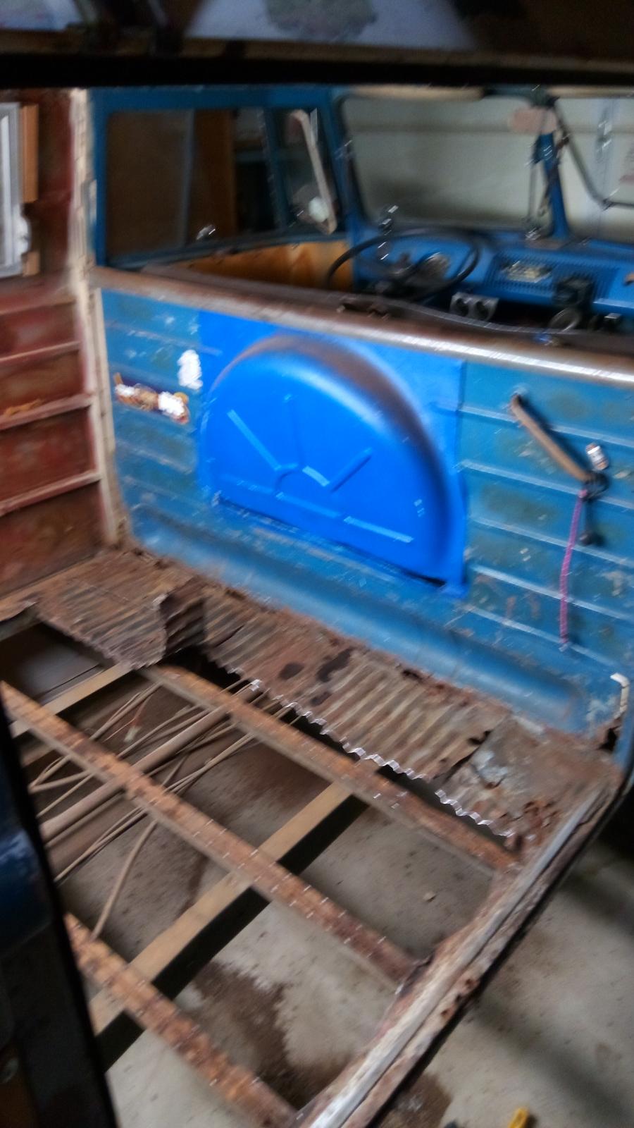

Fast forward and it's moved into the operating room. It's across town but it's nice to have a dedicated space for this kind of work. Got it all plumb on jack stands, no frame jig, no rotisserie. So I'm going to weld in some support bars between the frame rails before I cut everything out. Funky green arrived. Gerson seems super legit. Ended up ordering twice from him, once before floor demo and once after. Also got some autocraft UK odds and ends from CIP1. Ended up ordering just over 2 grand in metal.

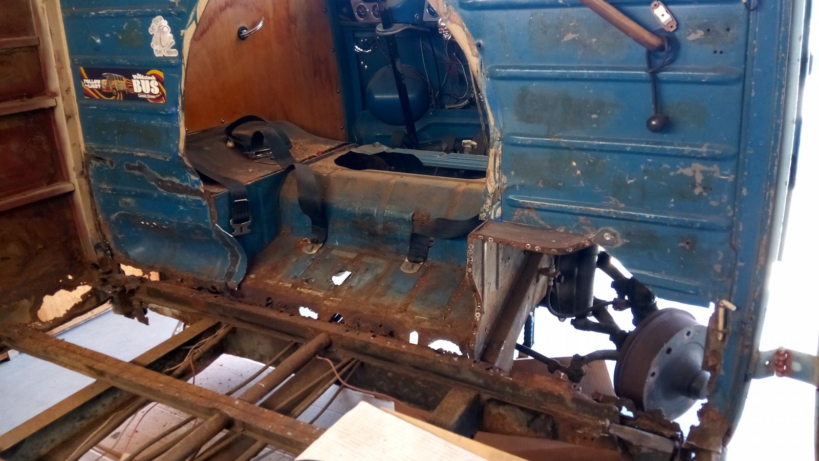

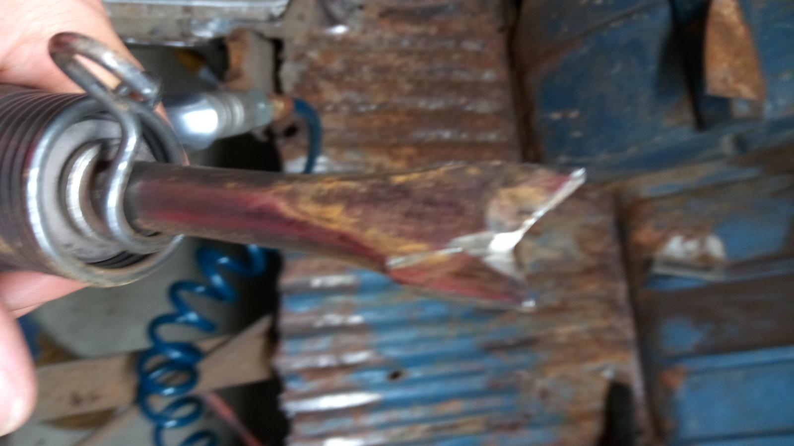

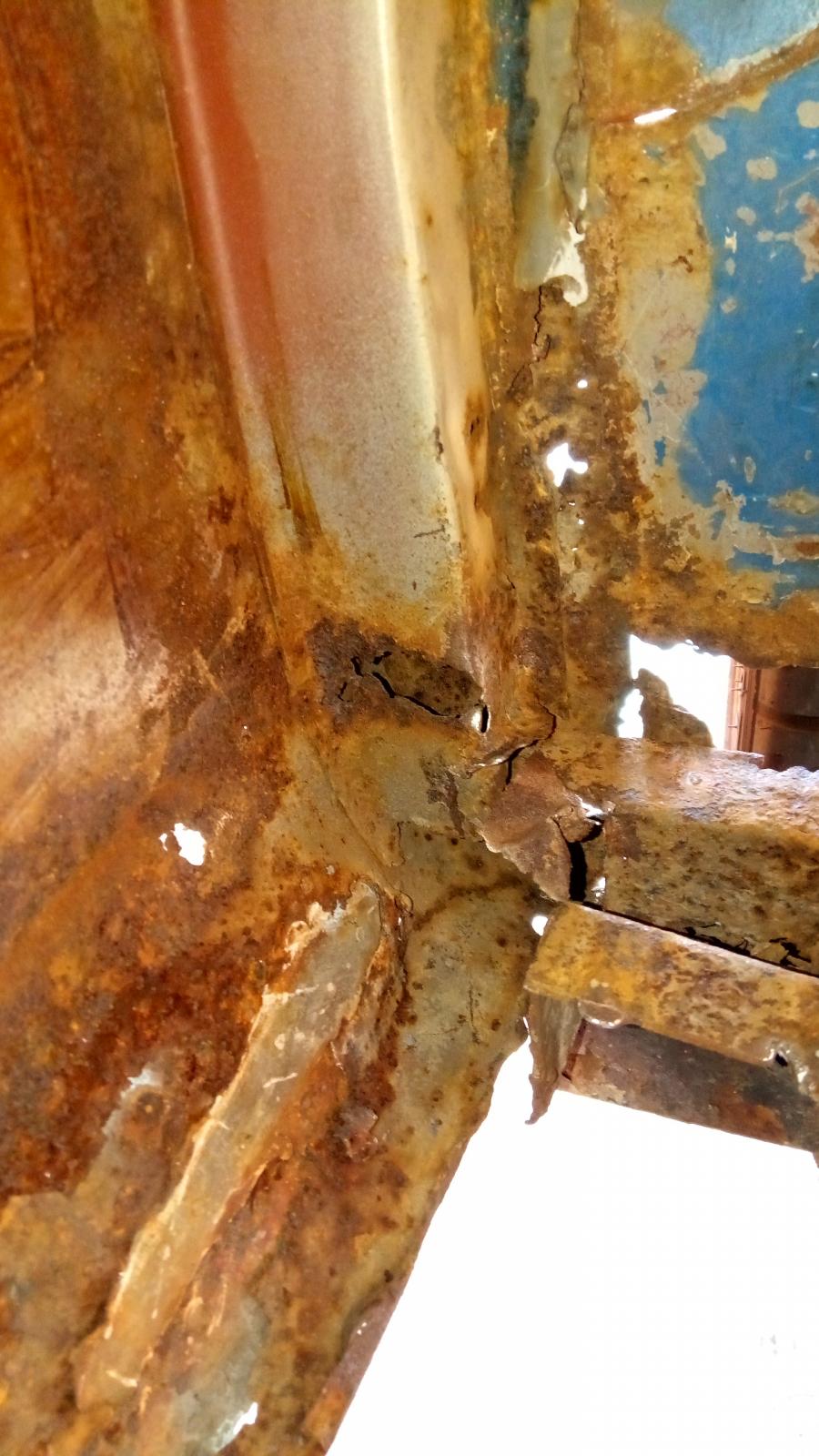

Right on vw 60. So I do some samba research and start demo. I kind of ground a sharp section into an air chisel tip. I would have that thing munch between the crossmembers and then use a pry tip to roll up floor sections. I drilled a lot of spot welds, but then I got lazy and started popping them up with the pry tip.
I get to the back lip and it is kind of shitty. And I know I'm not going to make that factory style of pinch joint. I am also deleting the heater tubes. One day I will run a little 12V blower.

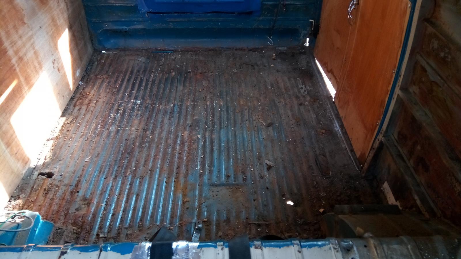

I exposed the B pillar section under the floor. Not much left there. Need more funky green. Giant bondo chunks drop out of the rocker.
C pillar is pretty bad too. Cargo rocker is this strange sheet metal chunk from a previous repair job. There are some welded sections which are hard and tough compared to demo'ing the regular metal.

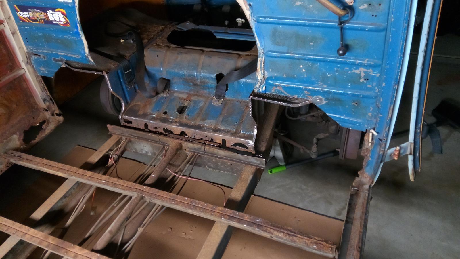

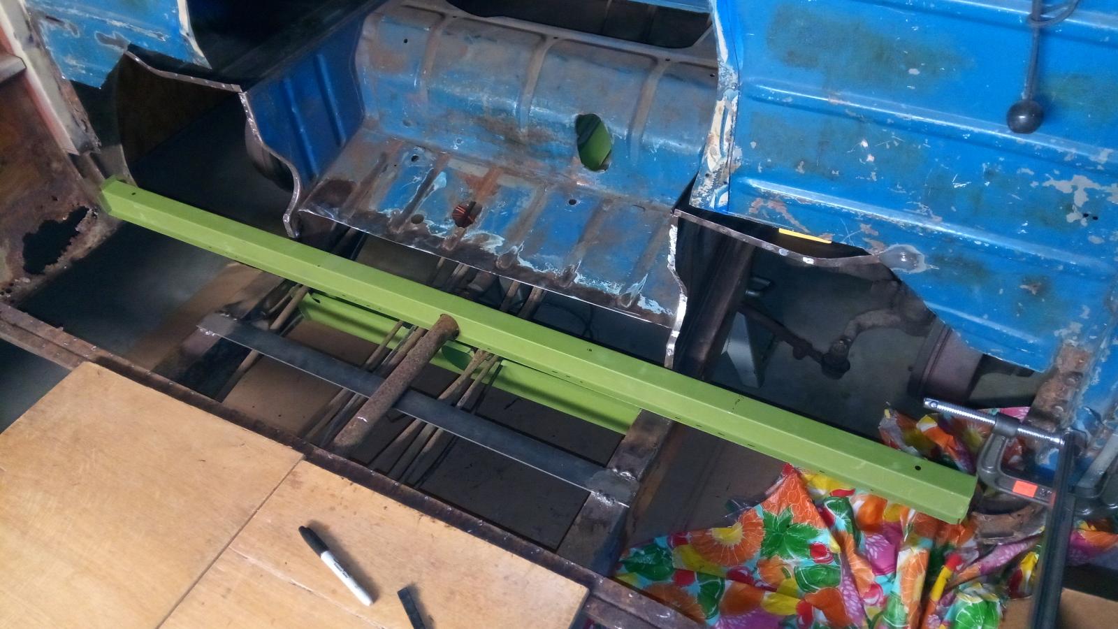

I keep demo'ing the bulkhead. I got a nice fat klassicfab section and I'm going to use it. I drilled out the spot welds to the pedestal and make angle grinder cuts. Getting after it pretty good.
Got new outriggers, so those have got to go.

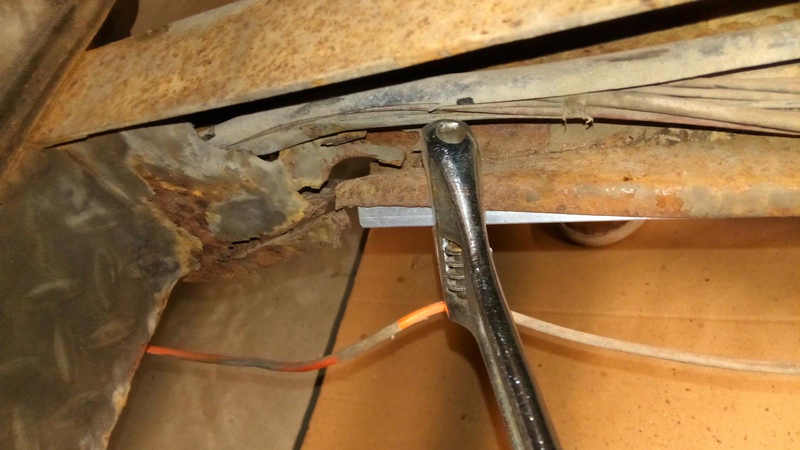

No frame jig, so I straightened the crushed part of the frame I need to keep with a crescent wrench and pipe for leverage. It moved around pretty easy. Before I cut out the front crossmember, I lay down my first welds and they are pretty nasty. But they hold. Overhead welding is hard and I have trouble getting penetration into the frame.

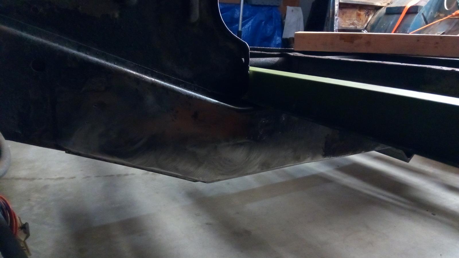

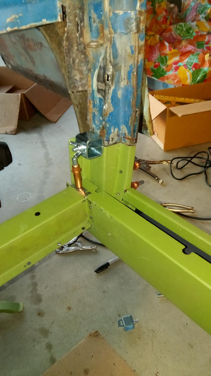

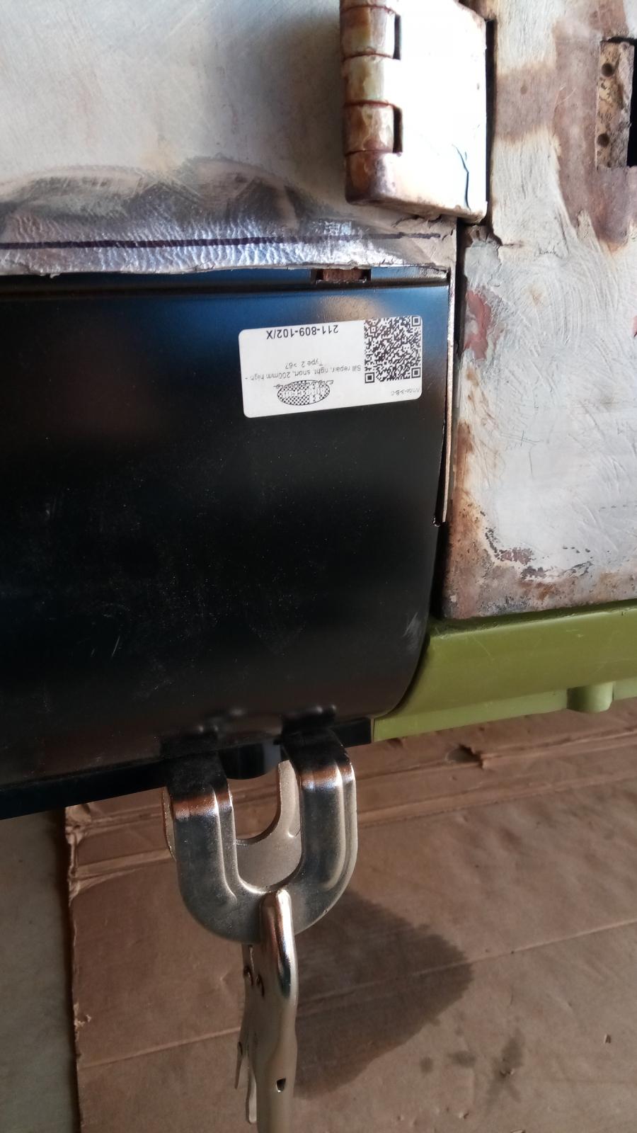

Before I cut out the cargo rocker, I wanted to brace the cargo door opening. I attempted to weld a brace between the pillars, but it kind of failed in every way. I couldn't close the doors with out clearance on the brace, and I was using my harbor freight welder (110V, low setting, .035" flux core, no gas). There was a super fine line between not getting penetration and blowing holes through the thin rusty metal. I ended up not using this brace, but I did keep it around to see how much the pillars moved after removing frame sections.

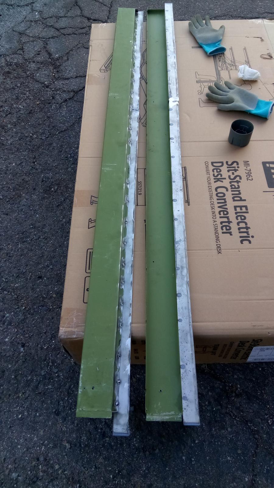

I got a section of autocraft frame rail section to make my patches. It was the right profile and thickness, so I didn't have to mess with bending the thick stuff. I think it's 14ga or about .075".
My welder is terrible and my skills not up to snuff, so I had a buddy with a 220V Lincoln mig with gas tack it in after I was happy with the fit. I knew I had to shore up the frame kink section before I built up anything around it.

I admire your brave work on your beloved bus. It definitely needs some attention to the chassis to make it strong and safe again.
I would suggest to do more and stronger bracing. A piece of stripsteel only takes pulling forces but can't stand any pressure. The more metal you cut away the bigger is the risk to loose alignment of the body and the chassis. It might deform under its own weight especially since you dont use a jig to keep everything in position.
I also would like to suggest not use the chassis of your bus as a practice object for learning how to weld. You don't want incorrect or weak welds in the structural most important parts of your bus. A fair amount of welding is needed there and you want to be sure it is of good quality to be safe and strong.

I agree with you guys about the structural welding. Part of the deal with me tearing this thing apart was that my co worker is a pretty accomplished hot rod fabricator type dude. So he did all of the structural welding. I have been fabricating, fitting the panels and gaps and then we'll get down on a weld session on the weekend. Learning experience for sure. Staying focused on structural integrity.

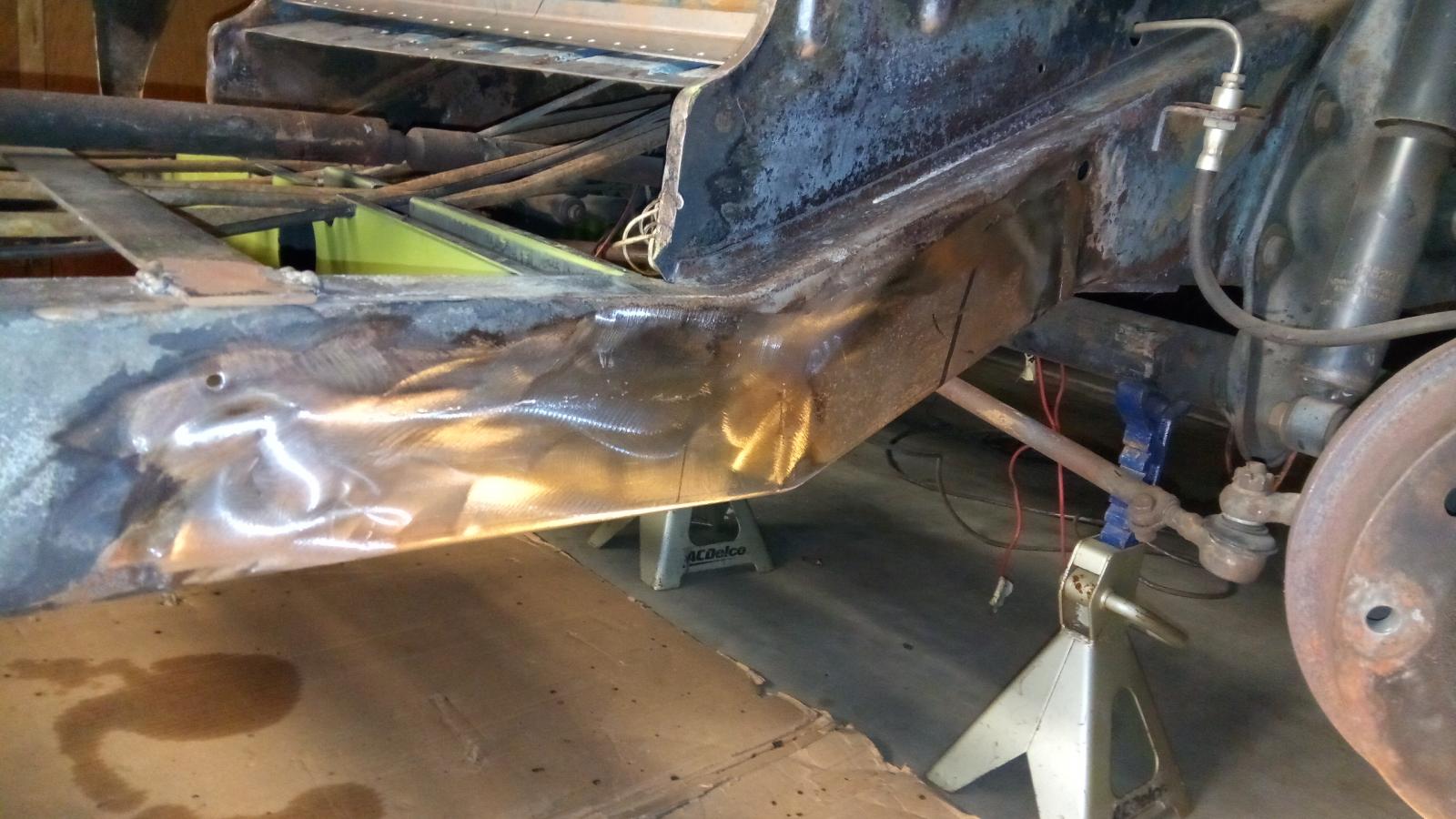

The middle closeout was pretty roached so I cut it out and made a closeout. The front tophat kind of sets where I can build out the rest of the rockers and front crossmember location.

The bus had been sagging on the passenger side way before I cut it apart, so I did some jacking, clamping, pillar pulling and squeezing to get it into position prior to final frame welding. I'm pretty happy with how it turned out and once it was welded, I released all the stuff and it seemed to stay put.
There were some pinholes, but once it's all boxed up with the inner sections, I feel like it is solid.

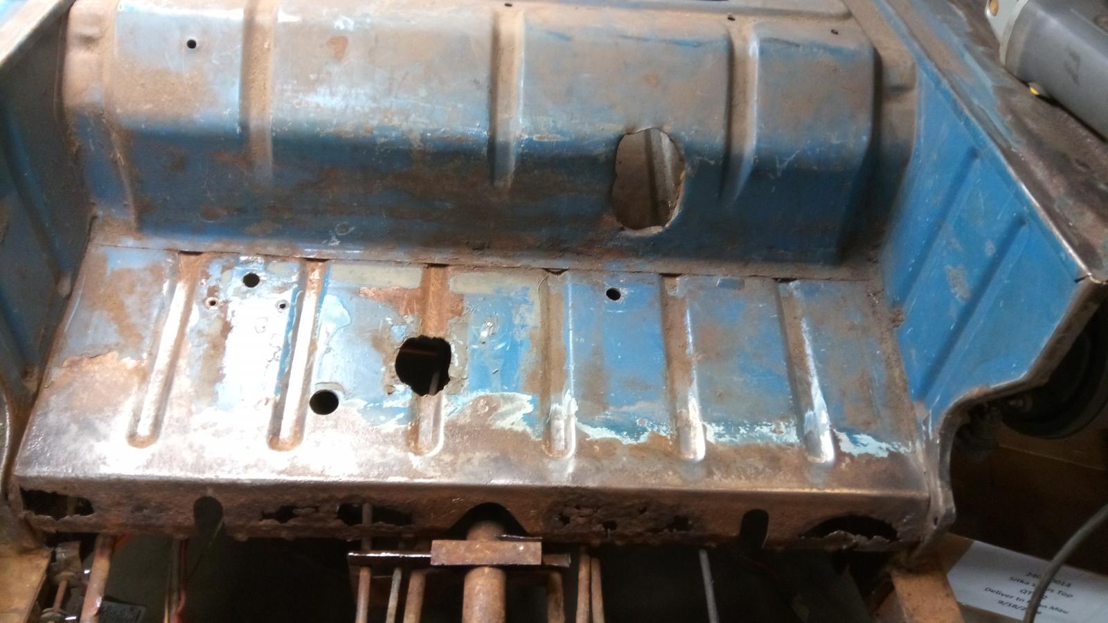

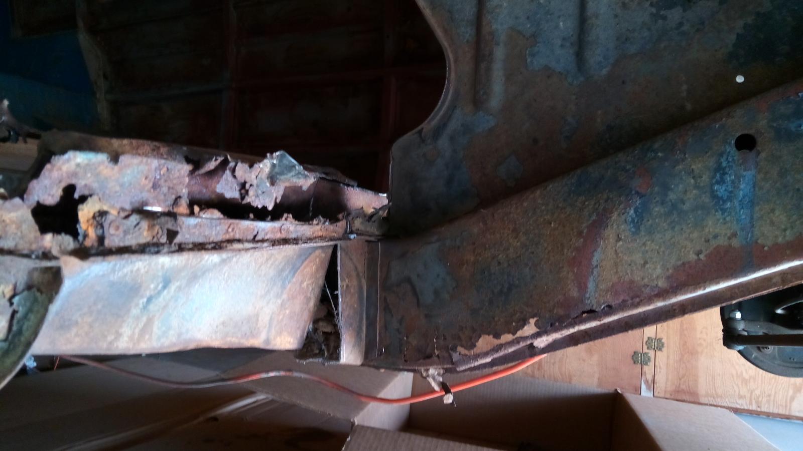

There were some strange hippy stash holes in the center pedestal. I plugged a few and left a few. Not structural, so I'm letting some of them ride. Strange though. Cleaned up some of the crustier parts with a wire wheel.

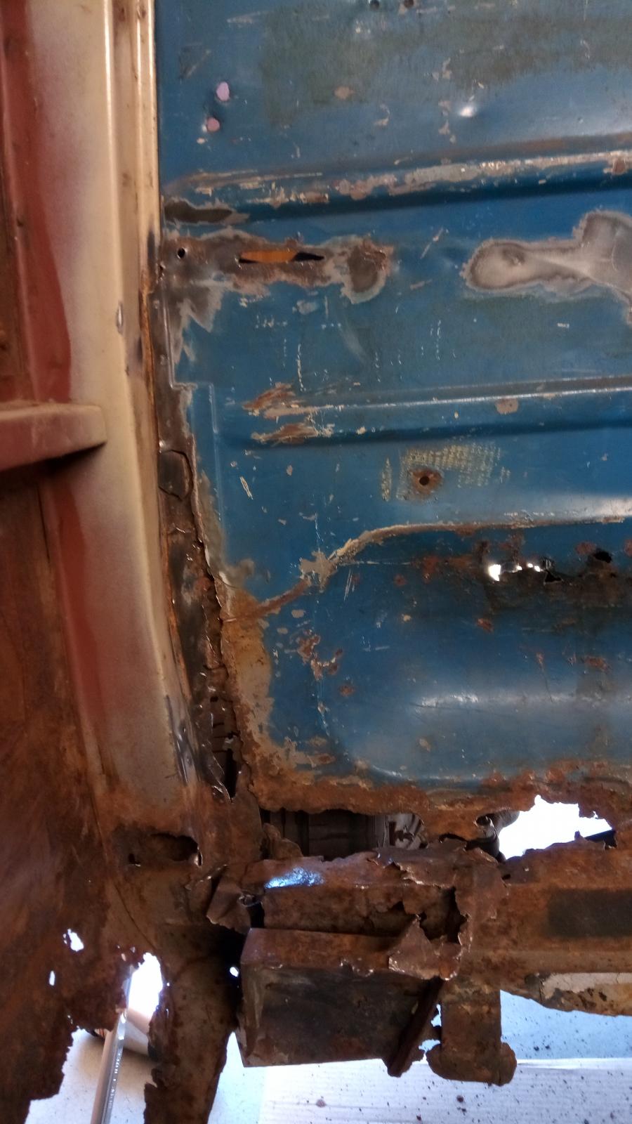

While dissecting the rear section, I found some pretty rough stuff, including some frame rot below the torsion housing I didn't know I had.

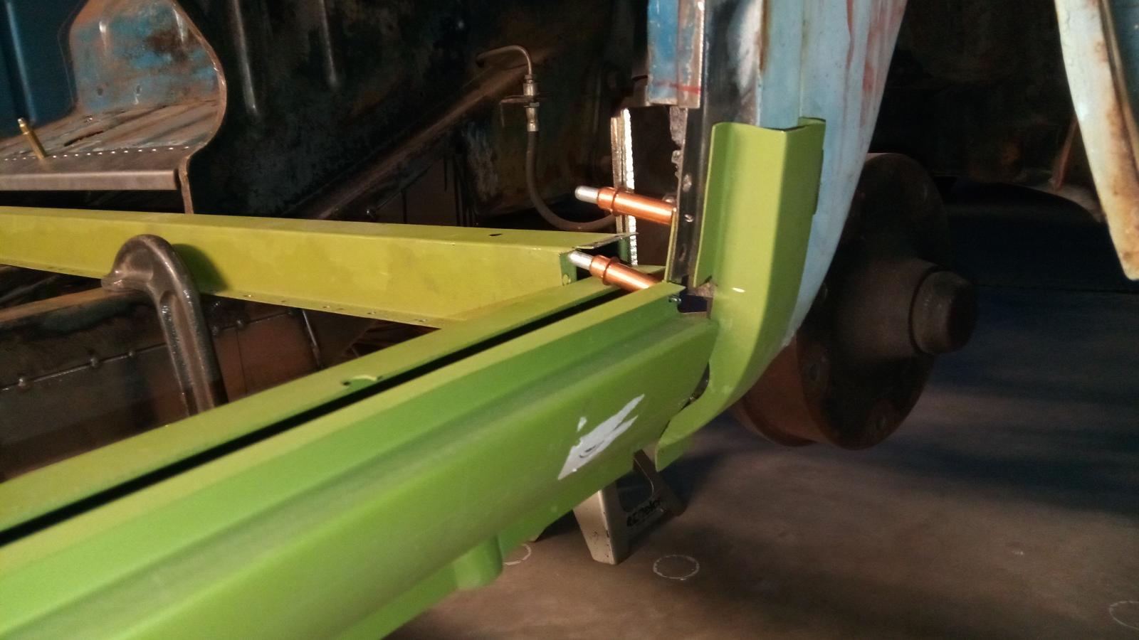

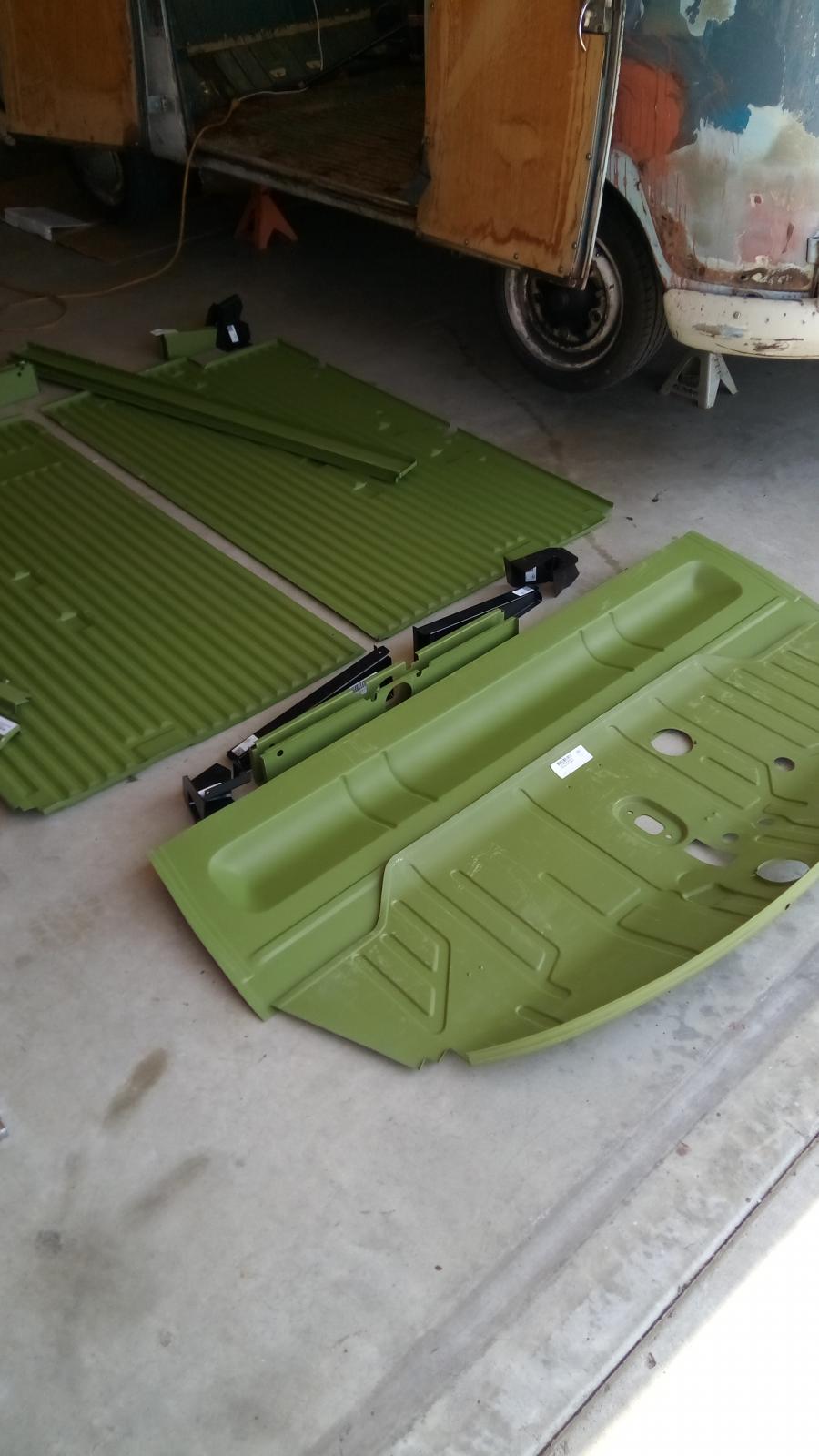

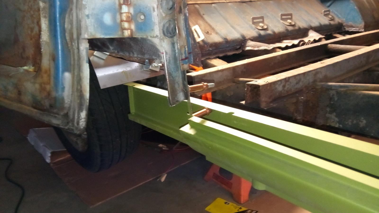

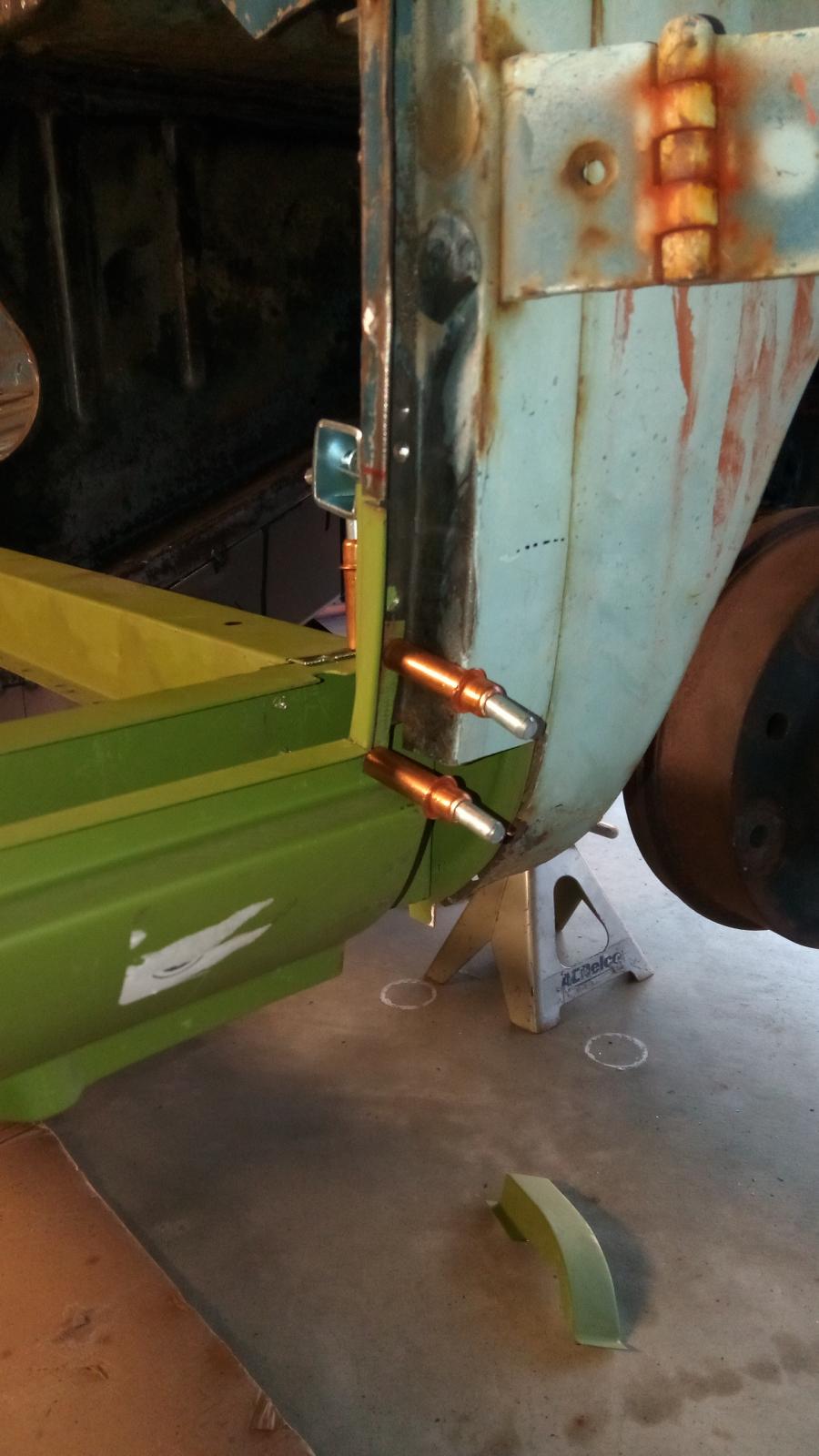

With the frame in place, I started to fit the tophat, front outriggers, bulkhead and inner rockers. Samba research led me to bend the rocker tab forward to make a 3pc sandwich with the tophat flange, inner rocker and closeout tab.
The autocraft outrigger didn't line up with the tophat, length wise, so I ended up moving the outrigger flanges a bit back.

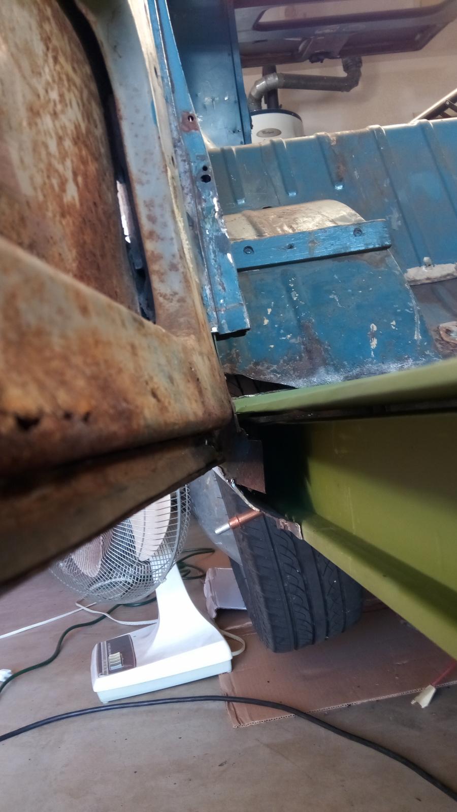

Setting the rocker tops to the I-beam and tophat plane, I begin to realize that my bus has sagged and will need some custom shit when it comes to bringing the inner and outer rocker seams together at the bottom.
In order to set the cargo rocker at the right height, it's going to be a little funky. B pillar and C pillar sections need to be at the right height, relative to inners and outers, so I have to get creative.

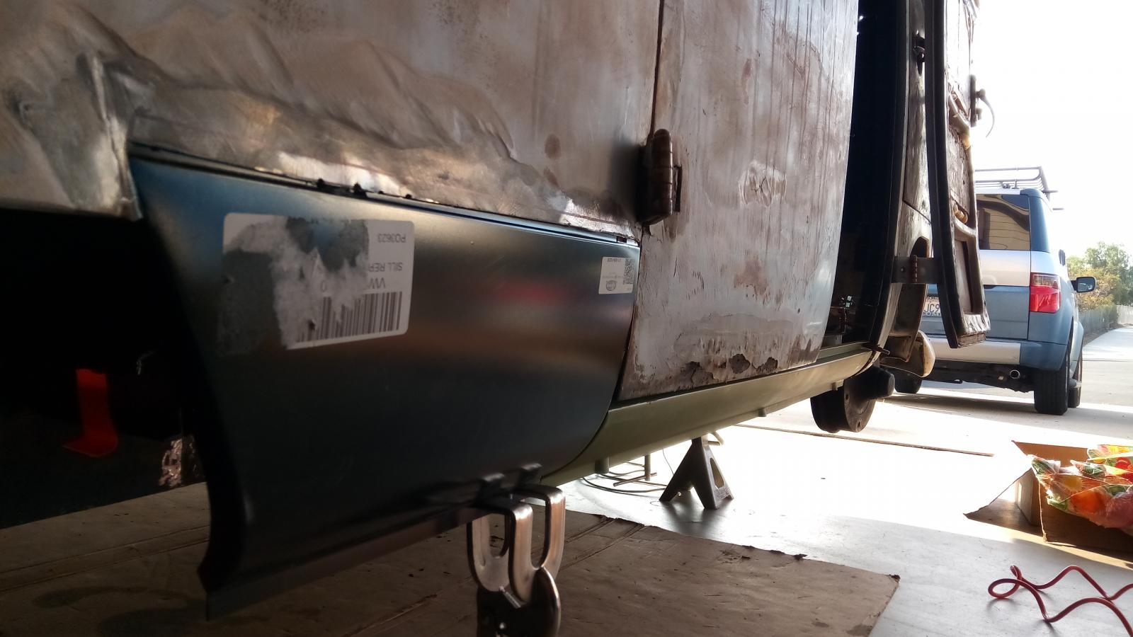

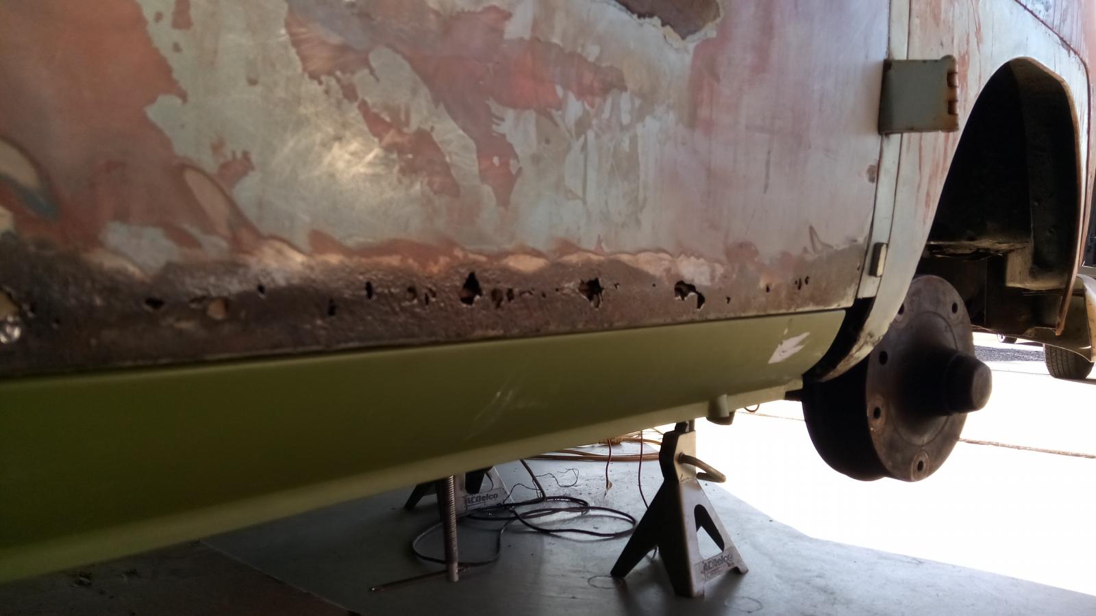

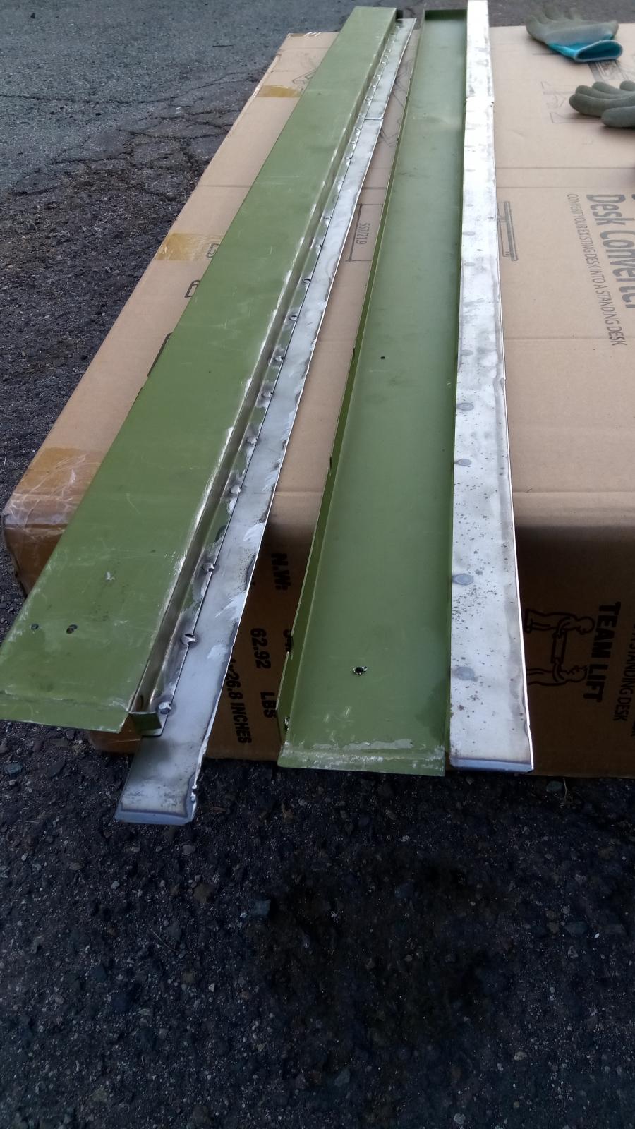

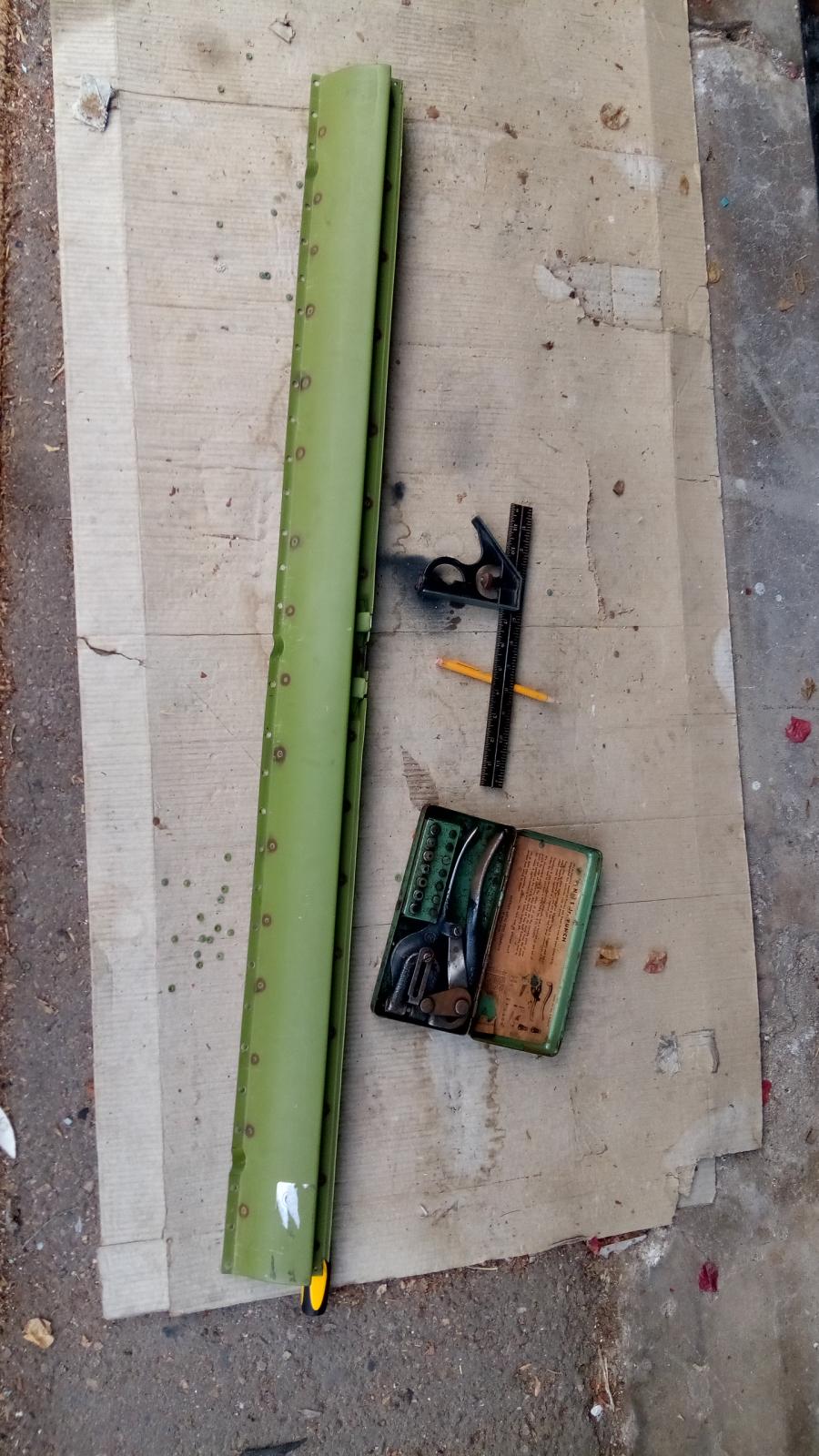

I painted the insides of the cargo rocker and stiffener before spot welding them together. A little protection because once they go together can't get in there.
Hung in the right spot relative to the lower door edges.
Got the short rocker all lined up. Lower C pillar fitted.
I was going to leave the long rocker, but it was too far gone, so it had to go.

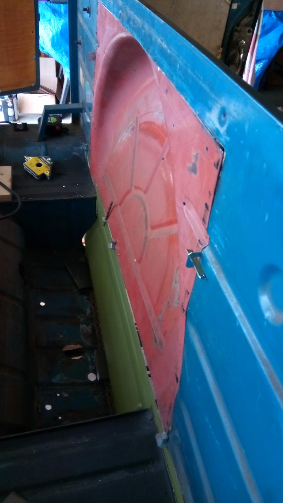

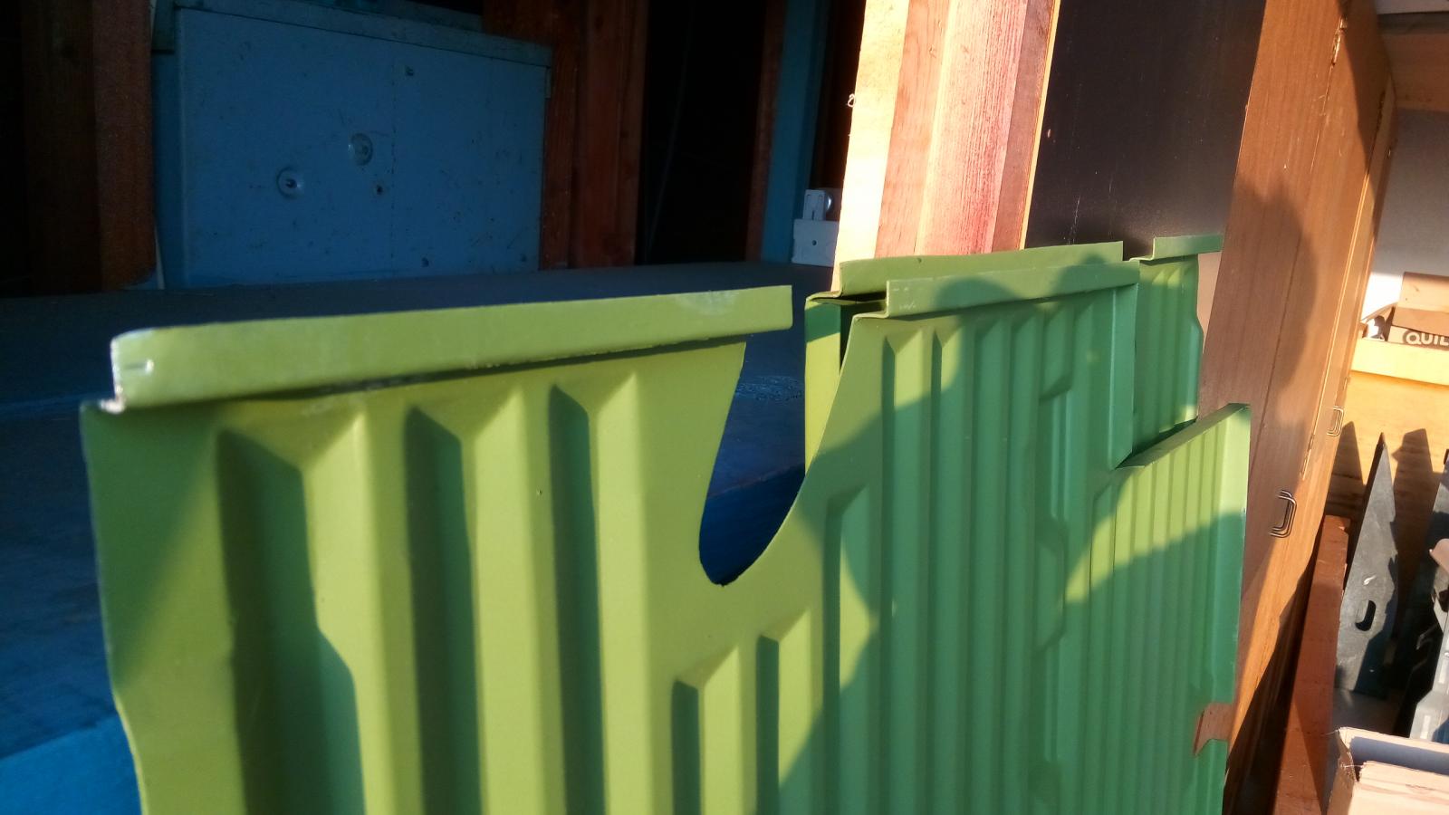

Lower bulkhead section fitment. It didn't fit well at the bulge, so I had to make some pie cuts and hammer it to close the gap.
To deal with the bottom seam mismatch, I spot welded some strips to the inner rocker bottom edge. This extends it lower and I can bring the outer rockers together at the bottom seam.

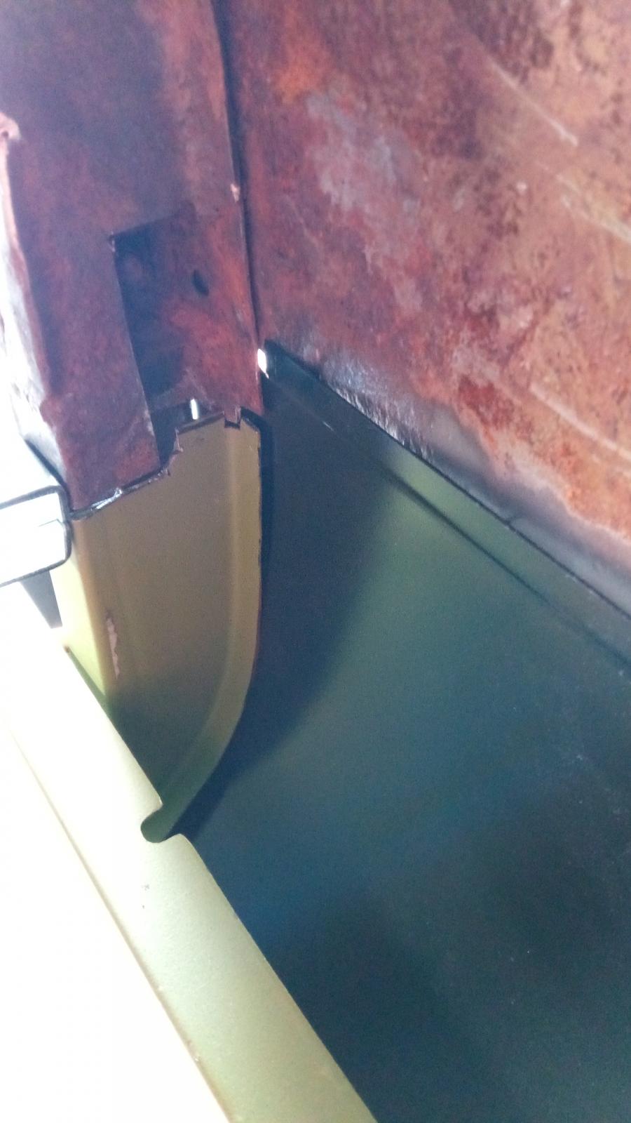

Thanks Karl H. Greetings from San Diego. Some more progress pics. Before the bulkhead goes in, I need to plug some hippy holes in the pedestal. These particular welds were done with a buddy's Miller 110V flux core. .035" wire. Not exactly a stack of dimes but it gets the job done and cleans up with flapper wheels.
Then I can start to final fit the bulkhead section in place, setting all the gaps for weld. There's not much pillar flange left, but it kind of all sandwiches together with the closeout panels.

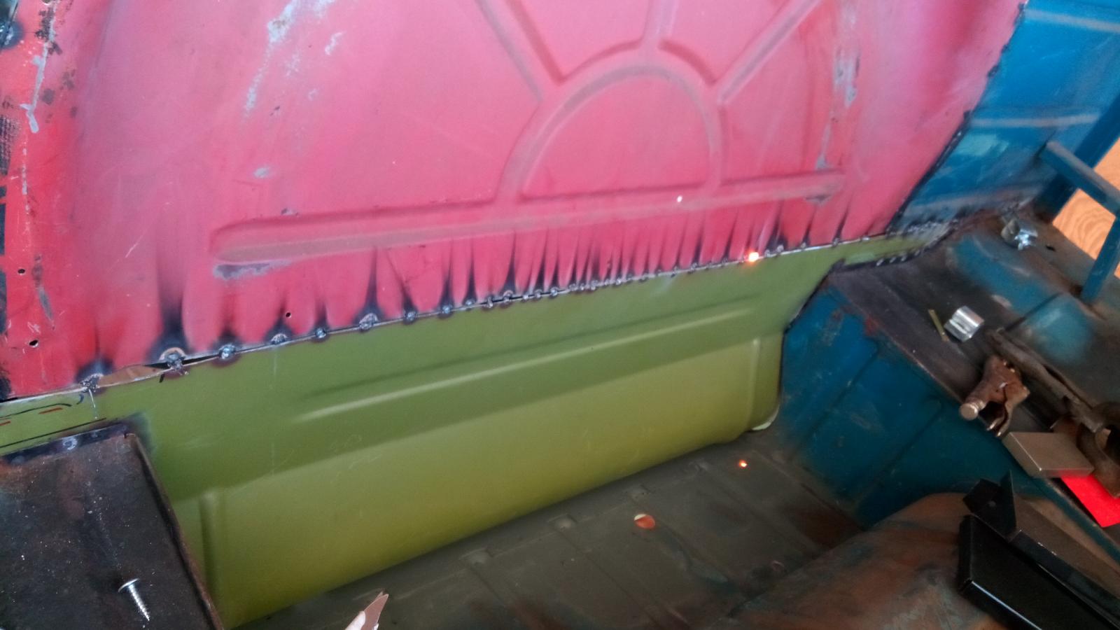

Flux core in action. This ended up being a shitload of welding. Hit it from both sides and then grind, then come back and do some pinhole filling. All while trying not to blow holes through the thin panels.
Converting back to 60 turn signals and tail lights. I been waiting a long time and collecting donor parts for this. Pretty sure I nailed the tail light location because the bottom of the original hole was still there. The bullet orientation, I'm not so sure, but time will tell when I put together the outer housing and lens.
