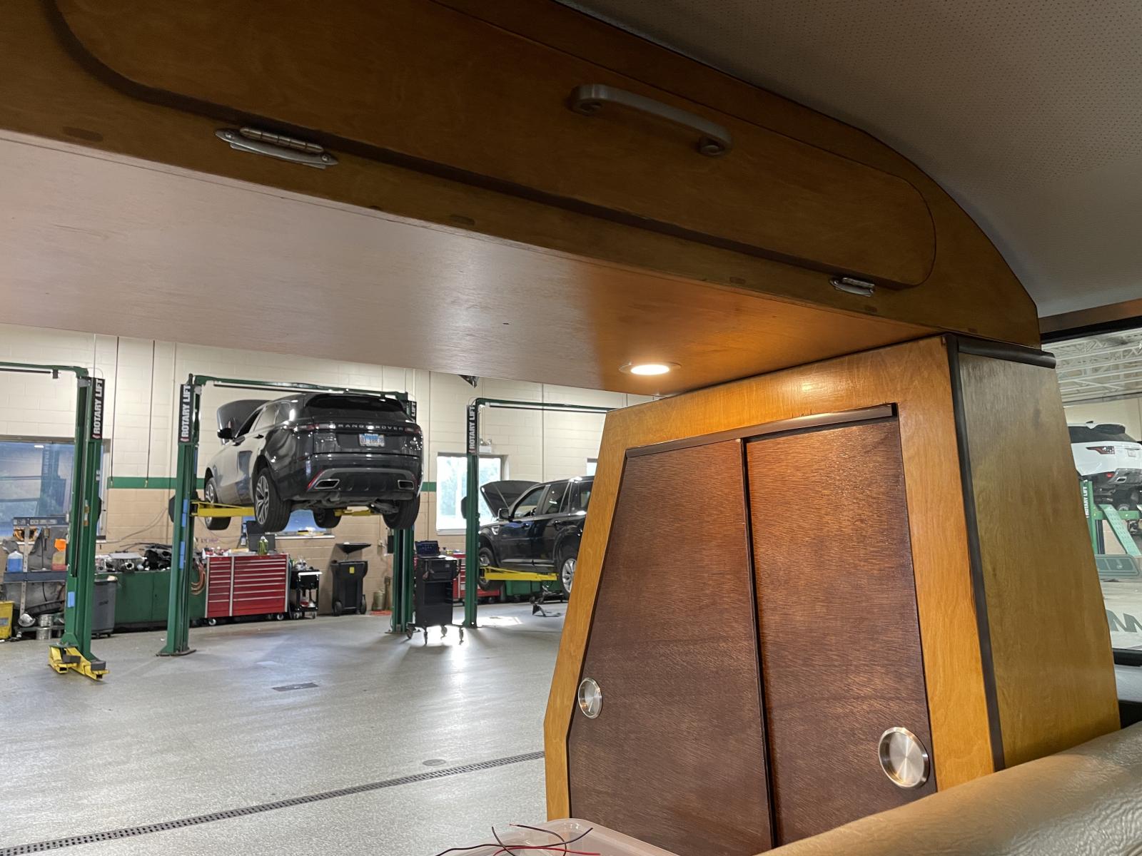

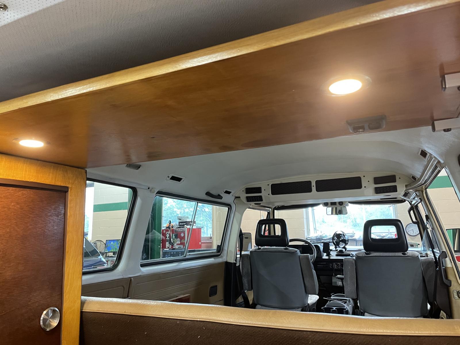

Finally finished wiring up the rear LED light I installed a few weeks ago.

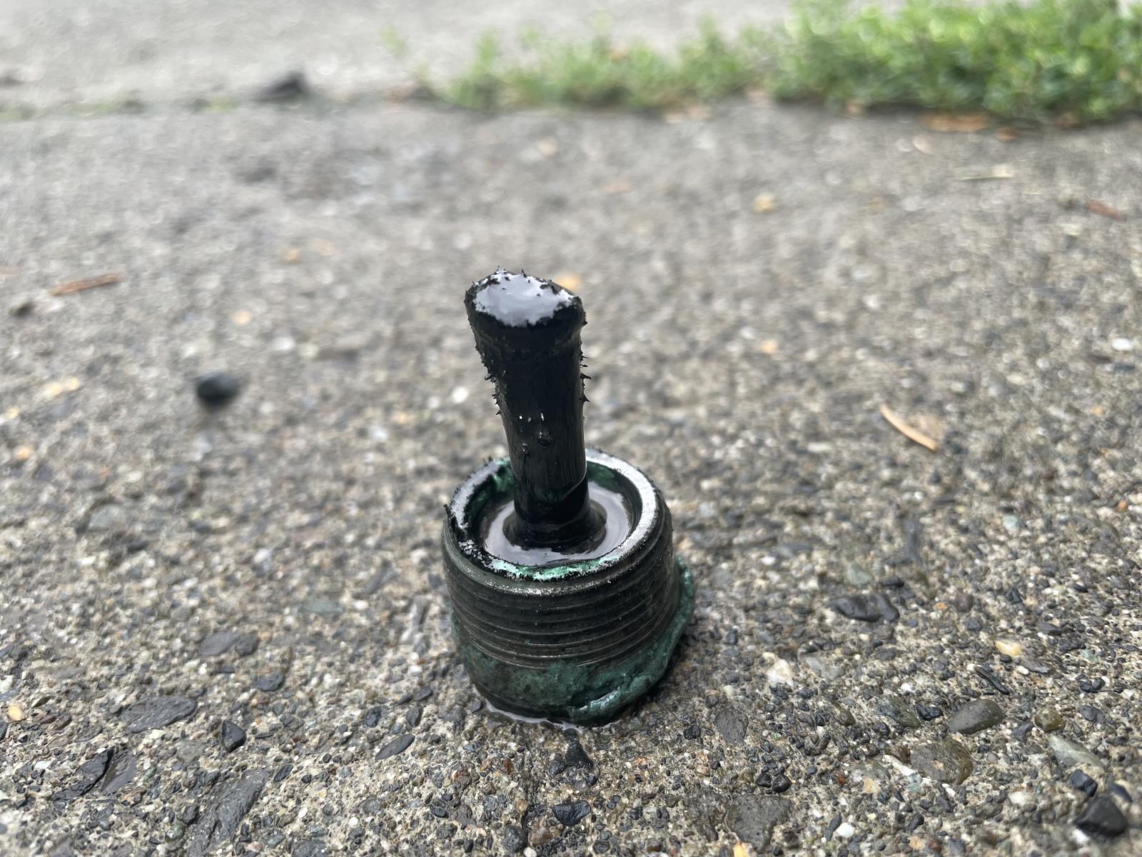

Got the oil in the transaxle changed. After seeing some of the pics of other peoples' drain plugs I was expecting a fuzzy caterpillar but was pleasantly surprised by the lack of swarf on mine:
I'm hoping that the fresh oil and that I was able to add a little extra due the slope of our driveway will contribute to reducing the gear whine I've noticed since I've finally started to be able to drive this thing around. <fingers crossed>

I'm just a dude on the Internet, but I would not overfill. It could cause a higher pressure than the seals can take.
It's best to have it on a level surface and wait until it drips occasionally before inserting the plug.
