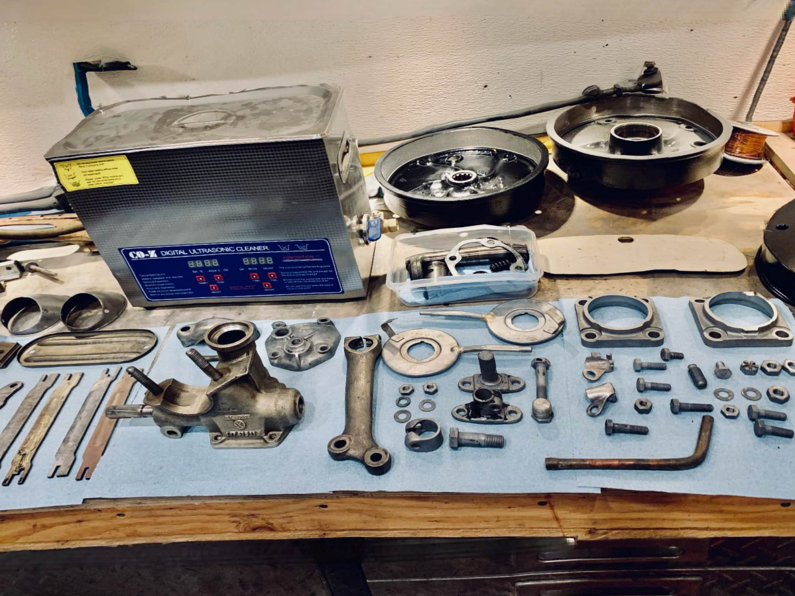

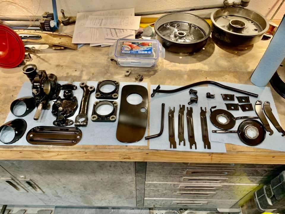

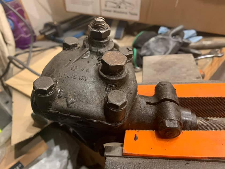

some progress with the steering box clean up with some of the brakes components.
I have used my ultrasound cleaner, with hot water, Lysol toilet cleaner and baking soda. not more rust and grease.

working on the details:
-> Black oxyde

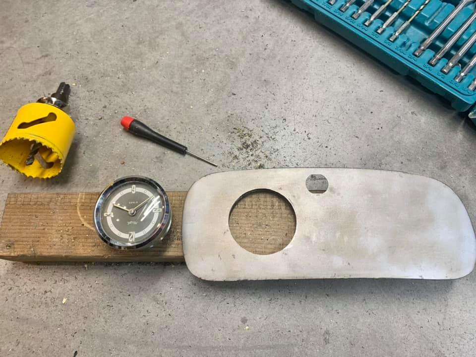

some random work,

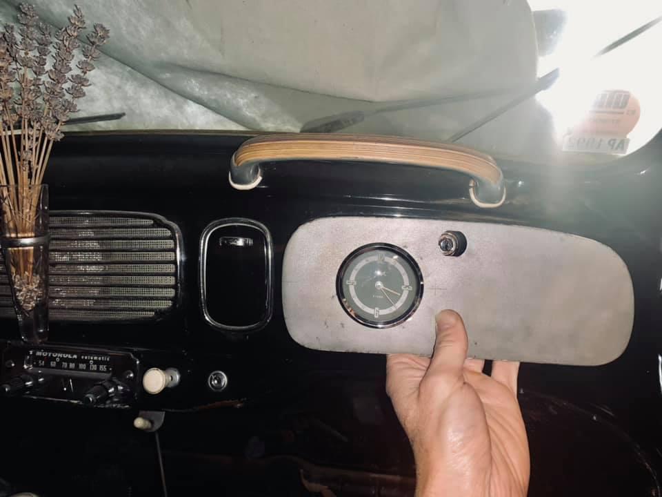

I just installed a kienzel clock:

also restored the stearing box
Before:
during:
After:

PostPosted: Thu Oct 21, 2021 3:25 pm    Post subject: Re: Original 1956 Oval convertible Reply with quote
Great stuff! Nice job on the glove box cover, bet you spent some time wondering about cutting a hole in the OG door!?
I did the cut on another cover i had in spare. I did not want to cut the og paint globe box door Smile

interesting your pitman arm has the upward bend. I thought those were only on early Ghias.

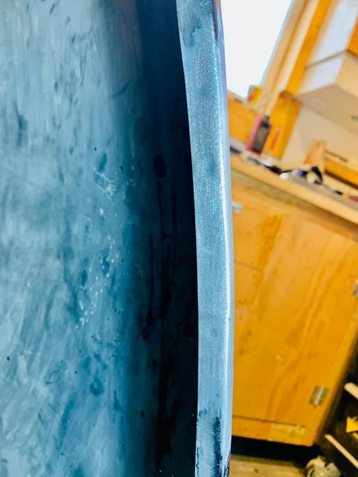

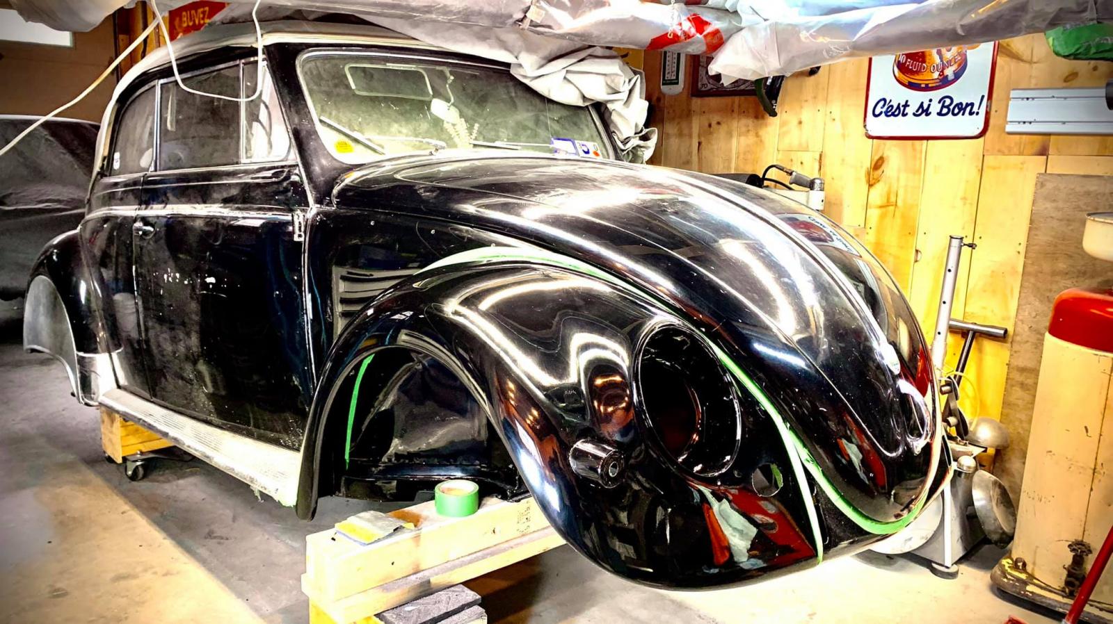

Here is a bit more update.
I just started to wet sand and buff the front quarter panel:
I water sanded with 1500, 2000, 3000
and used CSI polishing product.
1500:
2000:
3000:
final result:
[/img]

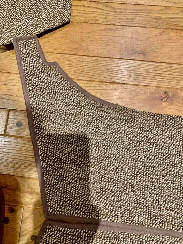

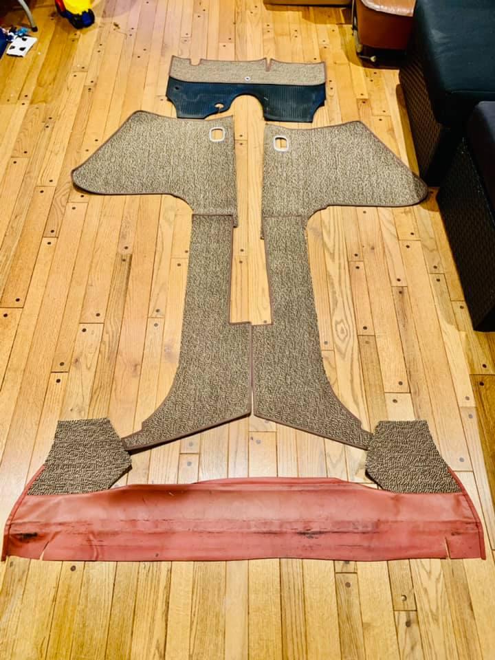

I just received my restored carpet from UK.
result looks great.

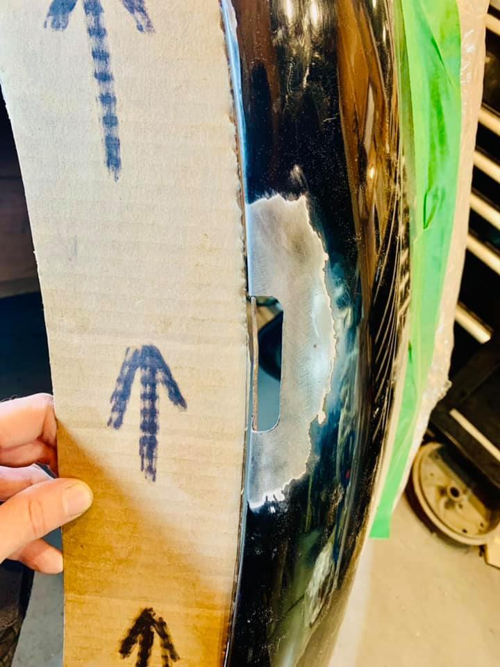

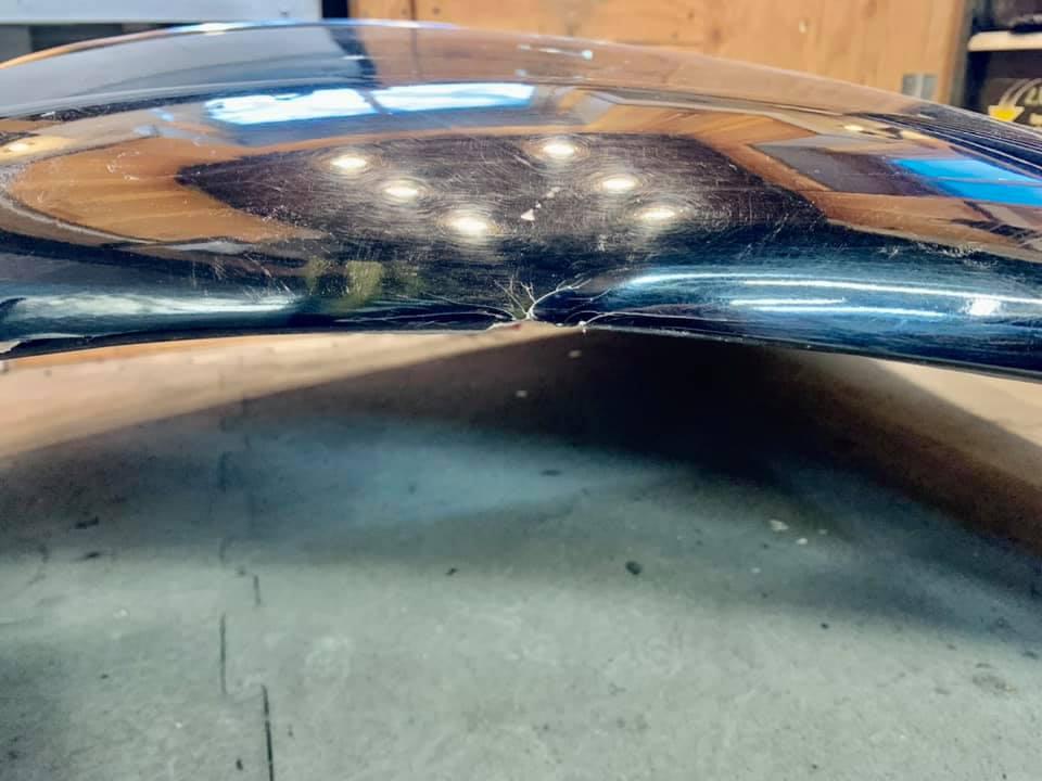

PostPosted: Sun Oct 31, 2021 5:21 pm    Post subject: Re: Original 1956 Oval convertible Reply with quote

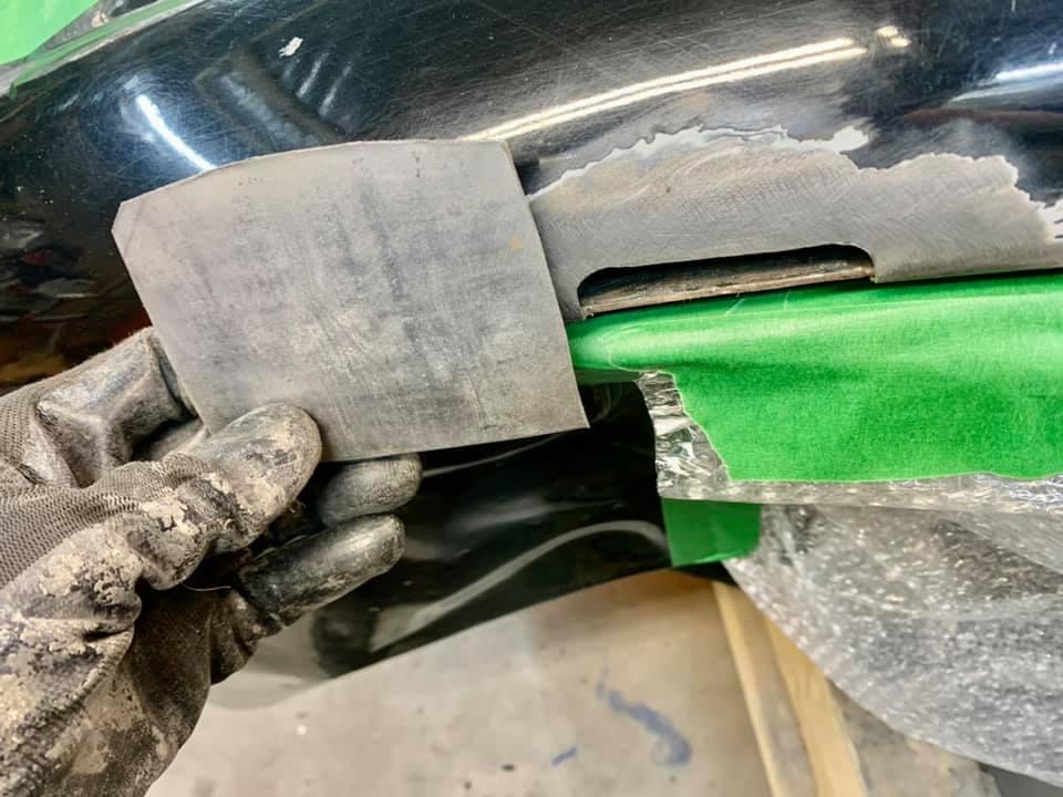

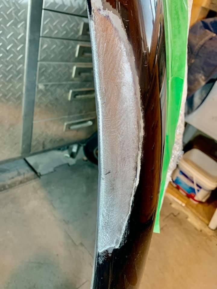

Here is a bit of update with a small repair on the front hood.

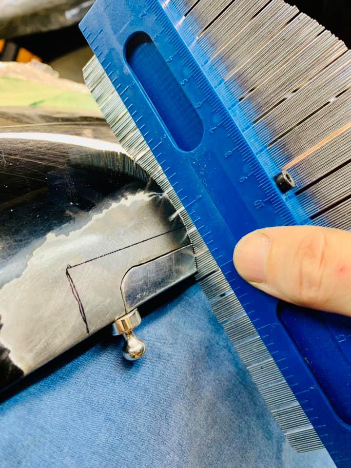

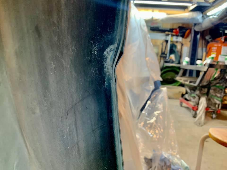

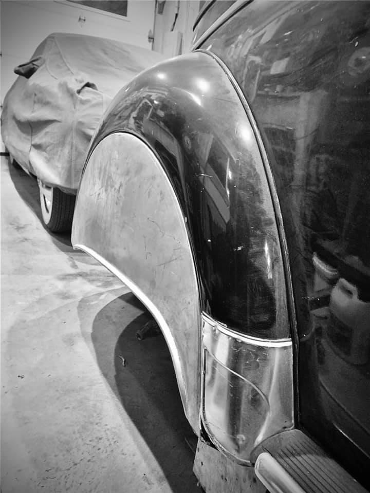

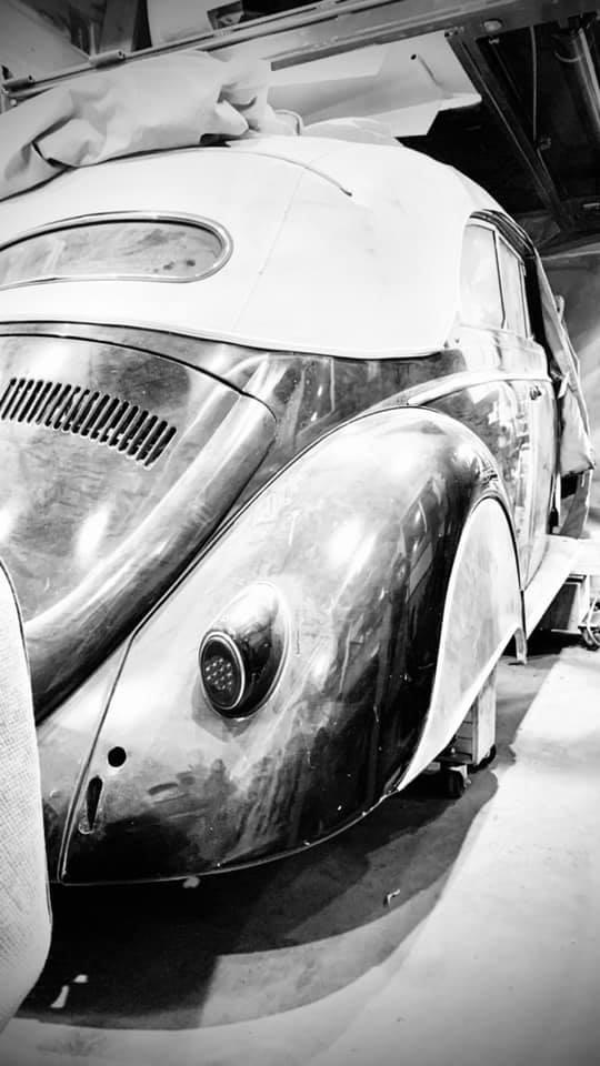

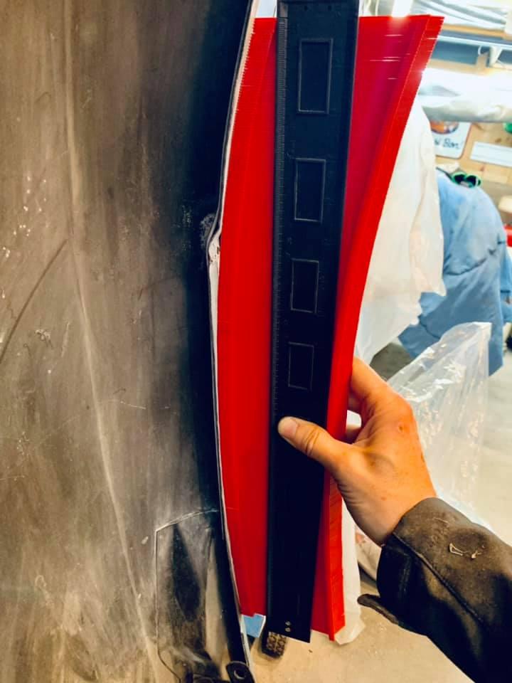

PostPosted: Tue Nov 09, 2021 6:10 pm    Post subject: Re: Original 1956 Oval convertible Reply with quote

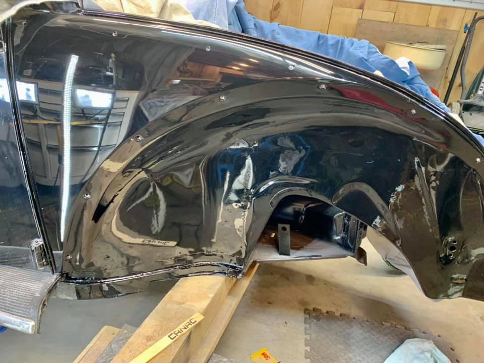

here are some pictures the fenders skirt I just started fitting. result should be great.
result looks great.
As usual, stunning work you are doing!
Question: Did you order new carpeting cut, edged and sewn to your original red vinyl and rubber front wall mats, or is that your factory original carpet cleaned up? And who provides this service in the UK? Looks great...

PostPosted: Wed Nov 10, 2021 12:30 pm    Post subject: Re: Original 1956 Oval convertible Reply with quote
Hi Bill,
I sent my original carpet so Dylan could re-use what ever was re-usable like the red leatherette, and aluminum rings for the heather holes.
we used the OG carpet as template to cut new carpet with the exact shape and color, same for the edges, he had different color available so we choosed the one the matched the best.
the rubber mat is new from Germany it is a very accurate reproduction.
So at the end the carpet is new but all of the specific details have been redone like the original one.

latestest progress,
the front hood is now blended and back in place.
working on cut and buff the fender before assembly
