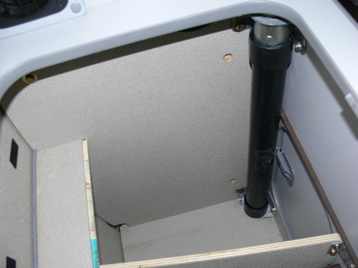

MsTaboo wrote:
Here's a pic of our solution, pretty much the same as everyones. Just a piece of ABS plastic and a couple of fittings. A little plastic filing in the corners but no metal work.
Yep, easy pleasey.

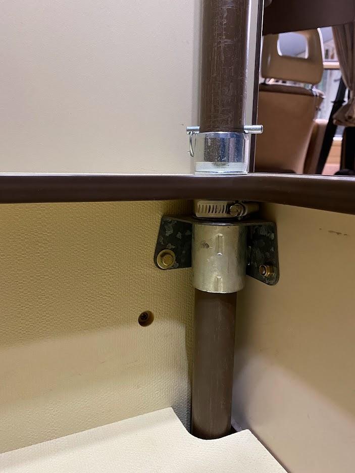

This is such an awesome modification and my hat's off to Sodo for doing this and starting this topic!
I just did mine. In stock I had both 3/4" Sch-40 PCV, 1" EMT conduit, which others have shown both work. I also had some aluminum tubing the same OD as the steel conduit and decided to use that. At Lowes bought a plastic fitting to fit between the bottom of the aluminum tube and the original plastic fitting at the floor. Fitting is a 3/4" PVC threaded nipple 1-3/8" long. Spent about 3 minutes filing the threads down partway to make a great press-fit into the aluminum tube. Then I turned what should have been another 5 minutes filing the other end into 30 minutes. I filed until I thought it was about right and found it was still too big. Repeat about 6 times until sufficiently filed! Very Happy I was just a bit too conservative about how much should some off and should have been more aggressive. I added a piece of electrical tape on the clamp plate that goes between the clamping screw and the leg tube, hoping to protect the tube's paint. Works GREAT!
Cost $0.52. No, wait. With tax $0.57! (Not including the aluminum tube I had in stock.) Laughing
New paint on the leg tube is drying now. I found a grey color I like. Rust-Oleum Painter's Touch 2X Ultra Cover in a color called Satin Stone Grey. Not a close match for the original leg color, but I like it better.
Thanks again Sodo and others who lead the way on this mod!

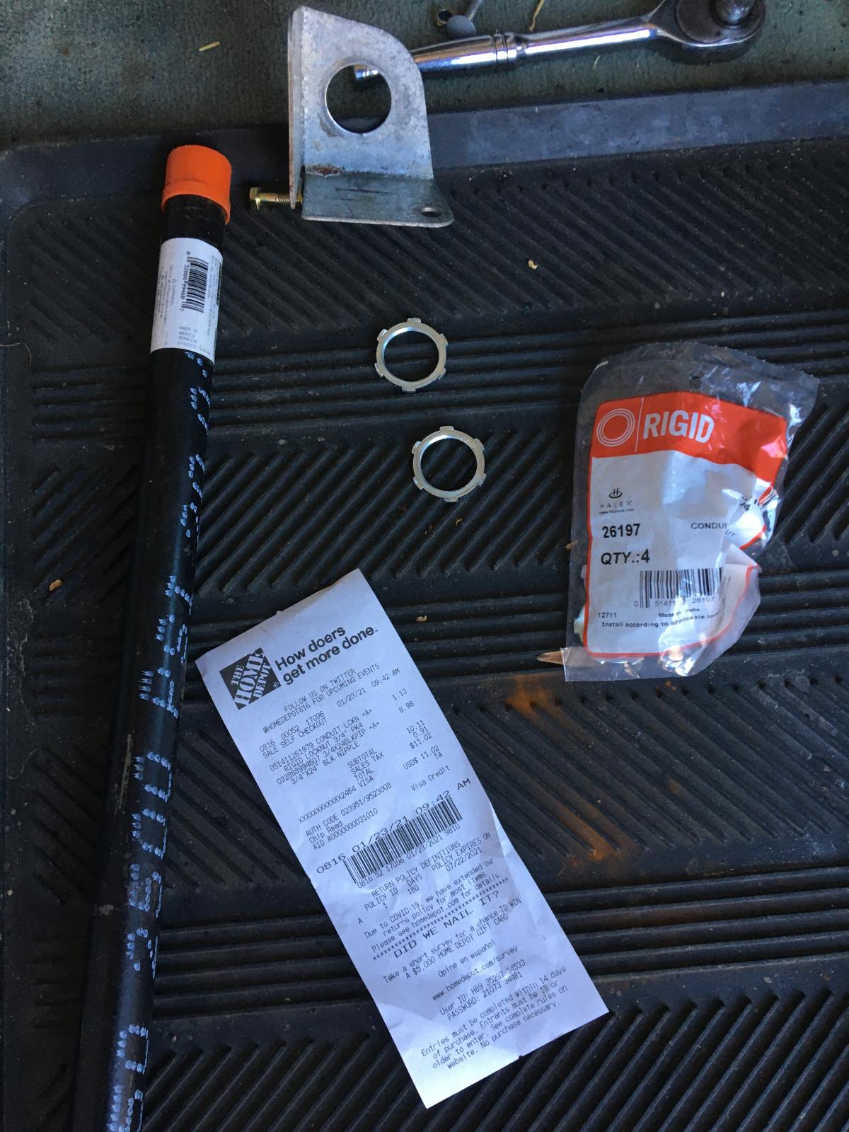

This worked for me:
2' of 3/4" black iron pipe. Cut the threads off of one end of the 3/4" iron pipe if you want to do the bushing and pin to allow the table to pivot in the raised position. I put the orange cap back on, it takes up the slop. If you just want the extension, no cutting needed. Plug and play
The bushing is a grey pvc conduit reducer 1-1/4" to 1" The bushing had to be enlarged with a forstner bit, I don't recall the size. Well clamped and on a drill press. A spade bit I wouldn't try. Cleaned it up on a spindle sander. I forgot to take a photo of the bushing prior to enlarging and belt sanding

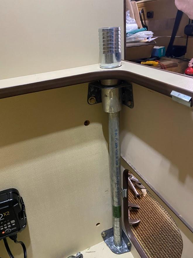

I used Povi's method, but had trouble enlarging the pvc conduit reducer.
Used a galvanized 1-1/2" insert coupling that fits perfectly. The coupling sits on the existing bracket for support. A hose clamp to keep it in place.
I did need to file down an interior ridge on the coupling and chose to cut one of the barbed ends off to reduce height.

Wellington wrote:
has anyone considered cutting the table shorter, just enough to clear the swing of the closet door?
prior to this vertical slider mod, i used the front table in the rear. repositioning the mounting plate allowed the door to be opened anytime.

Thank you all! This is a great addition/modification. I just did it with PVC pipe 3/4 in, and covered it with a closet rod plastic cover that I had lying around to get it to just about the right diameter.

[quote="jimf909"]I was researching the adjustable table height mod and saw this about the magnets. I too tried small magnets but they didn't hold 100% of the time so I added a much bigger magnet, screwed into the c-pillar with a metal strip on the table. This has held 100% of the time for about a year.
Neodymium magnet...
https://www.amazon.com/gp/product/B013L36SXA/ref=ppx_yo_dt_b_search_asin_image?ie=UTF8&psc=1
Screwed to the c-pillar
Metal strap on the table
Thanks for suggestion. Installed- works great.
