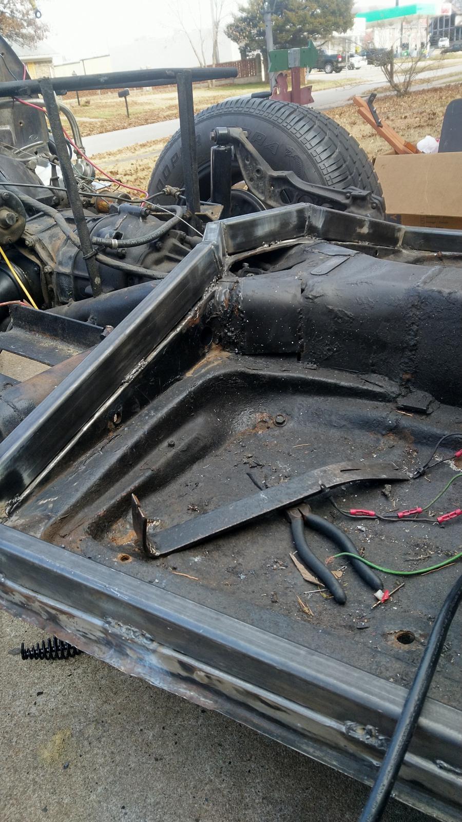

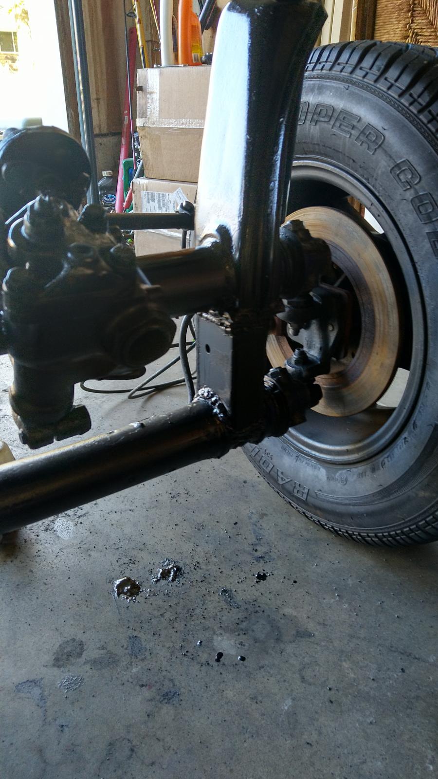

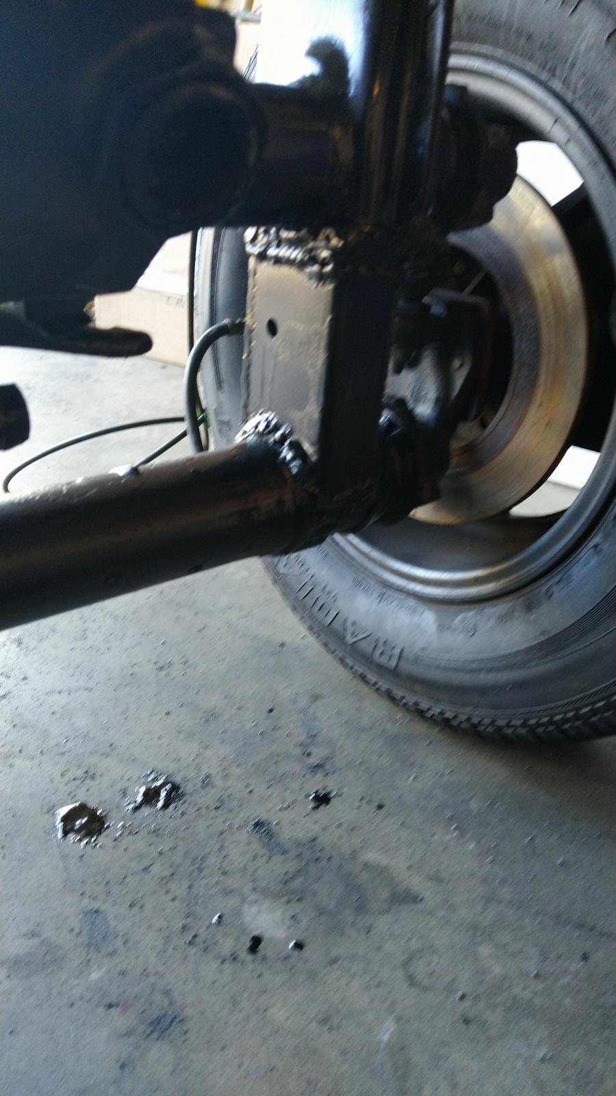

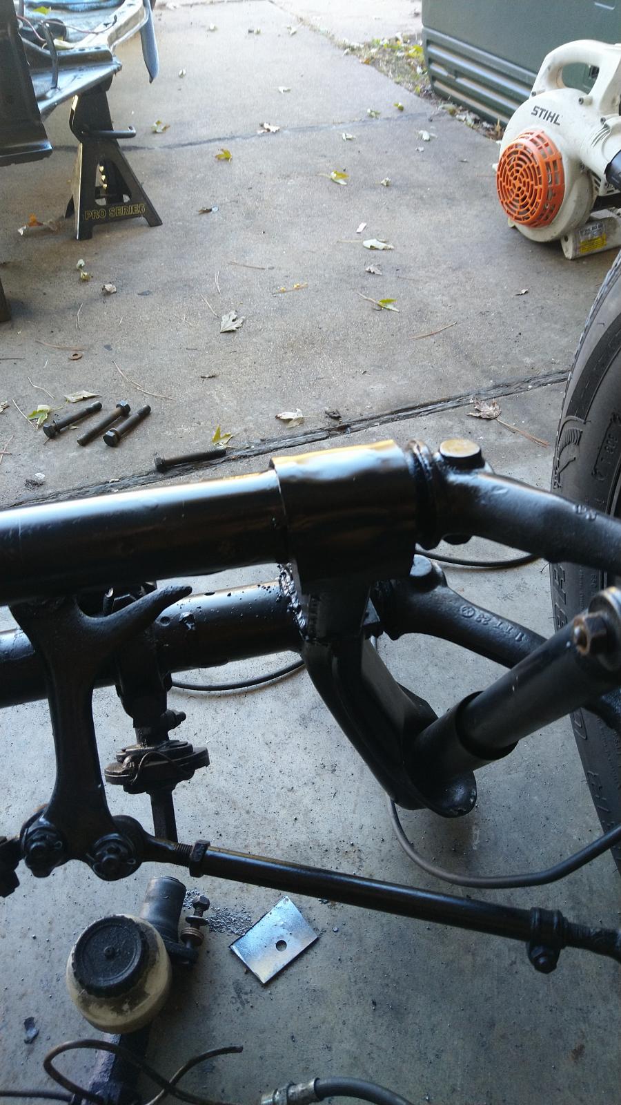

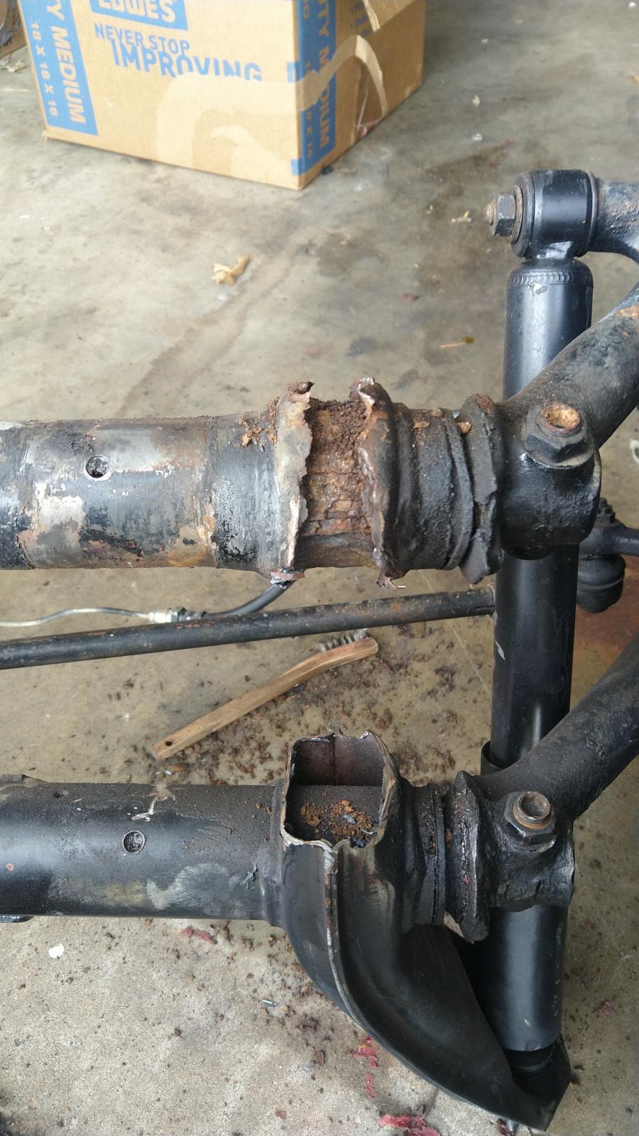

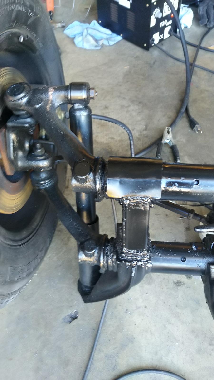

Well I had some time to look at the rust issues and started poking around to find it was way worse than it looked. I thought about getting a new front beam but finances and Christmas coming up with 5 kids says I can't.
So I decided to cut out that entire section and build a new one. I used 2x4 tubing. The stuff that was there was VERY thin, not sure if it was supposed to be or not. I cut and welded in the tubing. Where it connects to the existing part I put in some plates to mount to. Full disclosure, I have never taking a welding class and kind of suck at it. Not pretty but it's functional.
After welding in the parts I bent some 1/8" plate around the bottom of the tube and welded it into the 2x4 to tie it all together.
Then I did something that might be bad. But it worked. The top beam already had 6 leafs taken out so at first I pulled 6 from the bottom but it was WAY too soft. So I cut the middle out and turned it about 1.5" and welded it back in and put all leafs in the bottom. Looks like it's at the hight I wanted. Painted it all and put it back on.
I'm not 100% this is going to work good for the long term but there is only one way to find out.

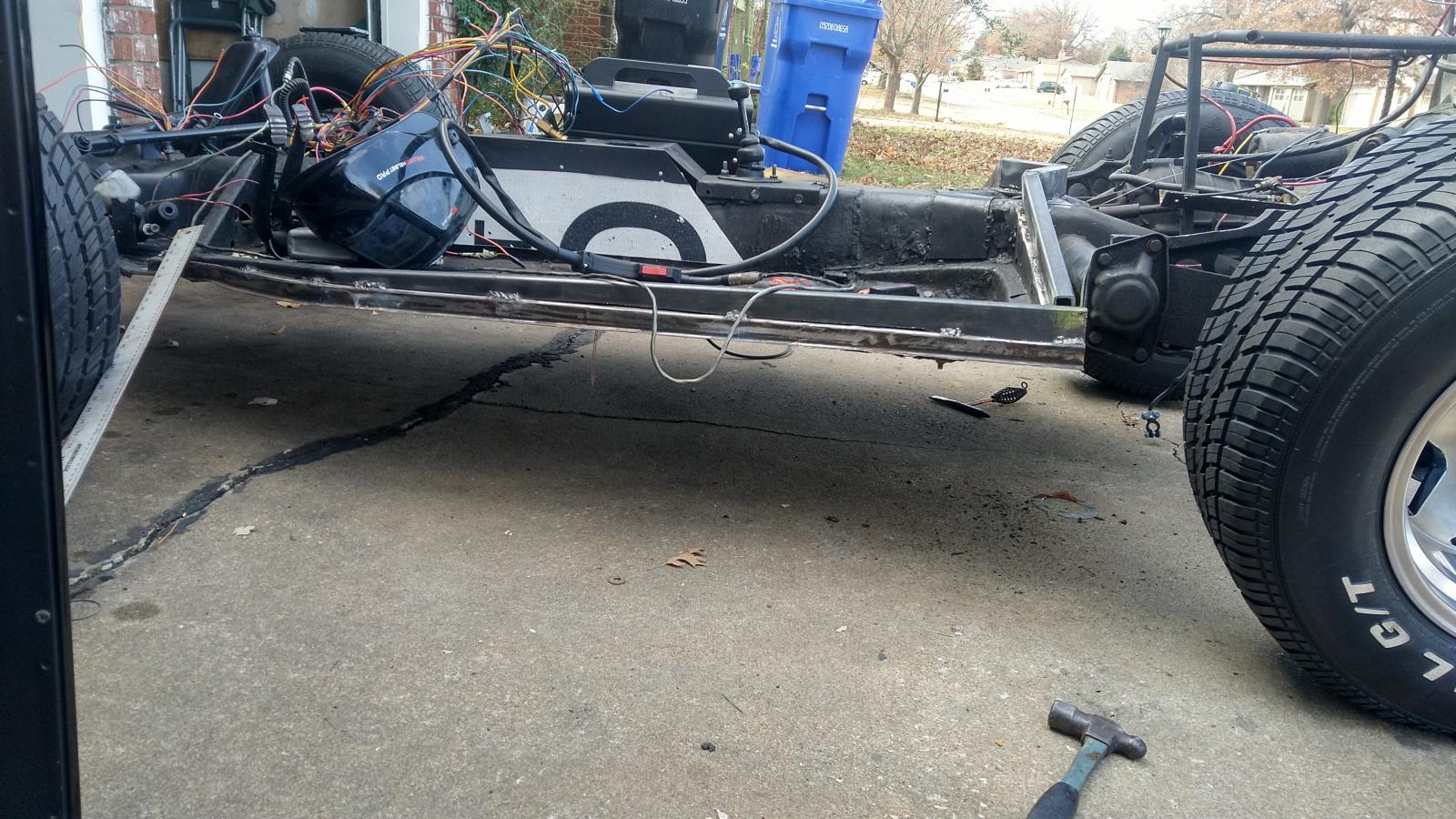

Next I'm probably going to shorten then clutch and brake pedals and then box the frame. I kind of have a strange idea for this. It seems that typically when boxing it's done from the under side. I am playing with the idea of doing it on top for 2 reasons.
First my rear tires a pretty big and to be able to drive without rubbing the body it has to be jacked up high and being swing axle means lots of positive camber, looks silly to me. I also plan to put on adjustable spring plates to get a more precise ride hight.
Second I want to have the car with an aggressive looking stance. I plan to do this by using 2x2 tubing and tapering it. Basically have full 2" body lift in the rear tapered down to 1/4" in the front. It might look silly not sure but only one way to find out.

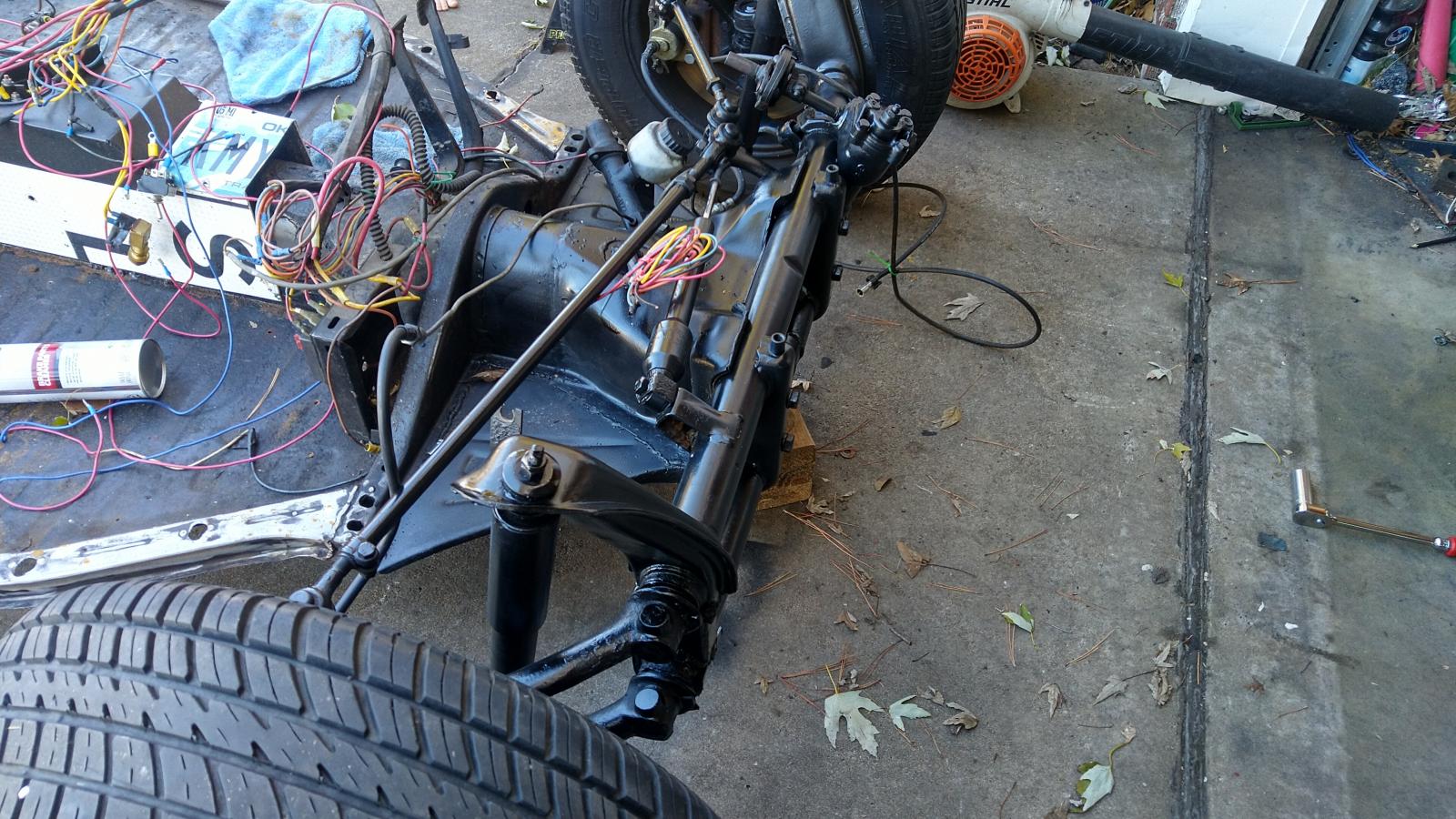

There are needle bearings and phenolic bushings inside that beam. Welding the heck out of it while assembled might not be a good idea.
I disassemble the lower beam after putting in the bars in the middle so I could clock the center part down some to lower it and applied new grease. Didn't see anything messed up and it went back together pretty good. Pain in the butt to get the leafs to line up and go back together in the exact right spots.
They are just shock mounts. They don't need to be heavy
That's fair but I just used what scrap metal I had laying around, best option I had. I don't have a lot of disposable income so any place I can save money I do.

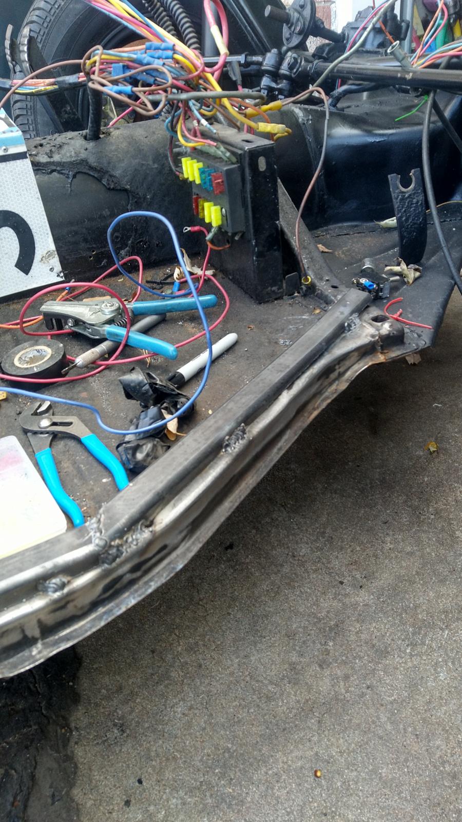

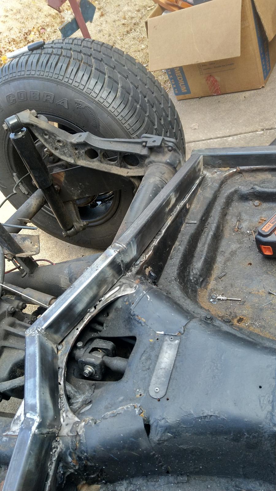

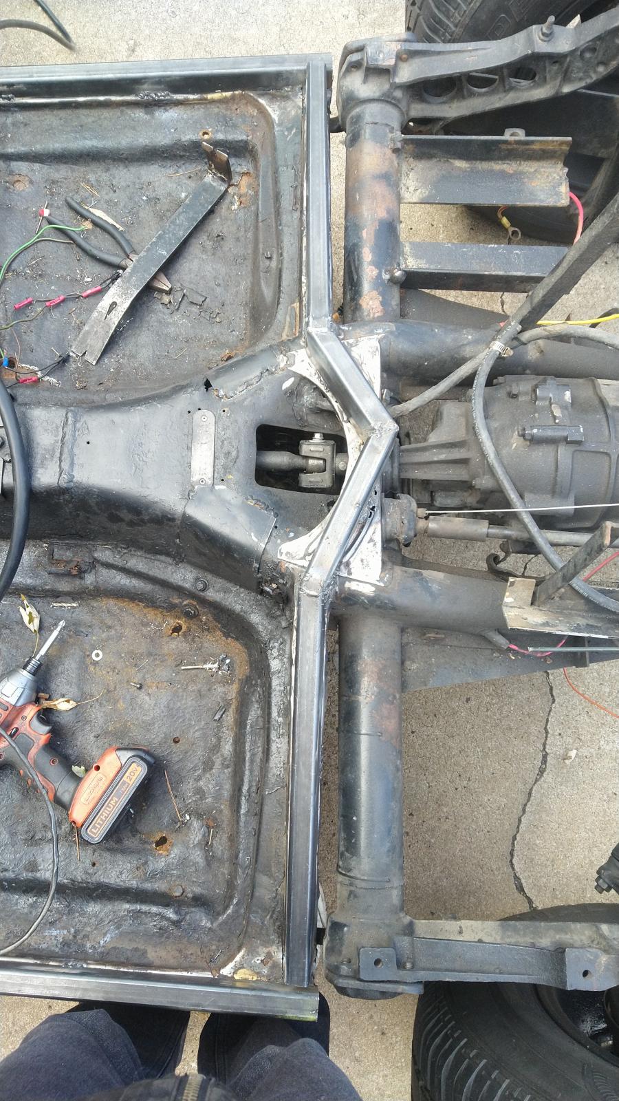

Been a while but got some more work done on boxing the pan. Not fully done but have most of it partially welded in. Going to fully weld it where the tubing meets the pan just got to get more wire first.

Been a bit. Now have the body back on for now. Only 4 bolts holding it on. Also got it sanded down the majority of the way and patched the large holes with fiberglass and long strand bondo to level it all out. Still have more sanding to do then start the painting.
I need to go through and do all the wiring too but I am not looking forward to that. Right now everything is direct powered through the fuse box. All the key does is start the car and everything has power without the key. That will probably be what I work on over the next few days. I hate wiring...

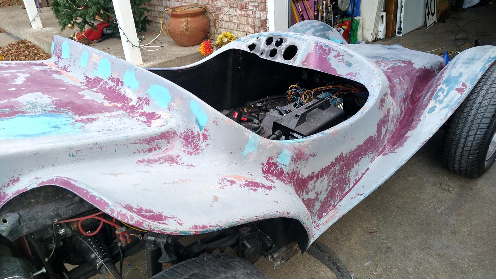

Been a little while. I had lots and lots and lots of sanding, fiberglass and Bondo work to do. But I am happy with it and primed it today. Now I have a lot more sanding to do before more paint it's coming along though.
I made the inner fiberglass part have a smooth transition to the outside and now it looks like all 1 I am also going to paint the inside. Before it was just black and the outside was purple. I'll attach some photos shortly

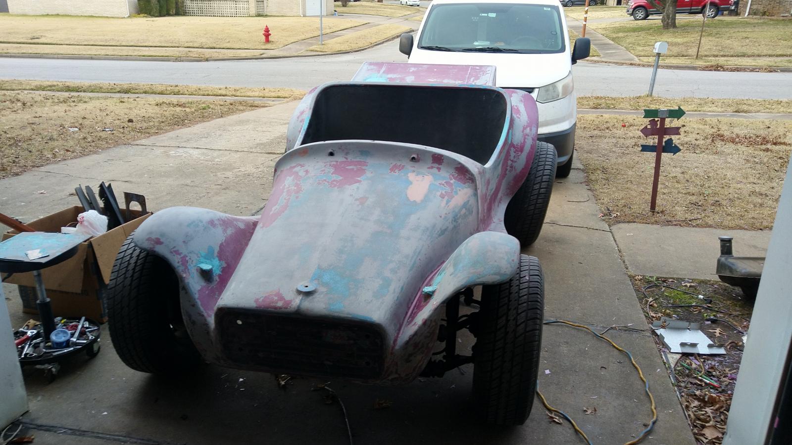

So I started sanding the primer today and here are a few things I learned.
1: ouch! Block sanding SUCKS.
2 I hate old fiberglass,
3: older fiberglass sucks to paint and I should have skimmed the whole body first. (See pictures)
4: ahhh my arms are killing me and might fall off.
5: when something looks flat it definitely isn't. Guide coat is great and a pain in the but too.
6: probably going to have to do some more Bondo work and prime it again. But use guide coat before I primer and not just after.
