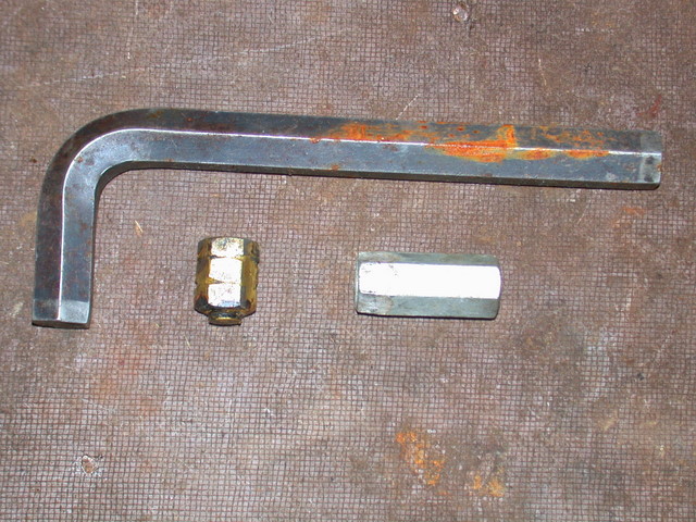

This works well for getting at the fill and drain plugs:
A few more options:
I now have thanks to ebay the tool that VW designed to do this. It will get into some pretty restricted places.
How about a pic and part number of that one Smile

vanis13 wrote:
I just watched Ebay until I saw one that was actually being auctioned and I was able to get it for cheap, something like $12 with shipping.

Wildthings wrote:
vanis13 wrote:
https://www.google.com/url?sa=i&url=https%3A%2...AdAAAAABAD
ah, a 17mm wrench w. a chunk of coupler welded to the box end side.
nice Ebay stalking!
https://shop.snapon.com/product/Transmission-Servi...ench/S5902

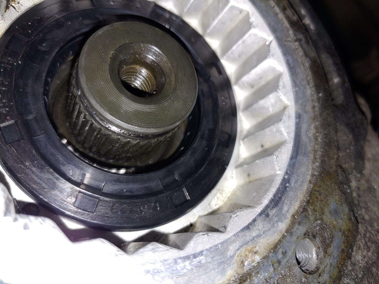

New seal installed.
1) I did put the one in the freezer overnight...non-conclusive it helped but it was able to get it seated by hand a bit then using the PVC connector drive it into place. I actually forgot to put hylomar on the seal, but figure that wouldn't matter since it was a very tight fit.
2) Getting the circlip into the groove with the wavey washer was a bit of a challenge, especially since the circlip pliers I have are too wide to fit in the inside of the flange and spindle. I got my pliers off amazon and think the OP on this thread had Craftsman. I was able to tap the circlip into place using a flathead and with a few extra taps made sure it was fully seated on the spindle groove.
3) I did put a super small bead of hylomar around the cap and popped that on.
4) When finally taking off the gear oil drain plug I noticed the magnet had snapped off. No idea if that happened inside or not. Couldn't feel anything or see anything. I did replace that with a plug that had a magnet but the threads are a bit off so I'm being careful to not get it seized while also not being too loose.
Finished
Fully seated oil seal
Circlip pliers
PVC Connector

My transaxle leak suddenly got worse after the last drain and refill. So, I am working on getting this done on my 87 camper 4 spd manual. So far, it has gone pretty well - a few stubborn bolts and a feisty flange seal. Thanks to all those who have provided instructions and tips - really helpful.
Now i'm ready to start re-installation... but this spring ring fell out of the assembly after the seal was removed. Does anyone know what this is? It is not rubber! it is a spring ring; I can stretch it and it springs back.
Thanks!

That spring is part of the old seal. It fits inside it and helps hold the seal lip tight against the turning shaft.
Mark
Thanks Mark!
I looked at the new seal and can see it on the inside lip.

The leaks started right after a transaxle fluid flush and fill. I had heard that sometimes, if it's been a while, draining and refilling can cause the seals to leak.
I was able to complete the seal replacement without too much trouble. It was a mess down there - the plastic flange covers were completely trashed. I used both the seal puller and screw methods to get the seals out. Once side popped right out with the seal puller and the other required the screw method. Both my flanges pulled off rather easily so i didn't need a puller - they also went back on easy with just a tap to seat them. I did run into a problem with 2 of the CV joint bolts(allen keyed) - ended up using a method i found on another VW forum. I tried the triple square and screw extractors but had a hard time getting them to seat properly to work. I ended up using a pair of vicegrips to grab the head of the bolt, then used another pliers to further tighten the vicegrips screw. Once it broke loose the bolt backed right out. I replace all the CV joint bolts with triple squares from T3 Technique. I also ran into an issue with my torque wrench; it is too long to be able to get under there. I ended up buying a shorter torque wrench and it worked great. I also made sure the trans air hole was clear to make sure it didn't blow out the new seals. I did this in my driveway which created it's own challenges, but wasn't as bad as i imagined. Went camping this weekend and so far no leaks.
What a mess!
The old parts - the plastic cover was completely trashed.
New seal installed.
Seal cover, flange, washer and circclip re-installed.
Cap installed with a touch of RTV - the same as i found it.
Tight squeeze; this side was a little cramped to exhaust piping.
Make sure you have the right ring pliers with the 90 degree heads to remove/install the circ clip.
I had to buy a shorter torque wrench to fit in the tight space under the van since i didn't have a lift.
