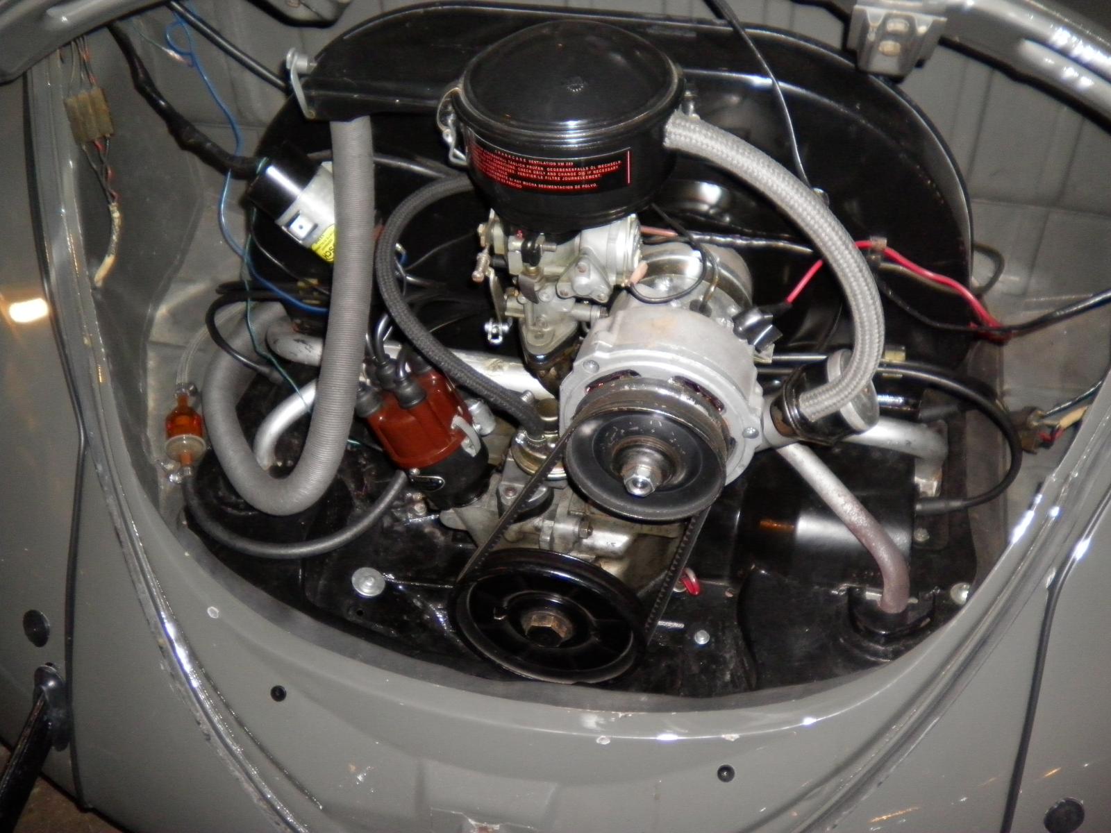

Busted-bolt wrote:
I guess this belongs here . My 1602 . It's almost done ! Lol
Is that CIS on a 40hp? What is that all about?
What did that turbo come from? A key chain?
Holy SH*T I bet that will absolutely rip.

The big bore 83 mm piston's were modified to be semi hemi just like the heads . I did use a .075" shim for the barrels to get my desired compression ratio .

I used 40 hp rods that had about .020" milled from each side of the big end . The stock 40 hp cylinder holes on the block and cylinder heads remain stock size as a factory 40 hp . I just have a set of slip in 40 hp big bore jugs in there as well . I need to find those copper stale air rings for the cylinder head to barrel seal . The aftermarket ones are junk because they are to hard and will not allow the cylinder to seat in the head correctly . When all of the mock-up is done on the prototype parts the top end will be removed , cleaned thoroughly , reassembled and adjusted . I just need to source some O-G stale air 40 hp head to cylinder rings ! 👍

If the sealing rings are solid copper heat them with a torch until they are a dull red to anneal them, then they should work.

I used the copper rings from a new box of good quality gaskits from WW in my 40hp 1385 bb.I didn't have any trouble with sealing & I use the stale air heater boxes with no smell or emissions. I switched the heads to the late '65 40hp heads.
