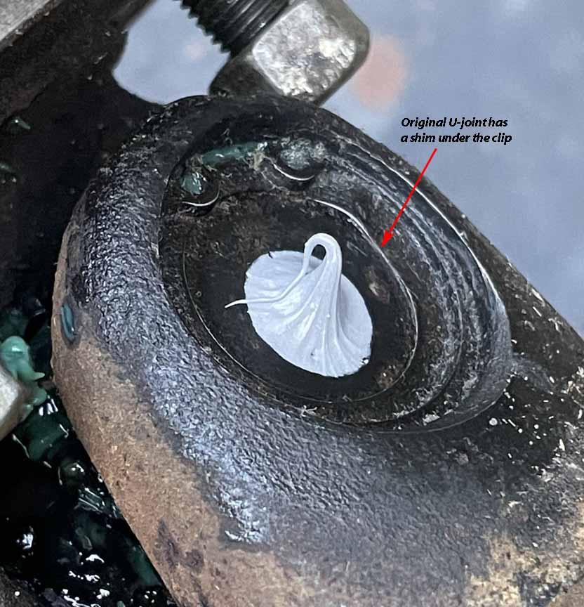

Here's a pic (from the thread referenced below) It's an OEM driveshaft with the cup shimmed inward (by VW or Steyr-Puch).
Same driveshaft, different cup. Notice there is NO shim. Maybe this was for driveshaft balance?

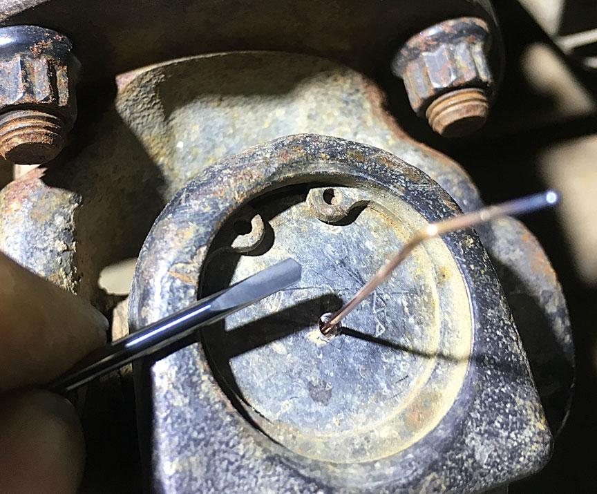

How-to: Syncro - Needle grease original driveshaft u-joints
I drilled the u-joint cups and pumped fresh grease in, old grease out ( 😎😎 ).
I did this at 180k miles (Jun 2019), and it's still silent at 224k (Nov 2022).
It had one "dry bearing" (of the 8 ) and I was bummed.
But I kept moving, pumped the dust out and 45,000 miles later it's still silent.
The u-joint angle is so little (4°) it seems like they could last a long time, perhaps wearing out only if it gets dry (???)
This is not an "easy DIY". Drilling 'bearing caps' with carbide bits requires higher-level hard-headedness.
It depends on your skill level or your posse. But you don't have to do it 'under the van' like in the thread.
I didn't even kknow how drilling one cup was gonna go. But it went well so I decided to drill the other 7 without removing the driveshaft. It was fast, and it was good!.
There's lots who can do it, you just gotta find that person and buy the tools.
Which cost substantially less than a new driveshaft. And perhaps you need luck too.
There's also the brass bushings in the Guibo (pronounced jew-bo🤣) connection that should probably be serviced about now.

I doubt the shim under the circlip is for balancing purposes, I mean it does in a way to center the U-joint but the primary purpose must have been there to help having a tight fit with the circlip bc of machining discrepancies.
