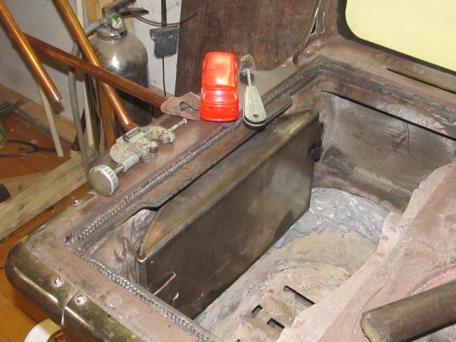

My Best Man in our Wedding was a Welder, I sure miss him Crying or Very sad but good news,
His Son is A top notch Welder,so guess who is Building my Stainless Steel Water Jacket,(lives south of Detroit)He was up here Turkey hunting with his two sons so He took measurement yesterday ,and I had a nice sheet of Cold rolled stainless laying around Wink I ask how looooong will this take to make? told me a week Cool Cool Cool Cool Cool

Welder called exactly one week later Shocked told me he didn't have time to test it Laughing He mailed it , I worked on it all Morning ,test was good Wink now to sweat all the fittings

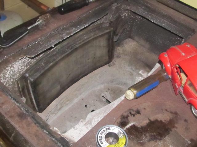

We had 'Free' hot water for 4 days and then,, water jacket sprung a lil' leak 3 pin holes ,put the fire out right quick too Crying or Very sad(we figured to much pressure blew it)a friend was up here for a visit so he took it back and the Welder fixed it,,, re-installed today and had a few copper sweat fittings leak Evil or Very Mad ,, this time with a pump an a expansion tank too Wink It's been hot for a couple hours now so ,,so-far-so good Laughing Anything I can do to this farm to help us get off grid,,,

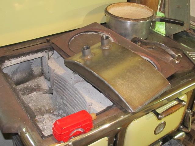

Had my "welder' fab up a new Bladder 1/4" Stainless Steel,old one was 3/16" which he fixed once and it leaked again,It was just too thin of stainless

thats awesome! i woudl have used 3/8ths for good measure and better insulation, but im sure 1/4 will be ok, what are you storing the hot water in? and what are you using to circulate the water? this is progress.

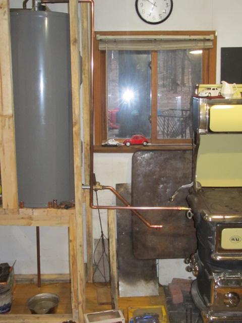

Thanks Outcast, I use a Grundfos circulating Pump (3 photo's up) For storage I have a new 40 Gal. electric water heater tank just not 'Hooked up' Wink
