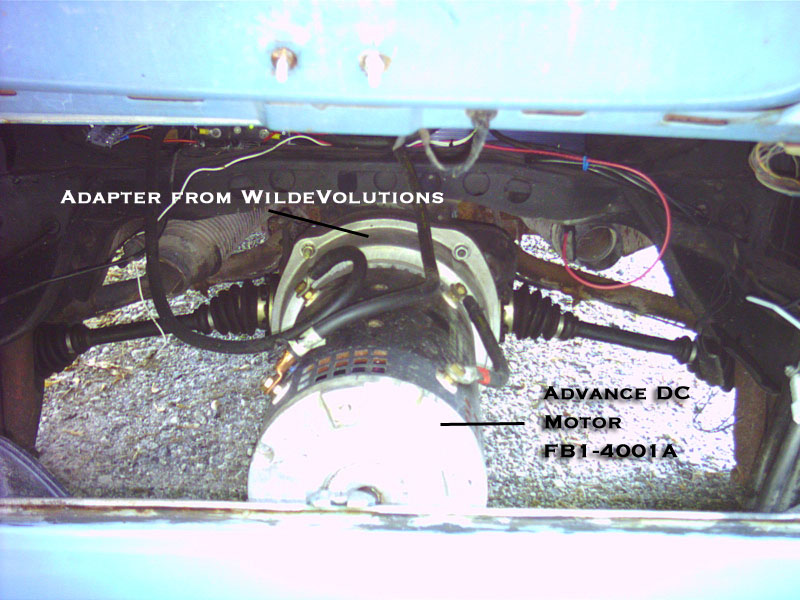

http://www.monkeywork.com/p/Bus1.html
It's been done lot's o times
Search on the internet and you'll find several sites, an early rabbit is the easiest car to convert, you can buy kits for them.
