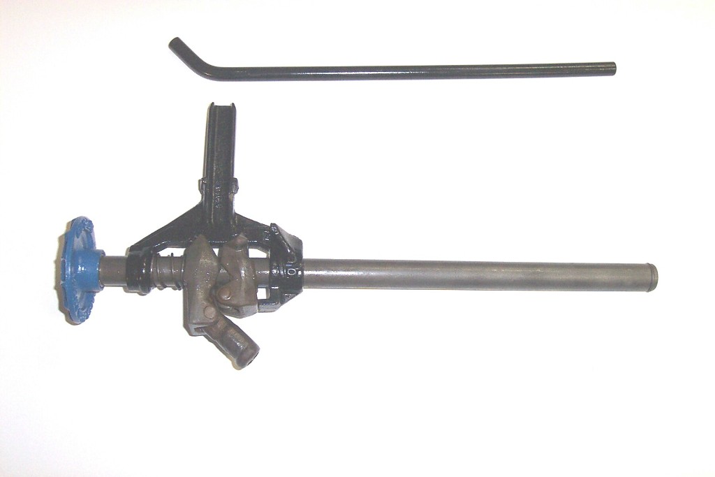

Beetle:

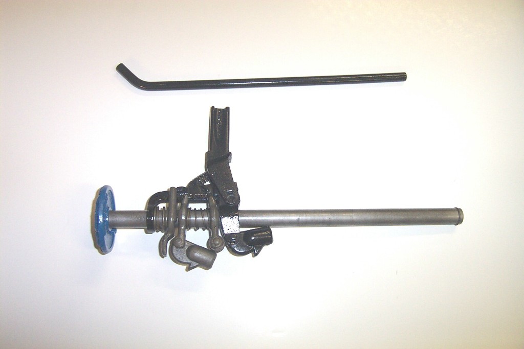

1950-53 There are two versions of the Split jack.
For jack crank handles - see This Thread
Jack bag dimensions thread

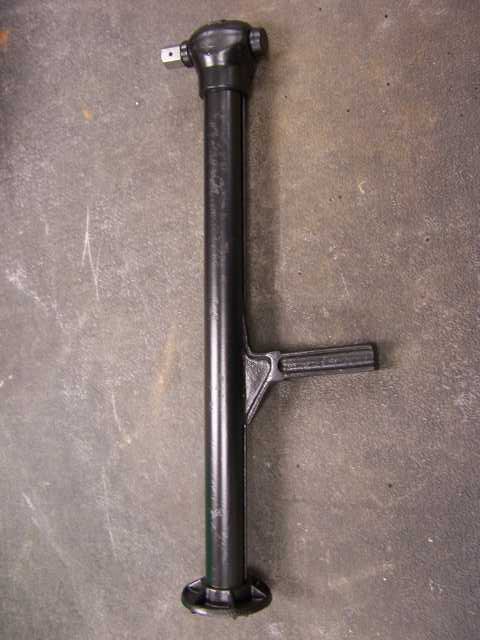

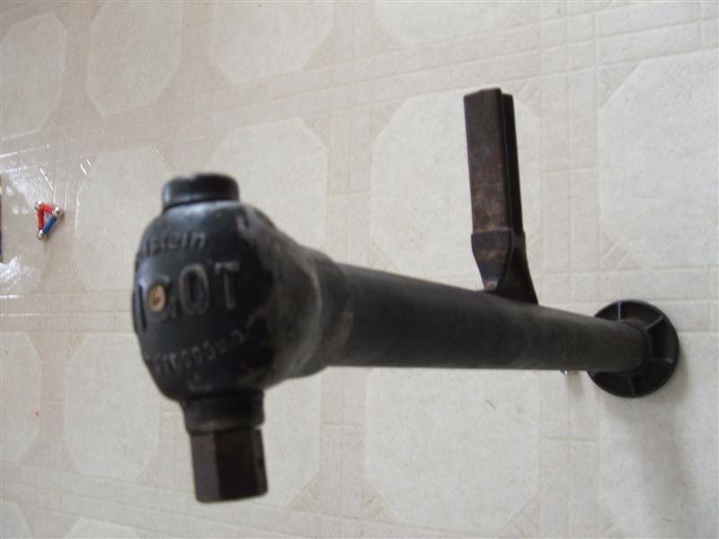

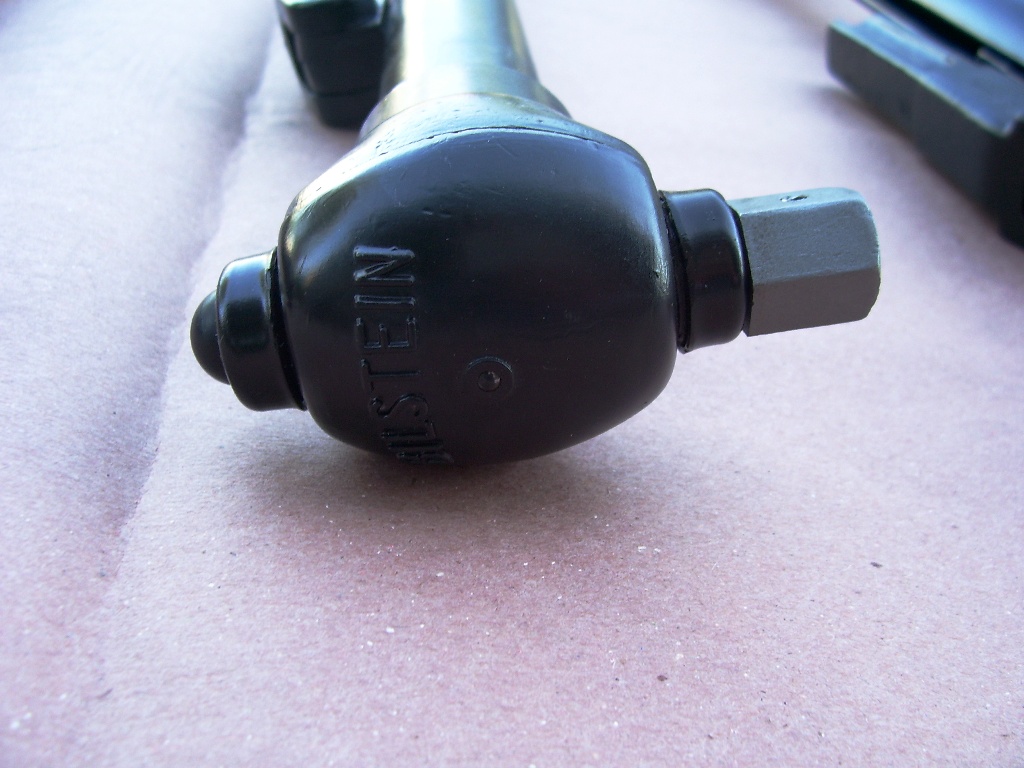

Early version - VIGOT/BILSTEIN, 3 prong:

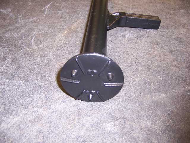

Later version - VIGOT/BILSTEIN, fat base:

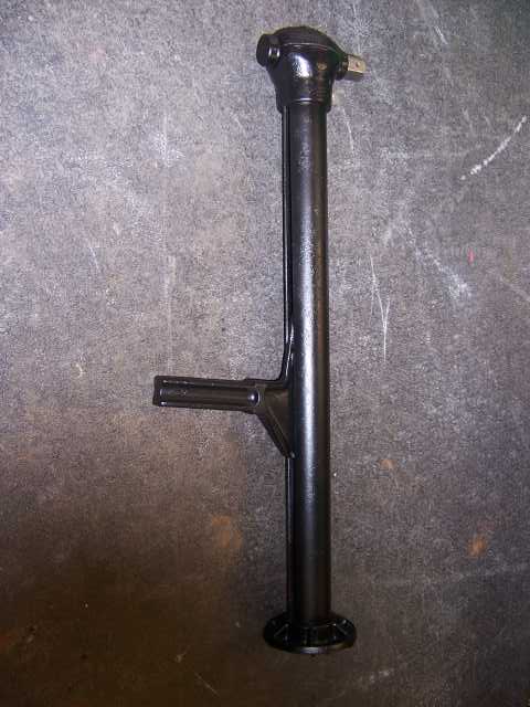

The bottom is the same as what is on early bus jacks - left and middle picture:
Do not confuse it with a Porsche 356 jack – arm pointing downward.

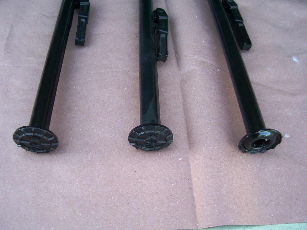

1957-65 Notice cupped end for rod. Two types.
Standard:
Dished:

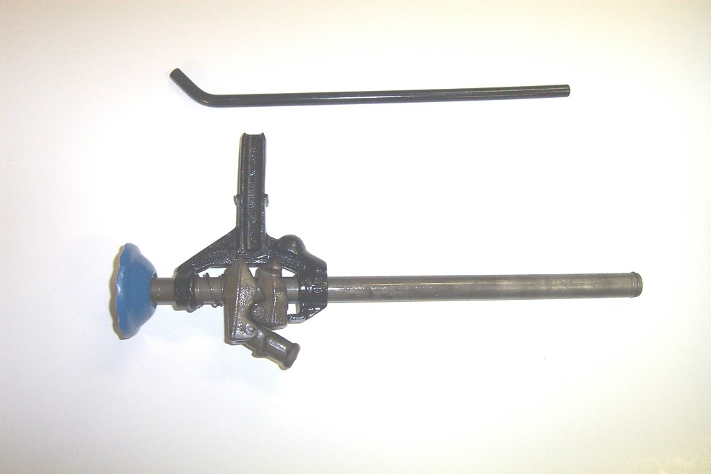

I have six styles of bus jacks. I don't know the exact cutoffs.
Standard:
What do you mean by "cupped end for rod"? I am having a hard time telling the difference. Could you please show me what you mean so that I get the correct one for my 60.

PostPosted: Sun Aug 28, 2011 7:25 am    Post subject: Reply with quote
He means the little rounded bulge above the area that goes into the jack point.

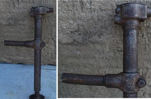

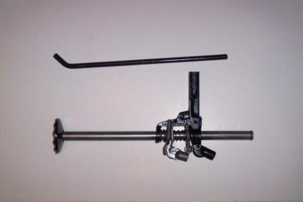

Here are some more early split jacks...
1940 ? - 1946 (notice round arm). The arm is placed quite higt because it's for a Kübelwagen.
1947 - mid 1949 ?
Mid 1949 - mid 1950 ?
