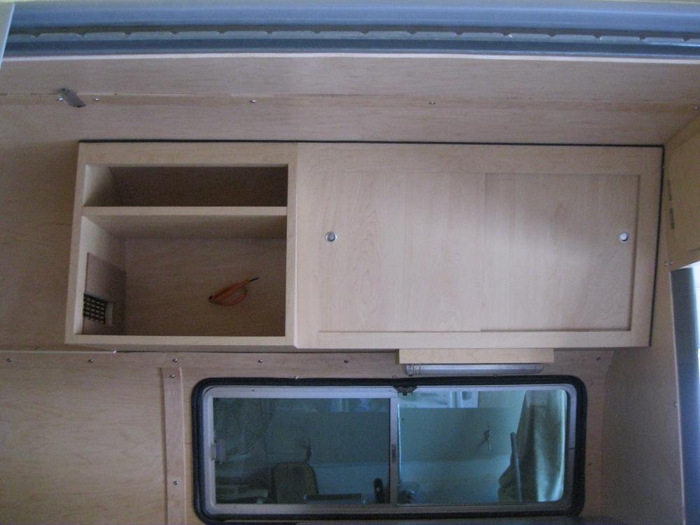

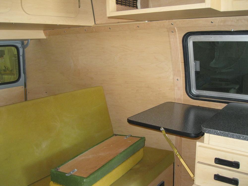

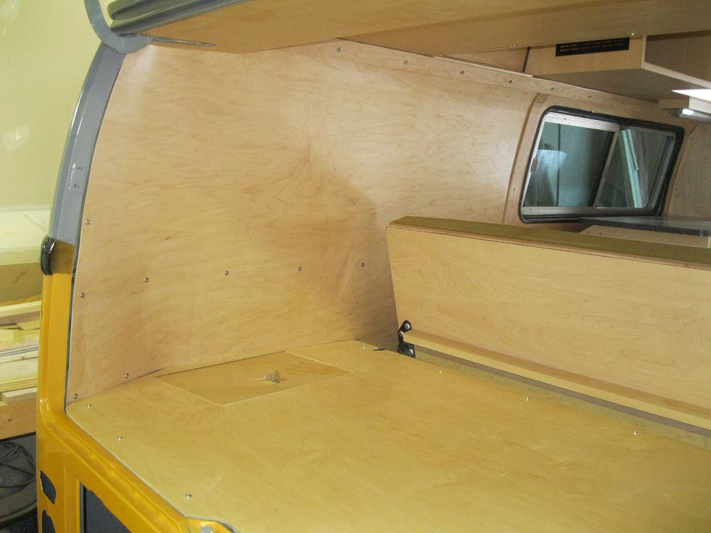

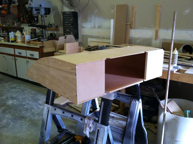

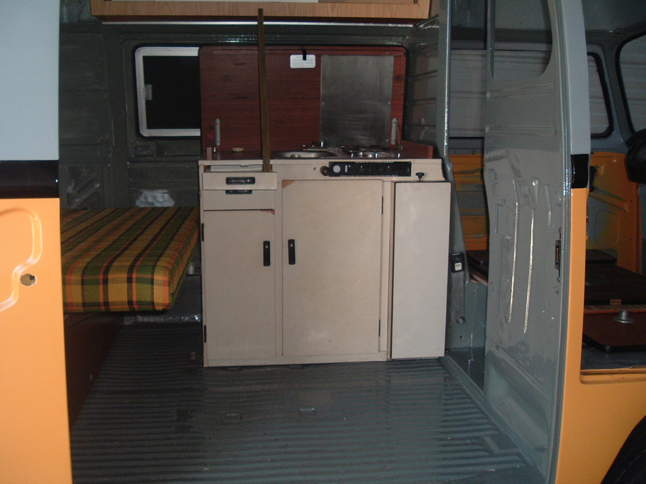

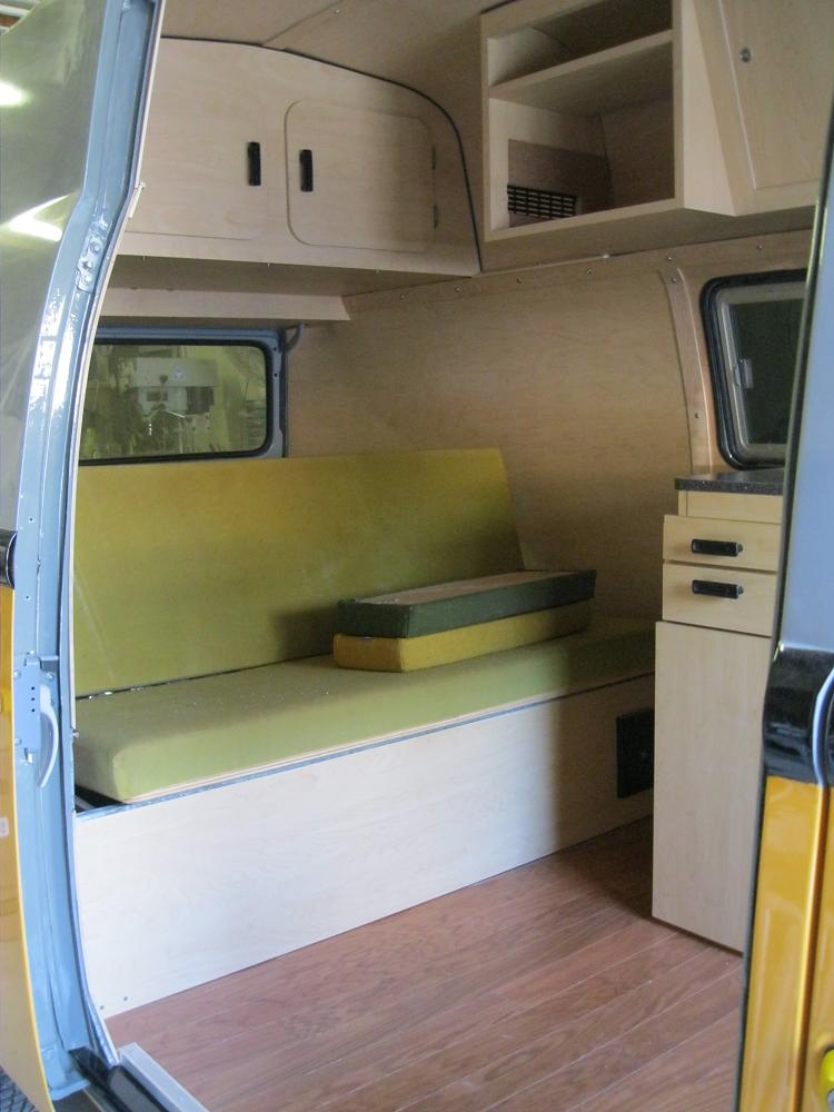

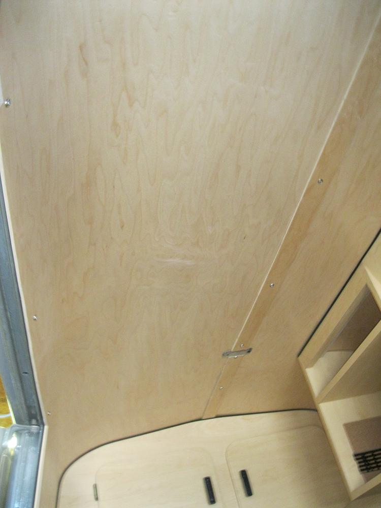

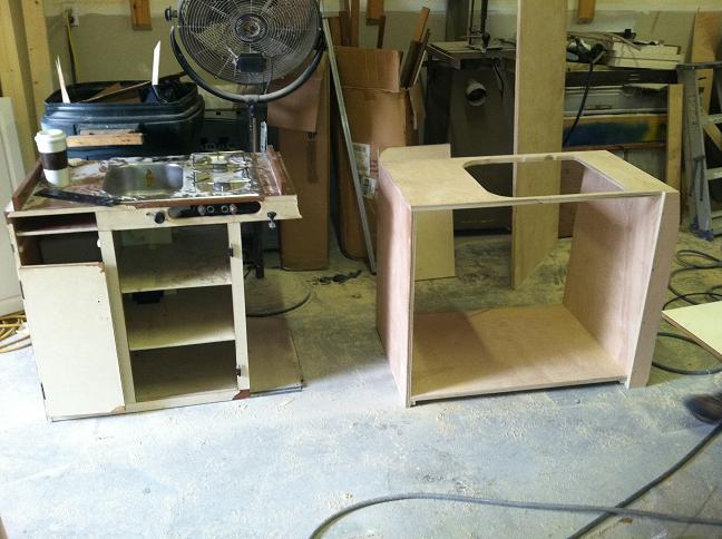

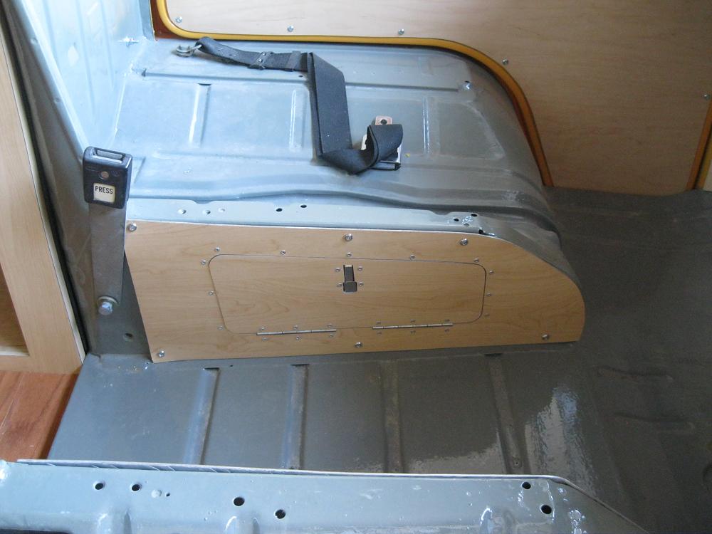

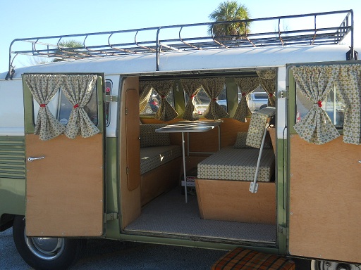

Hi Im Jeff Power, a bus fanatic, and woodworker. I've been reproducing Split bus camper cabinets for a while, and I was contacted recently by Rick to tackle this huge project.
Rick asked us to outfit his 1971 Swiss Postal Highroof with a complete set of custom cabinets and wood interior panels. His primary goal was to have something different, but that could still pass for factory Westfalia.
The customer dropped off some OG Westy cabs to restore, but in the end we just rebuilt everything.
The Sink/Stove will have an electric truck fridge installed, and the wall cabinet above the sink cabinet was designed to house a Microwave, as well as additional storage. We also built a little cabinet to go above the driver and passengers heads. It got cover with headliner paneling.
All of the Cabinets are covered with Formica, and all of the wood paneling was finished to match, when you are in the bus the match is so close its impossible to tell the difference between the two.
It was a very interesting project to say the least, there were a lot of hurdles to overcome, but in the end it turned out great and Rick was really happy with the finished project.
Here's the pics -

Did you saw away the supports here?
No at some point in this buses life someone else had cut them away, my customer really liked the idea of using that space as storage.

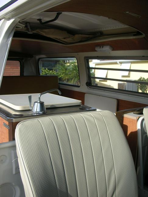

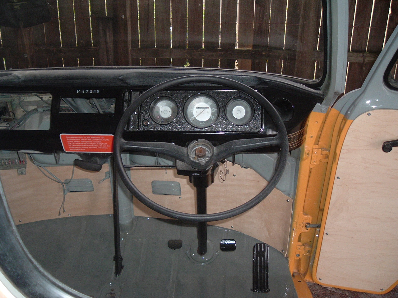

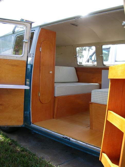

Heres some more pics of a couple other projects. These are just completed pics.
The first is a set of cabinets that was the recipient of a strip and re-veneer job. The customer dropped off the cabinets and we stripped the formica off, pulled all the rubber trim, and re-veneered all the faces of the cabinets. Then we re-streched and re-installed all the rubber trim.
Next is a 69 westy I bought to put together and sell, This one needed some mica patching and all the rubber stretched and cleaned. I also put all new interior and ceiling panels in this bus.
Heres my 67 that we built a complete custom interior for, loosely based off the SO-23 SO-33 kits
And here is a picture of our latest efforts SO-33 Copy Kits. This bus is a customers.

Those interiors look great. Very Happy Would you mind sharing a bit of information on the finish you used on the 67? I love the look.
Jeff Power
Joined: October 13, 2004
Posts: 1170
Location: with any luck, in my garage building bass guitars.
Jeff Power is offline
PostPosted: Sun Dec 04, 2011 1:49 pm    Post subject: Re: Finish Reply with quote
Synapse wrote:
Hi Jeff,
Colonial maple stain
1 Coat of shellac
3 coats of water-based poly

how high is that roof?

I will be doing the same to mine soon, and was wondering if you used all Baltic birch?

For the Highroof we used all Maple plywood. Rick, the customer, picked out a Maple grain Formica laminate, so we matched that for the paneling.
