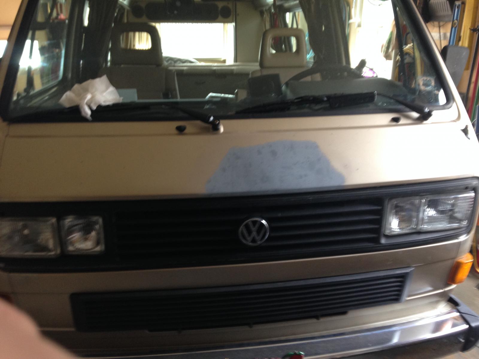

It wasn't just the square headlights for my 86 has the older nozzle location....
