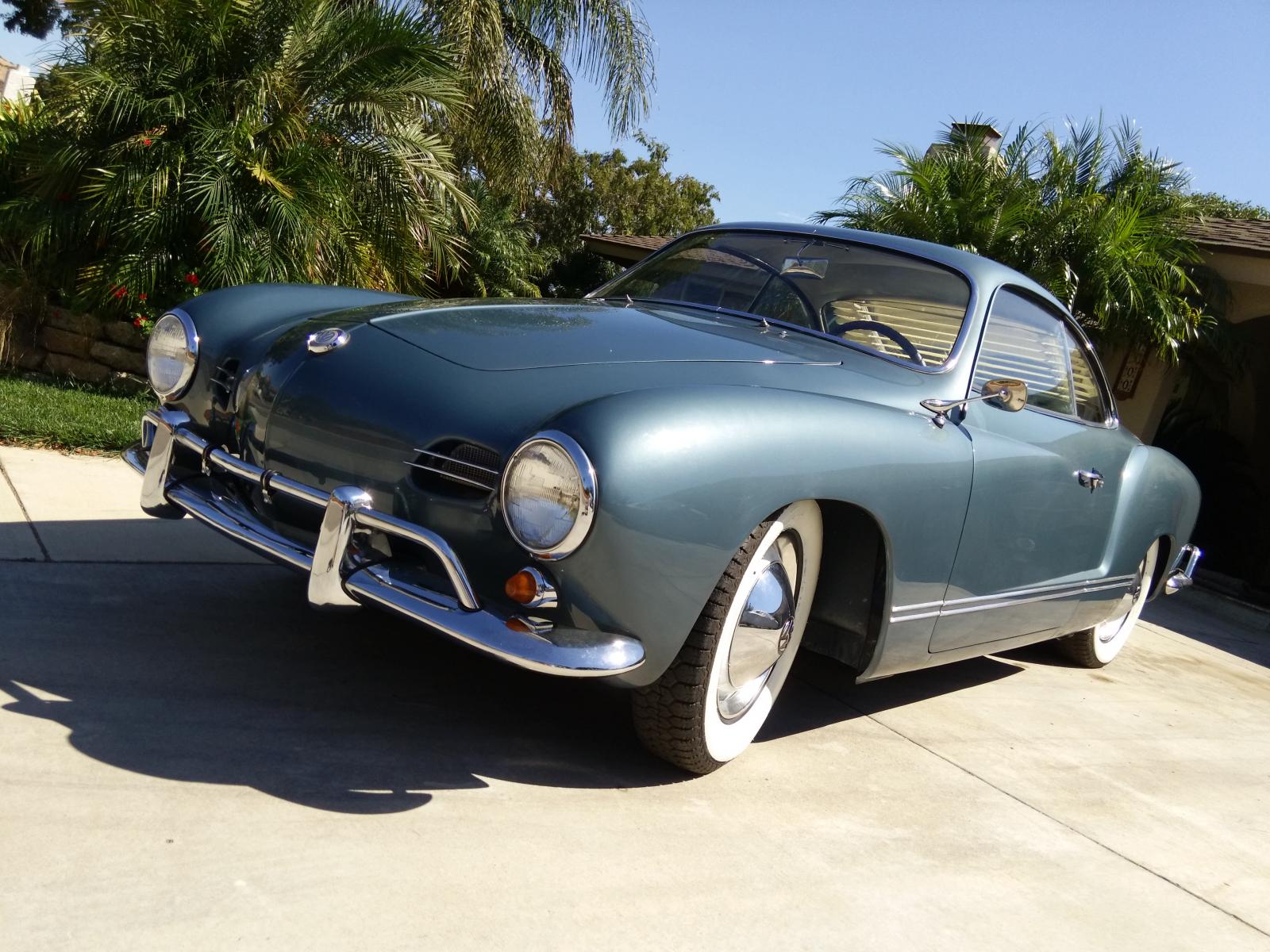

Here is a photo of the last project I am just completing.
