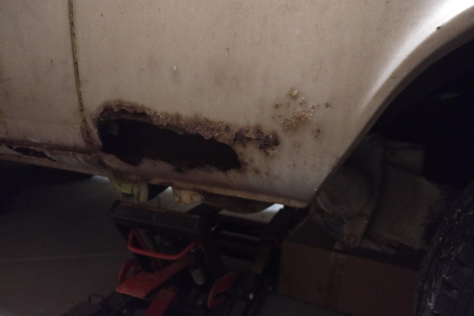

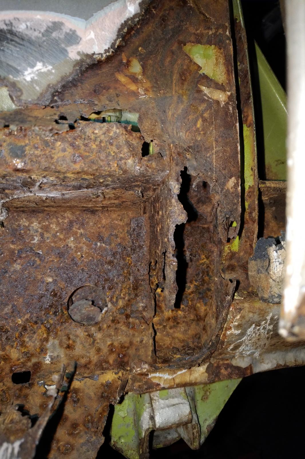

So to start things off, here's a couple pics of the biggest areas of concern:
I've already bought myself some of the drill-bits for cutting out spot-welds and have removed the battery tray, as well as the spot welds along the rear-arch. I have a replacement battery tray, corner and the arch is enroute. I have to get a few more pics, but the 'C' pillar is rotted (both sides) and I'm really having a difficult time finding replacements. I'm planning on cutting out and doing the whole passenger arch panel from the door-frame to where it meets the corner, as it was hit at some point and it looks to be the best approach for me. I will take a few pics of what it looks like with the bondo removed.
I've posted several times in the Bay forum for other issues and am blown-away at the support that the VW enthusiasts here show. I have another classic vehicle of a more 'local' brand that I have had for a few years, and the help/support of the VW crowd completely crushes the competition!

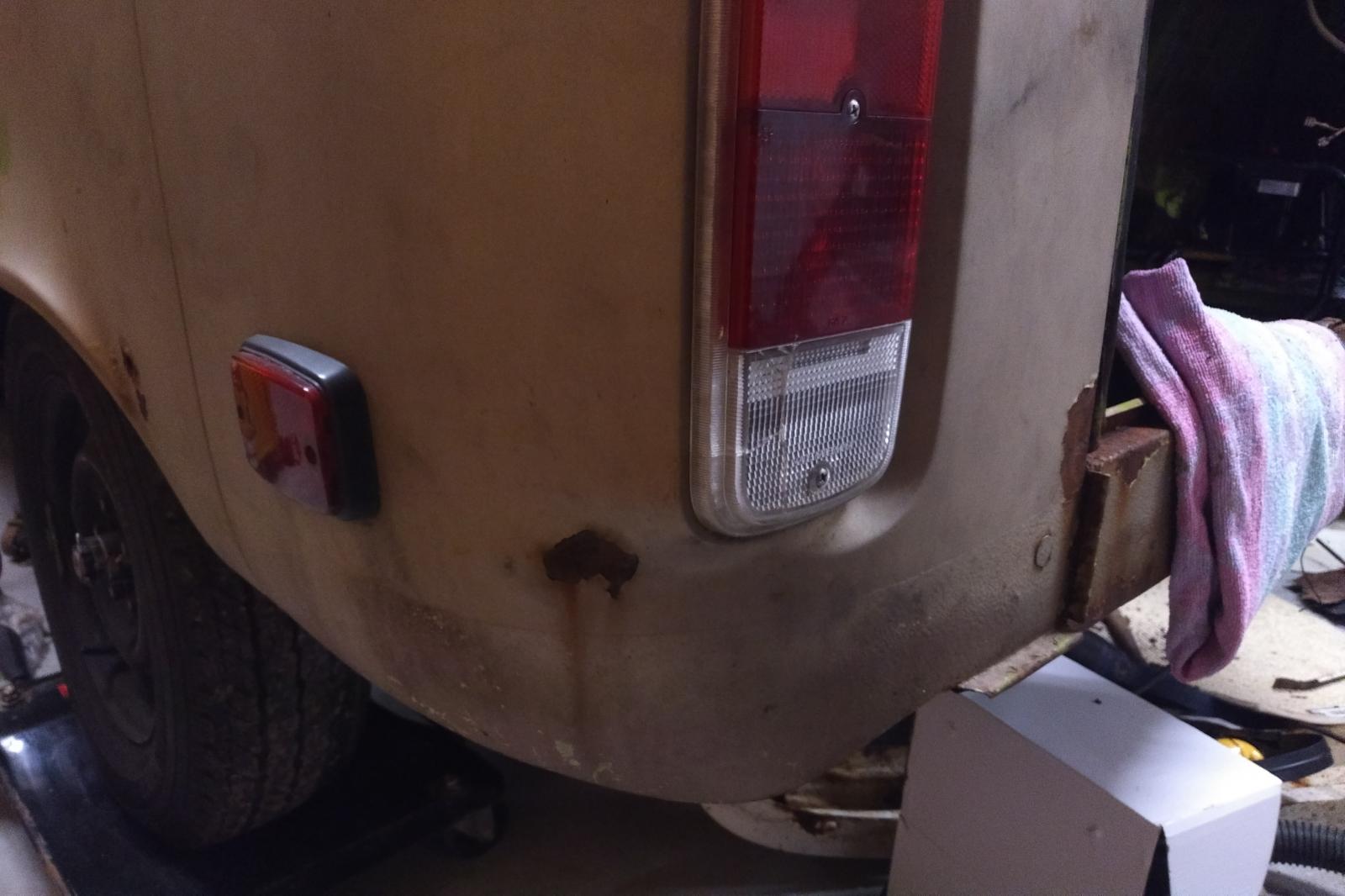

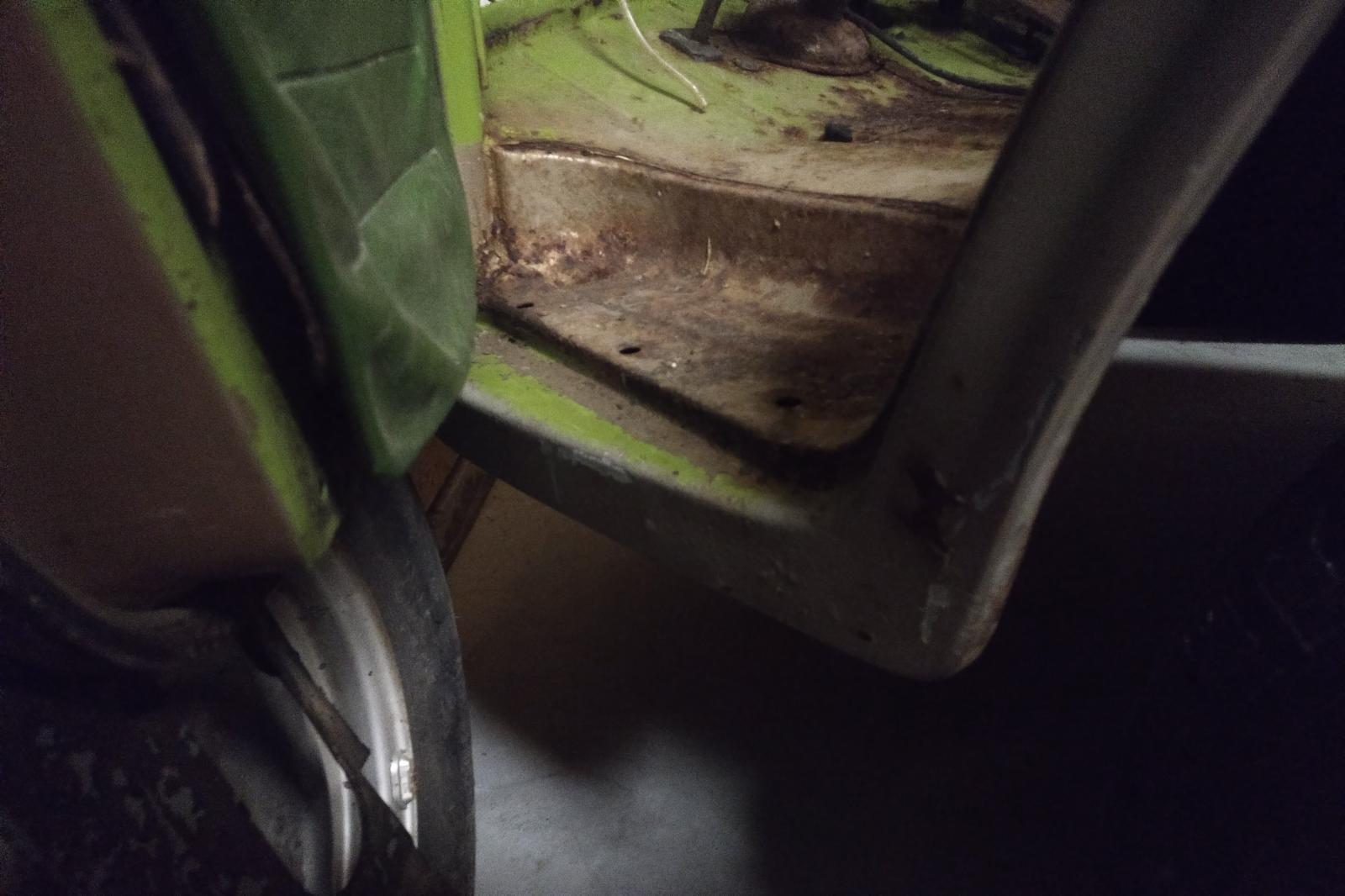

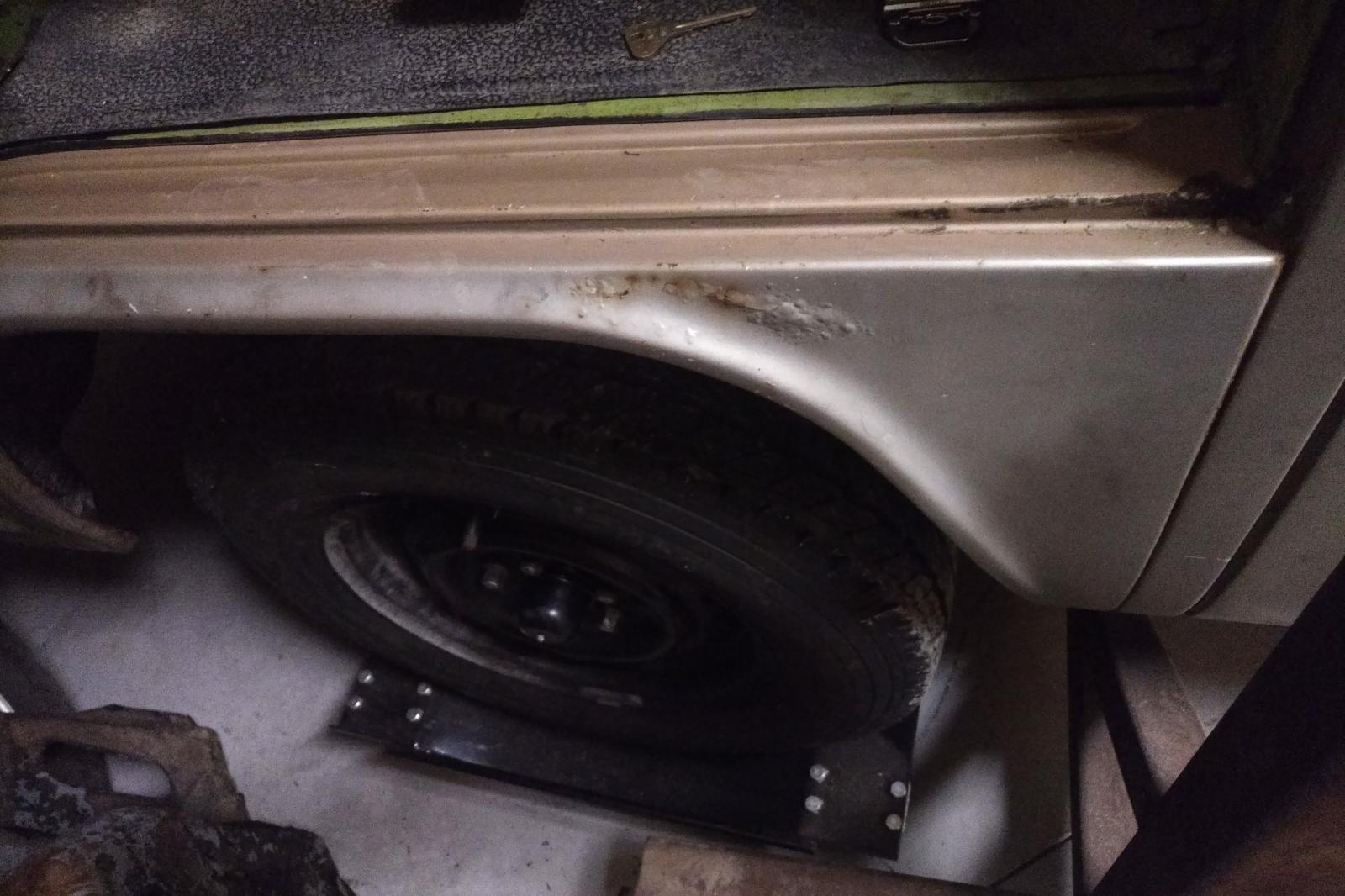

So here's where I'm starting. Corner has damage, the bottom of it has lots of Bondo to match up to the rear of the arch.
The holes for the marker lights feel strong, so I'll likely cut under them, under the rear light and to the engine hatch.

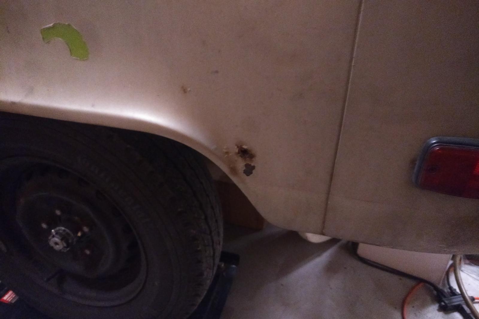

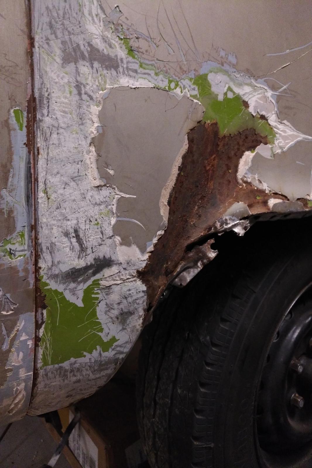

The wheel arch has damage at the skirt:
And is pretty much gone in front of the wheel:
I was thinking about cutting from the rear of the door and going all the way around to the engine hatch. I'm concerned though that I won't have any reference points if I do that. Should I do arch panel first, then corner? Or would the other-way around be better?

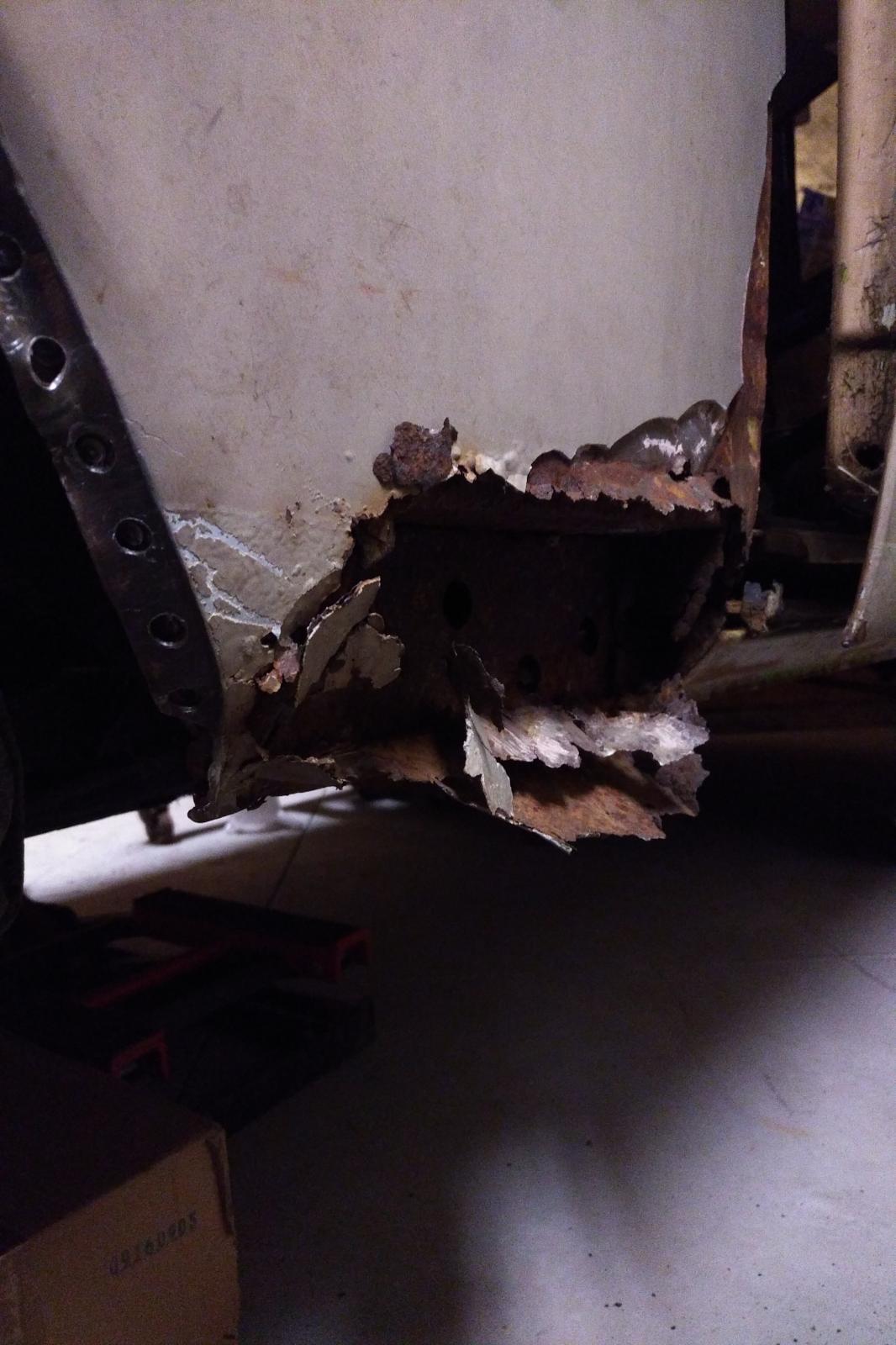

Here's the C-pillar that I mentioned earlier, pretty much gone:

Also, do I drill out the welds in the door frame to remove the rear arch? Any sense in not cutting out where the side and the rear corner meet? It's damaged and full of bondo, so I figured it should go...
1977 FI Westfalia
