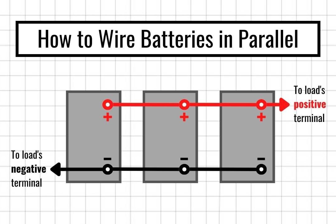

...and now the fifth iteration, two Battle Born 100ah batteries in parallel:
The Redarc is fed by 240 watts of solar on the roof and the alternator.
Why did I go with two Battle Born batteries in parallel? Because I was easily depleting the single battery with my DC power demands (amateur radios, plus comfort things like refrigerator, LED cabin lights, and USB charge ports).
I'm in the middle of a 4500 mile road trip right now and this dual battery setup has been a source of great comfort. I have no capacity anxiety with the dual batteries. On several occasions I have left the van for several days--the last being six days total--with the refrigerator running, with the voltage sitting at 13.3 volts when I depart and when I return. I've never had that confidence with the aux battery system before.
I am convinced the combination of the Redarc and the parallel batteries is what's making this work well.
You can see in the photos that I placed the batteries on their short side, so that the terminals face aft. This is a perfect fit for the rear bench space--no space is wasted vertically in this configuration.
