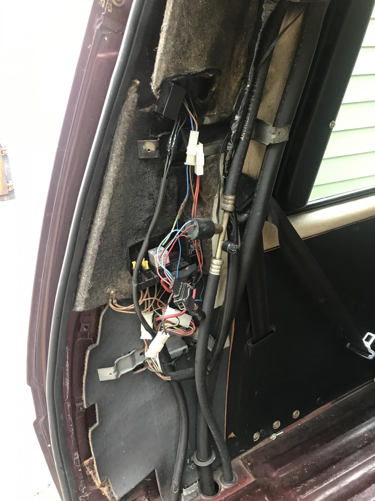

As you probably know by now, I now have a 1990 Tintop.
I will be going through the Air Conditioning system much as I did on my 86.
The differences between the 86 (basically the 1.9 A/C with some newer 2.1 bits thrown in just to confuse you) and the newer system is huge.
I'll figure it out, I'll fix my system but to start off the controls in the left D pillar are compromised.
There was a fire in there. The padding behind the wires is significantly burned.
There are three spliced wires with electrical tape, Upper left of photo near screw bracket, that have been taped together.
I wonder ..... Was something removed from there or was it simply a burned wired repair?
Also the harness running vertically is completely wrapped in electrical tape!

PostPosted: Wed Jan 06, 2021 6:16 am    Post subject: Re: 1990 Air Conditioning Reply with quote
i've got an 89 Carat donor that i can pull the panel off and take photos.... after things warm up. but there's probably images in the archives.
as i'm sure you'll do, i'd unwrap any non-factory tape to see what's going on, put in proper splices, and of course clean out the old foam. holler if you need any plastic trim, i might hang onto the wiring and controls for a while tho.

Dave, I have the wiring harness for the A/C from the euroBus out and accessible. I can take pics of whatever you need to see.

It will probably be difficult to envision on the floor but the wiring up tgat D panel, fuses, relays, pressure switch etc.

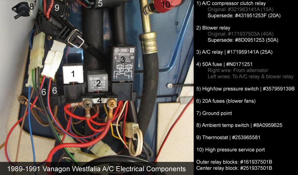

Your "new" van is also missing a relay.
~Kamz Anxious

PostPosted: Thu Jan 07, 2021 7:35 am    Post subject: Re: 1990 Air Conditioning Reply with quote
Hi Dave, What usually happens is the large red 12v wire connector at the fuse link overheats. The problem is the brass eye connector is too small for the amp loads. In Europe they must not run the A/C as often as we do. I have seen this connector melt the fuse and relay plates and burn all the nearby components.
The solution is to go to NAPA and get some brass battery connectors for a garden tractor. Change out that 12+ wire end to a bigger connector and change the fuse link, as I have done in the picture. Use solder too. Do the same on the other end of that red wire. It connects to the back of the alternator, AIRC.
Check the two fuses for the brown grounds. They can get toasty too. The solution there is to be sure the fuses/connectors are clean and fresh. The 6mm ground stud is clean too.
Having another late model Vanagon to mirror your repairs is very handy.

PostPosted: Thu Jan 07, 2021 8:20 am    Post subject: Re: 1990 Air Conditioning Reply with quote
Agreed that the wiring terminal is sub optimal. Also consider replacing the fusible link with a maxi fuse holder.

PostPosted: Thu Jan 07, 2021 9:38 am    Post subject: Re: 1990 Air Conditioning Reply with quote
Thanks for posting this, I hadn't heard of the upgraded relays before. Where did you source them? Not having much luck with the part numbers at the usual vendors.
Found a $50 OEM 431-951-253F here:
https://www.europaparts.com/relay-431951253f.html
It also looks like 8D0-951-253 may have been superseded by 4H0-951-253 which is available in a 70 amp version.
https://www.europaparts.com/relay-443951253j.html
VanCafe sells the complete board with a new 70amp relay (even thought the pic shows a 40amp), but they don't sell just the relay.
https://www.vancafe.com/KT-9984104-p/kt-9984104.htm
I run the AC a ton in Houston and want to upgrade every component I can in the system. Abel told me several years ago RMW was working on a plug and play AC Wiring upgrade kit, but I never saw them come out with one. Would be happy to support such an effort.

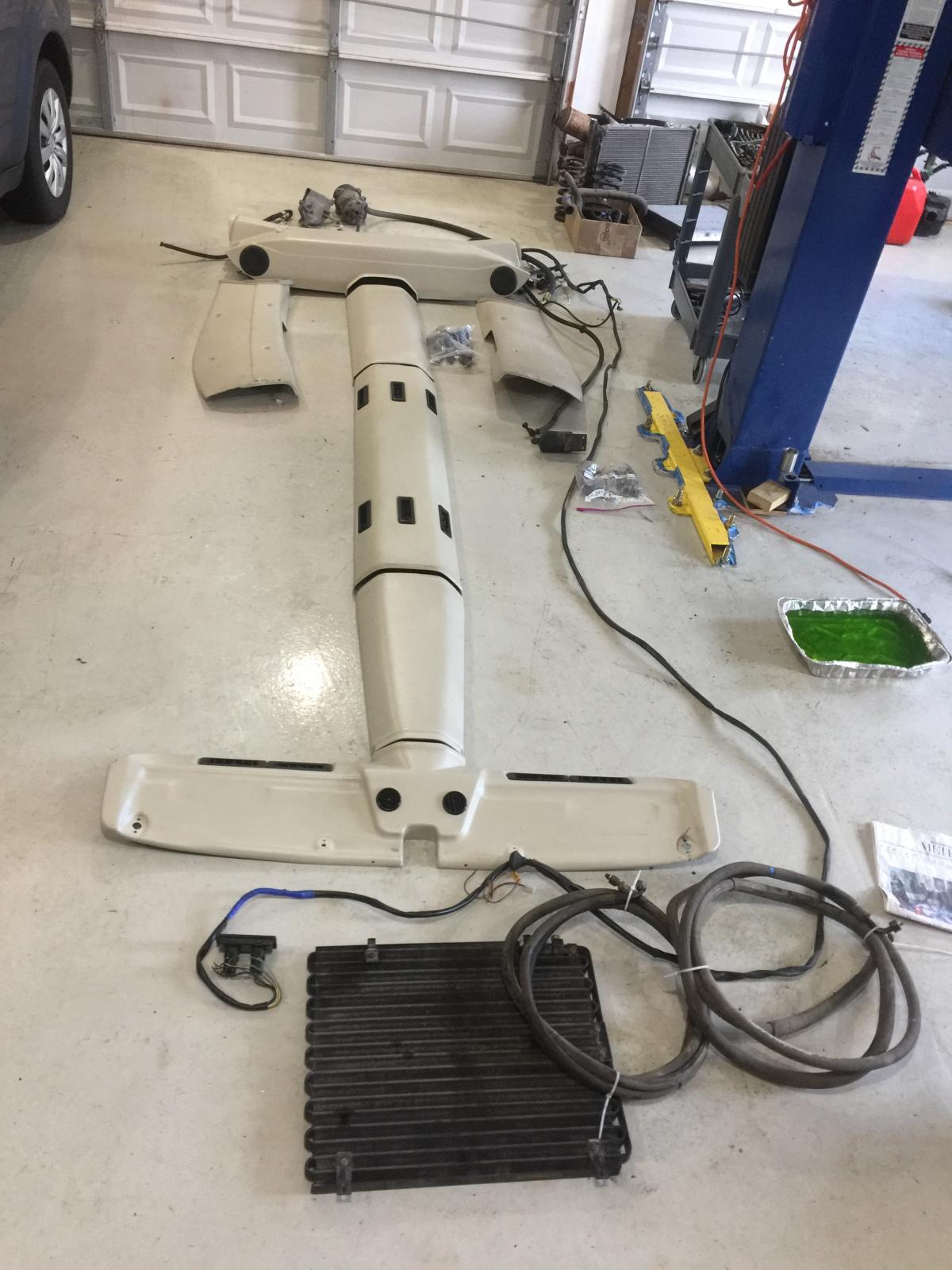

This thread will eventually become "how to rebuilt the newer A/C system.
I just discovered that my Condenser is bad.
One of the connecting pipes has broken off from the coils.
Both connections are on the lower left of the condenser.
The size is roughly 22” x 17” x 1 1/4”
I'm going to see what I can find.

PostPosted: Thu Jan 07, 2021 2:30 pm    Post subject: Re: 1990 Air Conditioning Reply with quote
You are actually kinda lucky. Time to ditch the obsolete R-12 condenser and get a lighter and more efficient design. Costs about $110
What's in the photo are the original relays; I failed to photograph the replacements along with the maxi fuse I installed. Embarassed
The 431951253F (Compressor Clutch 20amp ) relay was bought at NAPA (albeit 5 years ago); even aftermarket, it's a red relay:
The 8D0951253 (Blower Fan ) relay... can't recall where I bought it, but it is available. The OEM relay is stamped 370:
NAPA lists a Meyle version: https://www.napaonline.com/en/p/ATM8D0951253 .

PostPosted: Thu Jan 07, 2021 3:43 pm    Post subject: Re: 1990 Air Conditioning Reply with quote
BusDepot carries an OEM style Condenser.
Though the price of $270 reflects this originality.
https://www.busdepot.com/253260403
I'm thinking the Nostalgic Air r134a unit we've been putting in older Vans. Just under $100 but modifications needed.
https://nostalgicac.com/
This isn't a big issue for all new hoses will be installed for the EZ Clip system.
