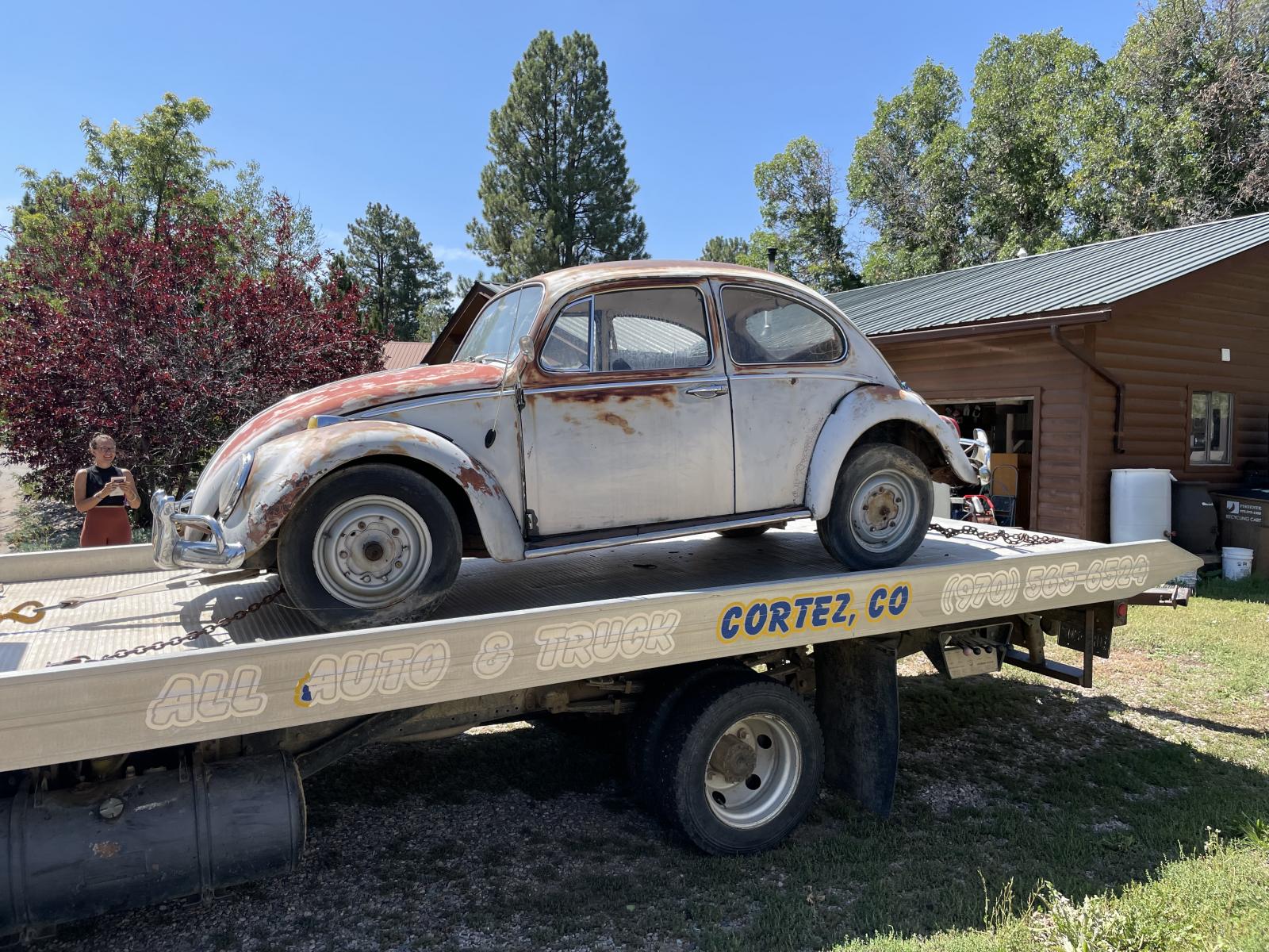

It was delivered today

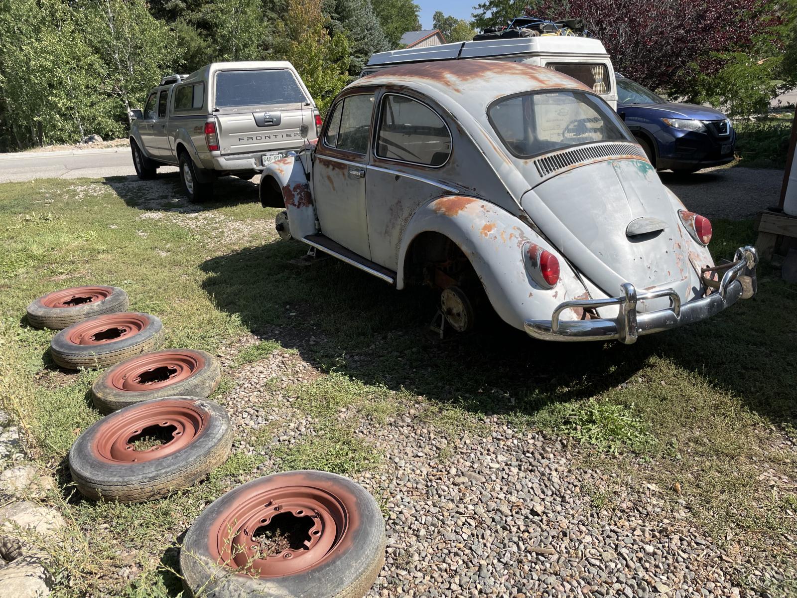

Pans, these will be replaced

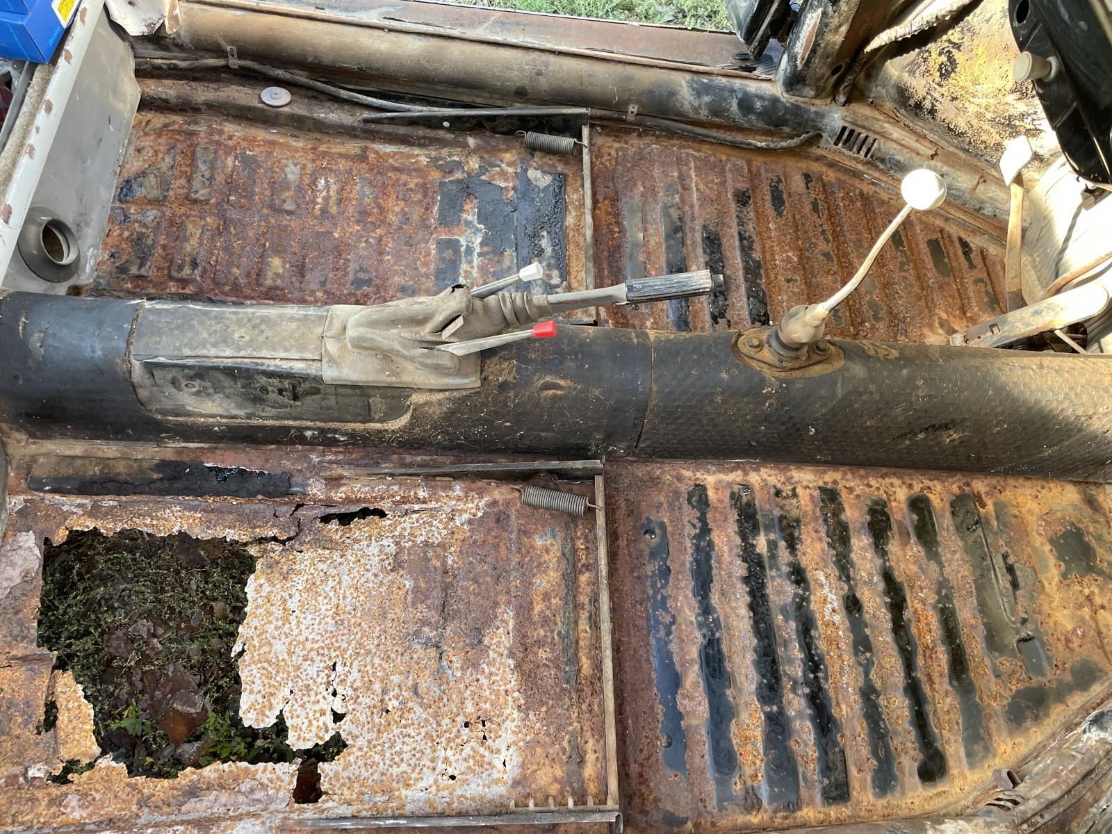

Gutted it today

Today after returning from the festival, I spent a couple of hours on the bug. I removed the interior door handles and door cards. I tried my hardest to save the cards, but 56 year old cards are really brittle. I didn’t murder them and I’m sure I’ll attempt to reuse them until I do the full interior after the winter. The. I worked on getting the windows to roll up and down. I lubed the shit out of the worm and the track with silicone, then things started to move nicely. I also lubed the door latch mechanism, as well as the door hinges. Both are working a lot better too. After that I pulled the rubber floor and did some more vacuuming. The floor is mostly good and the section that isn’t will be fixed when it goes in for the engine install.
My next plan is to get it up on 4 jack stands, pull the rims and pressure wash the wash car. Then I’ll probably get busy cleaning and painting the rims, as my new tires will be here on Wednesday. I’ll probably start working on the cooling tin at the same time too. I would imagine my brake and suspension parts will be showing up some time next week as well. So I’ll get cracking on that stuff next.

Here’s a pic of the pans

Today I got it up on jack stands and spent over an hour pressure washing it. The body was pretty good, but man was there a lot of shit built up on the front end and the transaxle. You can actually see them now. I also pressure washed the rims and all the engine tin. Then I sprayed all the shock bolts down with PB Blaster, hopefully that’ll help when I go to remove those.
I also went to the store and bought a whole bunch of spray paint and some contact cement. In the coming days I’m hoping to get some coats on the rims, drums and engine tin. I’m also gonna try to save the door card vinyl. Between Romes advice and some stuff I already know from my other builds, I think I have a half way decent plan.
