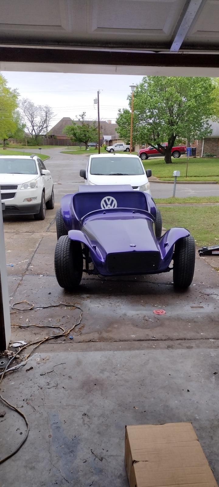

PostPosted: Mon Oct 11, 2021 5:31 am    Post subject: Re: Restoration build Reply with quote

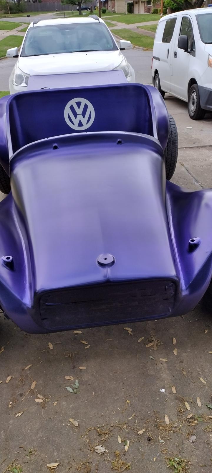

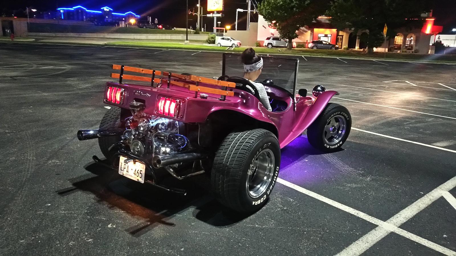

The day I got it

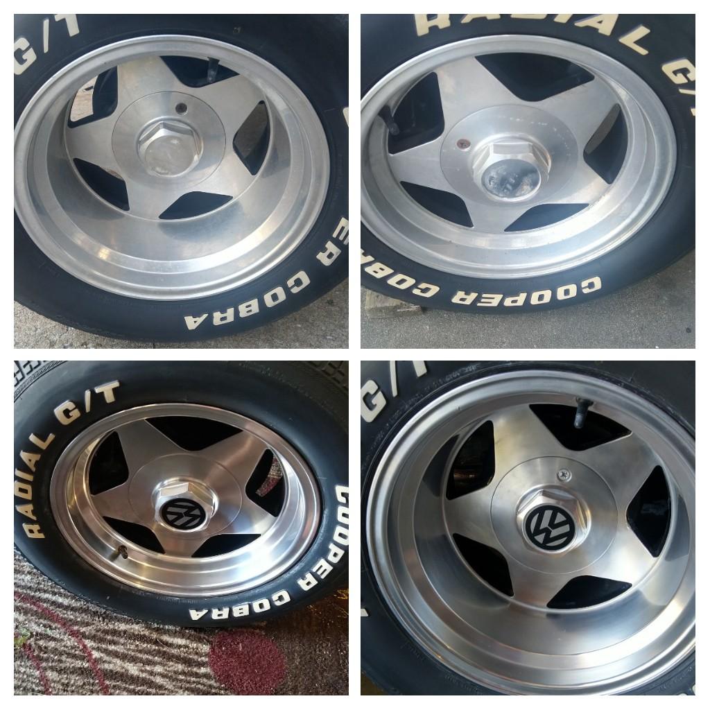

Polished the wheels
New floor pan coveres
Purple underglow (looks better in person)
Halo head lights

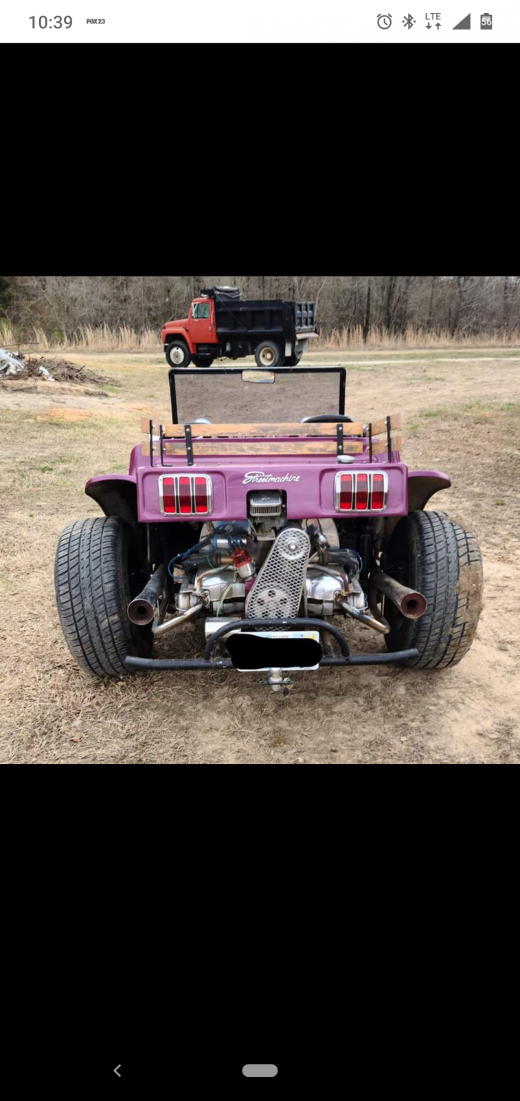

PostPosted: Mon Oct 11, 2021 5:34 am    Post subject: Re: Restoration build Reply with quote

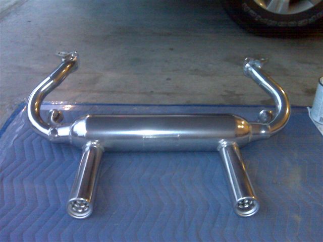

Exhaust after it was recovered
Started the tear down

PostPosted: Mon Oct 11, 2021 9:00 am    Post subject: Re: Restoration build Reply with quote
I like it a lot!! I even like the color.
As for the exhaust, those dual cannons are not doing you any favors. The engine would tune and run better with just about anything else but somehow they just look right on that car!

PostPosted: Mon Oct 11, 2021 11:12 am    Post subject: Re: Restoration build Reply with quote
Yes the color is the best! We are going to paint it just a few shades darker purple and add flake to it. Hard to tell in those pix but the paint is actually really bad. It has more texture than the textured walls in my house and runs everywhere.
No clue that style exhaust is bad for it. Runs pretty good. But with it trashedI got to go with something different, just not sure what. I like that look though.

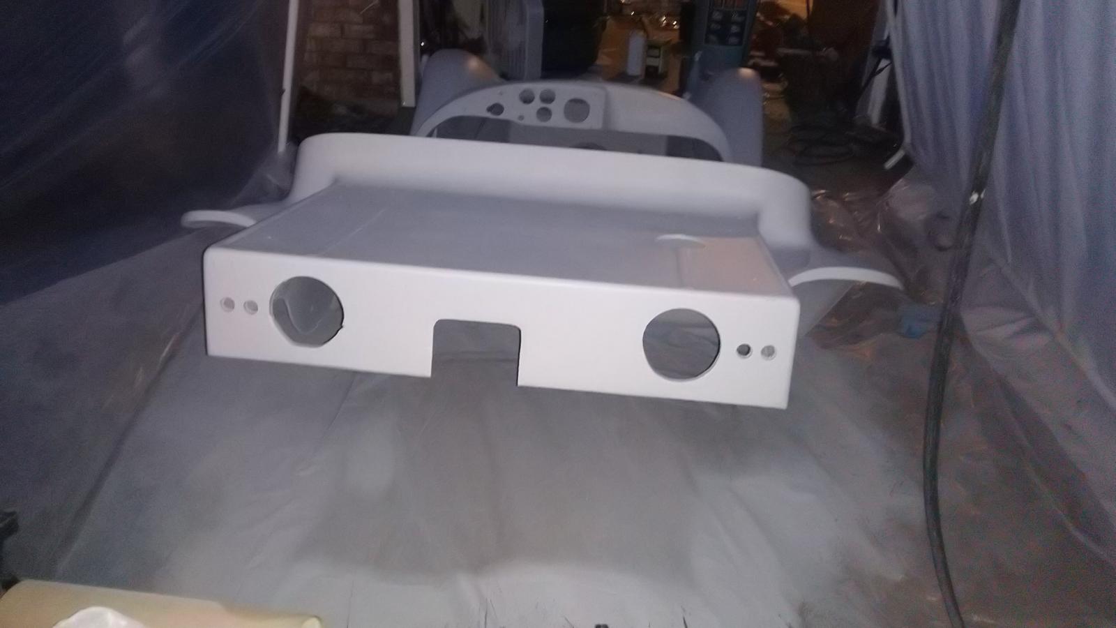

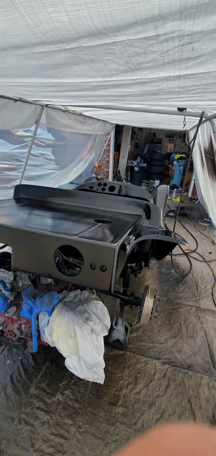

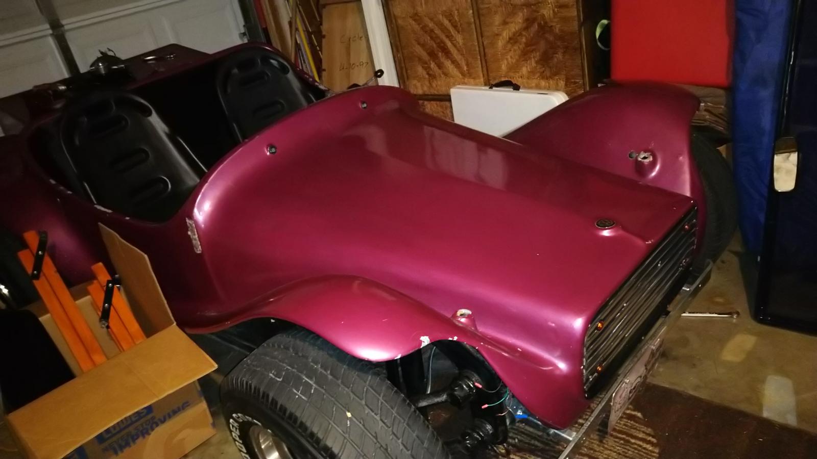

PostPosted: Mon Oct 11, 2021 11:13 am    Post subject: Re: Restoration build Reply with quote

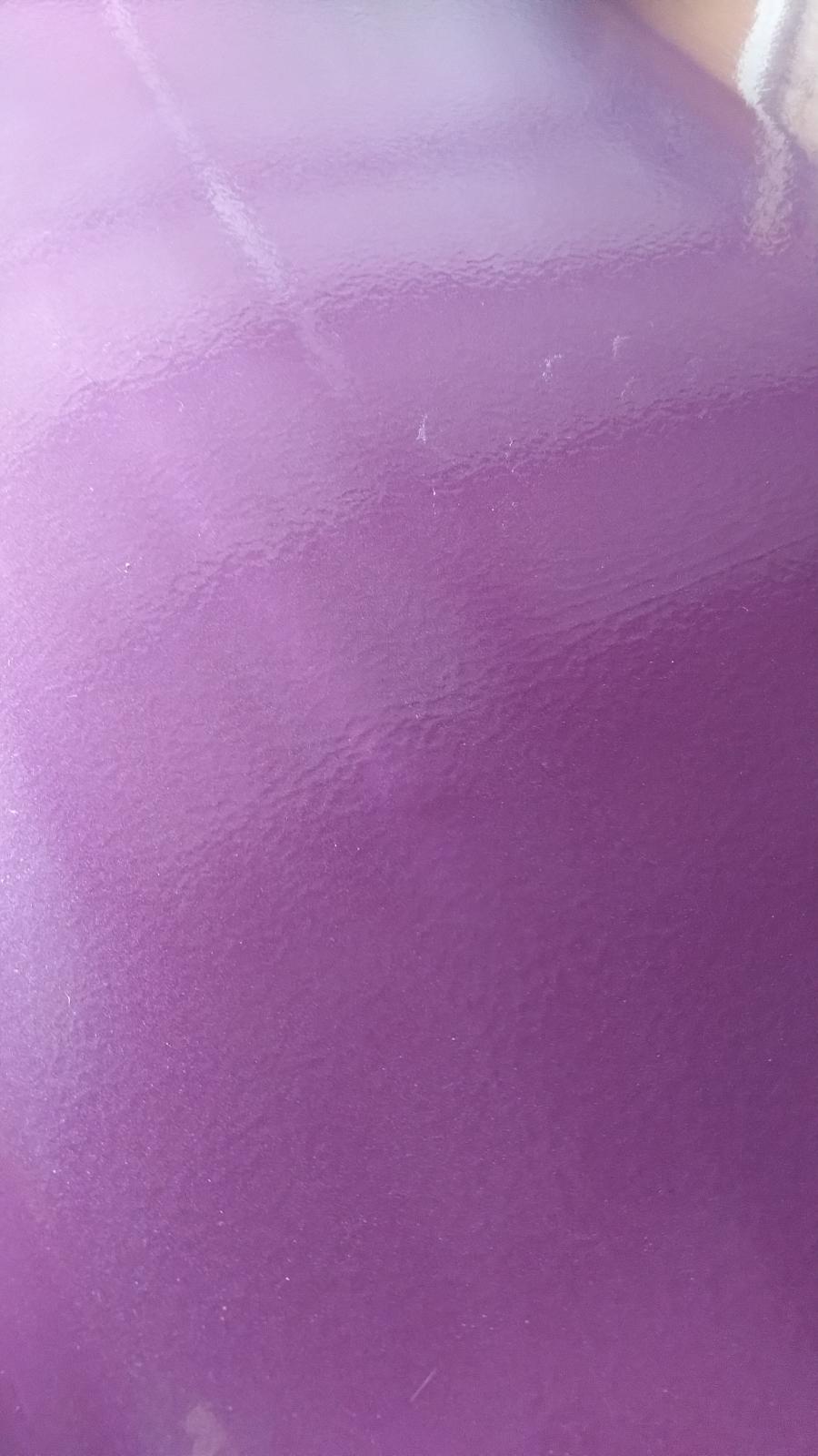

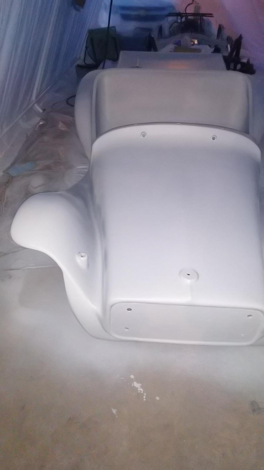

Here's a better look at the paint.

PostPosted: Mon Oct 11, 2021 3:38 pm    Post subject: Re: Restoration build Reply with quote
That's a Berry Plasti-Glass Mini-T, I've got one too. They are a fun buggy, always popular when running around, but they are a little cramped for room inside.
It looks like you have a nice intact example. I'm kinda partial to purple too. Mine is in very worn glitter purple gelcoat. Please keep us up to date as you make the changes that turn it into the buggy you want!

PostPosted: Mon Oct 11, 2021 5:23 pm    Post subject: Re: Restoration build Reply with quote
It takes special talent to get orange peal AND runs in the same paint job! Rolling Eyes
If you are truly happy with the way it runs and drives with the dual cannons it is either a fluke of chance or you have never driven an air cooled VW that runs properly. You will have to be the judge of that. Anyway they just look right on that car, anything else would detract from the looks in my view. A compact, low profile 4 into 1 might not look too bad...
If you do go back to cannons pick the ones with the longest primary pipes to lessen the interference between the two cylinders.

Laughing this is my first air cooled vehicle and the only one I have driven so I do not doubt what you are saying. I know very little about them, I use to build rx-7s before this (I like odd motors). I have a guy I use for any custom exhaust I get and am working on making something up. Would it be better to have all 4 into 1 outlet?
Or, call me crazy, but quad cannons? Not familiar if these "need" back pressure to run properly, I imagine I'd find a huge debate if I go looking for it.
oprn
Joined: November 13, 2016
Posts: 15244
Location: Western Canada
oprn is offline
PostPosted: Tue Oct 12, 2021 4:52 am    Post subject: Re: Restoration build Reply with quote
No, back pressure is of no real advantage, it comes it seems as a result of attempts to make an exhaust quieter. The smaller and quieter the muffler the more back pressure it creates. Big bulky mufflers reduce back pressure but are hard to hide on our rear engine air cooled cars. Yours is particularly vulnerable to this as everything back there is on display and as it was with all the chrome parts that dual cannon system was compact, tucked away for easy engine access and just looked good.
The issue with conventional dual cannons is that they pair the wrong two cylinders. This is done because they are conveniently close together and make for a compact exhaust. The firing order of the VW engine means that in this configuration the two cylinders paired are odd firing. You have a leading and a lagging exhaust pulses causing unequal cylinder scavenging and one cylinder to run leaner than the other. This results in that lovely "pair of badly tuned Harleys" sound that we have come to associate with VW dune buggies. With a center mounted carb the result is not so bad, just a loss of bottom end torque and some mild hesitation at light throttle. In a light car it's often overlooked as normal.
With dual single barrel carbs the problem is doubled as the intake side becomes paired wrong too and results in a two cylinder idle especially on a cold engine and drivability issues, stumbling and popping out the exhaust at light throttle.
A 4 into 1 exhaust is the easy solution as there are many options out there readily available off the shelf. One of those will give you back your smooth idle and bottom rpm torque but in my experiance top end power will change very little. The sound is completely different though.
A dual system that pairs the correct cylinders is not available commercially and is a bit of a challenge to fabricate but it can be done.
Another option I suppose is 4 singles. I believe they are still available and would look super cool but be aware that there would be no scavenging advantage that a 4 into 1 system gives and... I suspect... they would be loud!

One more exhaust option (in addition to @oprn's deeply knowledgeable suggestions) would be "stock-ish" choices, like this:
Or, this:
https://dunebuggywarehouse.com/vw-thing-exhaust-2-tip-ceramic-coated.html
That system still appears to be available, EMPI 18-1047.
Air cooled noob here, what do you mean by scavenging advantage? My thought is that's like the exhaust plus from the opposite side helping to kind of suck the exhaust out vs it only being pushed out by the piston?
I was playing with the 4 singles idea, might do it with a muffler if it's too loud but I'm not really worried too much about it being too loud, my last project was an rx7 and before I blew it up and sold it it was basically headers turbo and than 2 foot of downpipe out the side, nothing else. VERY LOUD, and cool flames Twisted Evil But that was a few years ago, younger and more ignorant.

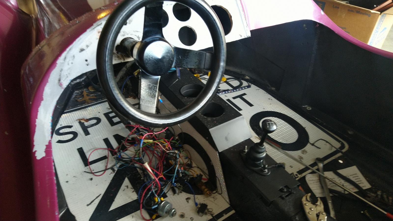

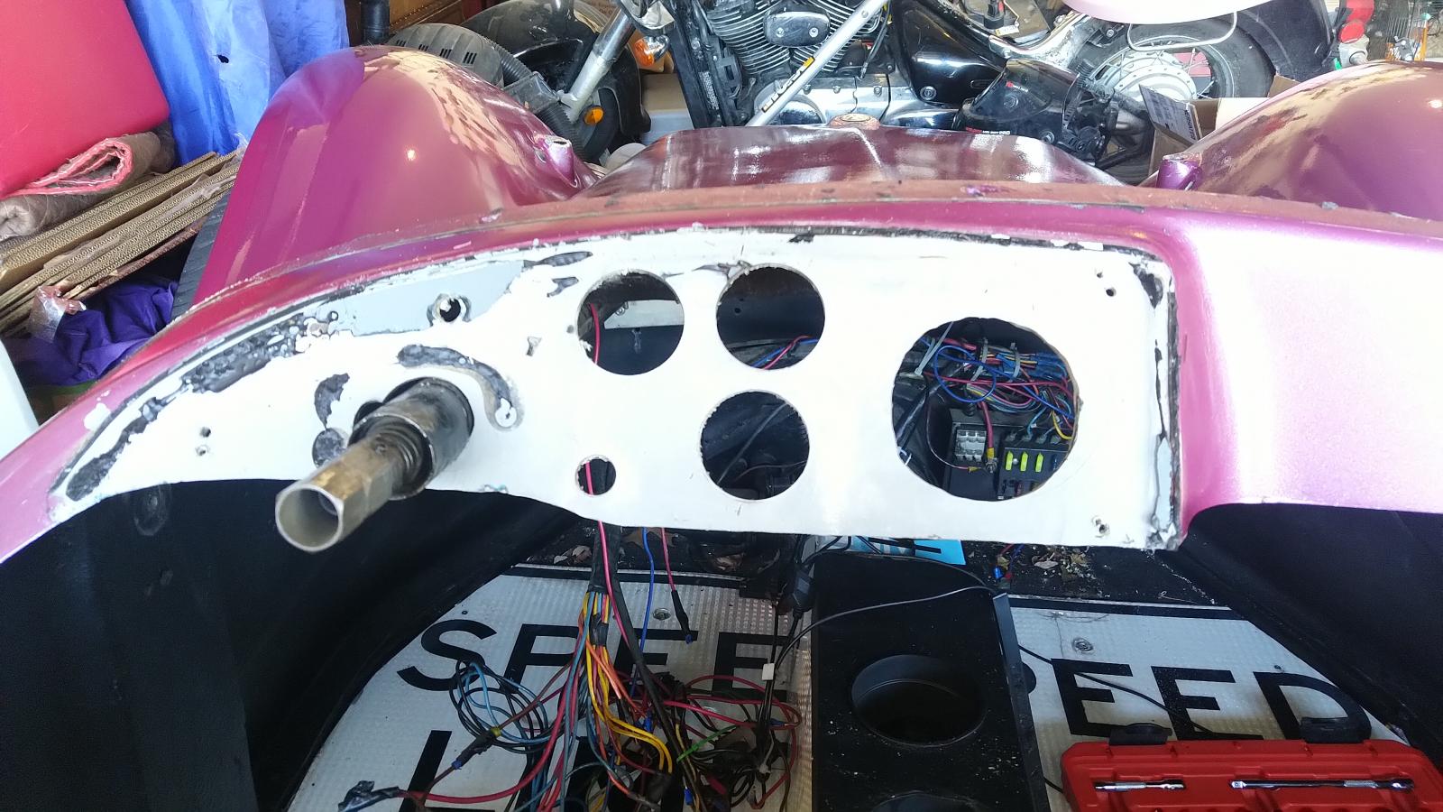

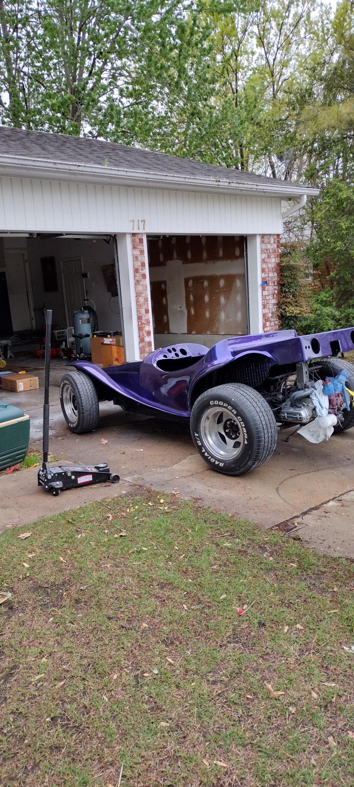

Put in a few hours of work, got the gauge cluster out and the rats nest of in marked cabling. Also found there was only 6 bolts holding the fiberglass down, and a TON of silicone. Body will be lifted off probably tomorrow which leads to my next question.
I have limited garage space so something will have to be stored outside. At first I was going to put the pan out there but the more I got to thinking about it. People are finding just the fiberglass bodies sitting out of in fields for who knows how long, so maybe it's better to store the body outside? It will be covered of course. Better for the cabling and the engine to be out of the potential for elements.

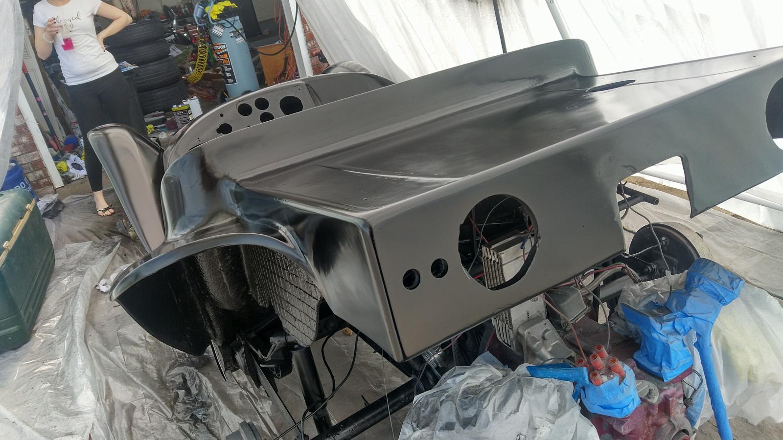

PostPosted: Thu Oct 14, 2021 1:02 pm    Post subject: Re: Restoration build Reply with quote

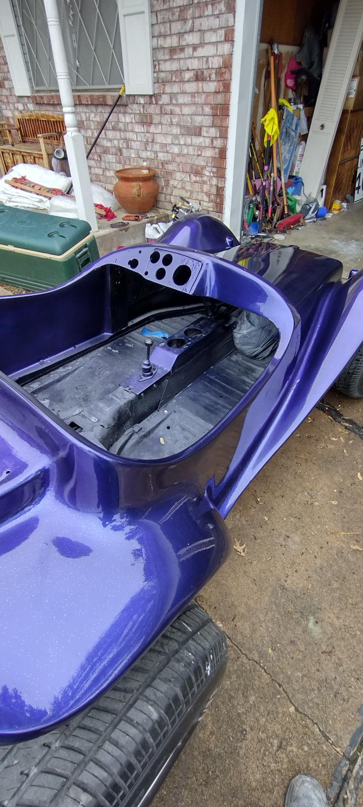

Got the body off. Not too many issues. First impressions.
Light surface rust in a few spots but that was expected.
Gas tank mount was not attached. It was just hanging there by 2 of the 4 mounts and am pretty lucky it was even on there.
I have lots of cleaning to do as well as cabling.
