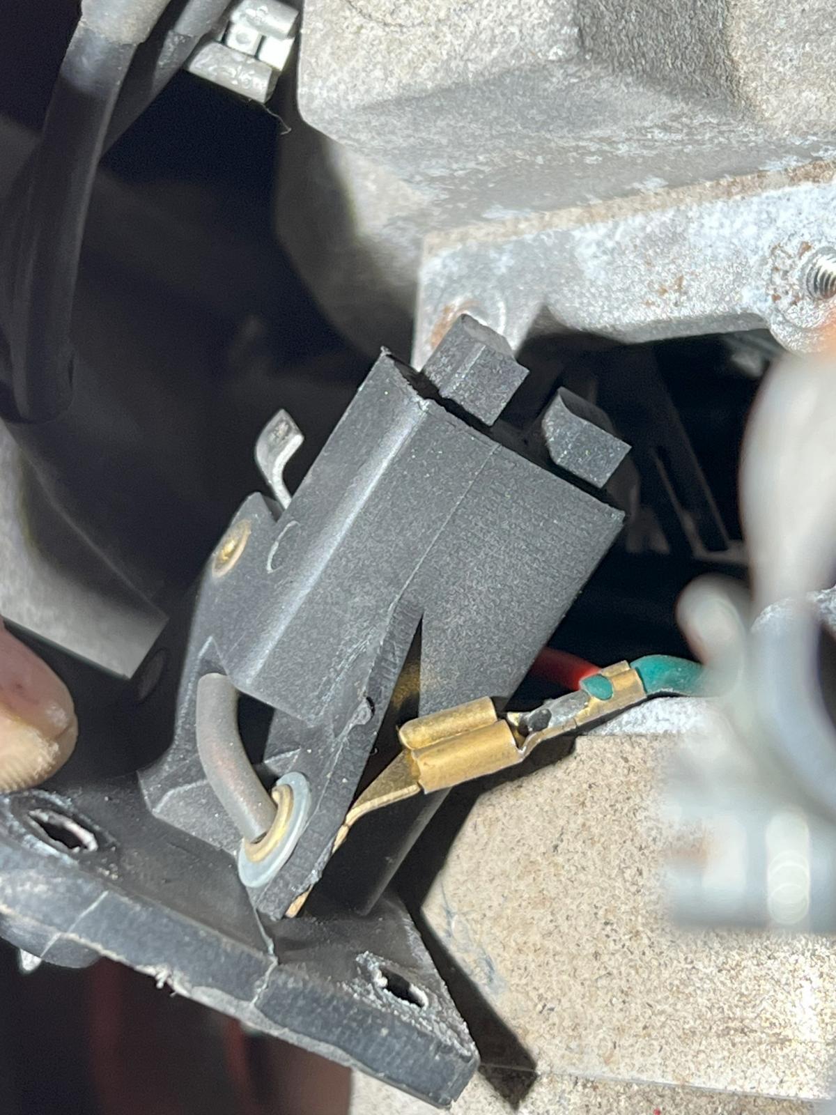

Hey guys,
I'm 150 miles from my last problem, time for another one Rolling Eyes
The alternator light has just come on (and staying on) on the highway towards Rome. I've pulled over, and troubleshooted it but it looks like the Voltage is at 13.7V - 14v and stable.
The red light goes off at idle but comes on again over 1500 RPM.
I have a volt meter on the dash which is reading 13+v and stable.
I checked the alternator bushes:
I'm a little confused about this behavior and unsure if it is OK to continue to drive. I'd really appreciate your thoughts on what's going on. Thanks
EDIT: Battery 1 year old with battery maintainer so it's not that
Wiring 4 years old so probably not that either?

HastaAlaska
Joined: November 22, 2012
Posts: 1450
Location: Off Grid
HastaAlaska is offline
PostPosted: Wed Oct 11, 2023 9:07 am    Post subject: Re: Alternator light on - but Voltage fine? Reply with quote
I've checked the tranny ground strap, it's fine.
The alternator B+ and Battery are both registering 14v whilst the D+ is registering 17v
Does this definitely mean it is the regulator? Or could there be another cause/something to check?
Back in 2012 the Alternator regulator went bad in Bolivia, but in that instance, the alternator and battery were registering 17v as well. A handy guy in the middle of the Andes adapted the alternator to have a new external regulator - not sure if the Italians would be willing to take the same approach or just install a new alternator
Mine here is also the Bosch 55A internal regulator style (i think AL82).
If it is definitely the regulator, is that something I can replace myself in the (literally) field?
If the battery and B+ are putting out 14v can I drive for parts? I'm off the road, 50 miles from Rome. Help appreciated.

PostPosted: Wed Oct 11, 2023 11:29 am    Post subject: Re: Alternator light on - but Voltage fine? Reply with quote
Could these symptoms be caused by bad alternator brushes?
They one have 30k miles on them which is way under the expected 75k norm but the alternator is used heavily in my application. Brushes I might be able to tackle myself, assuming I can source them.

PostPosted: Thu Oct 12, 2023 12:55 am    Post subject: Re: Alternator light on - but Voltage fine? Reply with quote
As B+ and D+ are both connected via diodes to the stator windings, if there is 17V on D+ it means the regulator is correctly commanding an increase in voltage.. as B+ is not getting to about 14.2 volts .
So its likely that one or more of the big diodes has gone open circuit.

PostPosted: Thu Oct 12, 2023 1:04 am    Post subject: Re: Alternator light on - but Voltage fine? Reply with quote
telford dorr wrote:
A major voltage difference between the alternator B+ and D+ terminals is usually an alternator diode problem, not a regulator or brushes. Unfortunately, the alternator is a dog to remove, involving an engine pull and fan housing removal. You know the drill.
If you're getting 14 volts at the battery, go ahead and drive it to someplace where you can work on it. Can't hurt the alternator any more than it already is...
I woke up this morning determined to get new brushes, but by the sounds of it that isn't my problem. Thank you for sharing your experience and saving me a big headache. VW Logo
I have the type-1 engine, so I think I can remove the alternator with standard tools, without dropping the engine. Mexico, 9 years ago was the last time I had to do it and I think the engine was out then. I can barely remember the process, so please somebody speak up if I'm about to discover a world of pain / need special tools, as I won't be able to drop the engine where I am.
I have a spare alternator back home, perhaps the best course of action is to get it shipped down to Italy ASAP.

HastaAlaska
Posts: 1450
Location: Off Grid
PostPosted: Thu Oct 12, 2023 5:43 am    Post subject: Re: Alternator light on - but Voltage fine? Reply with quote
Just retested, does this support your theory about the diode being the issue?
Unloaded (all house battery system off and isolated):
14.2 - 14.5 on B+ terminal
17 - 19 on D+ Terminal
Loaded ( house battery system charging at about 20-25 amps)
max 13.7 on B+ Terminal
Also, there is a bit of a droning noise audible at a certain RPM, have a listen to the video. Is that the alt bearings?
Note this video is with the house battery system connected and charging so it is not showing the full potential output of 14.4v. I've disconnected all house batteries from the alt now as I just want to focus on the alt related issue.
Thanks v.much

richparker
Joined: November 24, 2011
Posts: 7773
Location: Durango, CO
richparker is offline
PostPosted: Thu Oct 12, 2023 6:07 am    Post subject: Re: Alternator light on - but Voltage fine? Reply with quote
Just buy a new alternator and move on.

jmstu76
Joined: March 01, 2004
Posts: 1281
Location: Edmond Oklahoma
jmstu76 is offline
PostPosted: Thu Oct 12, 2023 6:46 am    Post subject: Re: Alternator light on - but Voltage fine? Reply with quote
This made me laugh. Yes you have an Alt problem. Get a new one.
