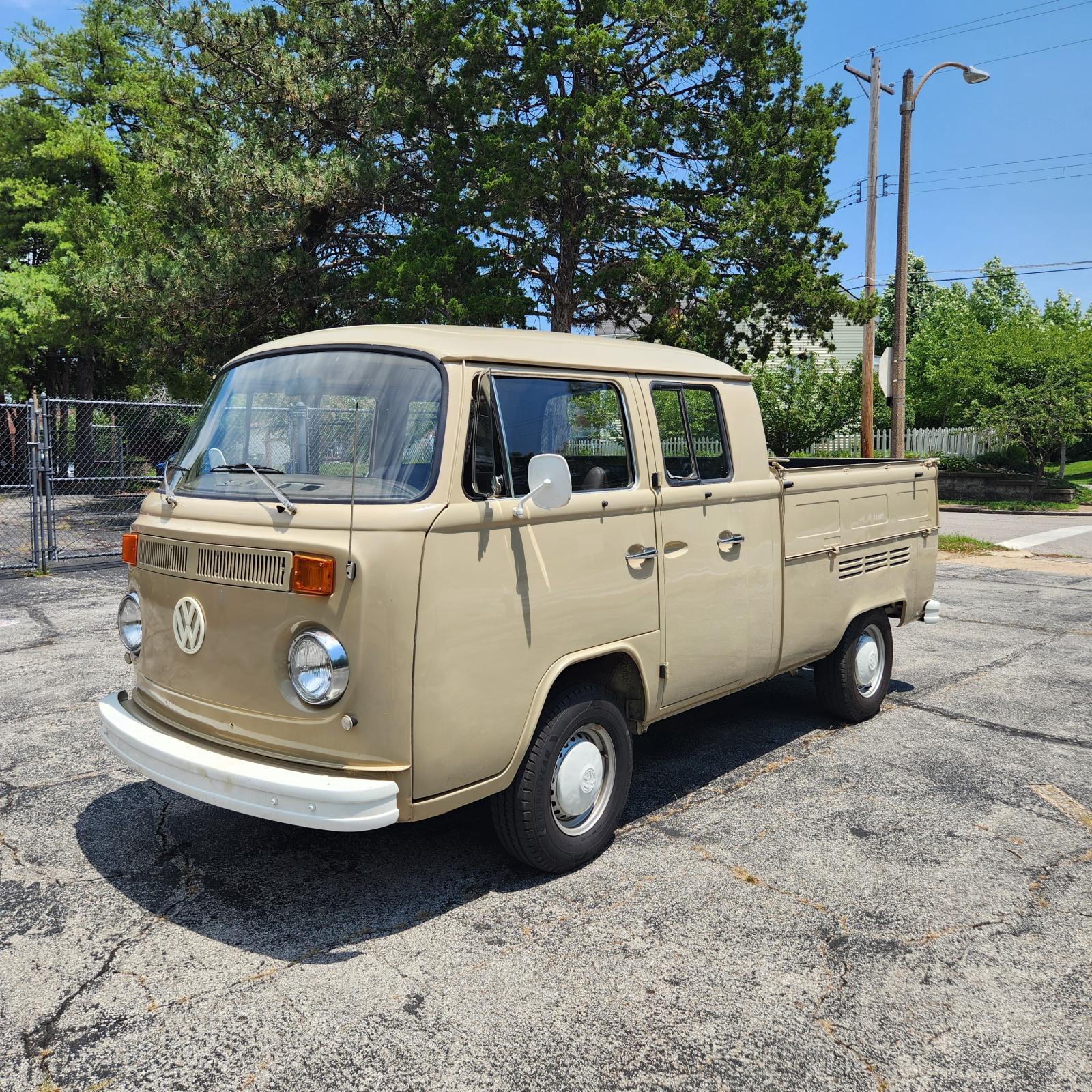

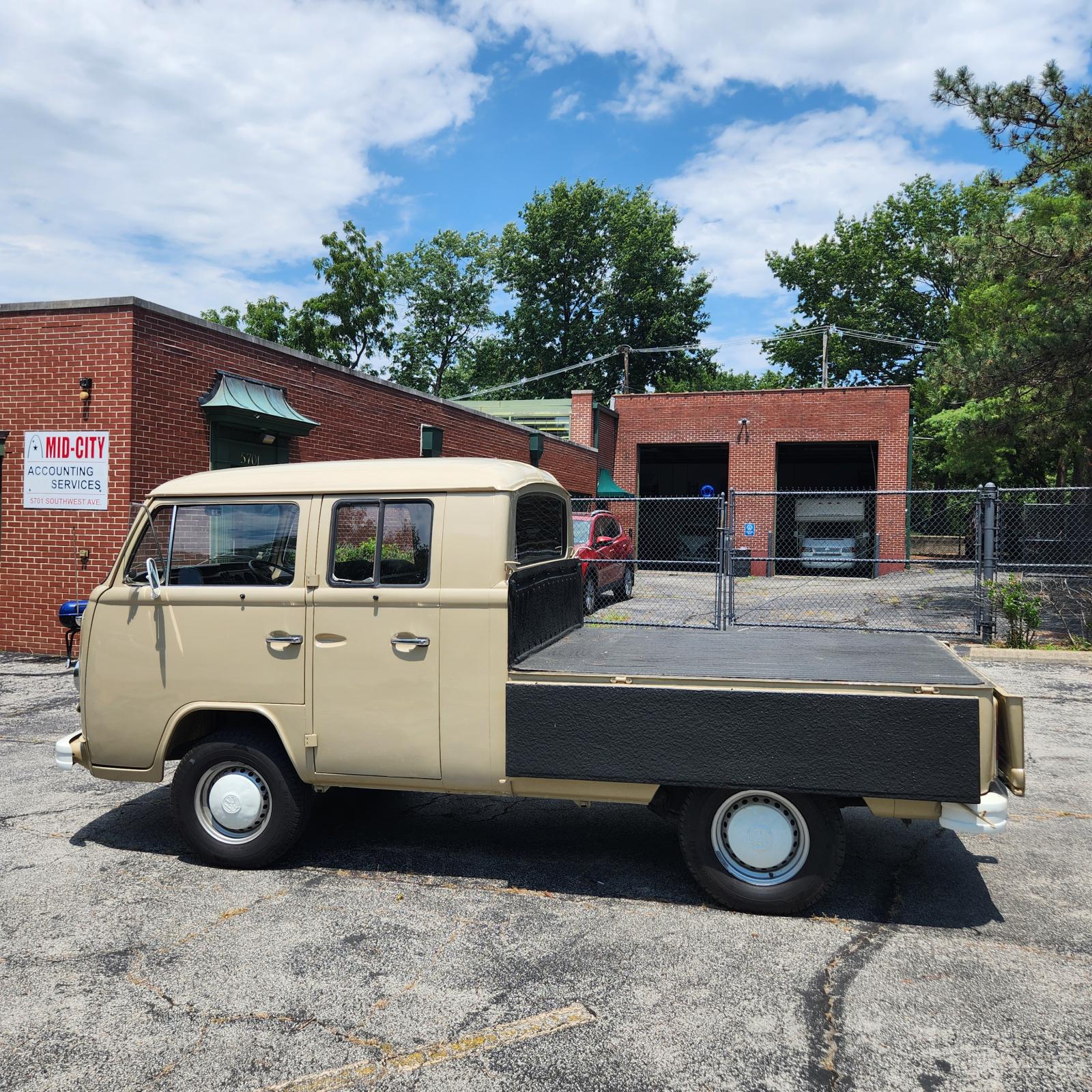

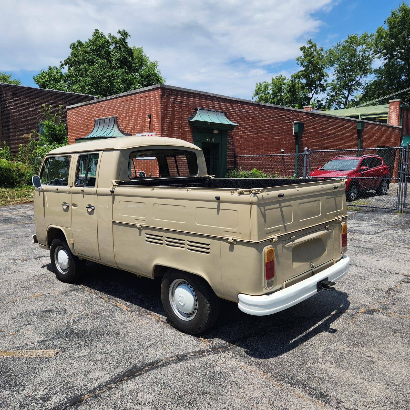

Hey there. Long time Samba member, maybe my 1st time ever being in the bay window forum.
I been prowling for a Bay Window DCAB for years and the dream finally came true this past weekend, so I thought I'd do a little show-n-tell.
Months back, on the Facespace in one of the VW groups, I happened to see a post from a non-ACVW guy who had just bought and imported a late DCAB from South Africa. He mentioned that he usually only keeps cars that he buys around for a few months and then passes them on, so I posed the obligatory "wHeN yOuRe ReAdY sElL iT tO Me" post.. and much to my surprise he PM'ed me right away.
Over the next few months we stayed in touch.. calls and texts with help & advise while he sorted through some issues with the bus.
Then, about a month back, right around the time we'd also just bought a '70 Ghia coupe.. he says he's ready to move along already and interested in selling! YIKES!
uh, ok.. so luckily here I won the gorram lottery in the spouse department.. and a few weeks later this babydoll was rolling off a trailer at the shop!
It was about 150*F here in STL Mizzery yesterday, so I haven't gone over it in great detail yet, but we did go around the block a few times at least. Needs some tweaking and the gorram Beetle muffler with no pea shooters replaced with a bus exhaust.. but otherwise I'm pretty pleased. I'm SURE the shiny new paint is hiding some sins, especially around the windshield.. but our intent is to actually use it as a shop truck, and the price was extremely reasonable so I'm OK with any shenanigans I've seen so far.
Plus the spouse is absolutely enamored with it being RHD.. probably even more excited for this than the Ghia! so what more could you ask for?
Now, some pictures!

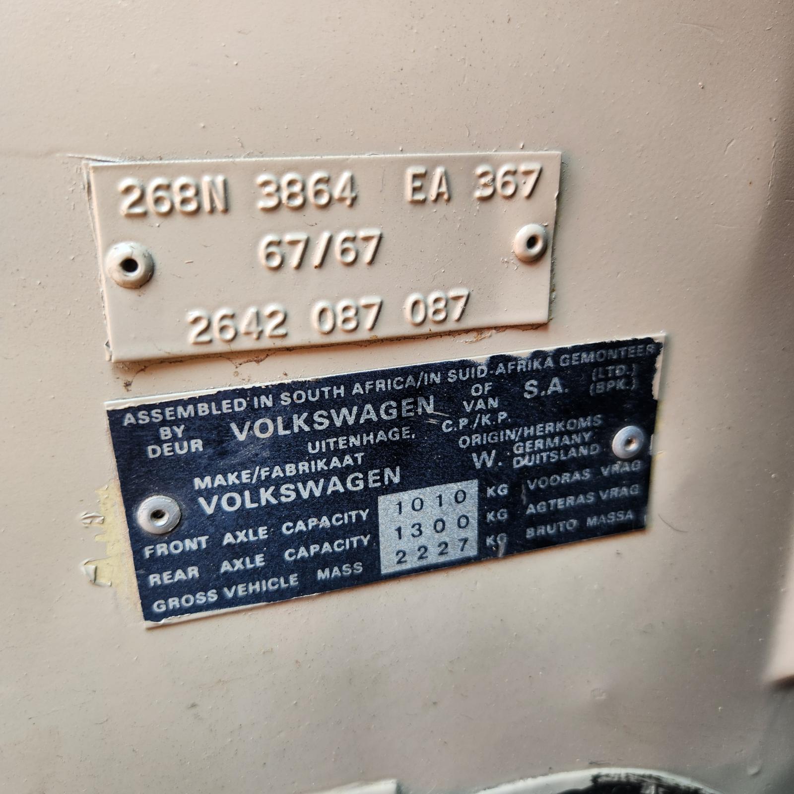

Build plate:

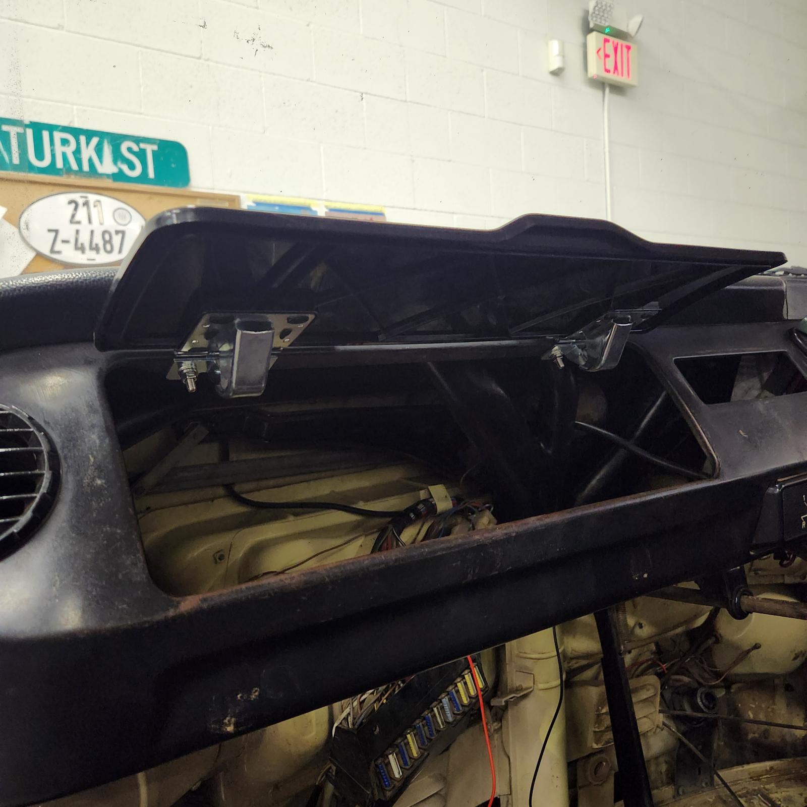

What's the whitish colored knee basher box under the steering column for?

Seems to be just some kind of strong box or lock box.. lock cylinder is missing.

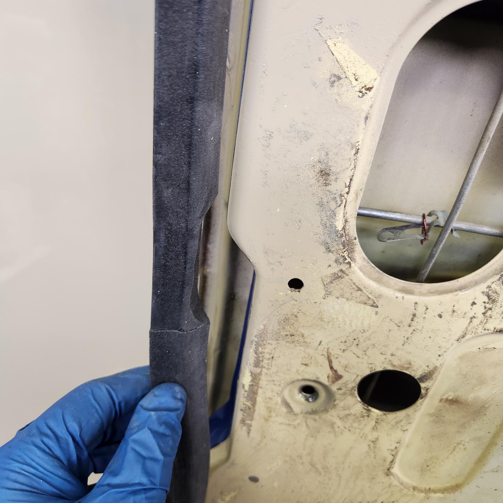

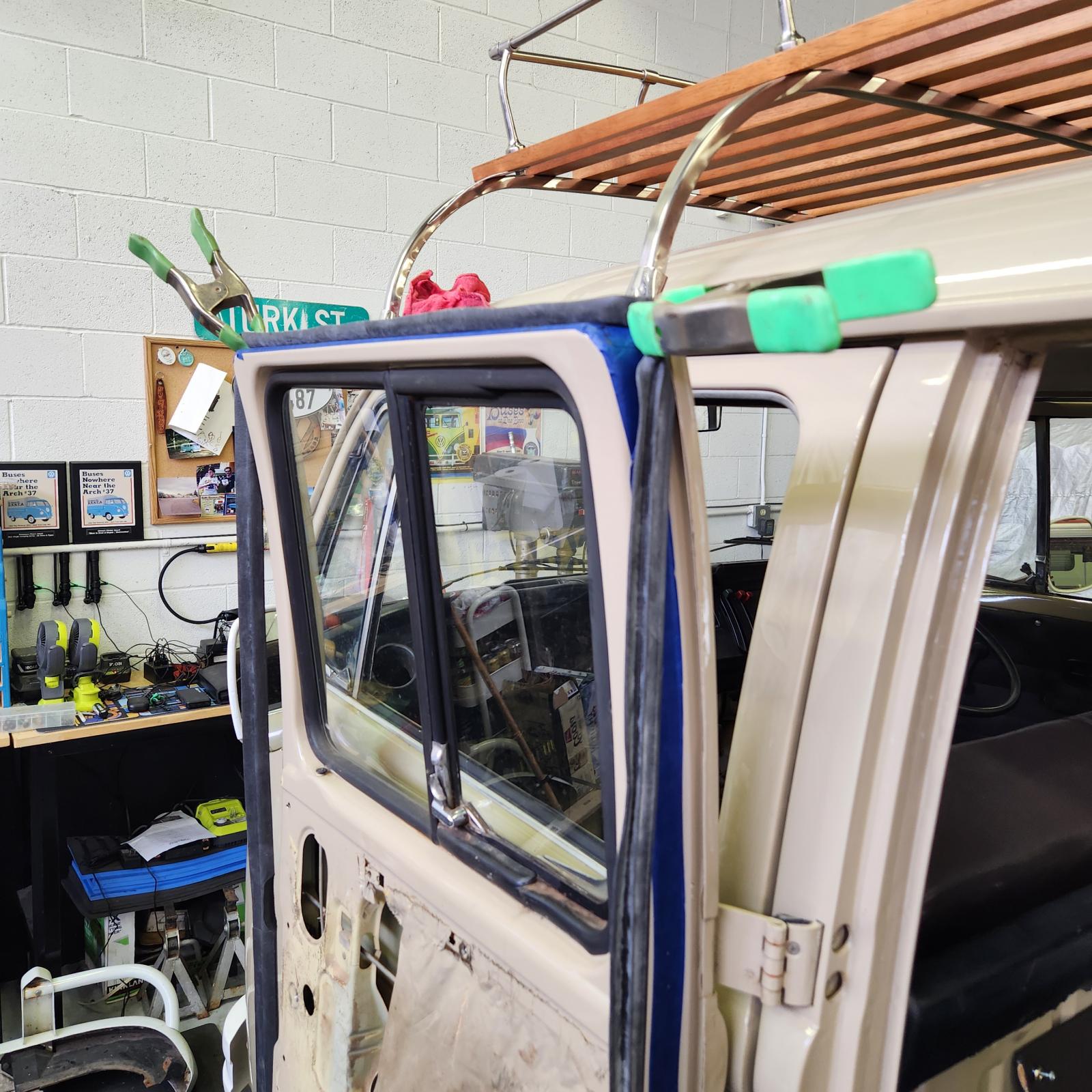

speaking of 3rd doors.. There's no door seals at all on this bus and I'd like to rectify that. The front doors are readily available, but I haven't found anywhere listing a bay window dcab 3rd door seal.. much less a RHD one. It looks like it *might* just be plain square seal like a splitty, but I haven't seen another one to compare it to yet.
anyone got a lead?

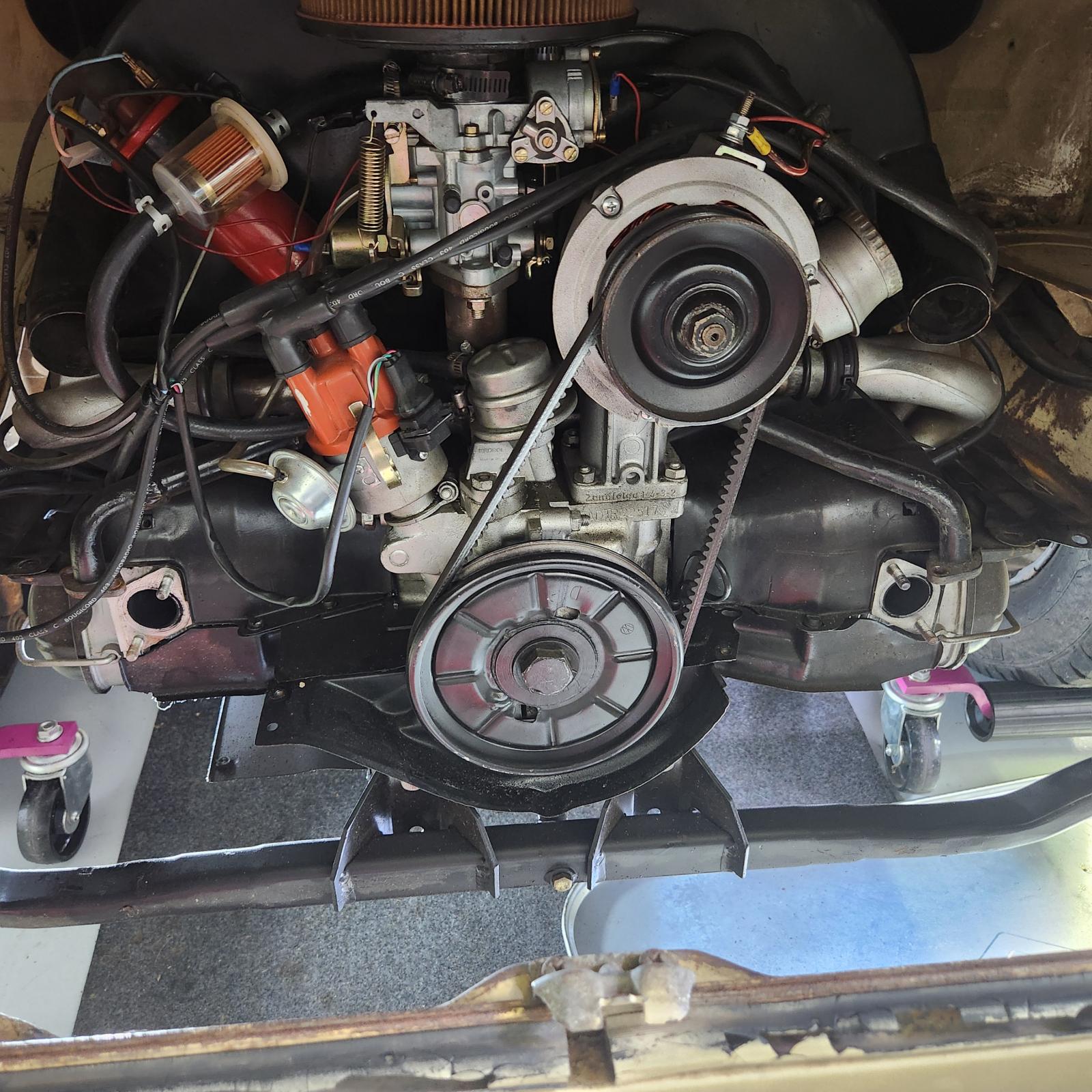

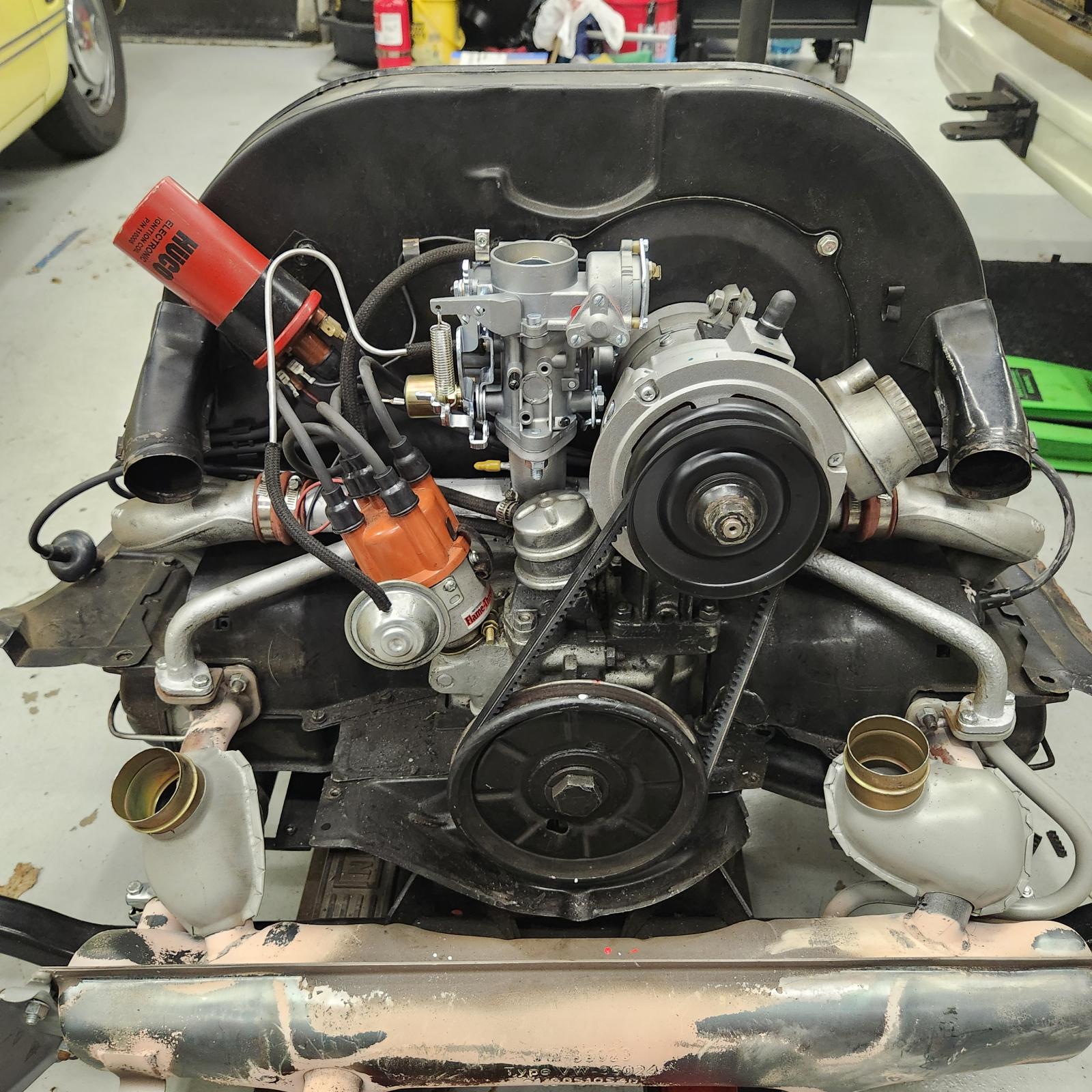

Now that I've wrapped up work on the '70 Autostick Ghia we picked up earlier this summer, I can finally turn my attention to the DCAB

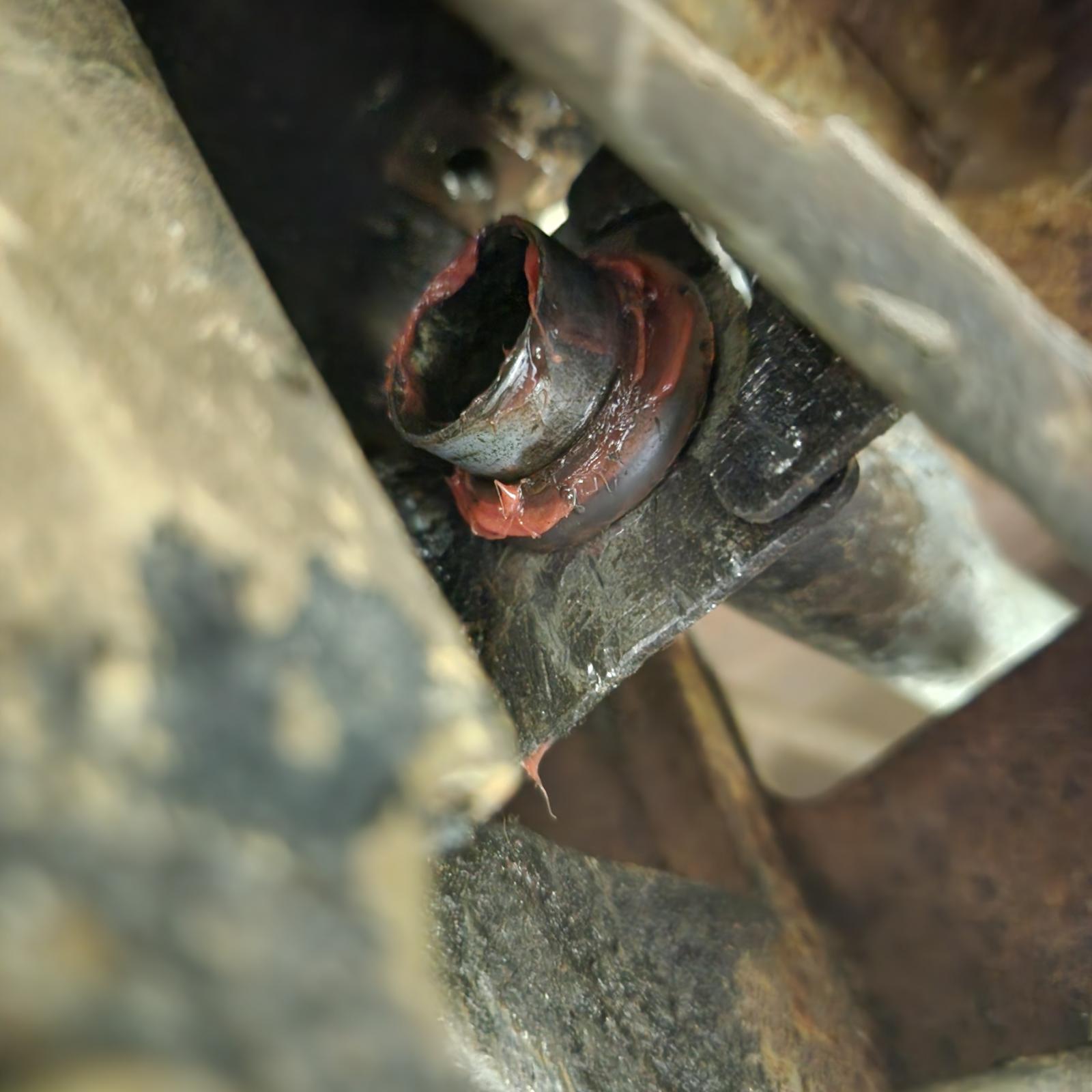

1st order of business was to jettison the Beetle exhaust and J-tubes. Everything came off easily, but now I'm starting to find all the bullshit.
early clutch adjuster - no bueno. installed a later wing-nut last night

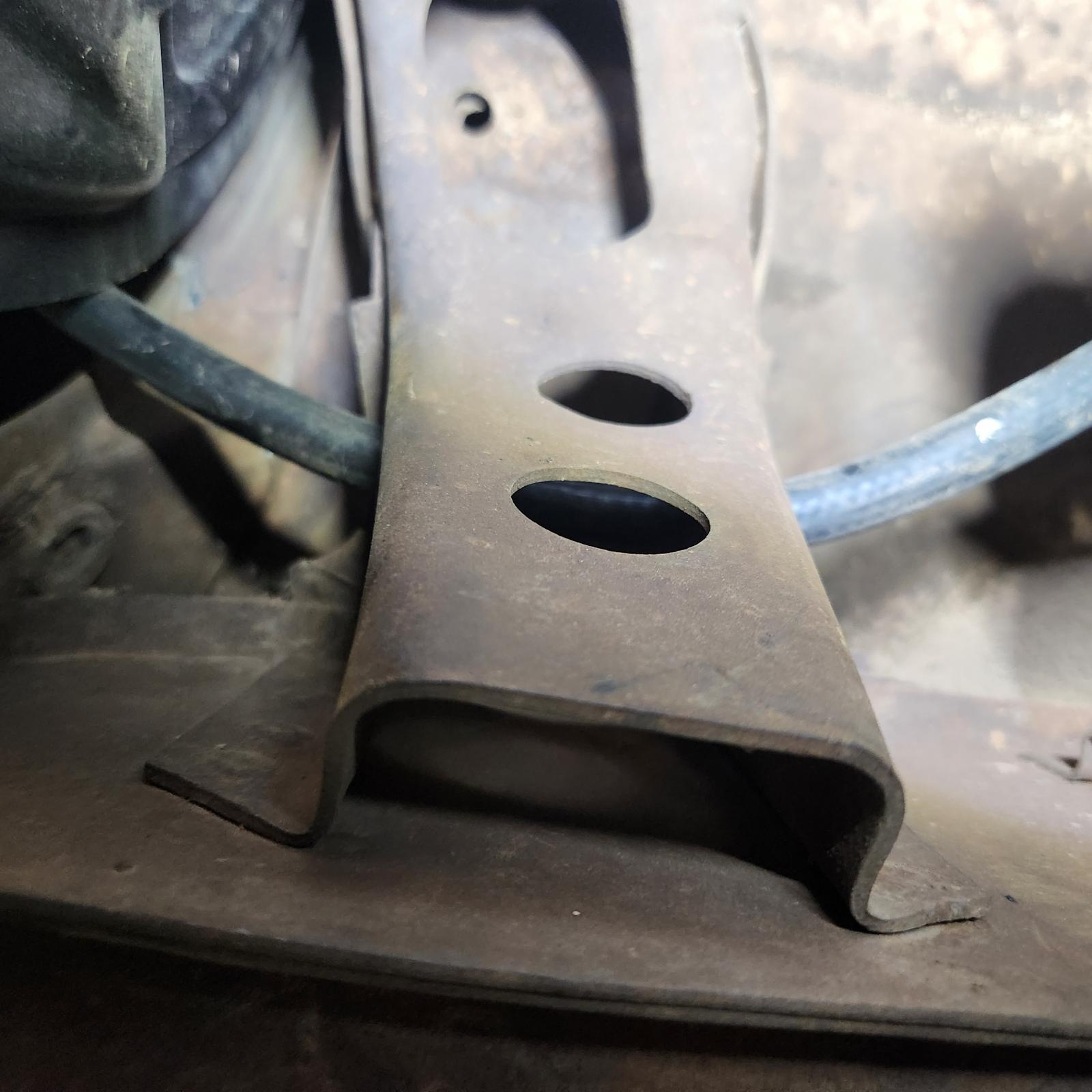

fuel line routed through the frame and between the engine tin & bay.. double no bueno. I started last night on re-routing the fuel line and installing a new metal line from the pump to the front tin.. and holy hell why is this line so damned stiff..??? Then I see the stamping on the hose... "COMPRESSED AIR" Shocked holy hell man! So, now I guess I'm replacing all the "fuel line" back to the tank Confused And I'm out of fuel line in the shop... uhhggg..
I removed the distributor for easier access to the fuel pump and clamps.. let's have a look at this oddball electronic ignition..
1st, the cap and rotor fit seems really sloppy.
Distributor code: S211006
anyone know about it? All I can say is that it kinda looks like the units on MexiBeetles.

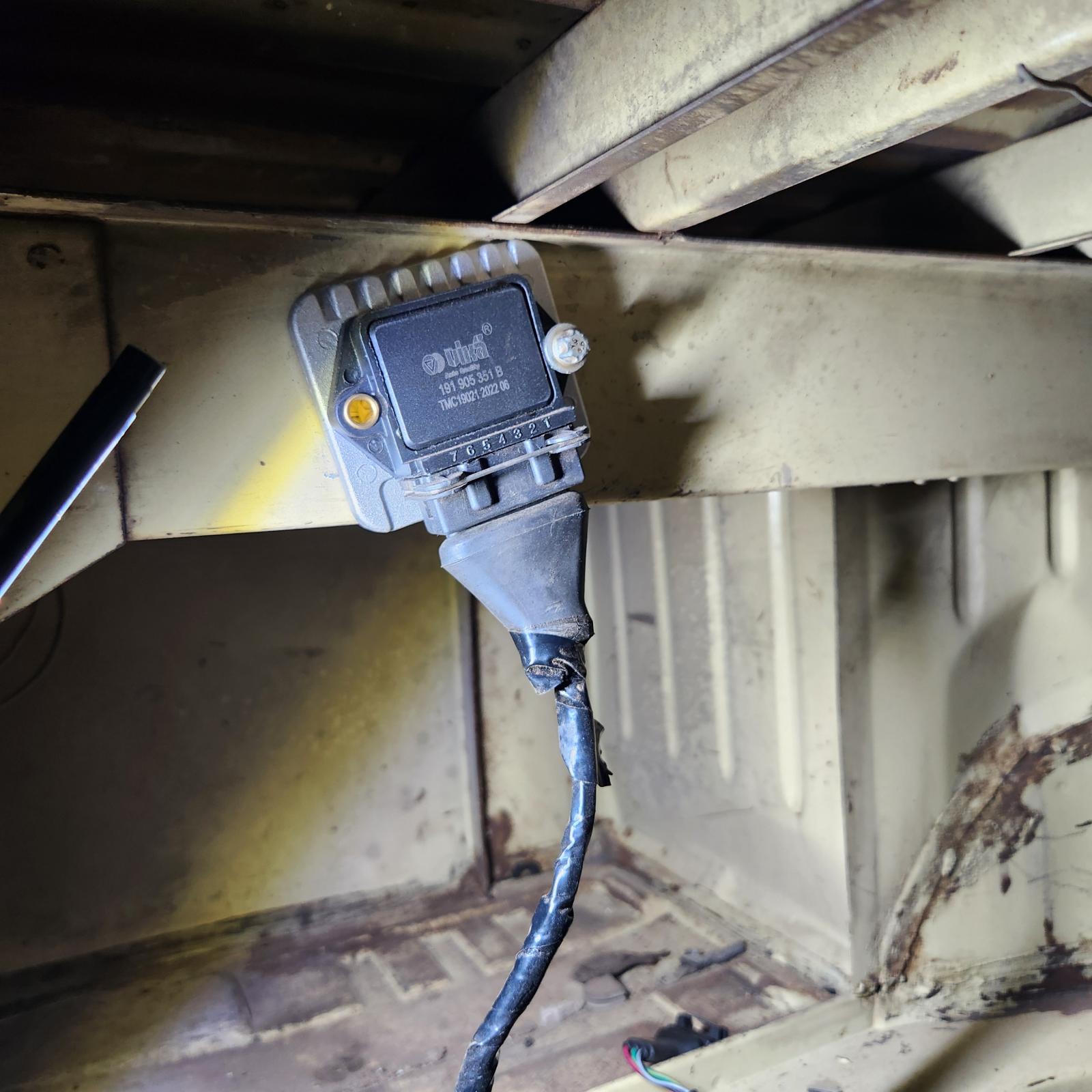

and what's that little box connected to the dizzy & coil?
plug wires are not VW ... so that's on my list now too.

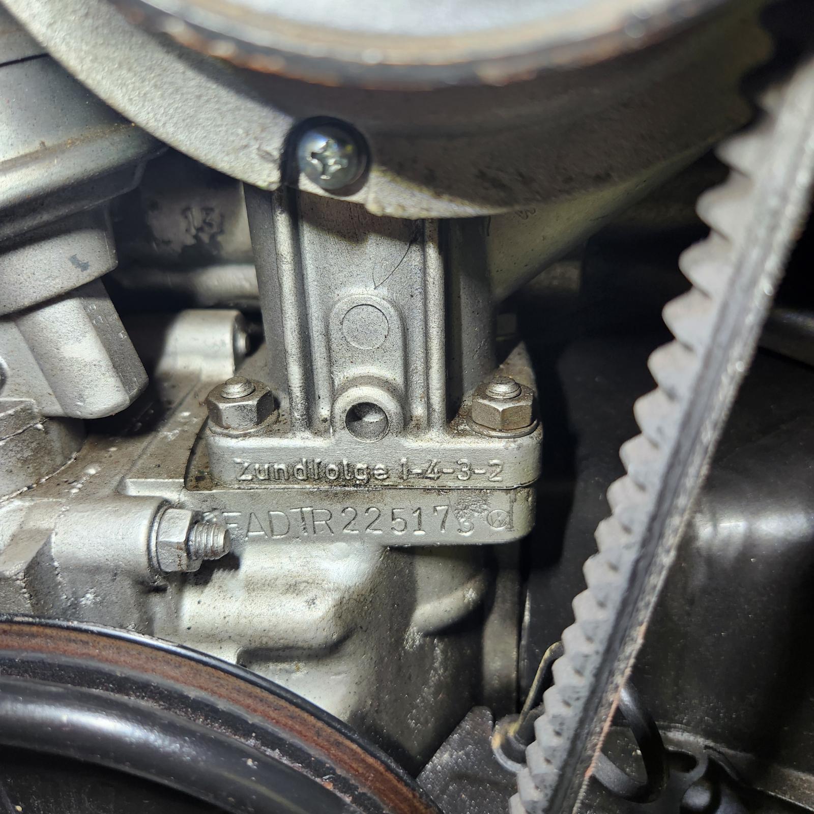

and lastly.. a parting shot of the engine case #

Looks Vanagon style. Read this.
https://www.thesamba.com/vw/forum/viewtopic.php?t=790113

so that's interesting.. it has a vac advance though.. so maybe like a 1.9L vanagon.. ?

Probably right. Mexican style late type 1. See if this helps
https://en.hoffmann-speedster.com/distributor-tsz-h-mexico-beetle-8.87-7.92

Your ignition just looks like the Hall ignition used on later VWAC engines and many other products. I would be concerned about the condition of the wiring harness for it because of all the tape as the tiny wires break easily. Numbers off the distributor would identify what you have. Your timing range is likely 28-32° BTDC at 3800+ rpms, hoses removed and plug during testing and adjustment. You might run the timing at the retarded end of the range during the summer and the more advanced end during the cooler months.
