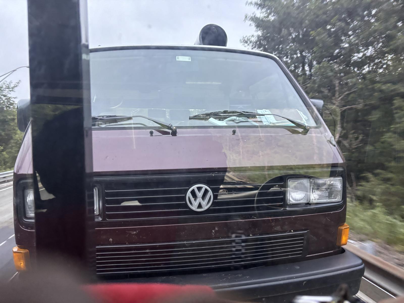

The first tow of my entire life!!
AAA premium 200 mile limit, I was only 36 miles from home returning home from running an errand to Lakewood NJ.
To think my 10,192 mile trip went well.
I believe it is water in the ignition, NJ had torrential rainfall on Thursday which I was driving in.
The engine idled rough at a red light or two, at the next light I pressed the gas and it stumbled.
There was a gas station right there so I pulled to a pump to fill up, turned off the engine and it hasn't started since.
I carry all the parts I need to fix this problem alongside the highway but the Van was so loaded with boxes that accessing the parts or the engine in a rain storm was nearly impossible, packing this Van was a half hour game of Tetris! Rotating boxes and arranging them just so. There wasn't an inch to spare.
Flat bedded it home and parked it.
This morning I'll start diagnosis.........
