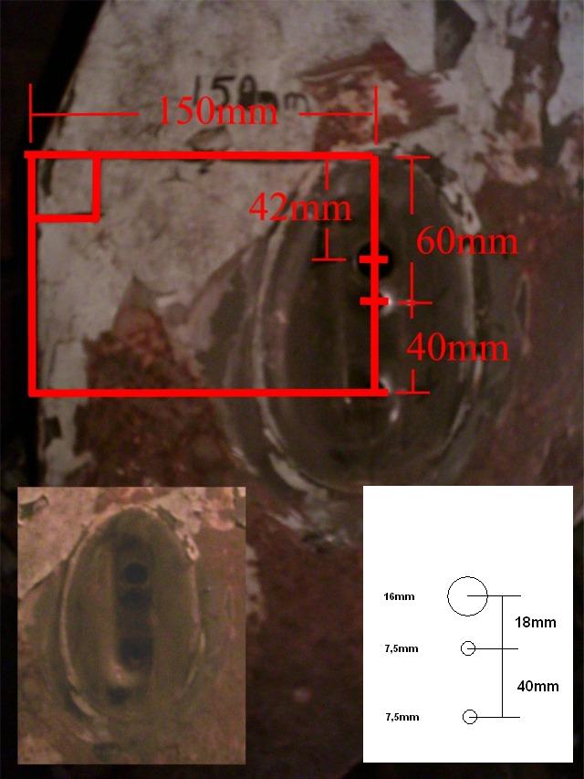

As promised. Split taillight location as follows. Very Happy
Notice that there is a bulge for the bulbholders.
Edit: Fixed the picture link too.. Smile
The original photo is lost due to the original gallery been deleted but here is an improved drawing for the rear taillight for split beetles. This also show the shape/position of the dimple..

PostPosted: Fri Nov 02, 2018 9:27 am    Post subject: Re: Heart tail light position Reply with quote
That is the same picture as I posted too but the original photogallery where it was before is down for ever but it seems to have been posted in the Samba gallery now too. Very Happy

banana split wrote:
Found this in the gallery :
Thanks for this.

PostPosted: Thu Oct 25, 2018 6:26 pm    Post subject: Chasing heart mounting hole positions Reply with quote
Hebster52 wrote:
Here you go! Very Happy
It's in Metric, but I think you can recalculate the measurements.
The photo posted with the hole position does not seem to be available anymore, would anyone have a copy of it?

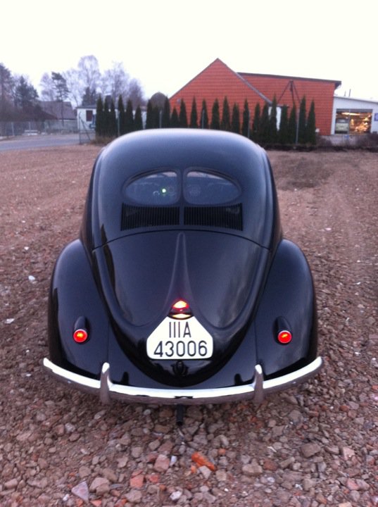

17 years ago, I found the rear panel from an early oval, starting half way down the window to luggage area including the vents and the luggage rails, in a scrap yard, paying $10 for the lot! Upon seeing that, I immediately remembered I had a w-decklid, which a friend had thrown away in a skip, stored in my granny's basement. I put 1 and 1 together and ended up with something quiet unique!
Here are 2 pics of the grafting:
I just couldn't resist adding the vent trims then, giving the decklid a more factory-intended look!
The closest I ever saw was this one:
It's not a common sight considering what you need to chop up to fabricate it! and it cost me close to nothing!

I used the information on this thread to find the proper postion for my hearts. Very grateful! Wink
Here's a pic of the end result, with the hearts in place,
and also on the 3rd brake light topic, a picture of the 51 pope nose brake light, coupled to 53 hearts! no twin filaments were used in the production of this photo Smile

nick696 wrote:
Anyone know the diameter of the holes?
for the gasket or seal 1/2 inch,and for the bracket 1/4.
nick696
Joined: June 25, 2009
Posts: 198
Location: Belgium
nick696 is offline
PostPosted: Sun Apr 08, 2012 3:40 pm    Post subject: Reply with quote
kdfwagon wrote:
I don't know if this helps but I found this on an old file on my laptop.
Thx but this is the one for past heart light
I need the diameters for the heart lights itself.
I guess I'll just measure my brackets and guess the other holes
