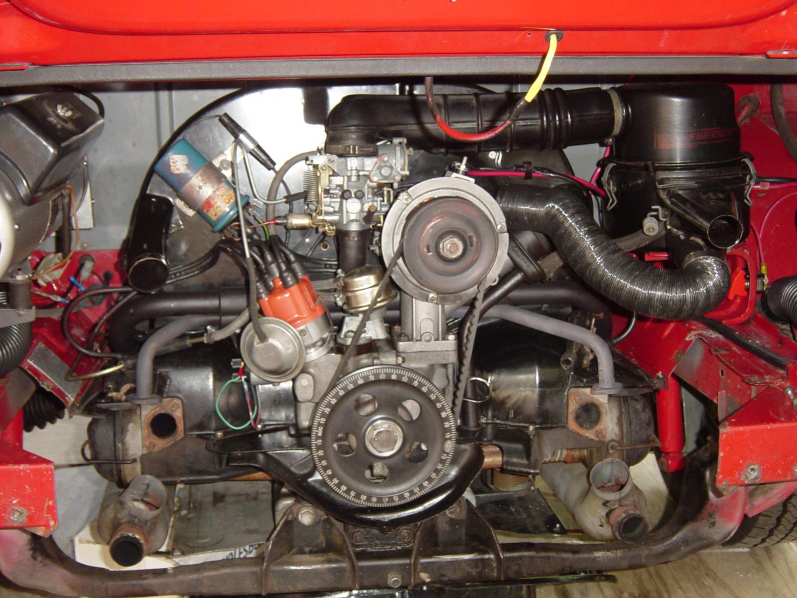

I am also trying to figure out if I can get dual carbs in my early bay engine compartment with BN4 heater installed. I believe I have the early style BN4 heater with exhaust coming out at 7-8 o'clock. I did read a handful of posts and it sounds like some have been able to move the heater further to the left, but I don't see anyway of changing the BN4 duct penetration anywhere different than the leftmost firewall area. What are the lowest profile dual carb setup that might fit? Here are a couple pictures showing my engine compartment.

Dave, I've done it, it is a bear! Smile You can barely see it on the left side of the pic I posted. It's possible, but for most people more work than it's worth.
