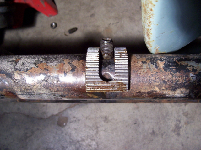

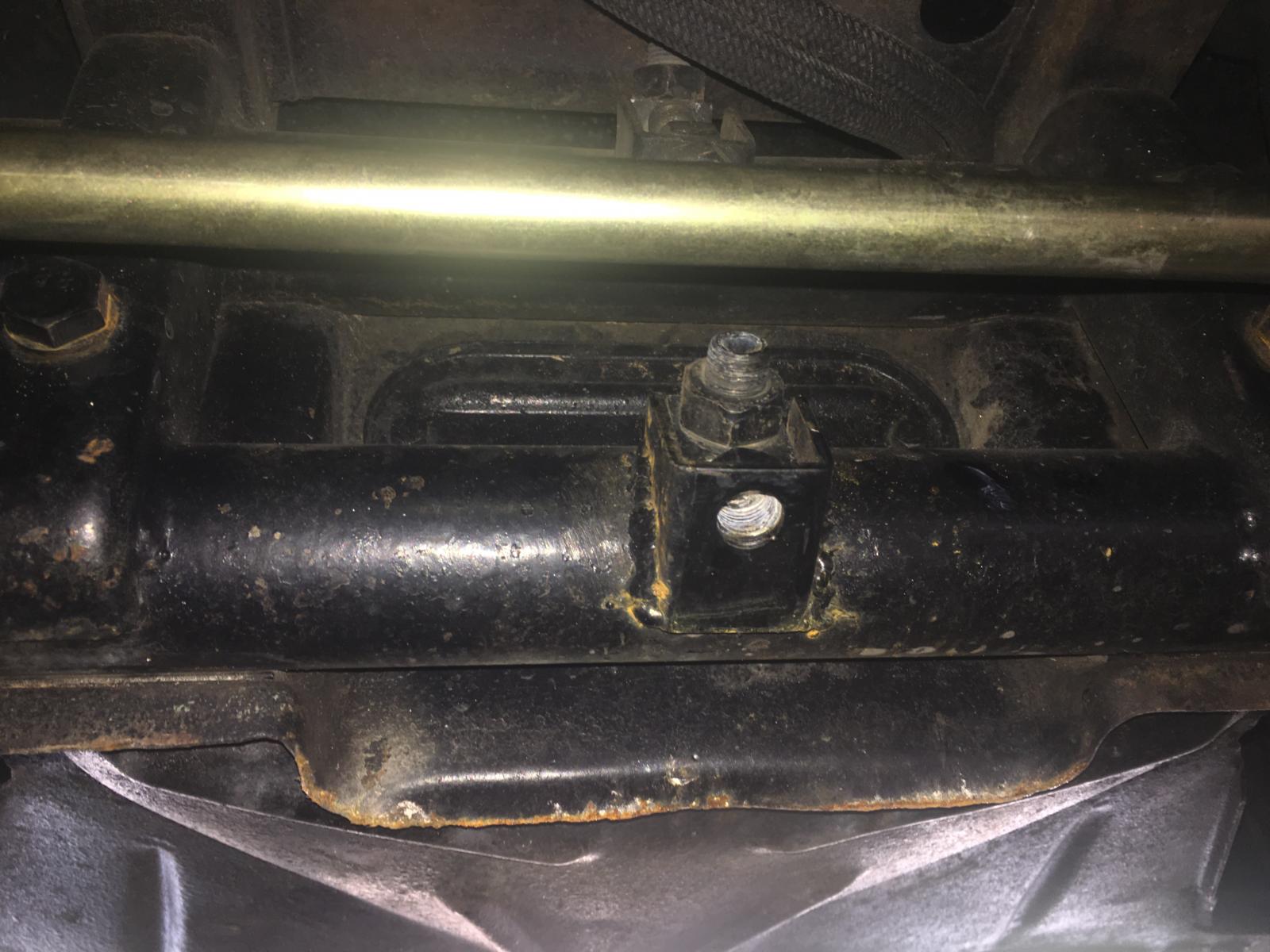

Yes.. missing the actual (lower beam) adjusting jack screw .. It should look like the top beam adjuster.. hope its not stripped.
If it is, the nuts are usually just tacked in place & are easily removed with a couple of good strikes with a hammer & drift. There is usually enough of the tack weld in place to keep a new nut from spinning until you can get it tacked in place.
Lots of people leave the lower bolt out to keep the adjuster from being damaged when the car is excessively lowered.

Those are typical Sway A Way style adjusters and appears to be a replacement beam.
VOLKSWAGNUT wrote:
VOLKSWAGNUT wrote:
Adjusters..
Sway-a-way
Select-a-drop
Avis or Berg.
Stock spindle
Drop Spindle
VOLKSWAGNUT wrote:
VOLKSWAGNUT wrote:
yes its an adjustable beam
As for adjusting
VOLKSWAGNUT wrote:
Red arrow adjuster jack bolt, Blue arrow "Grub" torsion bar centering bolt.
Having the fuel tank loose so it can be rasied will help access the upper tube adjuster and makes adjusting easier.
Raise the front of the car.
Loosen both locks nuts per tube (4 total 2 upper 2 lower) while holding the center (allen) bolts snug
Turn (out =lefty loosey to lower or in = righty tighty to raise) the adjusting jack bolt indicated by red arrow,
Adjust both beams preferably equally or as desired.
Lower car to allow torsions to settle, Jounce/Bounce the car.
Snug all lock nuts with vehicle lowered so torsions wont move when raised in the next step.
Raise the car and tighten lock nuts, but before tightening blue arrow lock nuts, be sure center "grub" bolt is still fairly snug
Lower car, roll it back and forth, or drive it back and forth and check height,
Readjust as required, or if its good, have the alignment checked.

You’re missing the vertical grub screw that pushes the adjuster up to raise the front. I believe that is called an Avis adjuster?

This thread hasn’t been active in a while so I do apologize, but since this is the “lowering thread” I wanted to post in the correct place. I have a 59 with a 2” narrowed beam and it is adjustable. However, I cannot find info on how to lift the front end back up. They aren’t the puma style adjusters. It sits way too low to be a daily driver, which it is, and it scrapes on everything. Can somebody please help! I do plan on replacing the beam in the near future but need to lift it in the meantime. Thanks.
