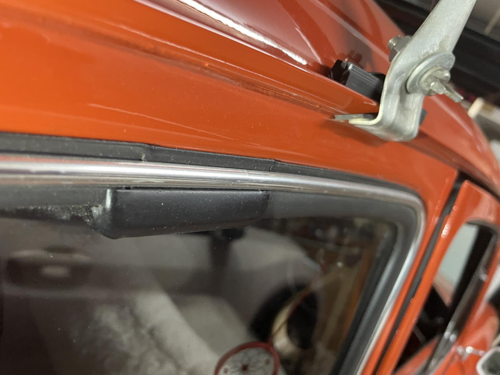

Your 4 black metal pieces all look identical to me. From the photos of mine below, you can see that the window rubber to the front of the clip is a totally different shape to the rubber to the rear of the clip - The rubber to the front is a much "fuller" shape. As a result the black metal covers are actually shaped differently at their rear edge than at their front edge, so as to fit snuggly over the differing rubber shapes. So my clips (which AFAIK are original on my 1970 FB) are very definitely two different shapes. None of yours (to me) look correct because none of them would fit on the differing rubber shapes. That is of course presuming your rubber does change its shape at that point ? If it doesn't, then I would hazard a guess that your rubber is for non pop-out windows ????
Thinking about it, the rubber HAS to be 2 different shapes - The rubber forward of the clips is bigger because the glass actually sits inside it, held firmly in place in a U channel. The rubber to the rear of the clips only seals when the window is pulled shut by the clips. It can't be the bigger section with the U channel or the window wouldn't open.
(Edit - Out of interest I have a small bolt welded into my window frame, facing inwards, top and bottom, and it pushes through the rubber when you fit it. You then have to get a very small and fiddly nut inside the rubber channel and onto the little bolt. It was fiddly and that little nut fell down into crevices below several times !!)
Haven't got a clue what those silver clips are for - Don't think I have them on my windows ! I have seen them somewhere on the car, I think, but can't remember where ! Am sure someone else will know.
Top RH window clip and rubber
Close up of front end of clip over wider rubber
Close up of rear end of clip, over narrower rubber.
Another view of entire clip

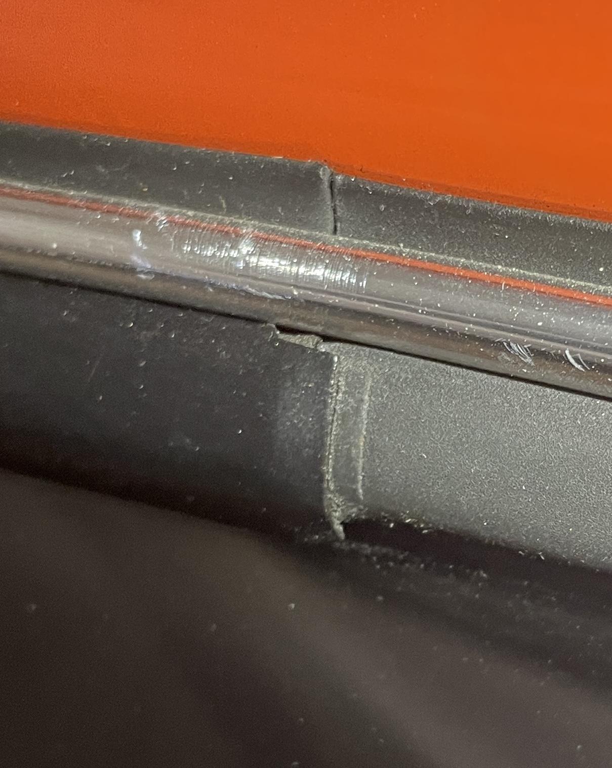

Roping the seal in ... take 1. Not entirely successful.
Problem 1: I positioned the rope wrong at the studs such that the rope was behind the studs when I started pulling. I know better now.
Problem 2: Even though I did get the seal pulled to the inside, one part at the rear, didn't seat far enough. I can probably start by push that part in first next time.
Problem 3: The headliner material gets pulled out by the rope. I'm using 3M Hi-Strength Adhesive and it just can't hold the material. So right now it's a mess I'll have to fix before the next attempt.
Can anybody recommend a better adhesive for this?
Max

PostPosted: Thu Aug 04, 2022 6:59 pm    Post subject: Re: Fastback Pop-out window seals Reply with quote
That worked OK.
The difference:
1) Carefully excavate the channel for the frame ends with a knife. I couldn't even see where that channel was without cutting.
2) Glue the glass into the forward part of the seal. This makes installing the trim easy-peasy.
However, the 3M adhesive is really tough to get off once it sets up. On the second window I'll clean up while it's still wet.
