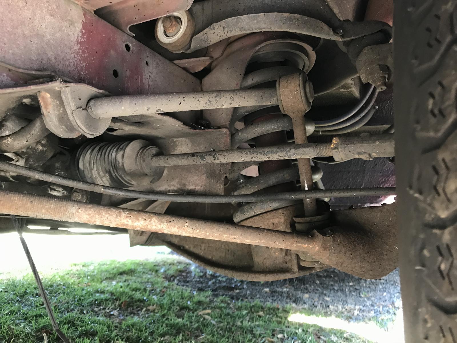

Anyway I thought I would post photos of my front end that helped me decide what to order.
Mine is a late model 1990 GL
#1 my sway bar is 19mm diameter........
#2 Upper control arm bushing, 2 per side
This photo also shows the upper control arm bolt end and nut
#3 Sway Bar below the upper control arm bushing you see the horizontal bar, this is the sway bar. They come in three diameters....... 19mm, 21 mm and 23mm.
You MUST KNOW THE DIAMETER! Christopher said an easy gauge is to take open end wrenches and slip them over the bar.
It needs two central mounts and two round end mounts, all of the same diameter, I didn't have this photo and got confused about the round end bushing...... even when asked I wasn't clear on it, color me stupid.
#4 Below the Sway Bar is the steering rack and tie rods. This is the item with the accordion boots on it.
The steering rack has rubber mounts that go bad and allow small uncontrolled movement of the rack while driving, this can contribute to wandering and being unstable in a cross wind.
I ordered new mounts.
#5 the sway bar has a vertical link at eack end, the stabilizer link.
This link has a round bushing at the top that the end of the sway bar slips into.
On the bottom are two bushings where it mounts to the lower control arm.
#6 the lower control arm has one mount to the brame with a large rubber bushing.
Sadly I failed to take a photo of this bushing, I'll add one after the rain stops.
#7 On the bottom of this photo is the Radius Rod. It fastens to the lower control arm with a solid mechanical connection.
The other end seen in the 2nd photo shows where it fastens to the body with two large rubber bushings.

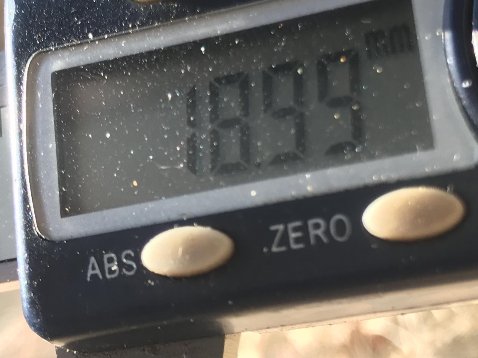

PostPosted: Sun Mar 24, 2024 4:06 pm    Post subject: Re: Upper control arm bushing failure (pictures) Reply with quote
Looking at that long bolt that goes through the UCA & bushings -it is 18mm dia where it is round. The bushing's hole is 18.65 +-. That 1/2 mm play. I expected this to be a tighter fit, but I guess the tire takes up the play for a camber adjustment.
Granted the eccemtric washers set the adjustment I still expected a closer tolerance fit.

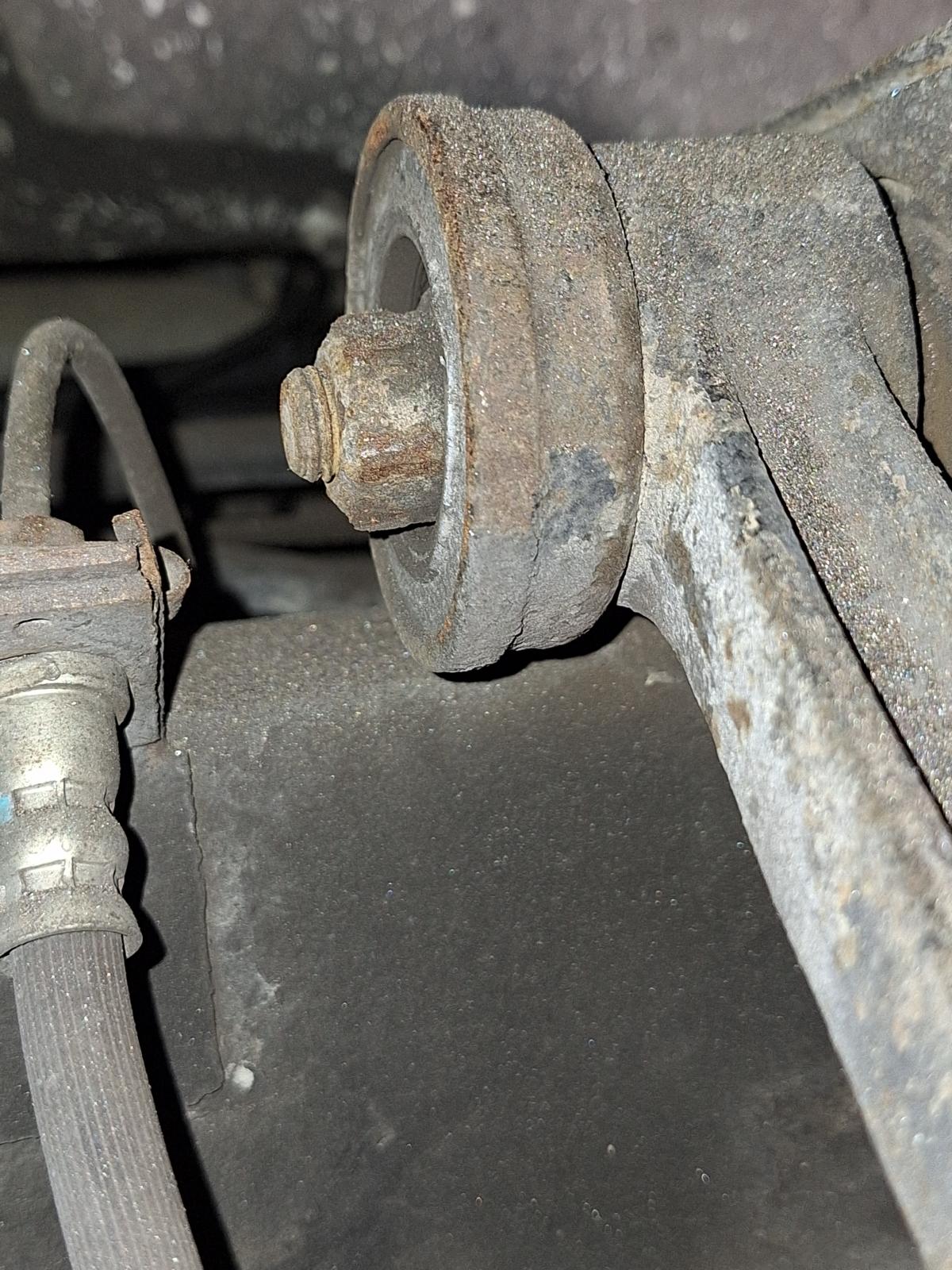

PostPosted: Sun Mar 24, 2024 2:01 pm    Post subject: Re: Upper control arm bushing failure (pictures) Reply with quote
The plastic ring is not fused with the rubber bushing, that's normal.
These things are shit for Syncro, maybe a 2WD with ther zerk fittings will last longer. I'm going back to PU soon. I wish there was a way to grease them. I'm gonna scratch my head to maybe make a custom sleeve to the PU bushings so they can be regreased.

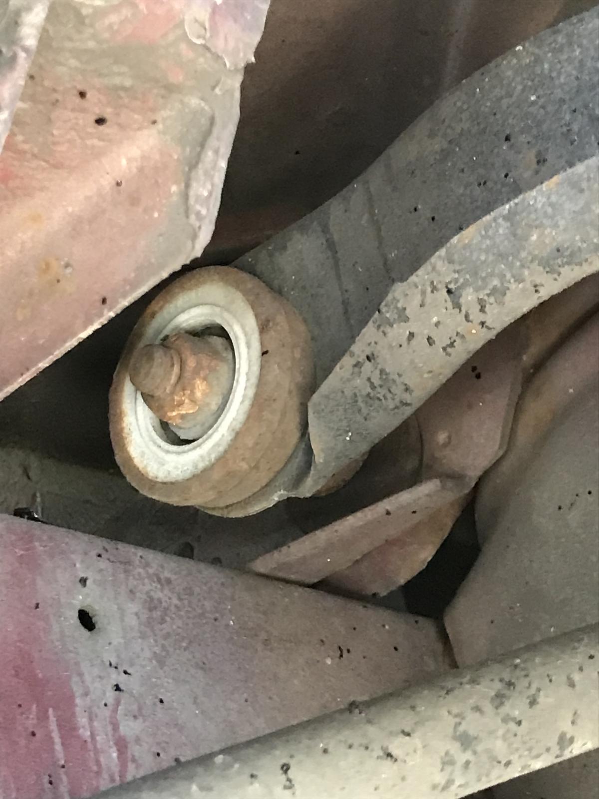

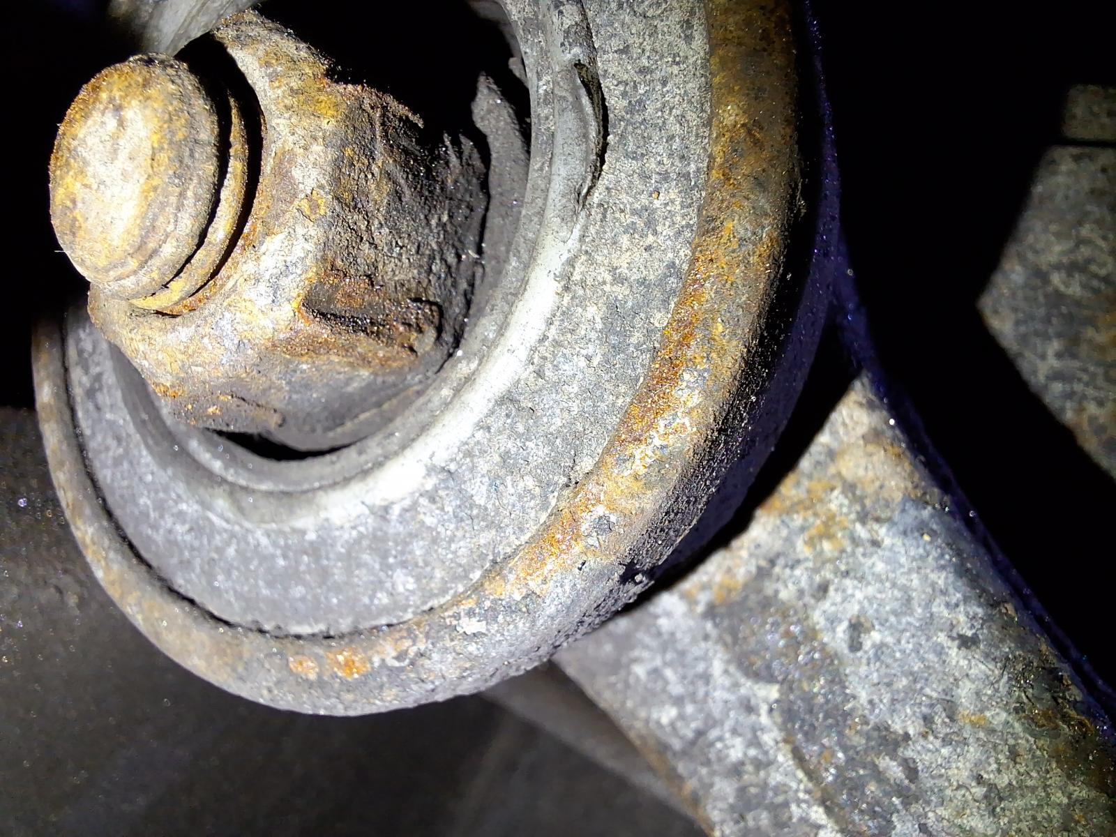

PostPosted: Sun Mar 24, 2024 10:31 am    Post subject: Re: Upper control arm bushing failure (pictures) Reply with quote
So amazingly I too have UCA bushing gone bad.
Obviously to nut is off center and reading in the Bently on page 40.5a it states that it is no longer good because the nut is coming in contact with the "support ring" So I definitely need to change it. It's not like there was a lot of material there to not wear through!
Touching the support ring.
I have a set of Febi bushings and following this thread I took a close look at the seal under the white ring and on all four of them it looks like the seal is not being retained underneath the white ring evenly. I do not know if there is a lip on the bottom side ofthe white ring that is designed to keep it there.
Seeing Alika's post about adding the zerk fittings and seeing how the grease came out by the white ring I would place bets this would happen to mine.

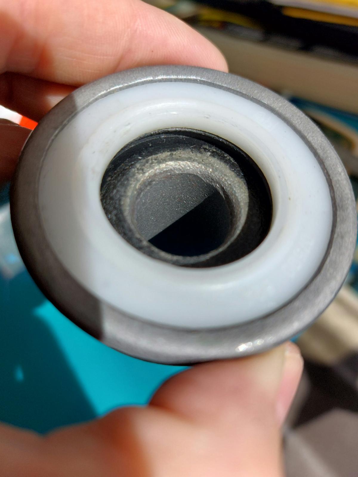

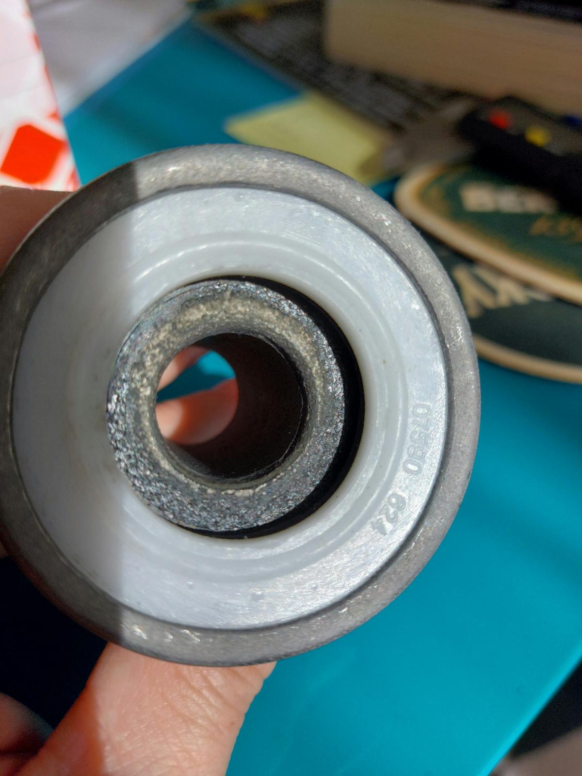

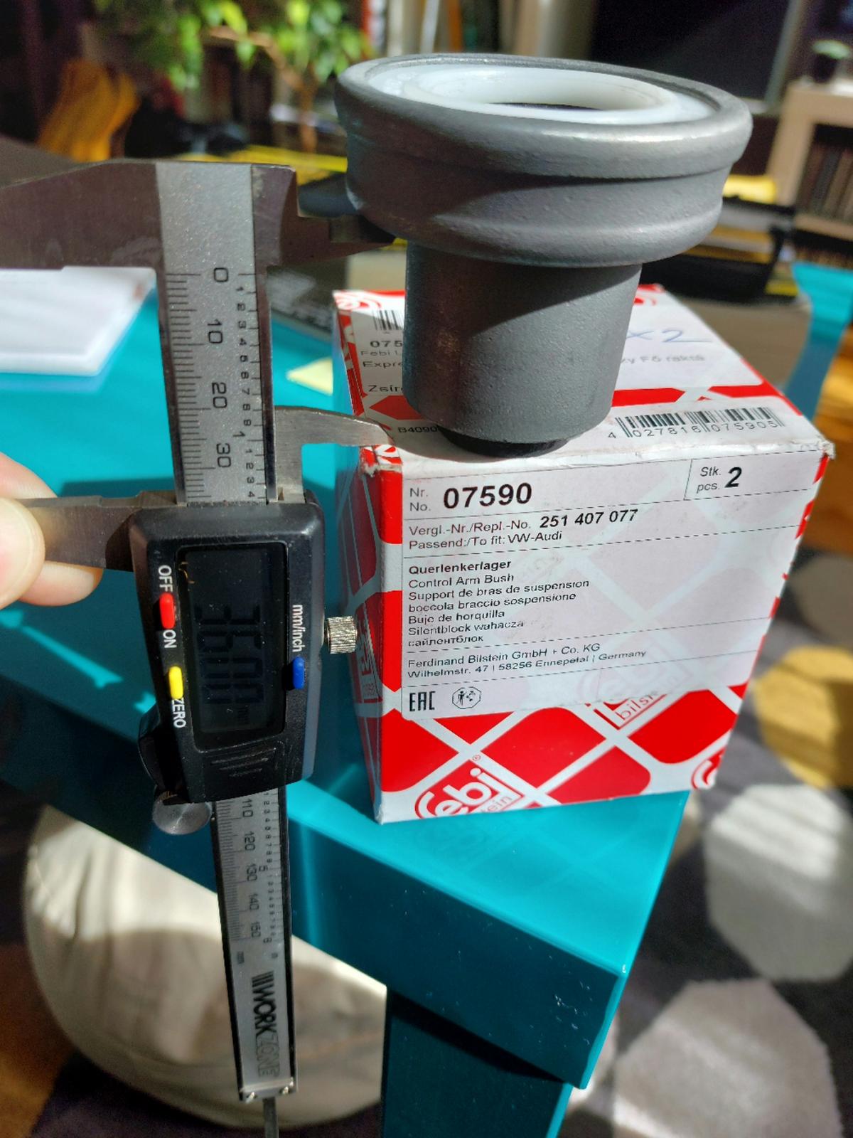

PostPosted: Mon Mar 18, 2024 5:35 am    Post subject: Re: Upper control arm bushing failure (pictures) Reply with quote
Bought FEBI ones today.
It looks like they are not made in Germany any more. Different plastic ring and more rough surface. No info on where they are made.
But I can see why the Lemforders failed on me. These are taller by 1.5 mms
It seems like nowadays you need different thickness shims even on 2WD vans.
