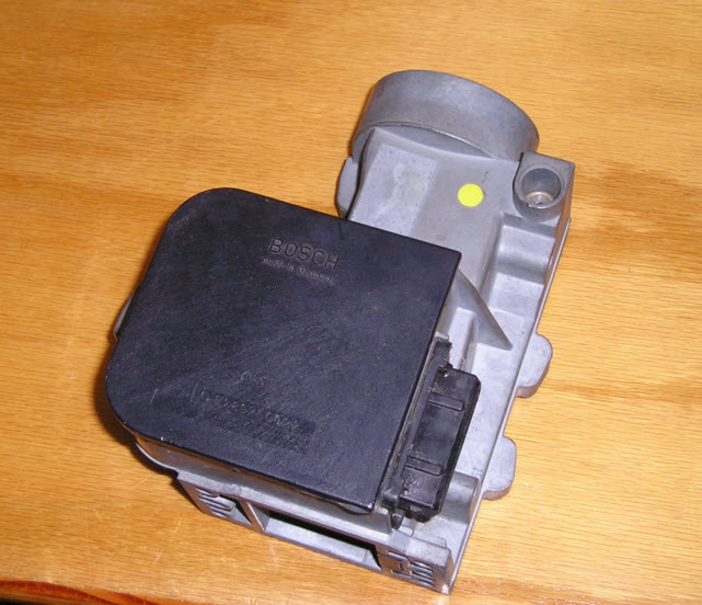

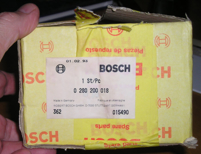

AFM (air flow meter) MAF (mass air flow sensor) T2 ID

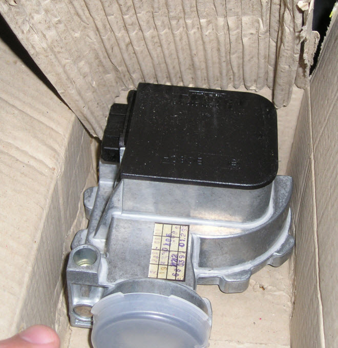

75-E76----- Bosch 0 280 200 012 (6-pin)
E76-76----- Bosch 0 280 200 018 (superseded> 0 280 200 020)
77-78 Calif- Bosch 0 280 200 020
77-79 Fed.- Bosch 0 280 200 020
1979 Calif.- Bosch 0 280 200 022
022 906 301 A , 6-pin , 1975 -E76 > 077 675 , Bosch 0 280 200 012
ED 000 640> ED 025 000 = 215 2 000 001>
GD 000 001> GD 010 999 = >216 2 077 675
022 906 301 B , 077 676> E76 -End of 76 , Bosch 0 280 200 018 > 0 280 200 020
GD 011 000> GD 027 786 = 216 2 077 676 > 216 2 300 000
022 906 301 D , 1977 -79 Fed. / 1977-1978 Calif. , Bosch 0280 200 020
GD 027 787> GD 055 800 = 217 2 000 001 >
GE 000 001> Fed. = 217 2 000 001 > 219 2 153 964
GE 000 001> GE 039 331 Calif. = 217 2 000 001 > 218 2 300 000
039 906 301 , 1979 Calif. , Bosch 0 280 200 022
GE 039 332> Calif. = 219 2 000 001 > 219 2 153 964
There is a discrepancy between what Karl and Ratwell listed for 77 and the Microfiche.
Which really does not matter because the 76-0 280 200 018 was superseded to the 0 280 200 020. So basically you can use either one from E76-79 Fed. and E76-1978 Calif.
Sources
Bus VIN / Chassis Numbers
https://www.thesamba.com/vw/gallery/pix/1688049.jpg / Fiche pic
http://www.ratwell.com/technical/FISwap.html / ratwell
https://www.thesamba.com/vw/forum/viewtopic.php?p=2908832#2908832 / Karl rip

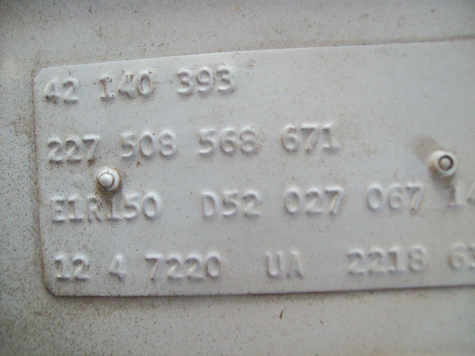

Hey VeeDubb steppin
Could you please post a picture of the M-Plate located behind the left (drivers side us) seat?
M-Plate Location
Thank you

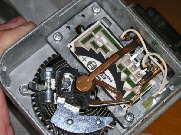

TCash said No, he is incorrect on this one.
First hand I can tell you that moving the board can and does trash some units. It trashed one of mine.
There are multiple voltage and current outputs between that board and the wiper (acts as a variable ground spot. If the board is moved it changes the voltages and current at each take out that goes to a different pin on the ECU. The ECU is analyzing differences between those pins then adding fuel as needed. Change the spot the wiper rides and one changes the amount of fuel that is added. Sometimes it doesn't affect much, other times like mine it trashes the unit. That is why I said perhaps permanently.
I missed that you removed the board. So yes that could change the setting.
Good eye
Good eye

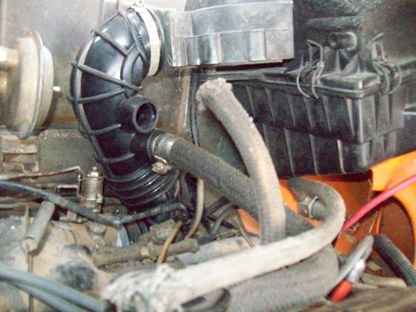

The S hose. Is one longer then the other? If so the short one could be from a Vanagon. That's all I got Very Happy
