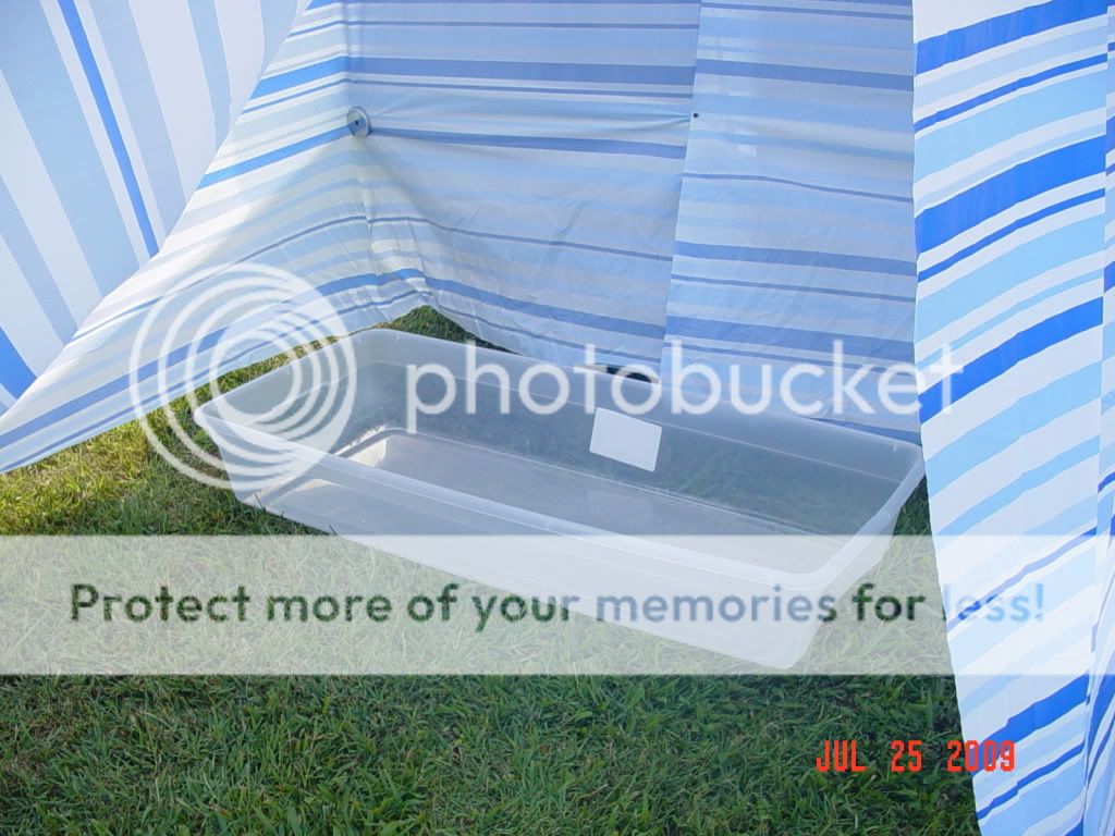

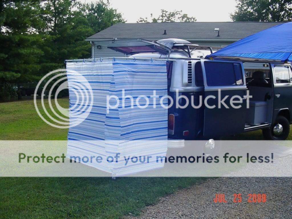

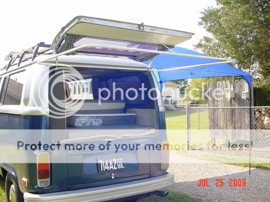

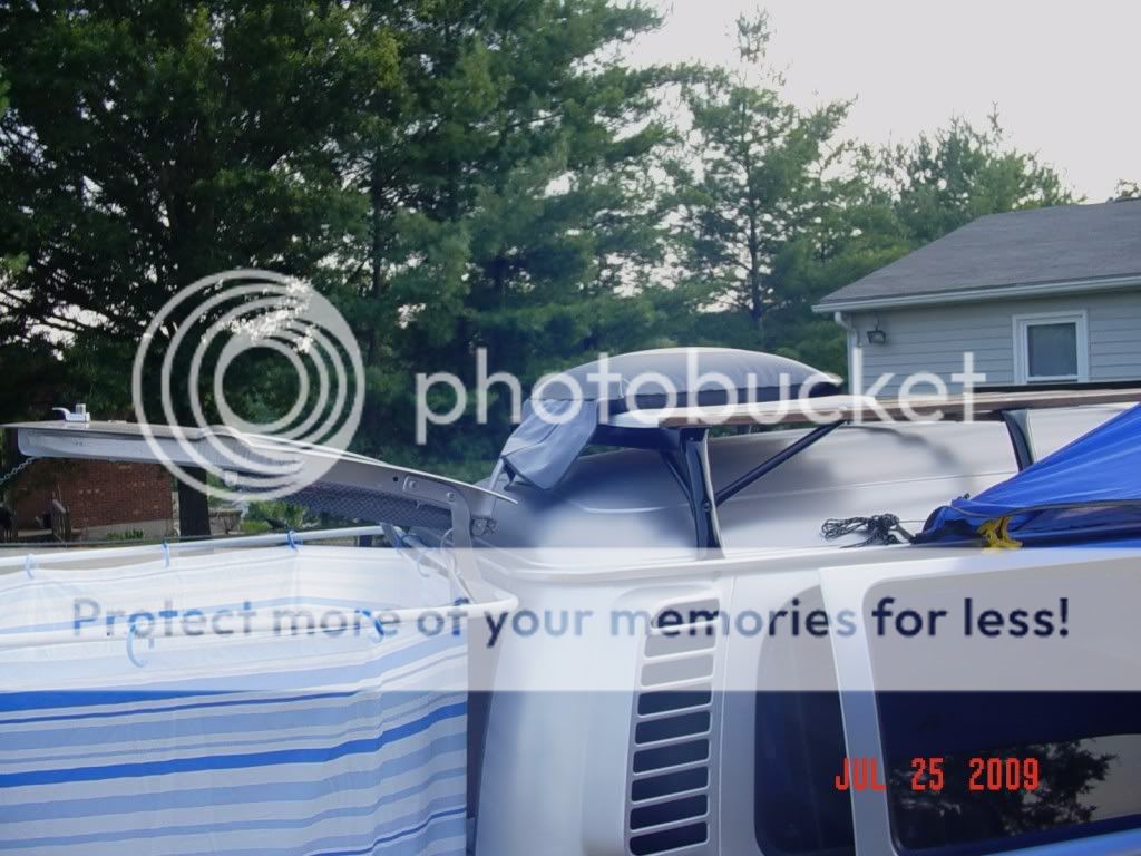

The tubing is 1/2" metal pipe in four sections that form a rectangle 5'wide x 4'deep when assembled. It used to be the framework for a canvas sun shade above a lawn glider chair kind-o-thingy. The four pcs. are too long to fit in my "shower box" when stowed, but fit nicely up against the back of the seat backrest.
I've seen people just clamp shower curtains to the rear gate when it's raised, but this seemed to small, especially if you want to use the space as a changing room. The pics are shown with a very thin, cheap vinyl shower curtain from the dollar store. I'm gonna upgrade to something more substantial to keep every little breeze from blowing it around. Right now, I use a few magnets across the back bumper and a stake into the ground at each rear corner to keep the curtain in place.
And yes, those solar shower bags DO work. I just replaced the short, kinked-up hose it came with between the bag & head with a softer longer hose.

Klauss, that is brilliant. and here i was all full of myself for trying to set up something like that in our cabin, and you've already done it in a bus!
is your shower curtain "rail" made of 1/2" PVC or what?
where we usually camp is so far from people that privacy ain't an issue, but that also looks nice to give you some shelter from the breezes whilst nekkid n wet.
good example of what a great resource this site is...i read this thread for the yuks and end up getting a great idea from one of the co-afflictees.....

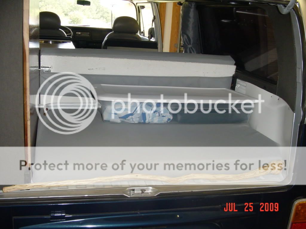

skidoo,
Here's my homemade rear shower (I mean, shower that attatches to the rear of the bus . . . Rolling Eyes )
Stored, ready to travel
The frame
The shower base to keep from making mud
Setup and ready to use in about 2-minutes
Sorry, no pics of me using it Cool
-Klauss
