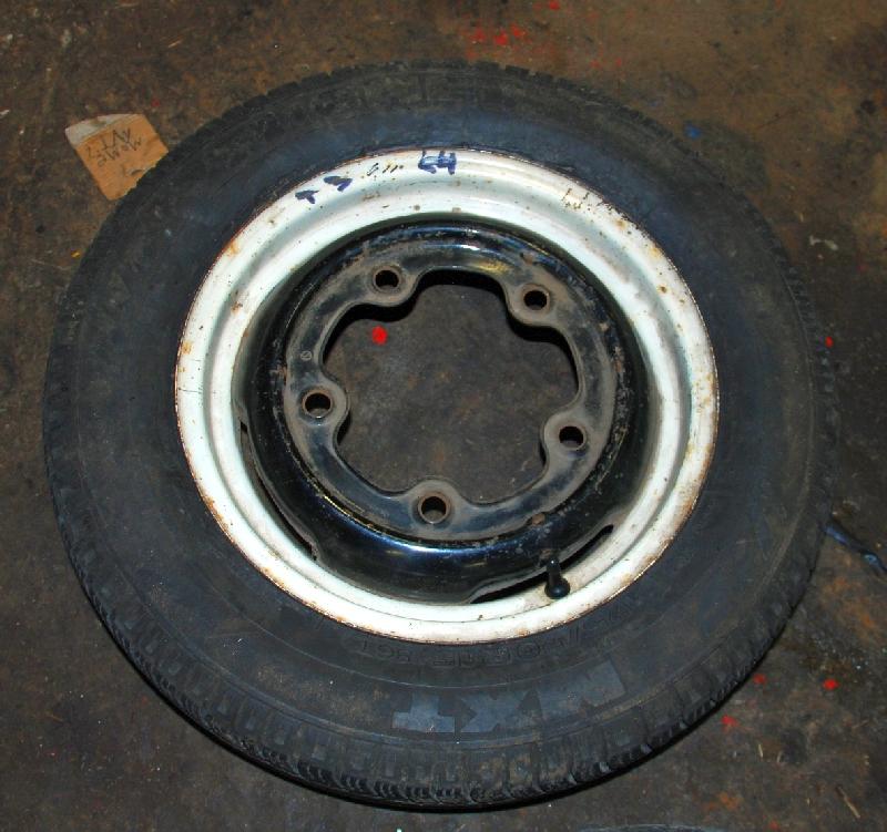

Never saw this question answered in here. I know it's an old thread, but this would be good info to share.
I have an early Type 3 slotted wheel in good condition. But I cannot find a date code anywhere.
It should be stamped on the rim lug pattern flat, like the VW symbol in the black and white rim above. It'll give you the month and year, along with an ET number and rim width. I hope this helps.
I cannot see anything in that area. I have been looking at wheel dates on bus and beetle wheels for years, so I am familiar with what they "should" look like. But this wheel looks to have nothing at all.

cdennisg wrote:
Thomas Pedigo wrote:
Where is the date stamp on an early slotted type3 wide5 rim? I have searched the same spots as a splitty, to no avail...

Mike Fisher wrote:
Wheel disc & rim colors listed here under Paint/Upholstery and more in the Technical tab.
https://www.thesamba.com/vw/archives/info/paintcodest3.php
Danke Smile
I saw that page last night but didn't decipher it properly. I've got it now Smile

PostPosted: Tue May 09, 2017 6:53 am    Post subject: Re: Early slotted wheels Reply with quote

notchboy wrote:
Early T3 rim flavors
What colors are these? What colors were available on slotted wheels? Thanks Smile
