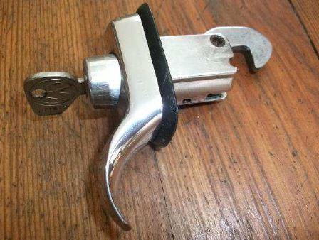

Marv [UK] wrote:
rekeying a lock is relatively simple but as good bus door locks are getting harder and more expensive to find I hit upon a simple and cheap solution for those that don't have enough 'waferes' to key the lock correctly
Beetle handles are easy to find and are chock full of wafers. A little bit of work with a file and they fit. They are slightly longer and wider than bus lock wafers but they do work. Fit them so that one side of the wafer is flush with the barrel then file the other side down. One side is usually quite thin though. FIle this down too much and it will break and snag your lock. Try to always file down the 'fat' side of the wafer.
I've been searching for info on cross-type wafer (and/or lock cylinder) interchange compatibility, and came across your post Marv...
Any chance you could tell us what year your Bus handles and the donor Beetle handles were from?
(I'm curious if yours needed filing because of Beetle vs Bus, or if it was because they were from different "generations" of the lock assemblies?)

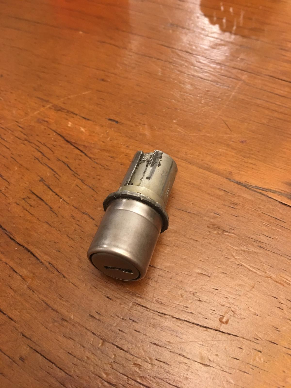

Help with rear hatch lock--
I've got a 78 bus, has the black plastic hatch lock. I was able to get the cylinder out (while damaging the spring collar Rolling Eyes ), but I can't figure out how to get the tumbler out? Any advice or tricks? I don't see any screws or pins or anything.
Does anyone know if the chrome plated (I believe early 70's model) rear hatch lock is easier to disassemble and/or if it would be compatible with my latch?
