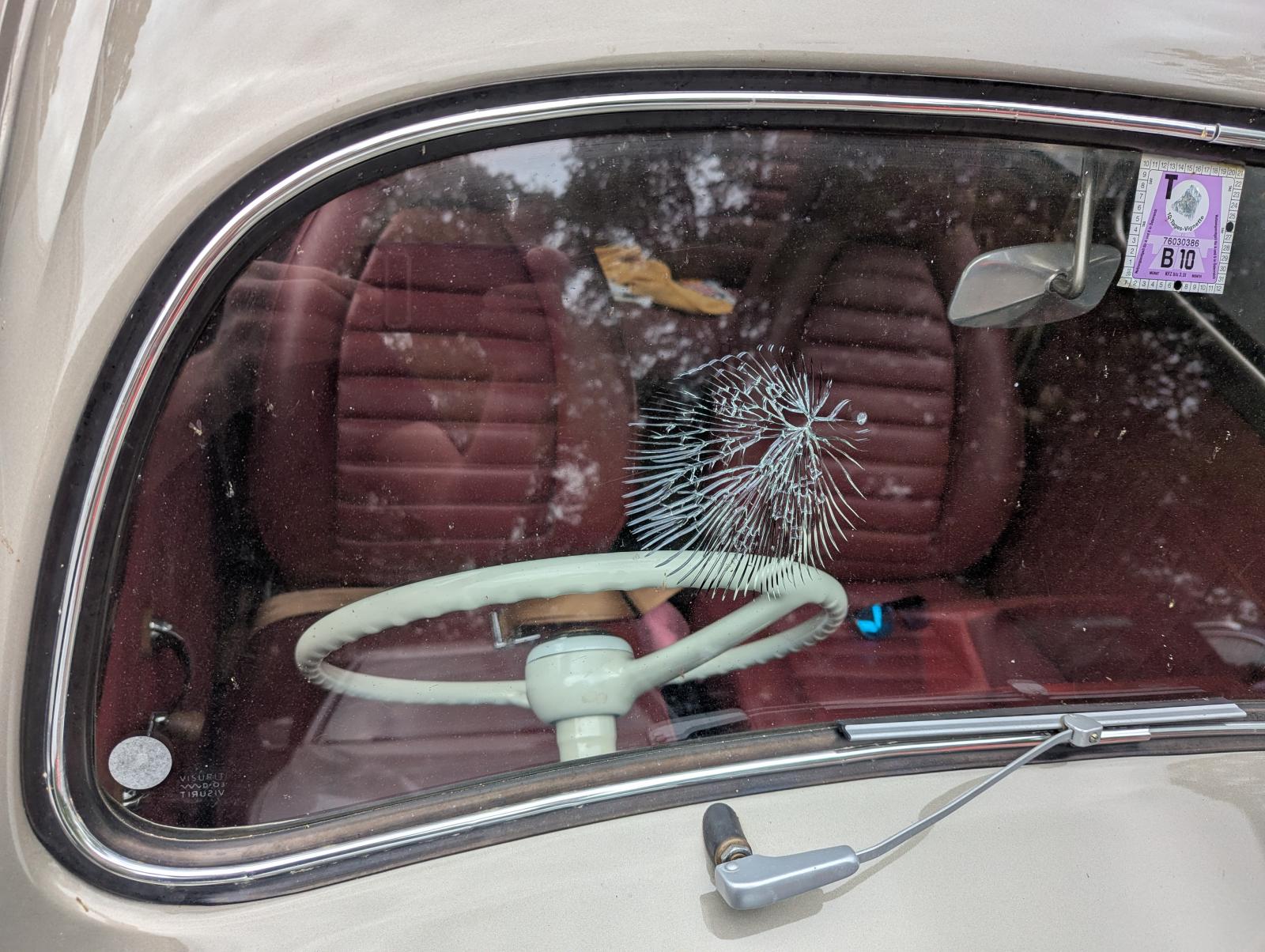

This happened to my screen yesterday .
56 Oval RHD .I've been able to see the bluey ring in front of me with sunglasses on ..always wondered what it was ...now I know !

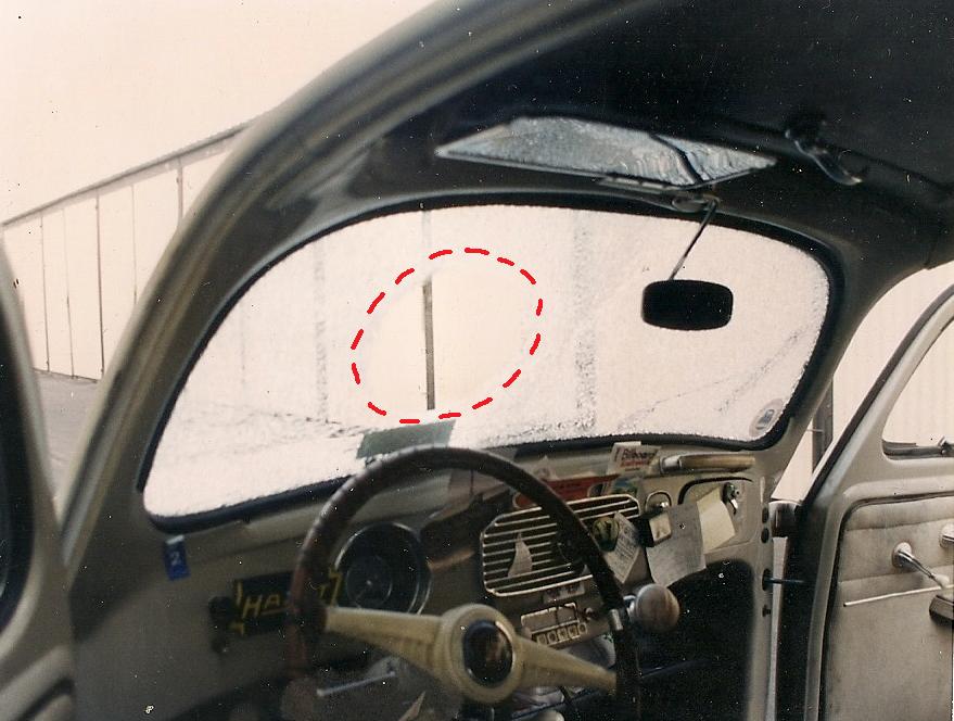

Prior to 13 October 1954 on Euro spec cars the windshields were tempered uniformly overall causing complete loss of vision if a rock were to shatter the glass, due to the nature of tempered glass any rock which was big enough to crack the glass would cause the entire windshield to shatter into small pieces, a lot of the energy of the rock would be absorbed by the forceful shattering of the glass allowing the glass to remain in place but blocking any vision thru it
There is an idea of a Billmetric; some kind of abstraction. But there is no real me: only an entity, something illusory. And though I can hide my cold gaze, and you can shake my hand and feel flesh gripping yours and maybe you can even sense our lifestyles are probably comparable... I simply am not there...
Bruce
Joined: May 16, 2003
Posts: 17586
Location: Left coast, Canada
Bruce is offline
PostPosted: Tue Feb 17, 2009 10:23 pm    Post subject: Re: Tempered Windshield Reply with quote
billmetric wrote:
...., after 13 October 1954 VW installed what they called windshields with a "vision area" in front of the drivers face which was tempered to remain in one piece while the rest of the windshield shattered into about one million pieces, ...[/img]
What was the windshield before then? Tempered? Plain glass?
