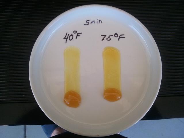

I purchased the Penrite Steering box lube and performed a very unscientific test on it.
Drop point: 170*C
Operating temperature range: -20C to 130C
Colour: Light Brown
One blob put in the refrigerator and brought down to 40*F
Second blob applied on 40*F plate at 75*F ambient Temp.
5 minute race is on.
Drop point: 170*C
Colour: Light Brown
5 minute race results. I wish I took more pictures. #75* took the lead laying down a thick film, just when I thought all was lost, #40* started picking up the pace laying down a thin film all the way to the end and beating #75* by a nose.
