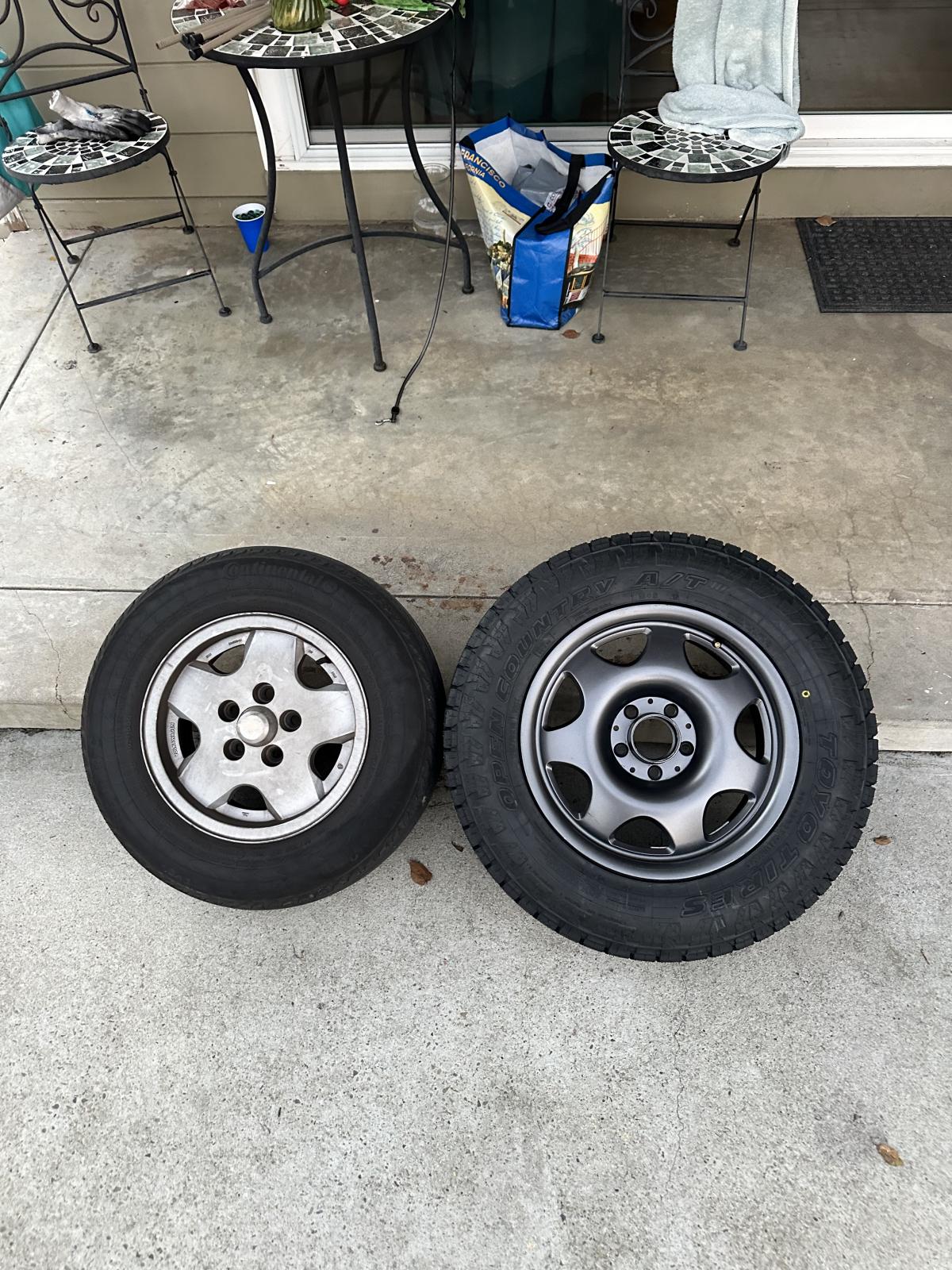

What beautiful CLK wheels! Are they painted or poweder-coated?

Welcome! Nice rig, my favorite configuration & definitely an aggressive look. Cool
Gotta ask though, what engine you running? 15% taller tires means 15% less
horsepower to the pavement, so stock 2.1 wasserboxer (90hp) now gives you
only 76hp to work with. Highway hill climbing in anything taller than 2nd gear
may be a real challenge. Maybe you plan to stay in town, just cruise the ‘hood?

New to the Forum, just bought my 91 2WD weekender 4spd. Thought I’d post my recent upgrade to it.
Tires : TOYO open country A/T lll - 215/75 R16 100T
With CLK wheels no spacers . Needs a lift for a more aggressive look . Hope this can help someone. Ride quality 80x better !! Engine rpms dropped by ~ 500
14” wheels @ 70mph : 3500 rpm
16” wheels @70mph : 3000 rpm
Speedometer is off by mph 70mph now = 75mph

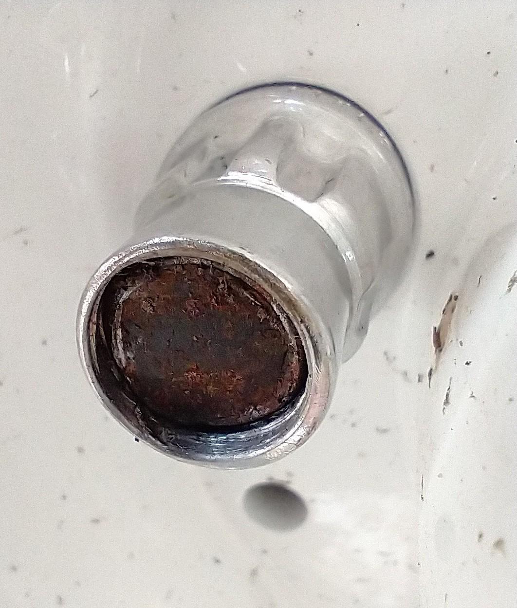

The locks didn't bottom out against the capped ends, they bound up a few mm below that where the threads ran out. I'm not going to use wheel studs as taps, especially as one of those rear hubs is on at least its third set of pressed-in studs, seeing as it had replacement studs in place when I acquired it. The tap removed significant swarf on its way through the nuts, so I'm confident that was the right solution.
Regarding the lug key, I got two sets of locks with the same key so that I could lock my rear- mounted spare, so I have a backup in case my onboard one gets misplaced.
Not torquing locks so that you can remove them without the key defeats the very purpose of having locks, in addition to putting undue stress on these wheels which we're already asking to support a heavier vehicle than their original application. I'm happy with the approach I took and can't condone these alternatives. If anyone in the Hartford area wants to use my tap for the same mod, feel free to message me.

I got a set of the T3 Technique 12mm ball seat locks for my wheels. They worked fine up front on my Syncro, where the OE studs are still in place. In the rear, however, I installed 50mm studs (15mm longer than stock, IIRC) which are a bit too long for the closed-ended locks.
I threaded the locks onto a 2WD front lug bolt clamped into a bench vise and drilled out the capped ends. The threaded area ended just shy of the newly-opened ends, so they wouldn't thread on fully. I solved this with an M14-1.5 tap, so all is well now.
Little late now, but I also had studs a bit too long and just cut them off. Used a mini grinder with cutoff disc and made sure to chamfer and deburr the end.
