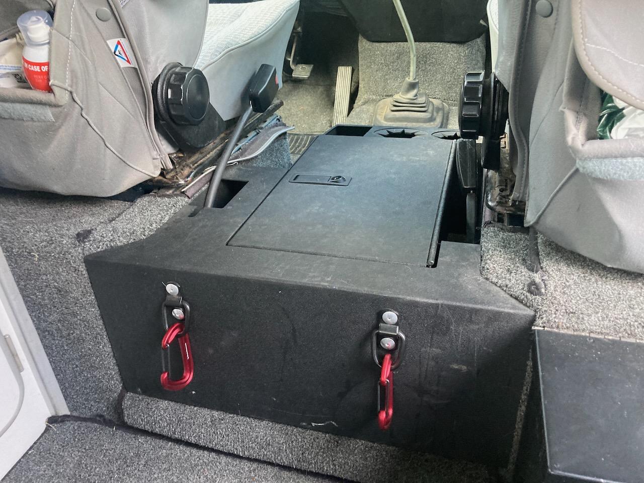

I mentioned the VanagonLife console, and that is a an extremely well thought out mod. Not cheap, but definitely not overpriced - it’s built like a tank, super easy to install (just unscrew the seat belts bolts and use them to screw the console in place) and provides an insane amount of secure storage.
Link: https://www.vanagonlife.com/vanagonshop?category=Vanagon+Center+Console
I did the same mode to the console as to the lockbox by installing more tie-down hooks and some carabiners.

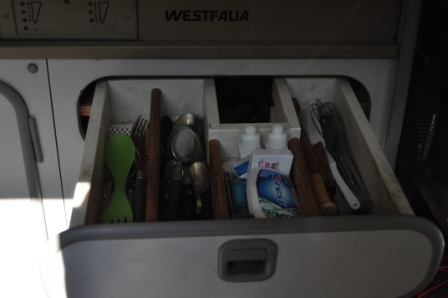

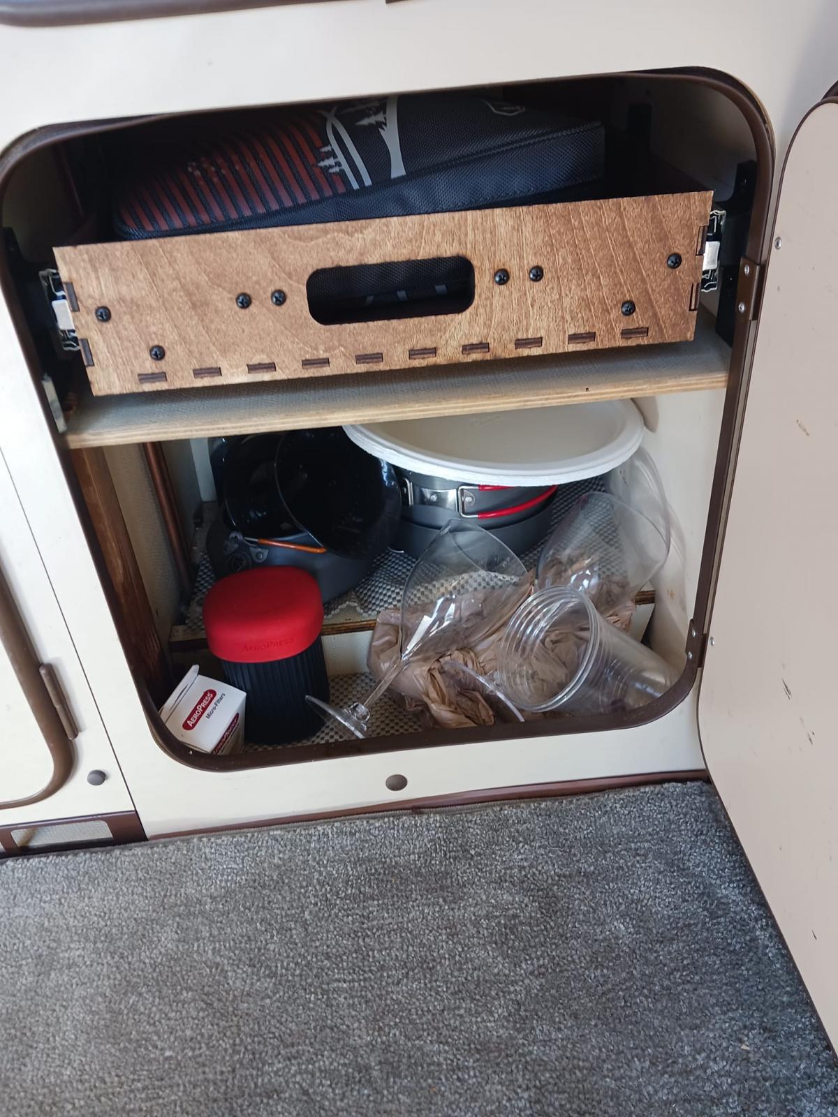

The drawers from customish.net are great. I put one under the sink and one in the fridge area after I got rid of the fridge. [img]
The Bravo was a great way to store tools.
The Ketzel bag behind the seat gives a ton of more storage.
