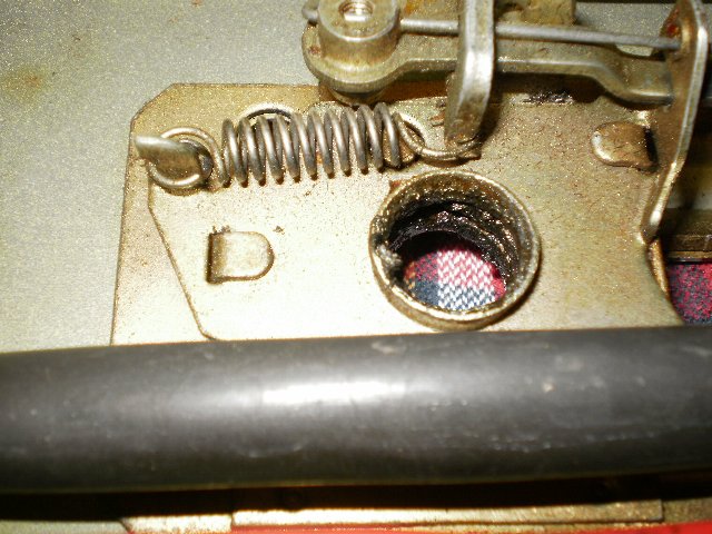

Semper_Dad
Joined: May 14, 2005
Posts: 3535
Location: Indiana
Semper_Dad is offline
PostPosted: Fri Feb 18, 2011 5:38 pm    Post subject: Reply with quote
Here's what your hood latch looks like underneath.
Do you have this return spring?
You may want to release the cable/sheath from it's most forward retaining tab on the right side of the trunk (passenger's side). This should effectively lengthen the cable enough for your latch to close fully.
Walküre Restoration Thread: https://www.thesamba.com/vw/forum/viewtopic.php?t=737492
eaker02
Joined: December 08, 2010
Posts: 71
Location: Rome,GA
eaker02 is offline
PostPosted: Fri Feb 18, 2011 5:00 pm    Post subject: Reply with quote
thanks, but never put a bolt through the clamp until I saw your picture, then I tried putting the bolt through thinking a previous owner didn't finish something
no bolt through clamp. can shut hood fully and it stays shut. when I start driving hood comes unlatched.
I can shut again and the hood stays shut until I start driving again, then it comes loose again.
I will say that the clamp is outside the slot where you run the lock though in order to open the hood.
almost sounds like i need to pull the cable a little more at the latch in order for the clamp at the release handle to line up with the holes in the glove box?
thanks

Ferretkona
Joined: December 03, 2005
Posts: 1306
Location: Columbia, CA
Ferretkona is offline
PostPosted: Fri Feb 18, 2011 4:56 pm    Post subject: Reply with quote
That lock tab can twist and keep the latch open. Make sure it guides in where the holes line up.
I had to go thru and fix the sheetmetal tabs that hold the cable housing in place in the trunk. They weaken in time and if the housing is loose it can be a bear to open.

Semper_Dad
Posts: 3535
Location: Indiana
PostPosted: Fri Feb 18, 2011 4:51 pm    Post subject: Reply with quote
eaker02 wrote:
yes, the hood shuts fully and can't pry it open, but as soon as I go down the road the hood will release. The safety latch is the only thing that keeps the hood shut.
didn't even think about a lock going through the holes.
ron
So it's my understanding that your hood remains fully latched with the bolt in? Even when driving?
Sounds to me that the return spring is not pulling the cable back into the latched position.
I recommend that you remove the cable and sleeve and see if you can fix or replace the return spring. Otherwise, replace the whole cable/sleeve/spring. In the meantime, try thowing a bolt or pin in the hole as a extra safety measure while driving.

eaker02
Posts: 71
Location: Rome,GA
eaker02 is offline
PostPosted: Fri Feb 18, 2011 4:40 pm    Post subject: Reply with quote
ps. will post pics at some point. right now the Thing is three colors.. Original is white(under hood and trunk). someone then painted the whole inside Red, then another owner must have wanted a Acapulco Thing and painted the outside blue with white stripes.
ron
