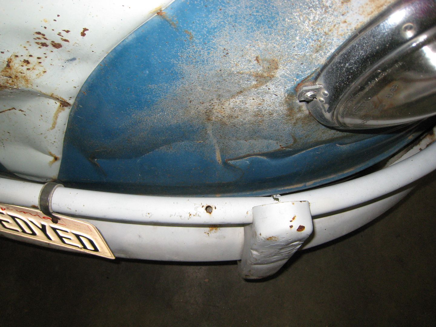

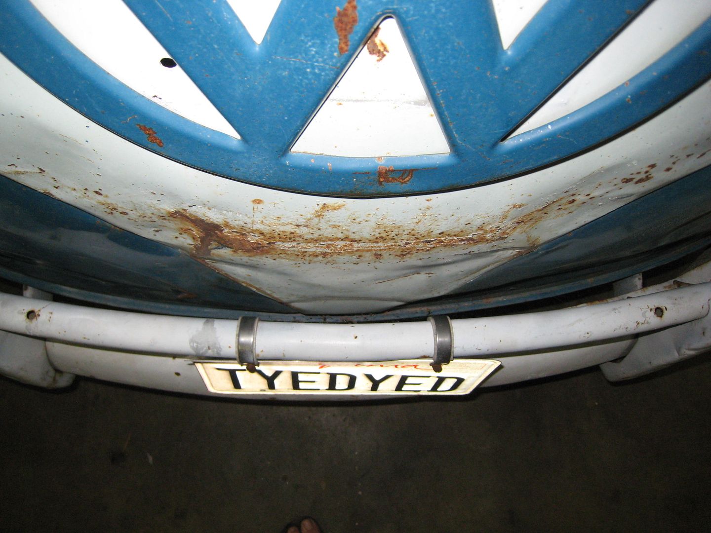

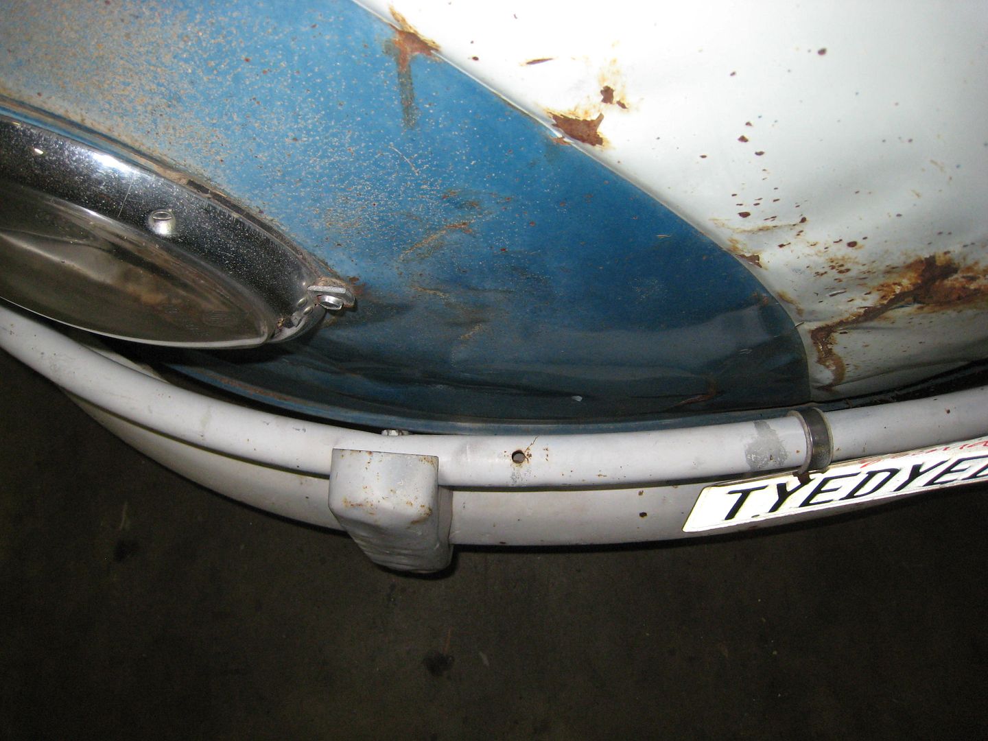

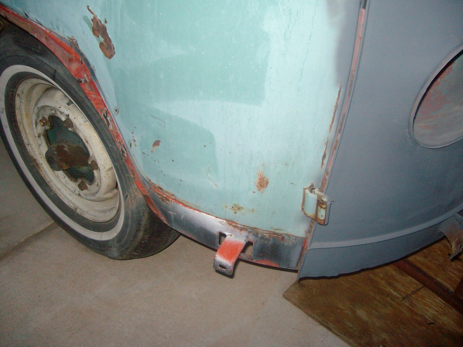

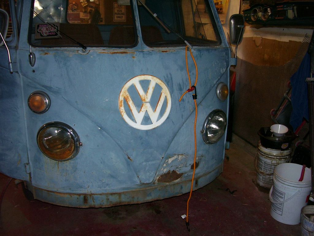

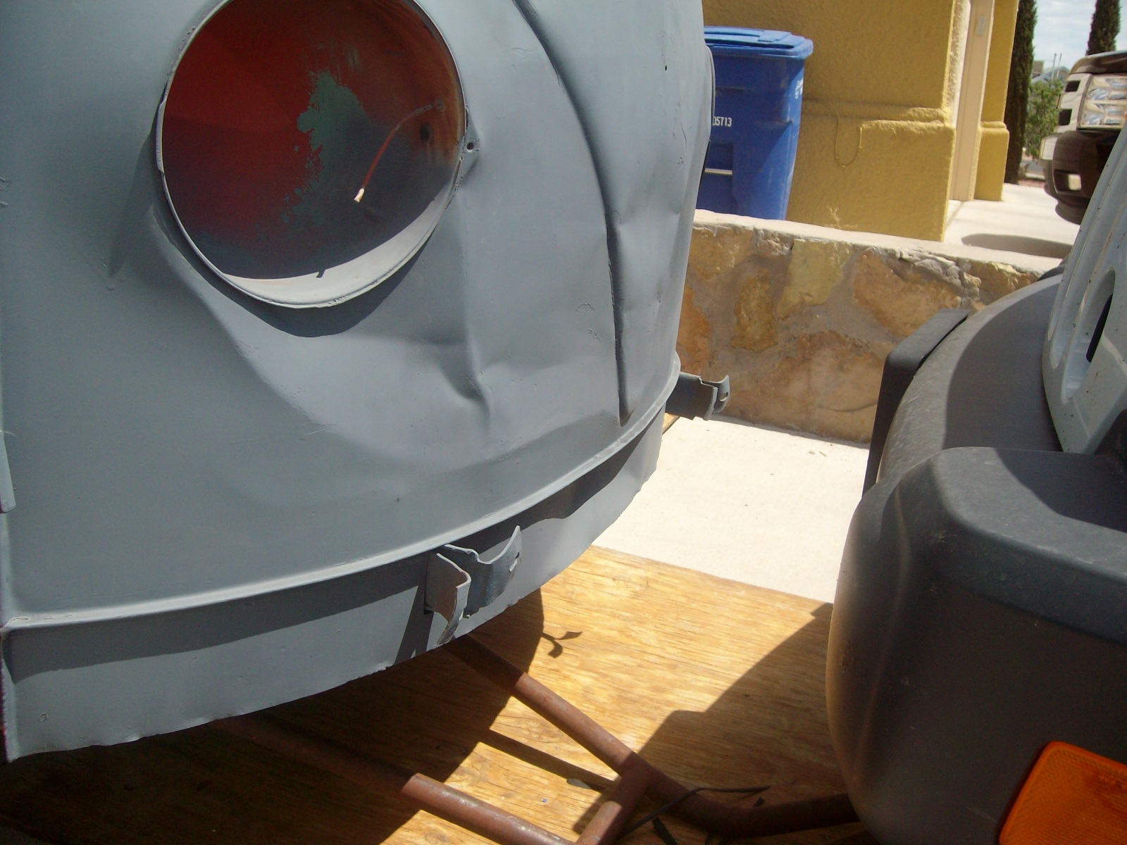

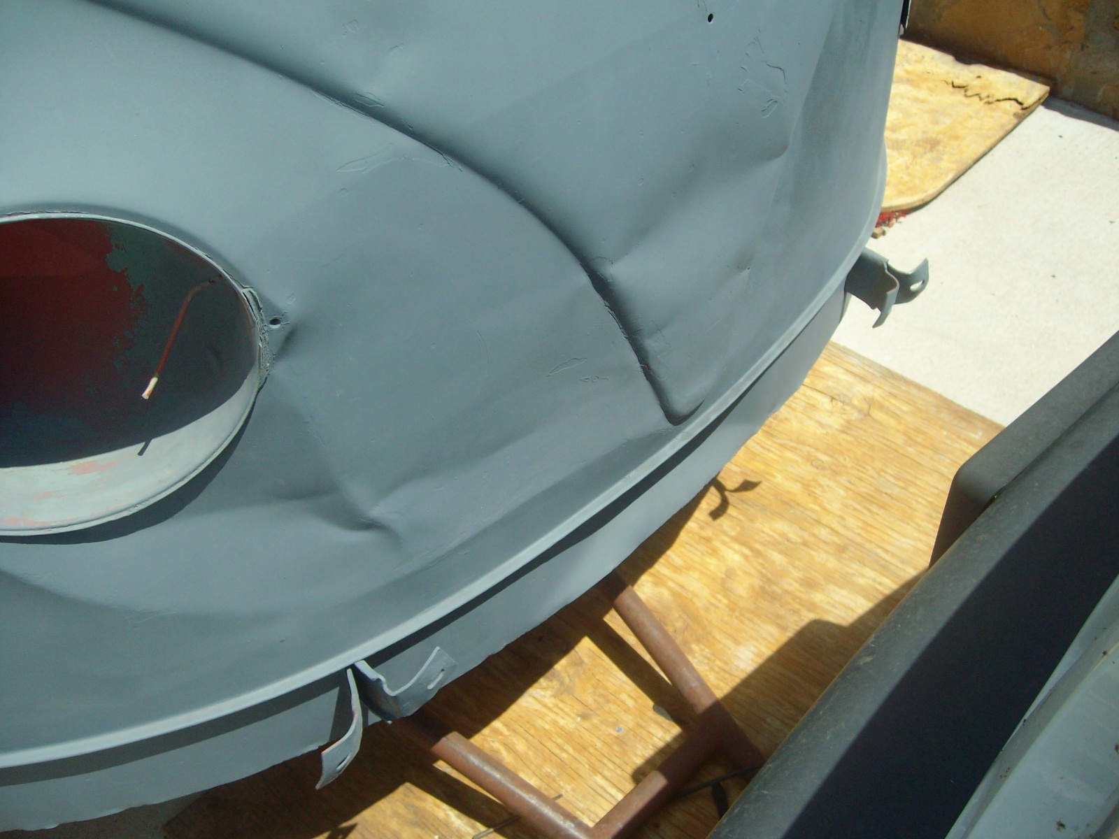

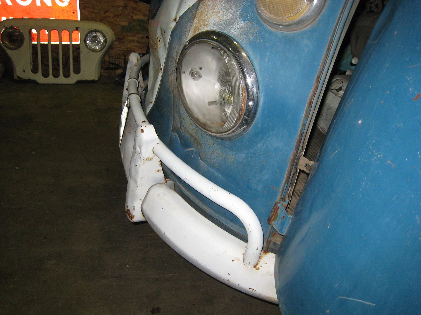

Ok, Did the football trick today!! I am so stoked. The nose isn't perfect by no means, but it is way, way, way beter then before!! Thanks so much for the tip on the football!!
Before,
After,
I learned a few things in the process!
1, don't use an old sun dried football!

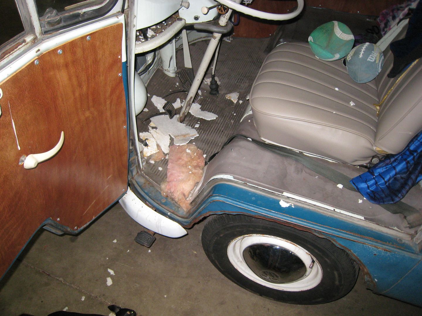

I also learned to put a board between the seat floor board area and the metal that the football falls between. I kind of bent that out a bit at first. Once I had a board holding it in place, I was able to get more of the dents out!!
I had a hard time getting the football down far enough in some areas. In some areas as I got one dent out with the ball, the other already fixed dent, would pop back in. We decided to start collecting footballs and when we get enough of them, we will take the bumper off and blow up several balls at the same time, then work the outside metal.
Again, thanks so much for this tip. I have been hating my buss's nose for a long time. Finally started to look for a stud gun so I could try to fix it by myself. Even though Hubby did end up helping me, the football did the trick to get the nose to where I can live with it now! Looks like a bus now instead of a bulldog! LOL

In the morning you can tell your little girl that the big dumb guy on the internet thought that she was a boy because he didn't look closely enough.
Maybe we need to add the Football Trick to the FAQ/stickys. This comes up every few years.
A stud puller should help on that nose but the metal looks pretty stretched.
The paint on that bus is NUTS!

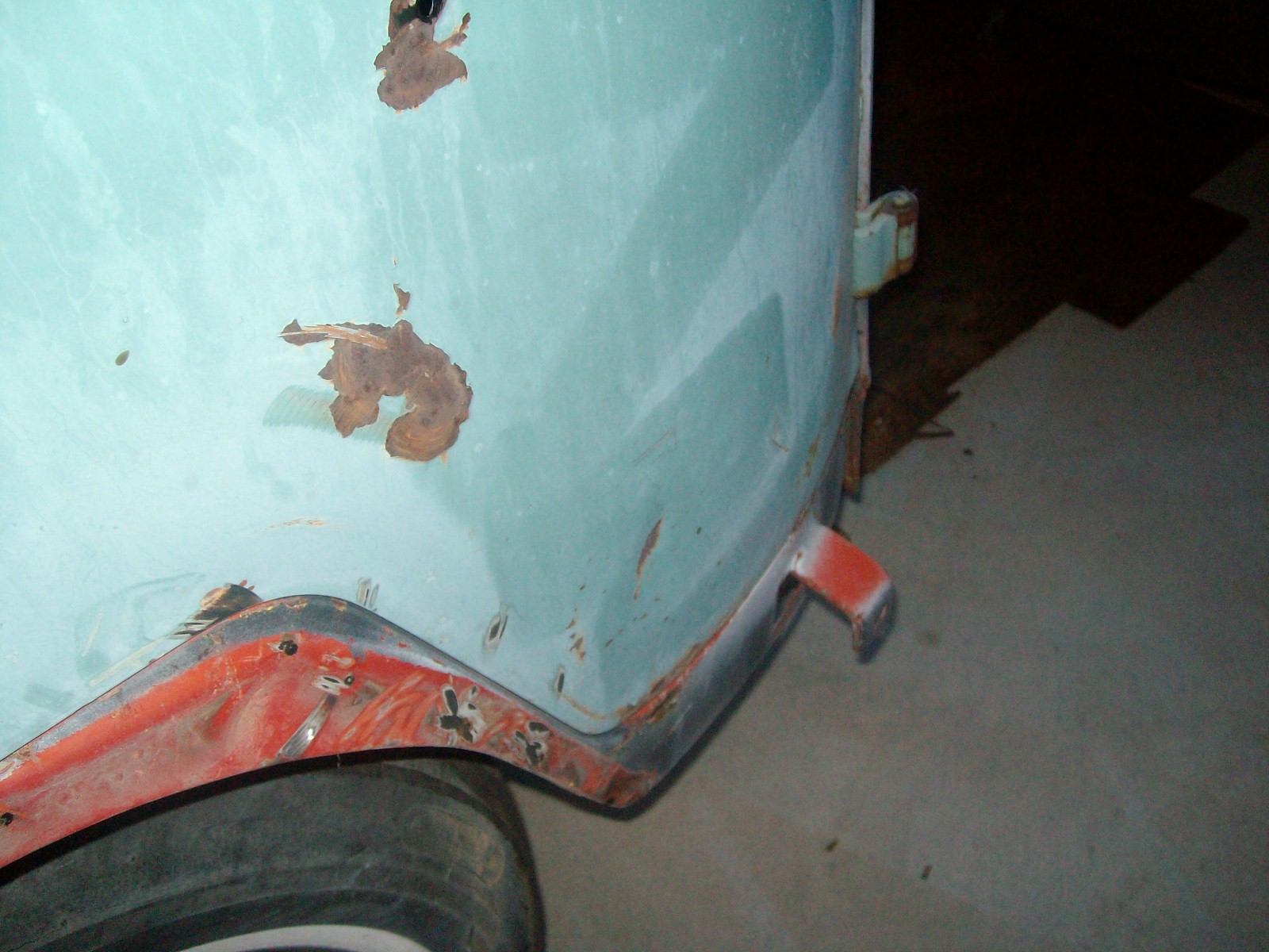

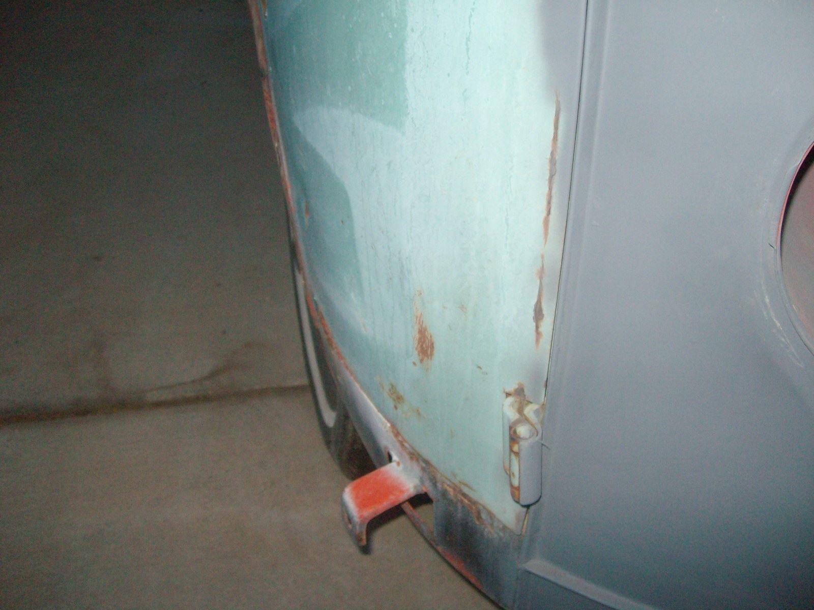

Here is a pic of the door i did with the football.
Before, you can barely see the dent, you can see the rust spots where the corner of the crease was.
After

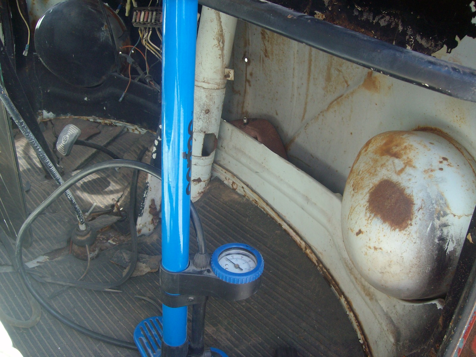

Before, ONly Pic I have that shows damage, LOL
Shoved football in this area, but lower
Used pump to slowly inflate ball
Made a huge pop sound
Not perfect, but much better

THis is a very cool trick for sure. One bit of advice I found out was being able to get air in the needle with the football shoved way down in the nose.
I ended up clamping a small rubber hose about 18" in length to the end of the needle, and then could shove the football down in there and then pump it full easily with the hose from the air compressor...plus, air was released quickly too, made for extraction of football easy too!

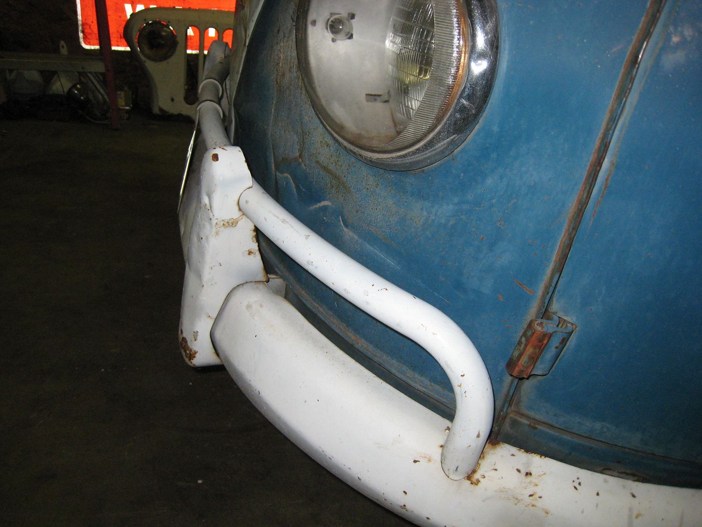

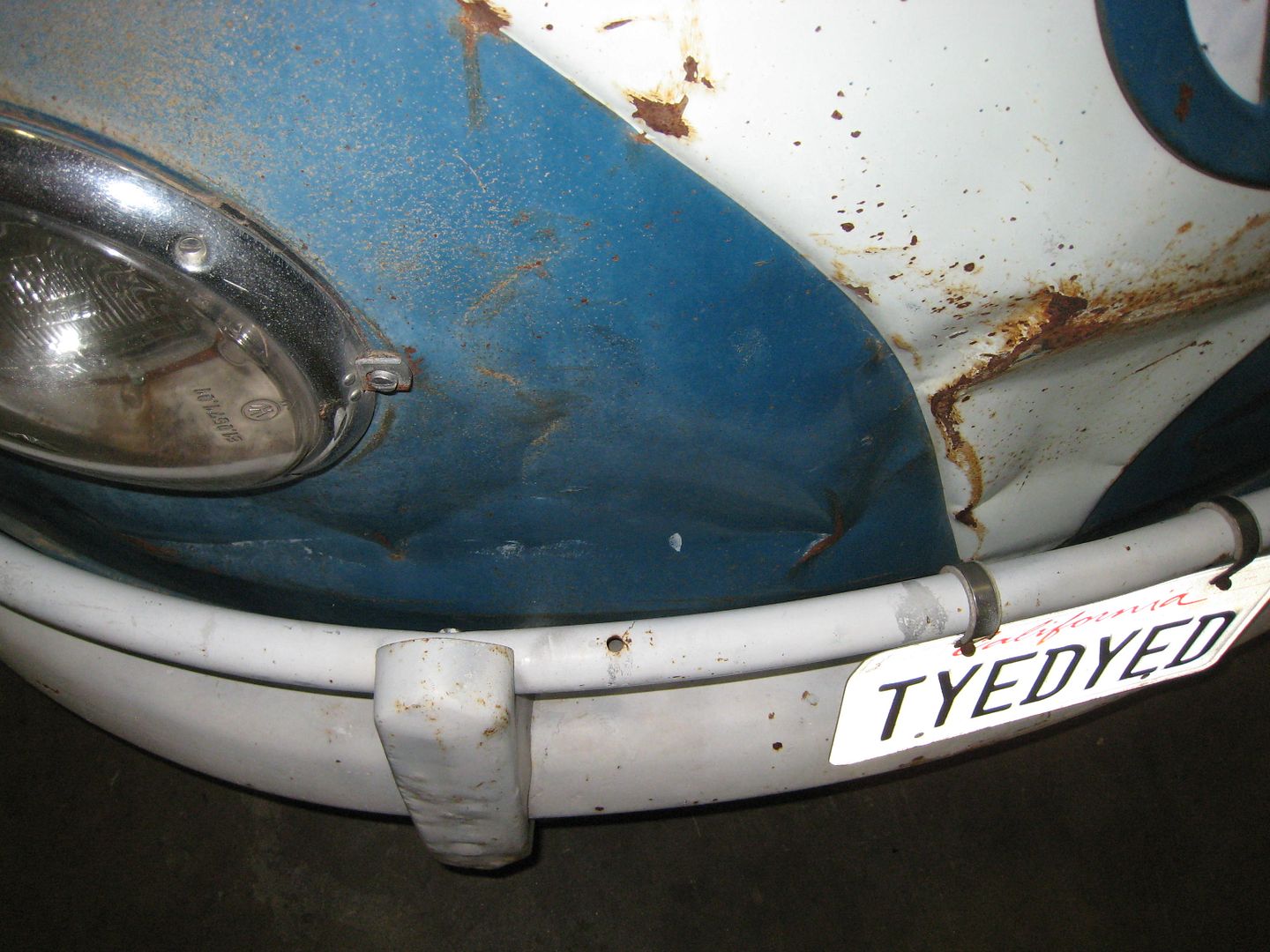

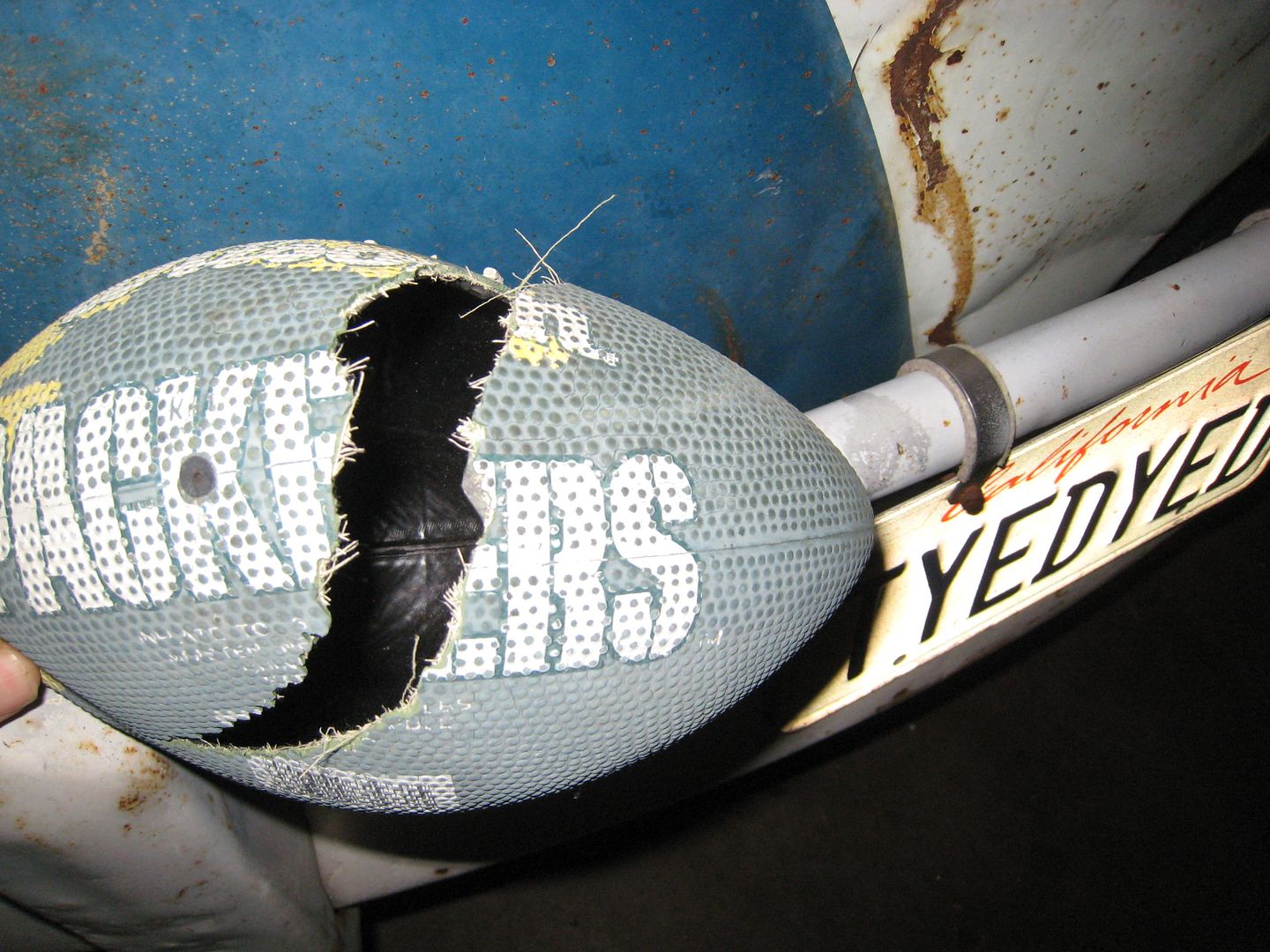

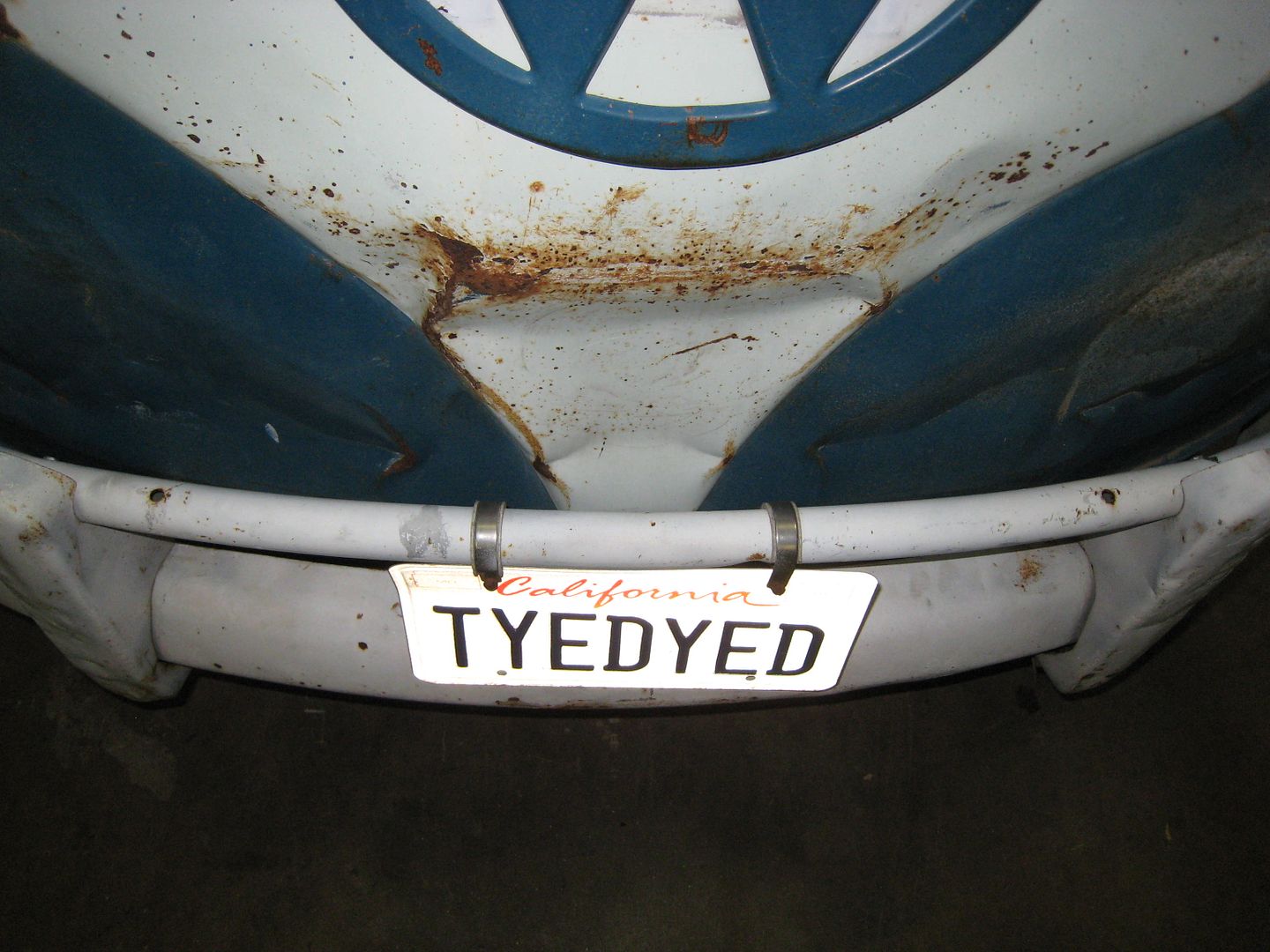

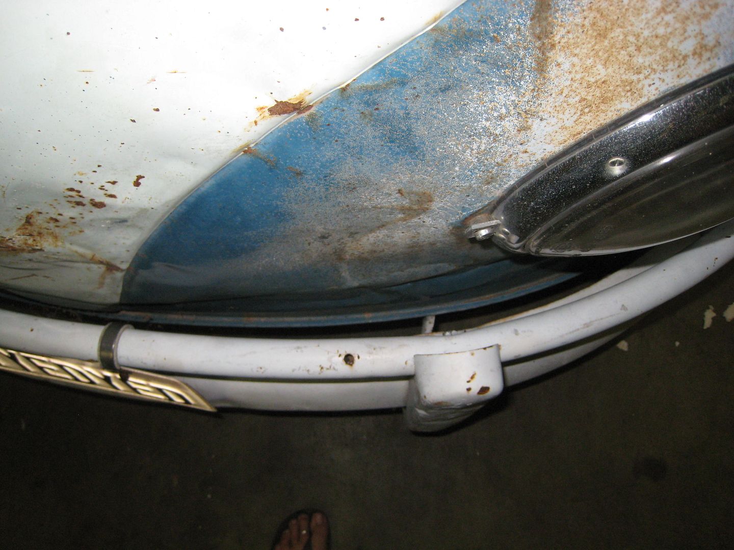

Used the "football trick" to pop out a huge dent in the nose of my '57 Single a couple of years back. The pics don't do justice to the difference! It took all of about 15 minutes.
Before:
After:
